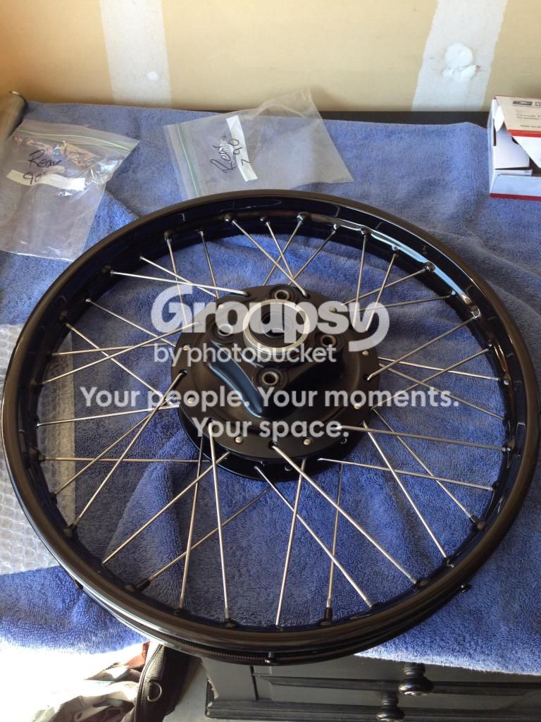

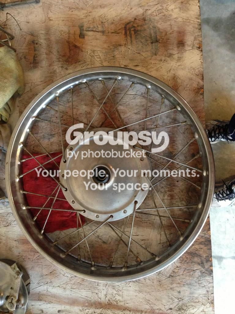

Before i took the wheel apart, the lacing pattern looked like this:

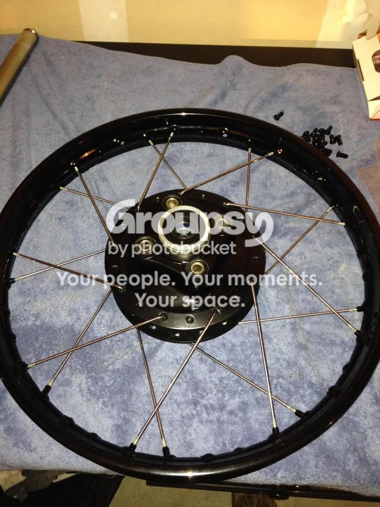

Here's some pics of where I am now and some attempts I've made. I've done this like 6 times over 4 hours or so and I'm bloody frustrated! I feel like I'm so close!
This was my first try. It looks good and I feel like this was my closest attempt but if you look close, the last 9 spokes are too long because of whatever I did wrong. You can see them sticking out of the rim plane at the bottom of the pic:

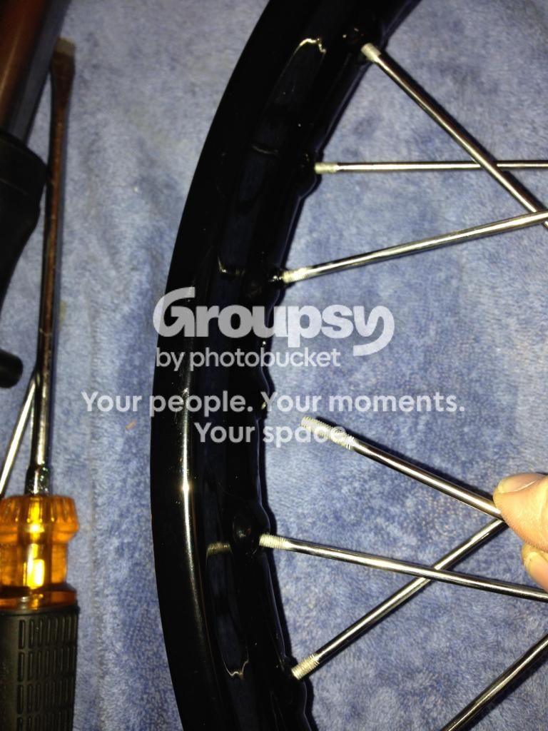

And this is the problem...the last 9 spokes come up short because of whatever I did wrong...

Your lacing pattern is off. See how each pair of spokes that cross each at the flange are 6 holes apart? You installed them 4 holes apart.
