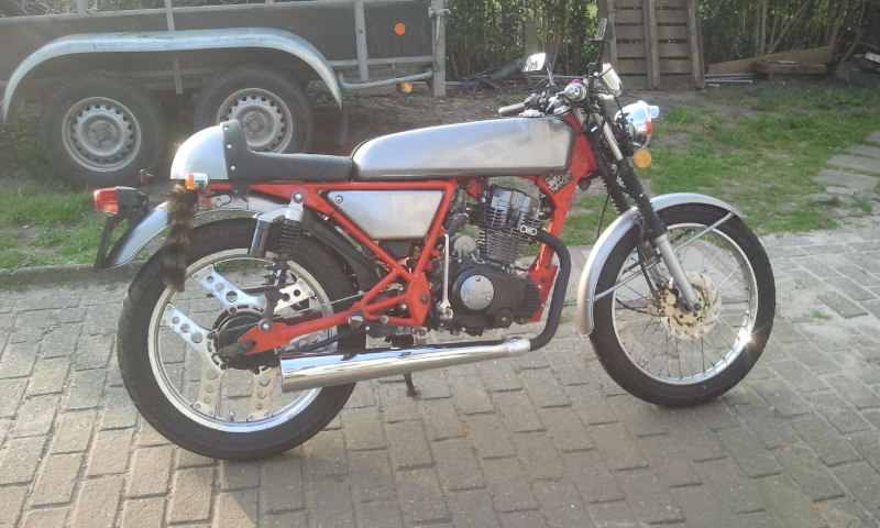

And here it is.
The rear wheel is quite easy. It's less wide than the original so i needed a few spacers. The sprocket is a 420 instead of a 428, so I needed a front sprocket and a new chain.
The honda front wheels need fork spacing of 15,5cm; the Ace has 14,5cm.
First problem is the triple tree or yoke. The only one that has the right steering stem length is one from a CB125T, or CB125RS in the UK.
Next problem are the forks :
CB125 accepts 31mm diameter forks.
CB125 has a crappy floating caliper.
MBX50 wheels have a 220mm disc brake.
Solution :
NSR forks are 30mm
NSR forks have attachment for the same 220mm disc brake as the MBX. The caliper on the NSR is the same as the ace.
I'm going to build a new front end and swap the whole thing.
