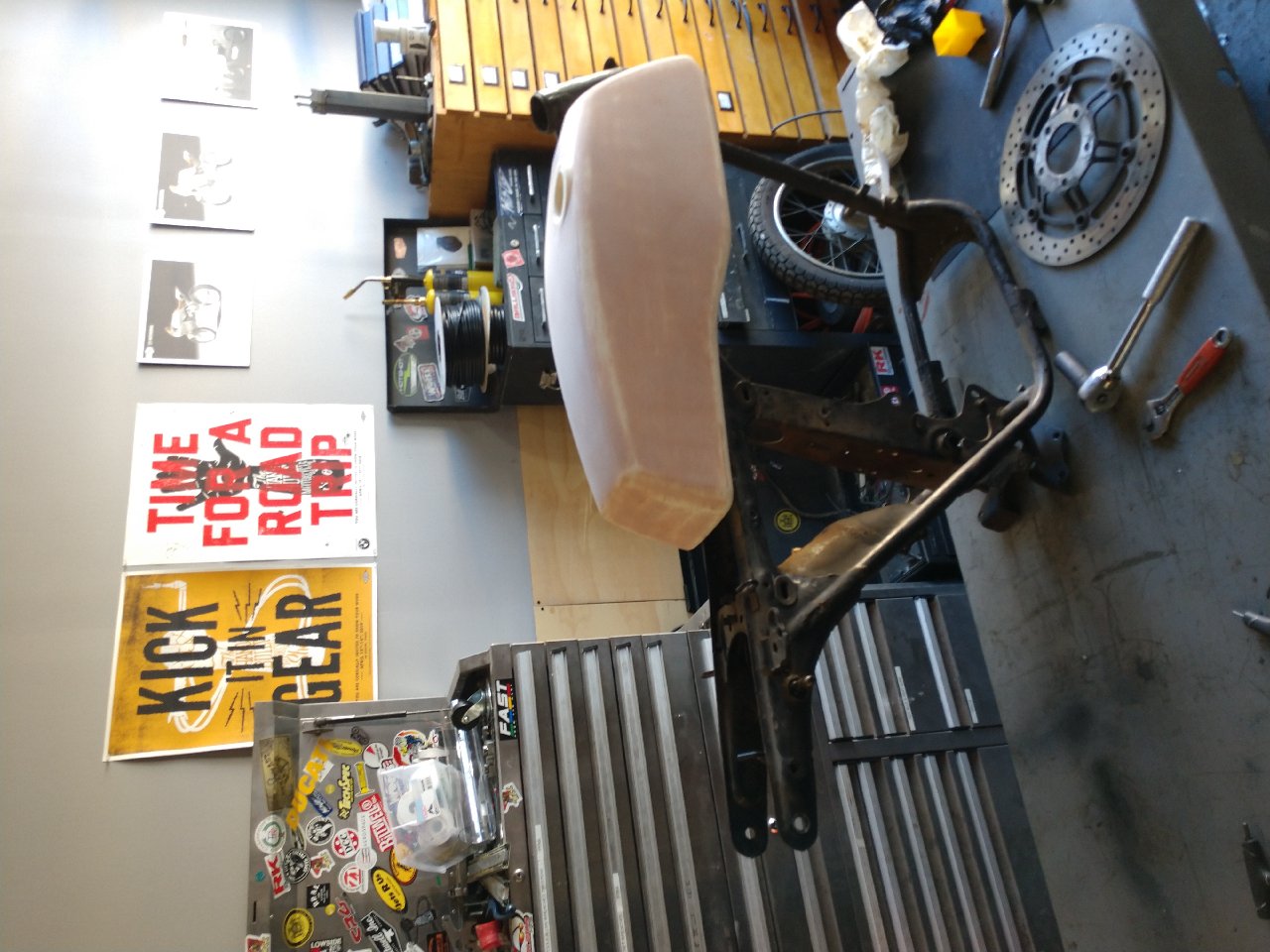

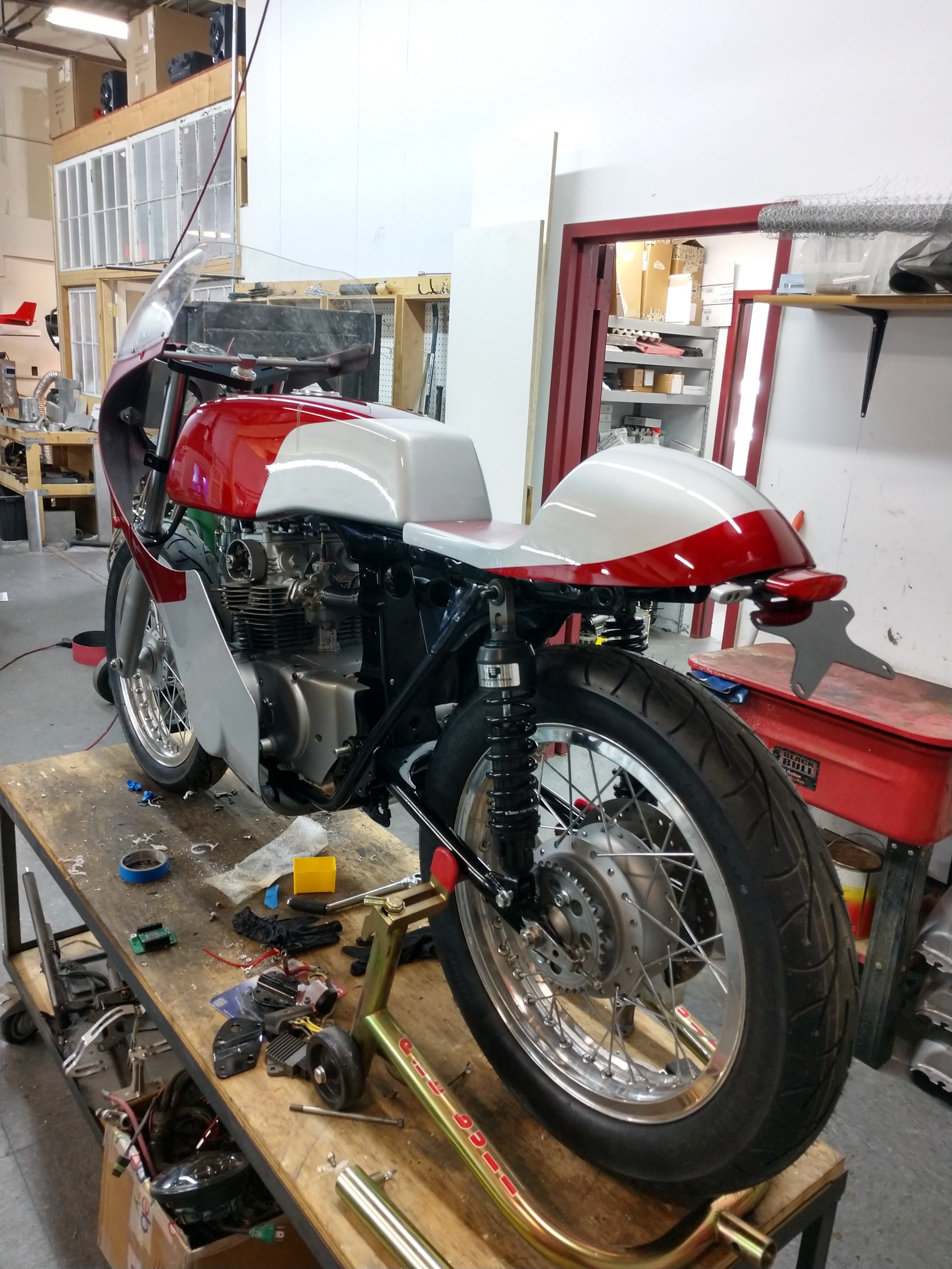

Made more progress on the design and started to print the tank, as that part is finalized. The seat will need some modification because the tail light wants to be integrated but the tire will hit it at full bump, modelled the rest of the front wheel including the brake disc and will need to slightly modify the fork mounts to keep them narrow, fit the headlight into the fairing so I could mount it directly to that instead of having some separate mounting structure. Currently designing the exhaust so I can order bends and start welding them up. It's nice to have a good 3d model of the bike so I can design the exhaust and find interferences before ever cutting metal.
tank finished, a bit more filling and it should be ready for primer, seat design is finished and currently printing
almost done
