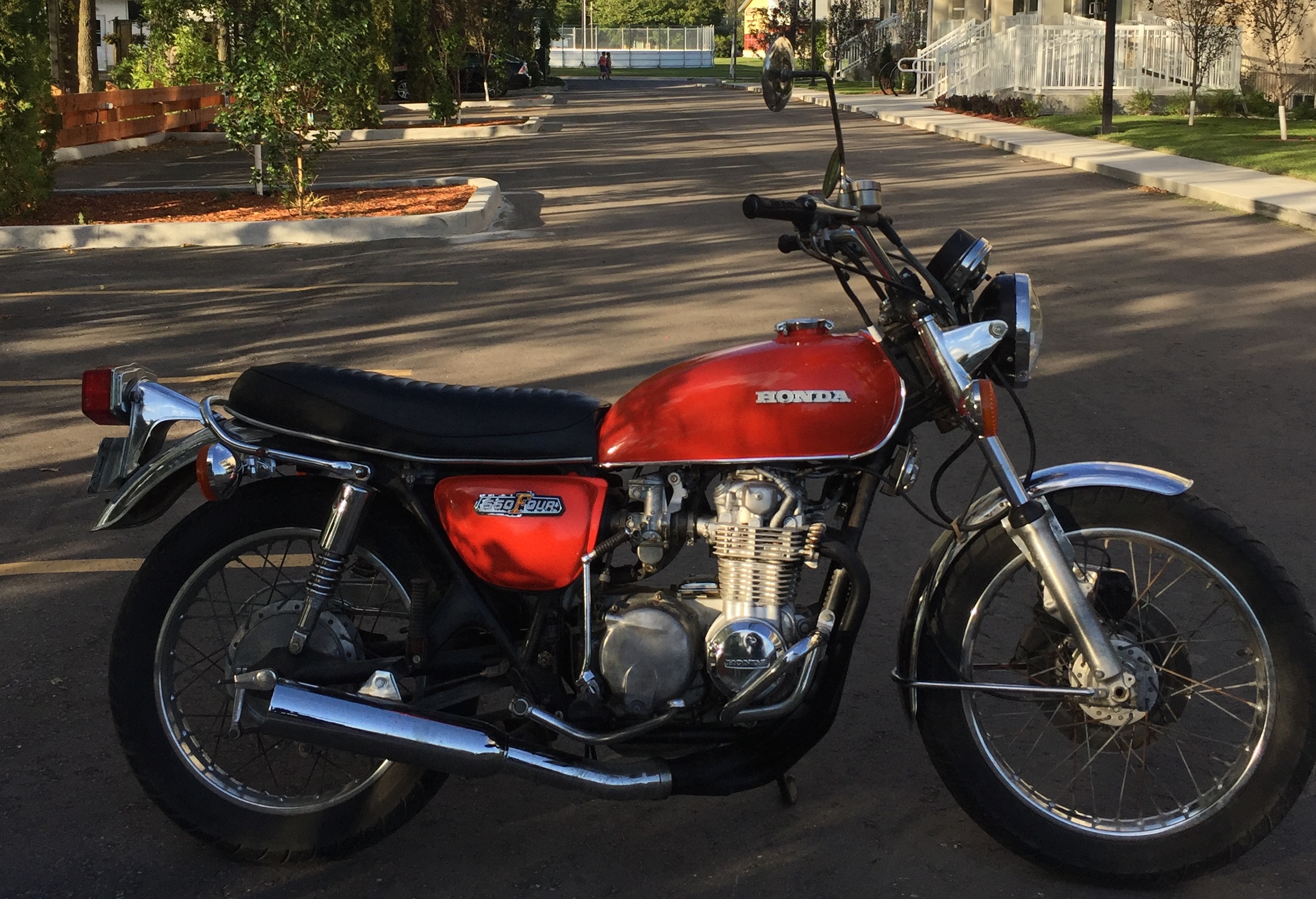

Hey all,
New guy here. Been lurking for a while, but figured it was time to introduce myself. I'm fairly new to bikes but eager to learn. This is my CB550 -- has been a blast to learn to ride on. Have some carb issues now and I'm a total newb, so I'll be asking for some advice and help from the community here.
