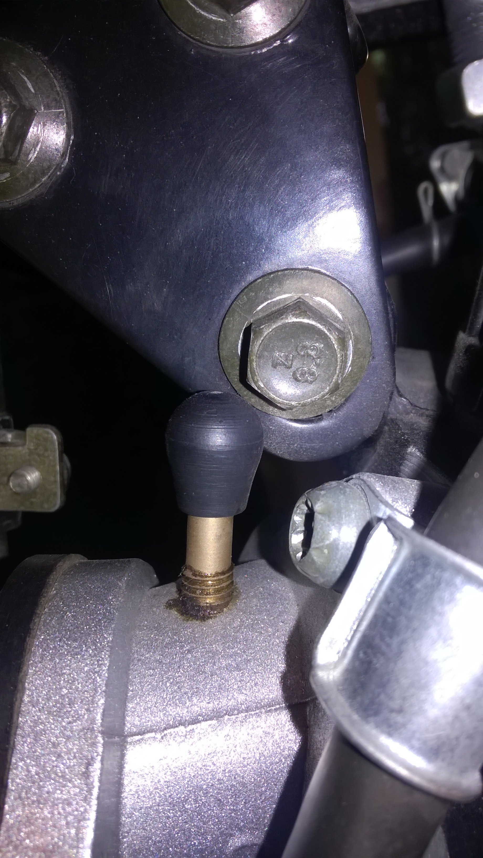

Dealer had already removed the emissions stuff for me. I think it is just a matter of undoing bolts. Only trick is to find something to fill (and completetly block so it doesn't suck air) the littlle hole that is in the top of the carb. The screw they used to fill mine looks like this..
Cheers
Richard

- Plug the inlet manifold as shown by 2B above

When you plug the hole, use some sort of goo, to make sure it is truly plugged. Not sure what they used on mine, but you can see the residue there gathering muck. If there is a gap or the plug falls out, and air gets sucked in here you will have trouble tuning.
