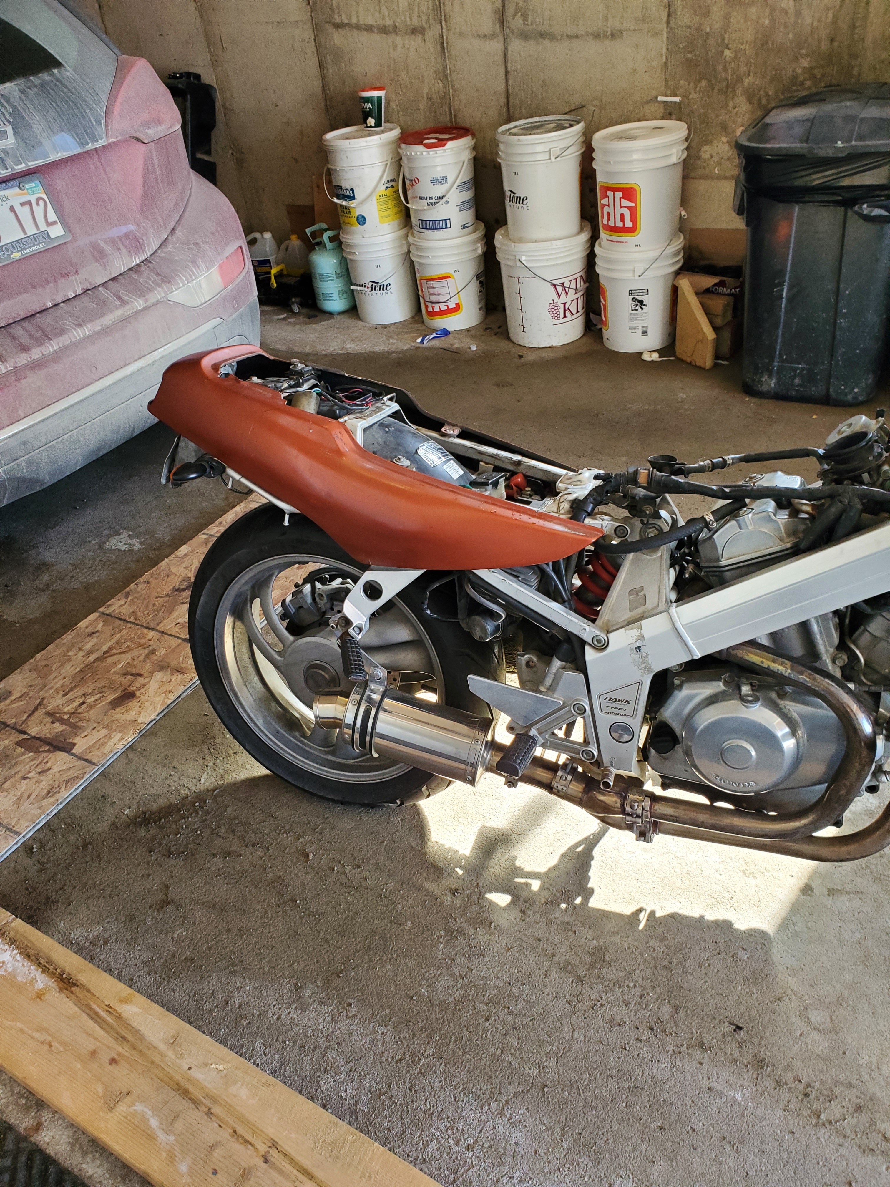

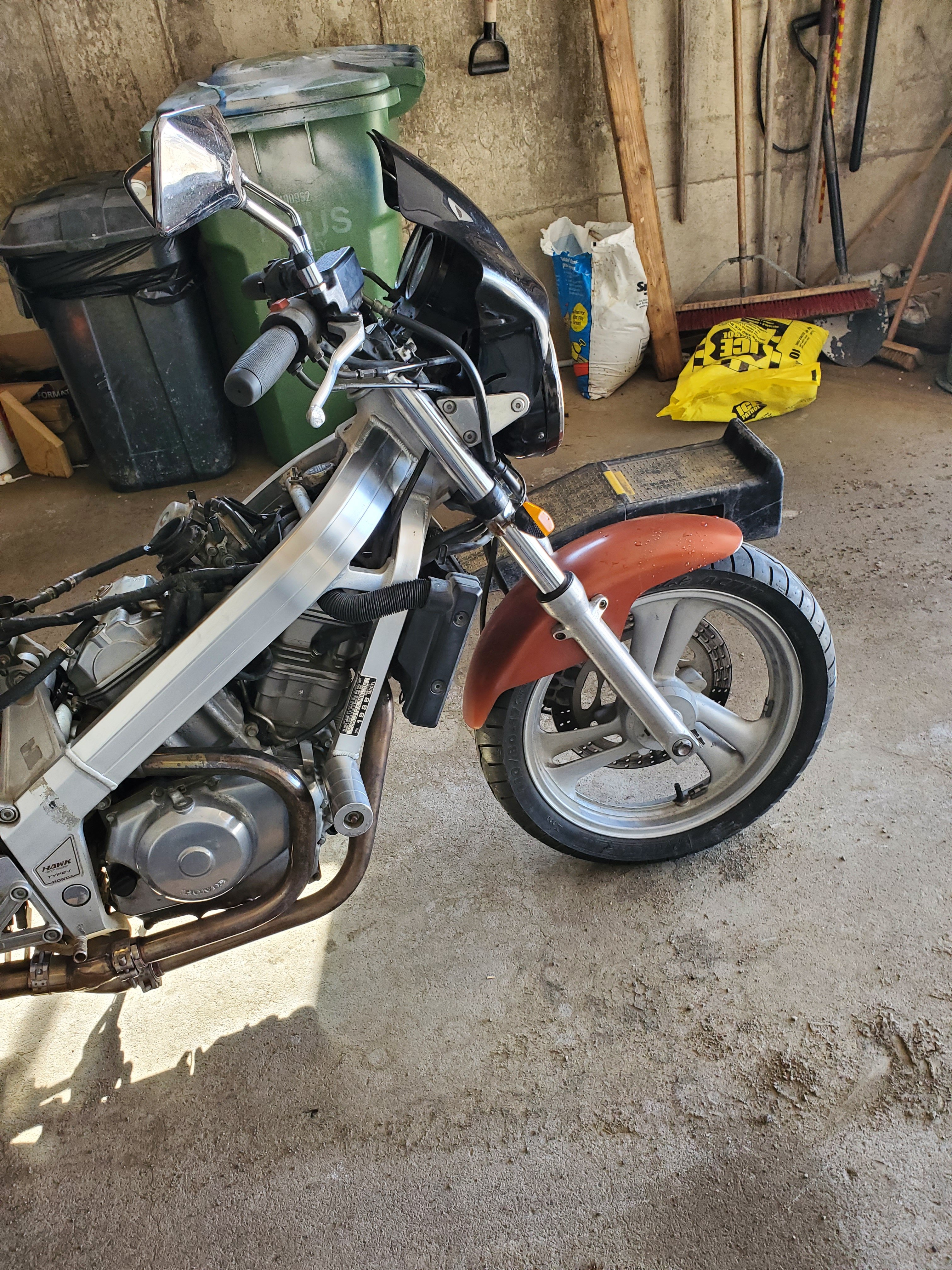

Here she is
So basically got the bike in the house then left town to help my wife's uncle pack up and move to a care home. I lifted the slide in the carb on Sat, it was still up Sunday night so they are coming off, hopefully tonight for a cleaning. Aftermarket can on it, no label but Mark say's is sounds good. seat needs a new cover too. Will be making a list of needs tonight too, there is some sketchy wire connections I'll be redoing and need to test all the lights etc. Pretty low KM's for the age too.

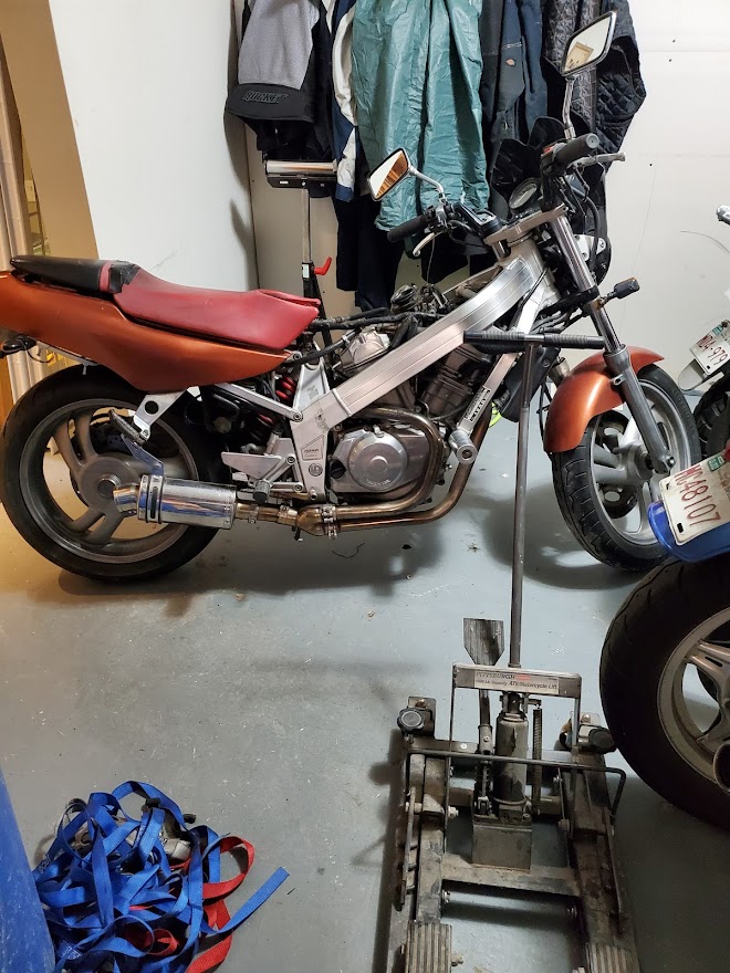

Tank came. Need to figure out how to mount it, which Petcock to use etc. Will get pics on the bike tonight
Here’s the ‘90 I’m working on for a buddy. It has a F2 tank as well. Someone before him did an absolute hack job on the stock subframe to mount up a Ducati Monster seat. I scrapped the stock subframe and made my own for it. I still need to fab and mount up the electronic tray but it’s getting there.
