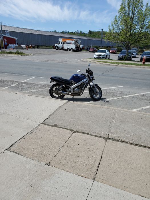

Hawks are slow, Hawks are slow. Top speed maybe. Holy shit I did the plug swap, fired on one stab of the button. Left drive the way I used to and almost wheelied. Shit eating grin. Redline 1-3 in seconds and 4--5 not much slower hit the ton in a crouch on a SHORT stretch of 55mph road straight and continued to do 45 miles of fun ass twisties. 50-70mph in no time just for fun. Texted Magoo be careful she's angry now.
Gonna have to fight Magoo to get to ride the bike now. He took it out yesterday after I got home from work with it and came home with a huge grin! He said it was like a new bike and loved it. He came home after a short 10 min test ride, took off his gear and went in the house, 10 min later he said, I'm going back out and came home 1.5 hours later LOL.
