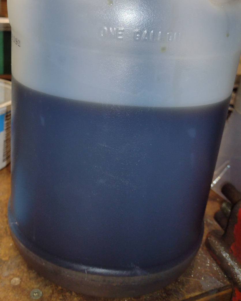

I'll have some photos up, but after today it may have been foolish to judge the motor by the compression. Drained the oil and got about a pint of water and sludge along with it. Sump in the bottom was filled with an unknown sludge that grudgingly scraped out of the sump pan. Happily the gearbox (separate) was just oil, but the primary cover held water along with oil, also. Letting it all drain and drip while deciding next step.
I discovered with a '79 GL1000 junker I bought that water doesn't seem to get at bearings and journals due to the thick coating and small gap for oil. But, gears rust up pretty bad. Haven't opened the rocker boxes yet. Guess a full set of gaskets should be ordered. These use the same transmission as the Bonnie and TR6C, but this is one of the homologated 200 built in 1972 with 5 speeds. Still right hand shift until 1975.
I guess this negates the bonus of having a seat already that fits. Hunley had a little water in its oil, but very little.

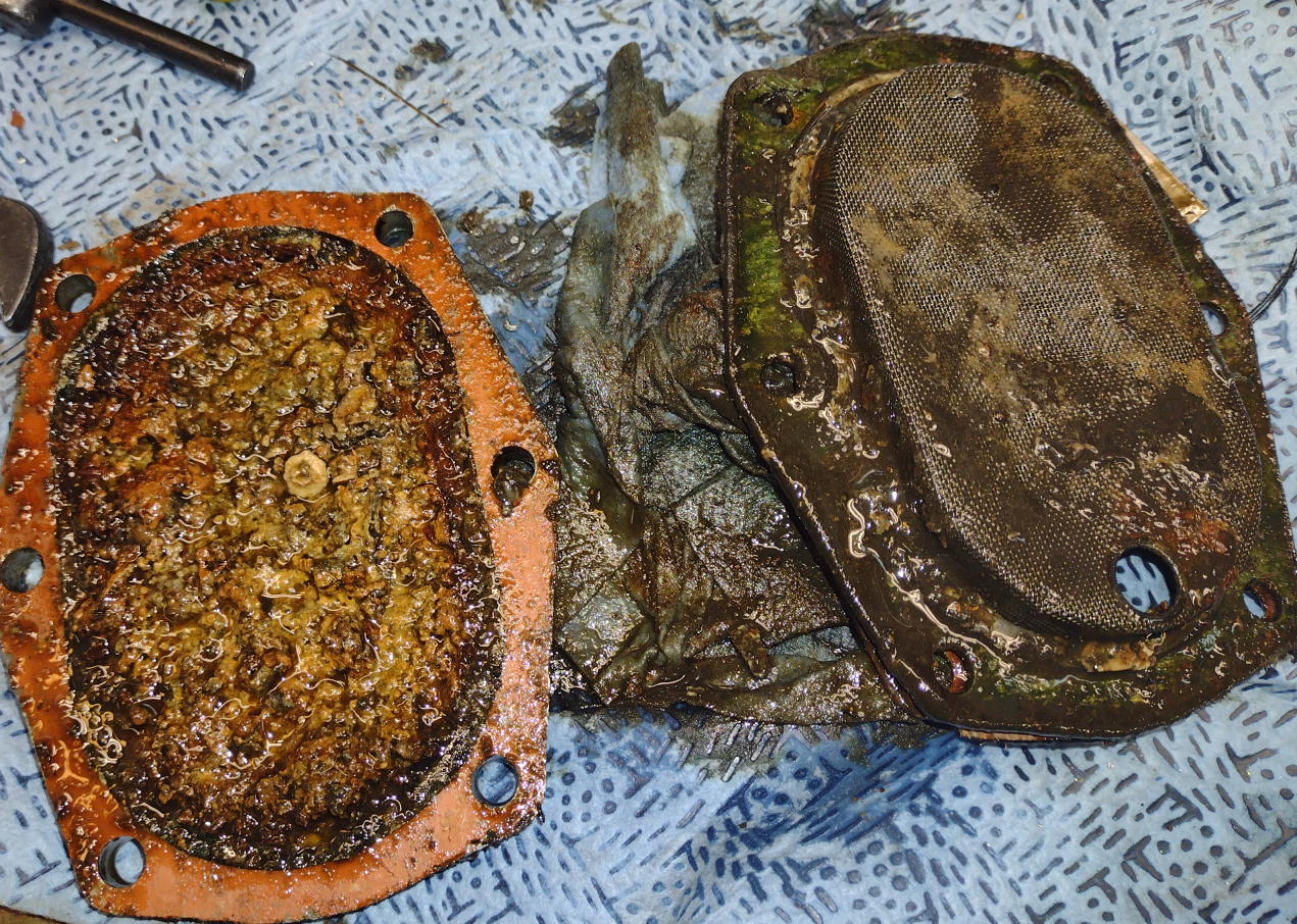

What is it with me and previous owner issues? I think this one may have had the same goons beating on it as the Hunley had. Orange RTV everywhere! The sump cover cleaned up OK. Stuff in it when dried looked like dirt. Gasket RTV'd on of course.

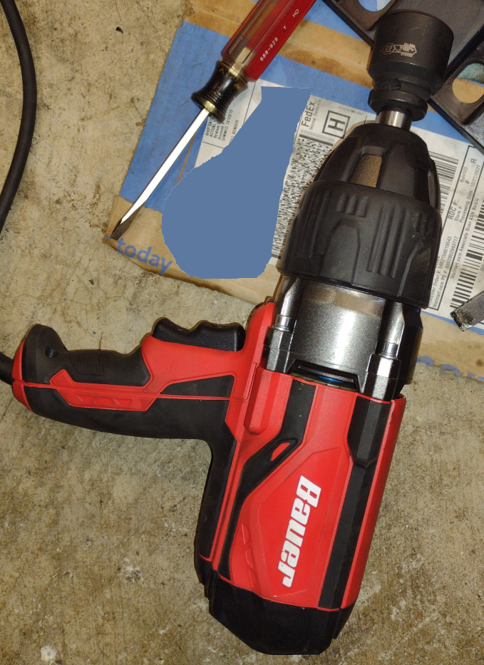

Brought it plastic car ramps and laid her on the right side so I can pull the outer primary cover and get to the oil pump. I figure it at a minimum needs flushed out, and it will give me access to inspect and flush the rest if necessary. So, what do I find? glued on with RTV! Primary sprokets came off easy enough (notice a PO used the hammer and chisel wrench).
BTW, I LOVE this impact wrench!

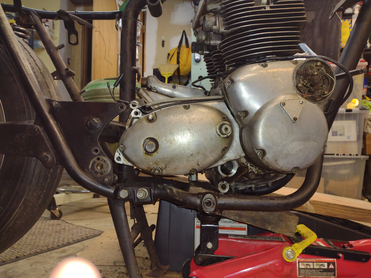

Oh, Lort. Finally got the oil pump out. RTV had a death grip on it. And, not all of it came out! the base plate is stuck in (not aware of how) and someone broke both body screws off in it, so there is no way to grip it to pull it out. So, I will leave it in. I have been able to blow through the holes in it with 100 psi air to assure myself that water has not been pumped into the oil passages of the engine. If any, it was pumped into the oil cooler line (and the oil cooler is missing) by the scavenge pump. The inner primary cover came off pretty easy. No gaskets (except for the pump o-rings, and they used two of those) were used by whoever put this together - just gobs and gobs of orange RTV. But, it is all scrapped off now and gaskets are on order. Spent a bit of time with needle-nose forceps picking little bits of orange crap out of everything. Haven't taken a cover off of the other side yet and I don't see any squirted out of the other case seams.
Some of the RTV that I scrapped off:
Actually got the rest of the oil pump body out. Used screws through the clamping holes to jack it away from the bottom. Turns out it was glued to the gasket, and the gasket glued to the case with RTV. Fun to get out of the pump cavity, but I did finally get it all cleaned up. Cleaned and reassembled the pump and it turns smooth.

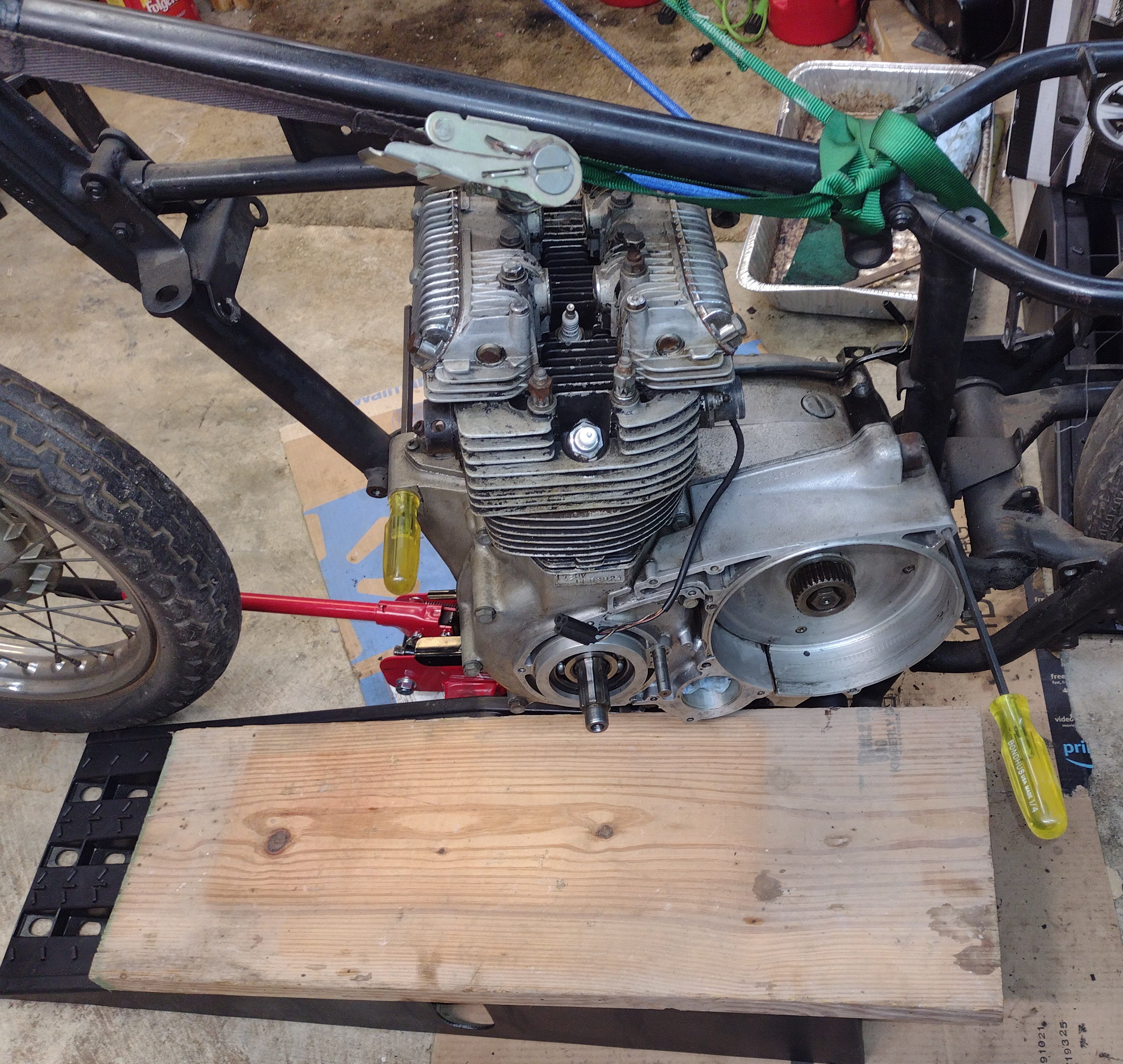

Decided this was definitely going to require engine out of the frame, even if not a full tear-down (not decided on that yet). So, today I pulled it onto a furniture dolly so I can roll it around the garage. Pretty dicey for an old man by myself, but it went Ok in the long run. Might be a different story going back in.

When you get the engine ready to go back into the frame, it is much easier to lay the engine on its side and lift the front section of the frame over the engine. The trident engine probably weighs nearly as much as the CB750 so it is no lightweight. .
That is the plan. It is how I did the CB750F. Service manual lists it at 190 lbs.
