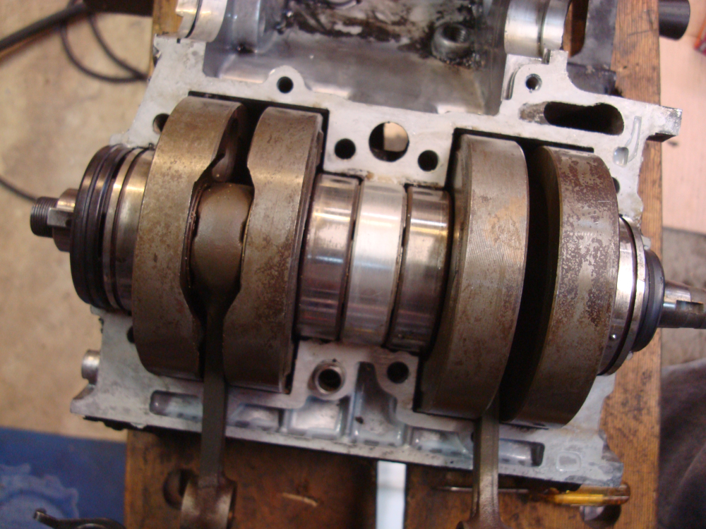

The case was glued together with some kind of grey RTV. There wasn't any in the transmission, but the crankcase had bits of it everywhere. The crank - I have no confidence in it. I have no experience with bearings that spin that fast. Electric motors with grease lubricated bearings, yes. And, these would be rejected then. Seems these should feel tighter, and be silent when I spin the crank with the rods. Instead, there is a constant whir. The outside left main sounds fine the right is noisy, I can't really tell on the centers.
So.... Who are reliable crank rebuilders in the USA? And although this is almost a moot point - about how much does it cost?
For a 350 it's cheaper to get a brand new crank from Vito's. Not sure if they do a 400 version though. I have Bill Bune in MN do all my GT750 cranks and I'm sure he could split and rebuild the 400 cranks too. Rods are easily available as are mains and crank seals.
Try John at Economy Cycle for RD parts. There's a guy in Florida, Chuck Quenzler that seems to do very nice work on RDs and he rebuilds cranks. There's also Garret ?? on the left coast - he's on 2stroke world.
That gray stuff should be semi hard Threebond/Yamabond/Hondabond. It's still available but in a slightly different concoction. Probably reduced the toxicity or VOCs or something.

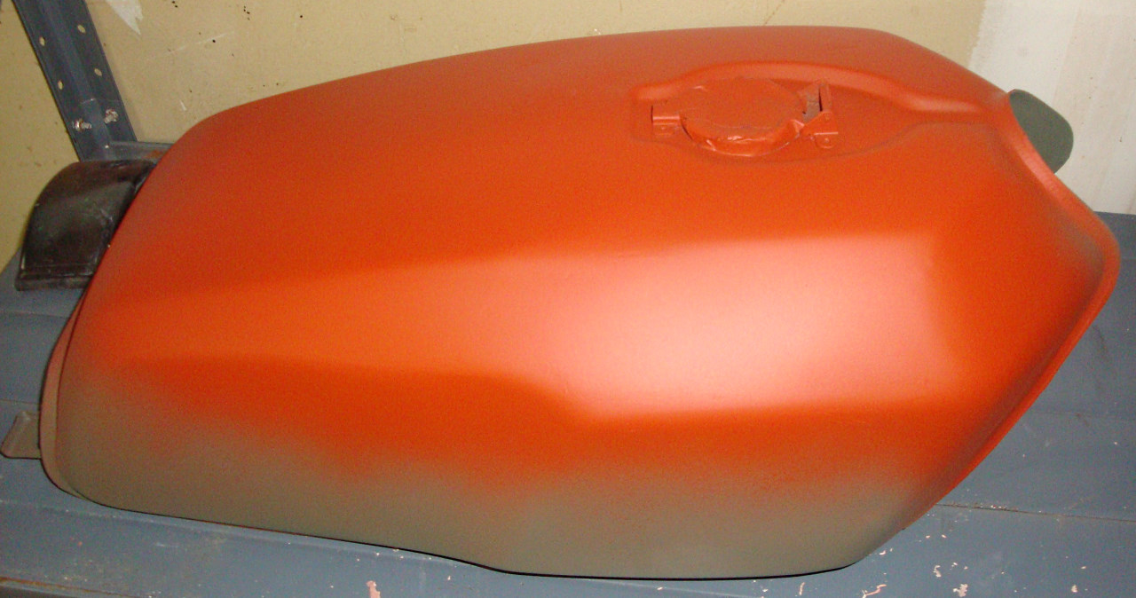

Finished removing the paint from the tank. Bondo on the small dents and the one big rough spot left on the front after using the stud welder on it. The a lot of sanding, and more Bondo, more sanding, Bondo Glazing and spot putty, more sanding. Primed the bottom (tunnel) with etching primer, then the top. Noticed some rough spots on the top, so built up about four layers of filler primer (the red). I'll let that cure overnight and hit it tomorrow with sanding again. If good then, a good etching primer layer to seal everything so the lacquer will not react with any small bit I may have left. Considering leaving the tunnel with just the etching primer and then clear over the whole thing when it comes time.

Well, good and not so. The "filler" primer never hardened. Had to sand it off. Then I tried Bondo Glazing and Spotting Putty - it never hardened and continues to outgas through my lacquer-based etching primer, messing it up. Dug that out and replaced it with regular Bondo 2-part. Pretty close to what I want, now.
Looks pretty good now. I hate when the filler primer doesn't dry and spot putty is hit or miss too.
