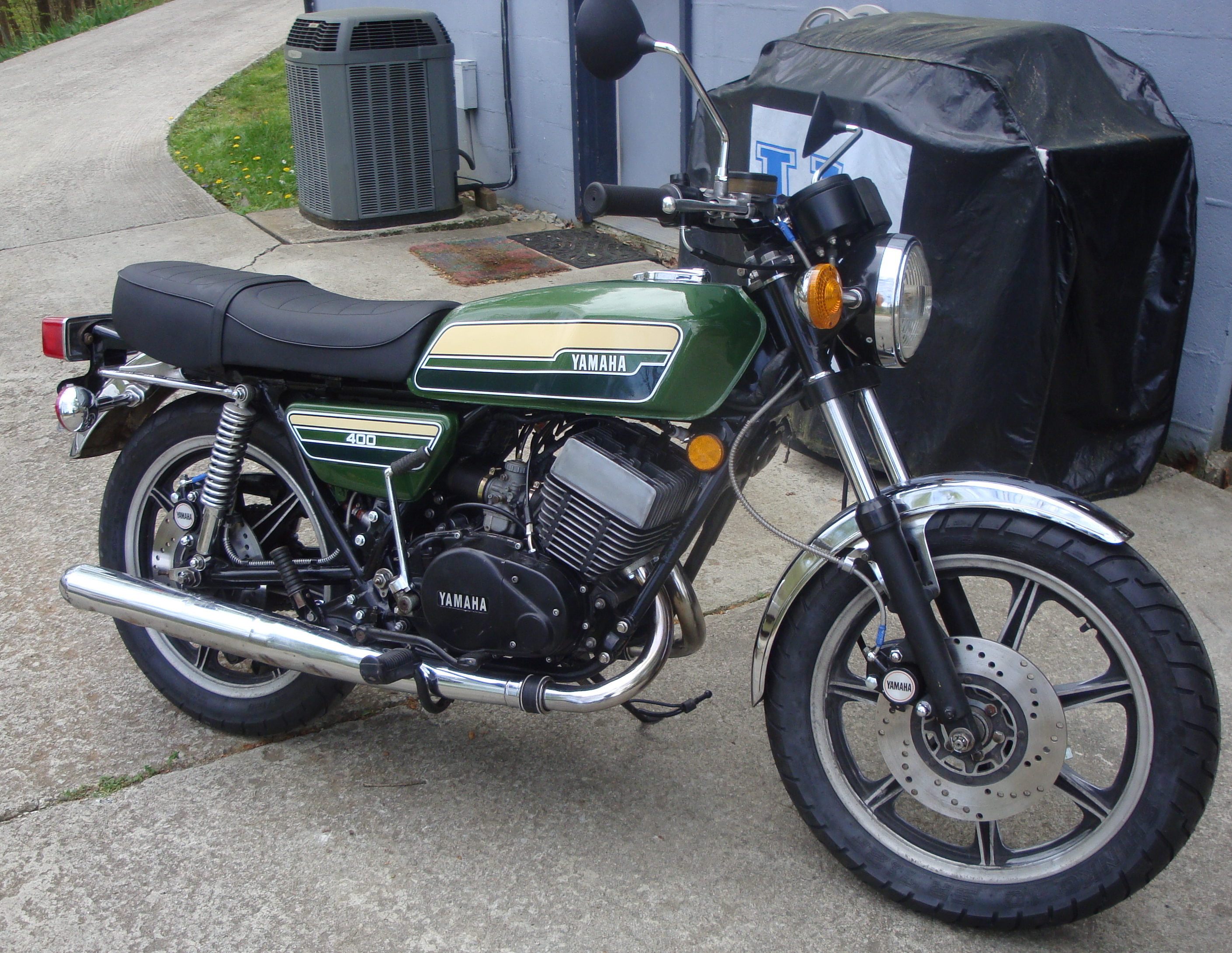

Yeah that’s BOTM material right there. Gonna eat my bbq’d chicken and then this little beauty is getting nominated
