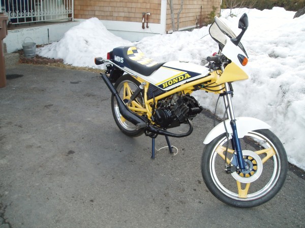

I am working on a 50cc Cafe, power is from a MB5, 6 speed. Stock bare wheels weigh 13lb rear and 10lb front. I have built new wheels with weigts of rear 9lb and front 3.4lb. Any ideas as to what kind of useable power improvements I can expect. A Stock MB5 weighs right at 175lbs dry, I have my tatol weight down to 136lb. Thanks for any input

Lowering the weight of the bike will provide no power increase, but it will allow the bike to use the power it does make more efficiently. If you want to create more actual power, look into an overbore/oversized piston, head work, new carb...
You'll find the most power for the buck in a after market chamber/pipe. And ya, you should feel an increase in acceleration with lower rotating mass. Also, if that motor is a reed valve unit. After market reeds would make a difference too.

In re-reading my initial post was worded in an awkward fashion. i'll try again, in loosing the weight would there be an appreciable performance gain ? I already have a pipe and aftermarket reed set-up, trying to keep the engine at 50cc.
Sort of....
Losing weight will not change performance per sé , but it improves the power to weight ratio so the bike will accelerate faster. Rule of thumb was always 7 pounds = 1HP. Lose 14-21 pounds and the bike should feel more nippy.

Thanks TEAZER, That was what I was looking for, some sort of guestement. I had read that a 10% weight loss would equal a 10% gain which seemed pretty generous.
