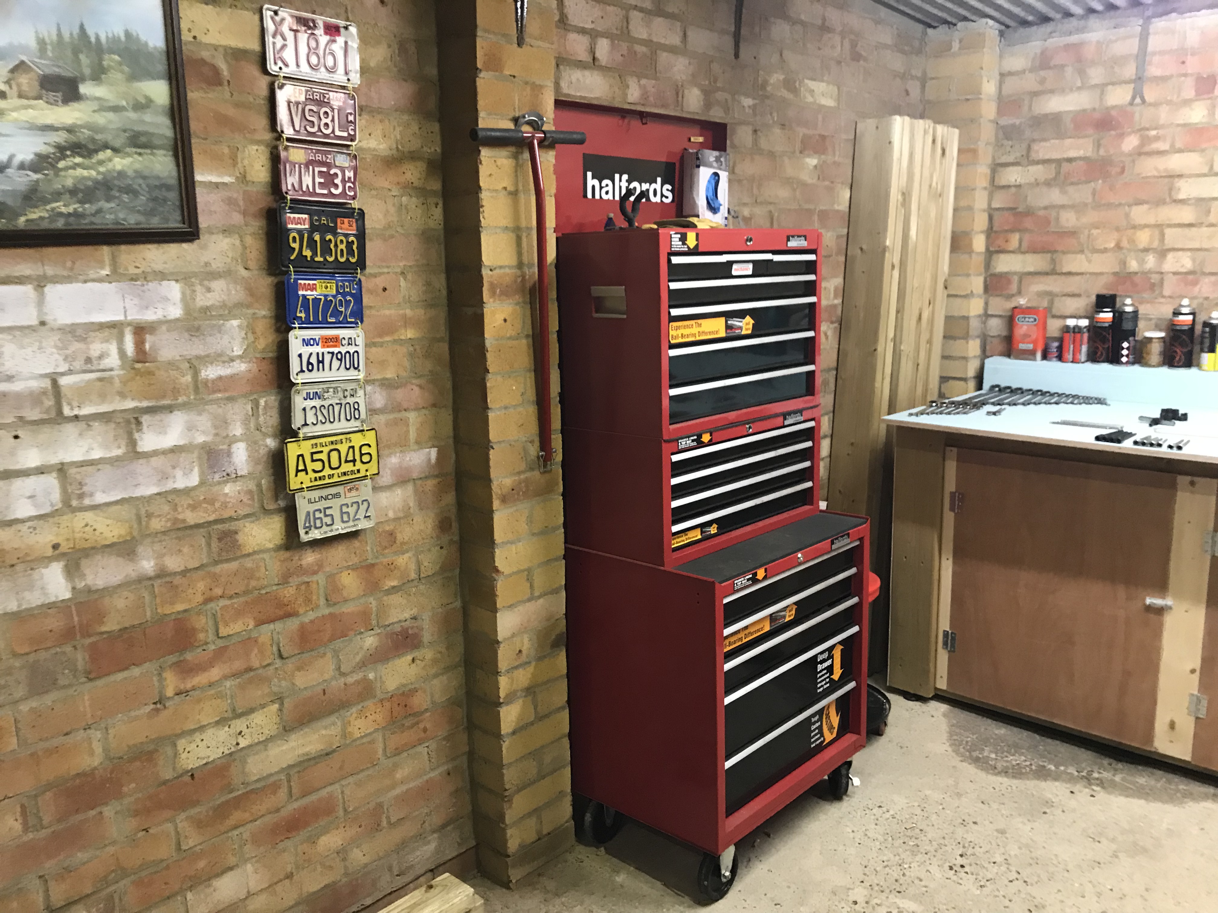

This is my garage and workspace.

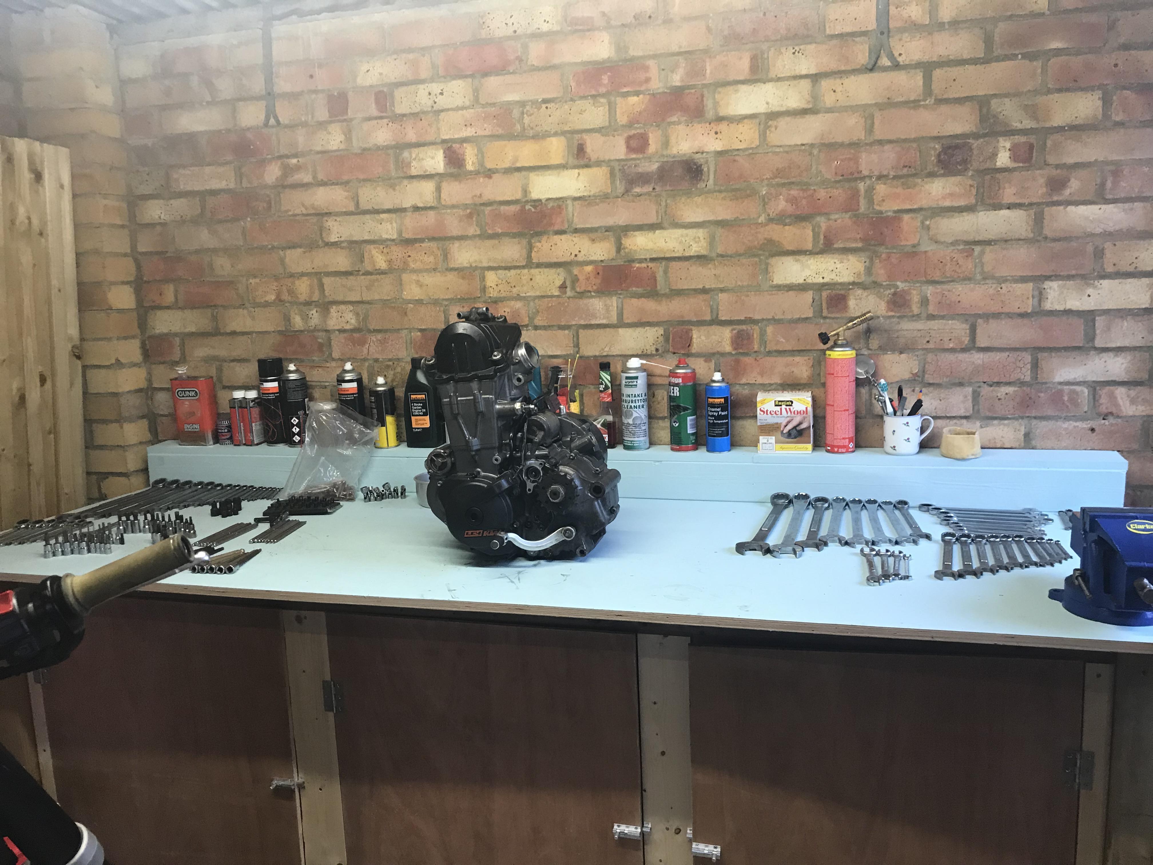

I built the workbench specifically for this project. In this picture it's not completely finished, and I am still organising my wrenches.

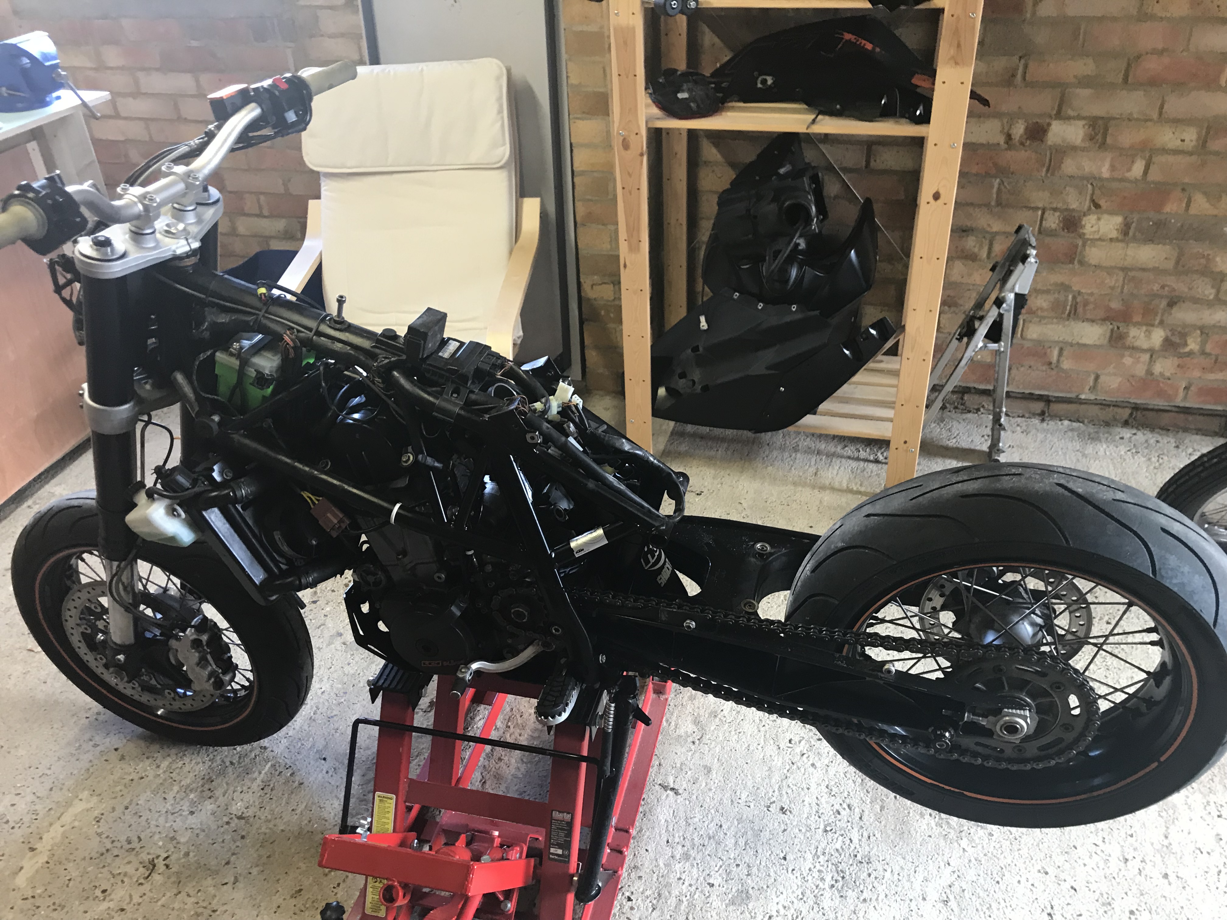

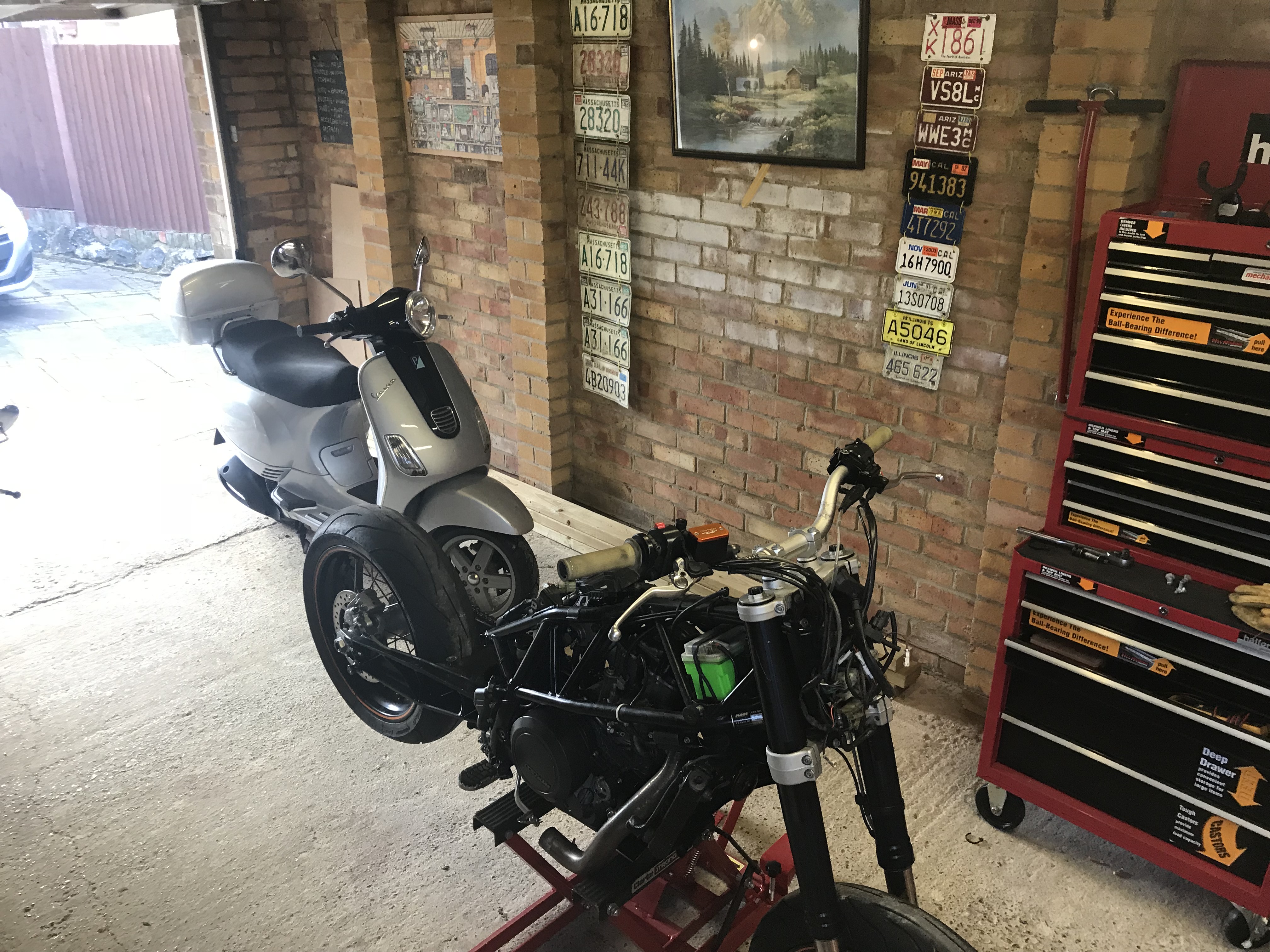

Engine ready to come out. My wife's scooter is in the background.

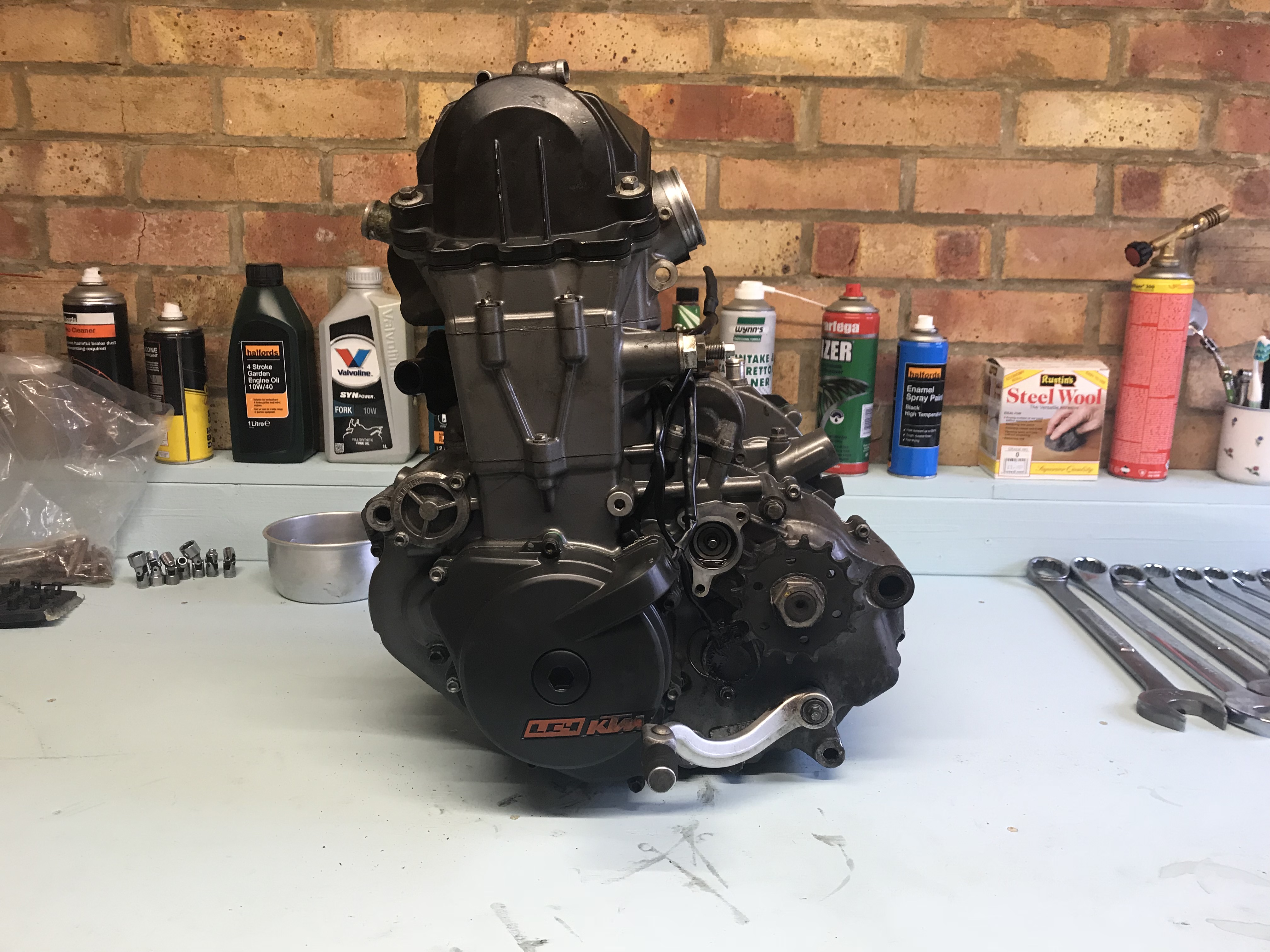

And the motor is out!

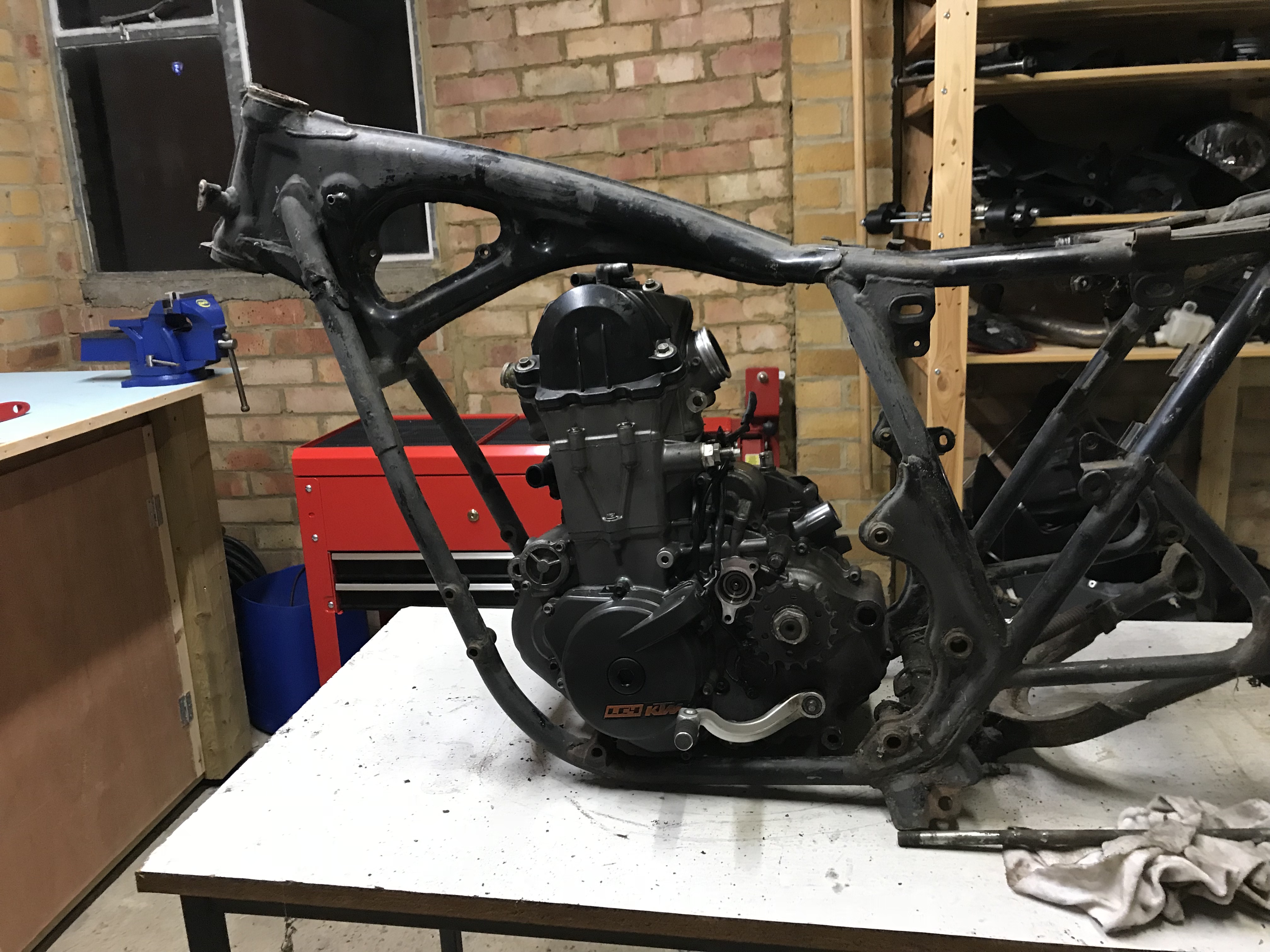

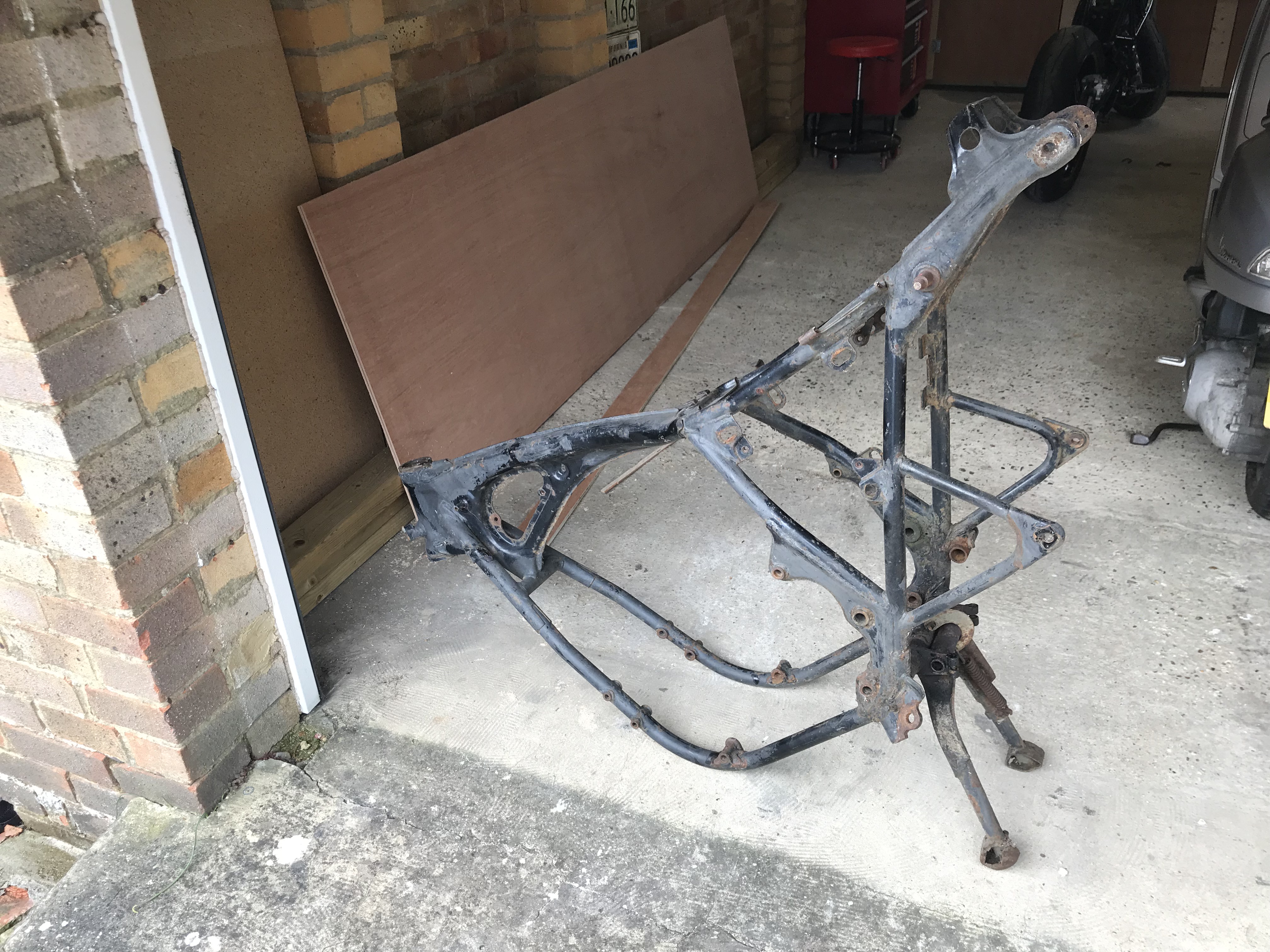

This is it, the beginning of my dream. I bought a 1977 cb550f frame from a nice guy up in Essex. The engine more or less fits in as I expected. The swingarm pivots will be removed from the 550 frame and new ones constructed that move the engine a few inches forward. A new swingarm will have to be constructed, as well. I may have to modify the left hand tube under the engine to allow it to come down a little, it sits a little high right now.
The other side.

Another picture of the frame. I still have some work to do on the frame, like freeing up and removing the centre stand.

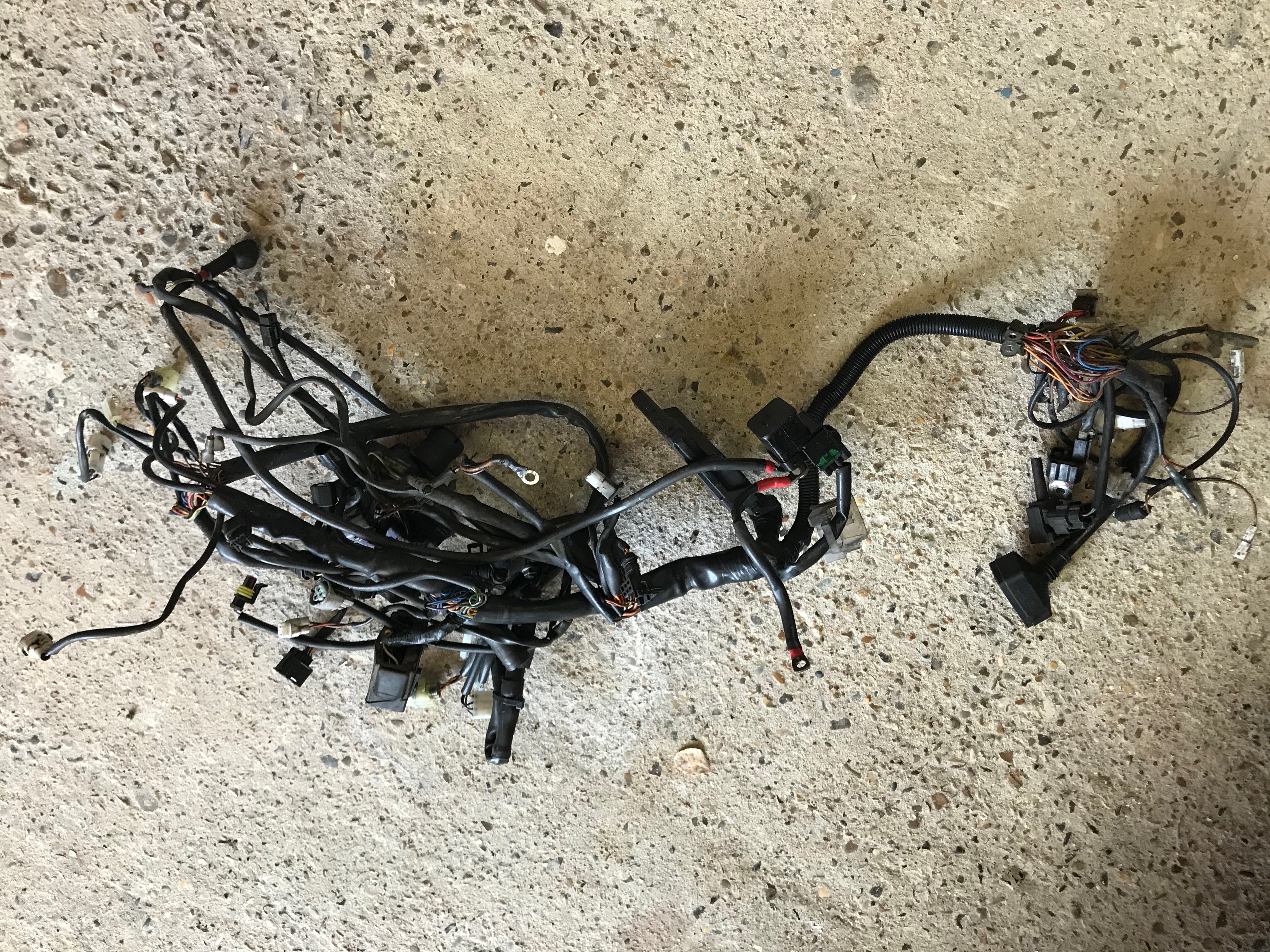

The wiring harness. This entire thing has to fit in the CB690 somehow! There is a ton of stuff on it. Tip-over sensor, barometric sensor, two different computers, just lots and lots of connections and switches.

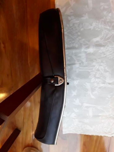

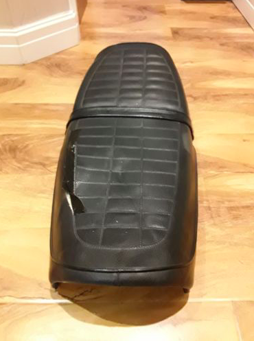

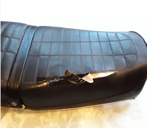

Just overpaid for a seat on eBay. I need it for the mockup, I'll refoam and recover it later. The pan is in good shape which is the most important.
This is from a K model, and I don't actually know if it will easily fit on the F model. We'll find out when it arrives, these pictures are from the auction.
