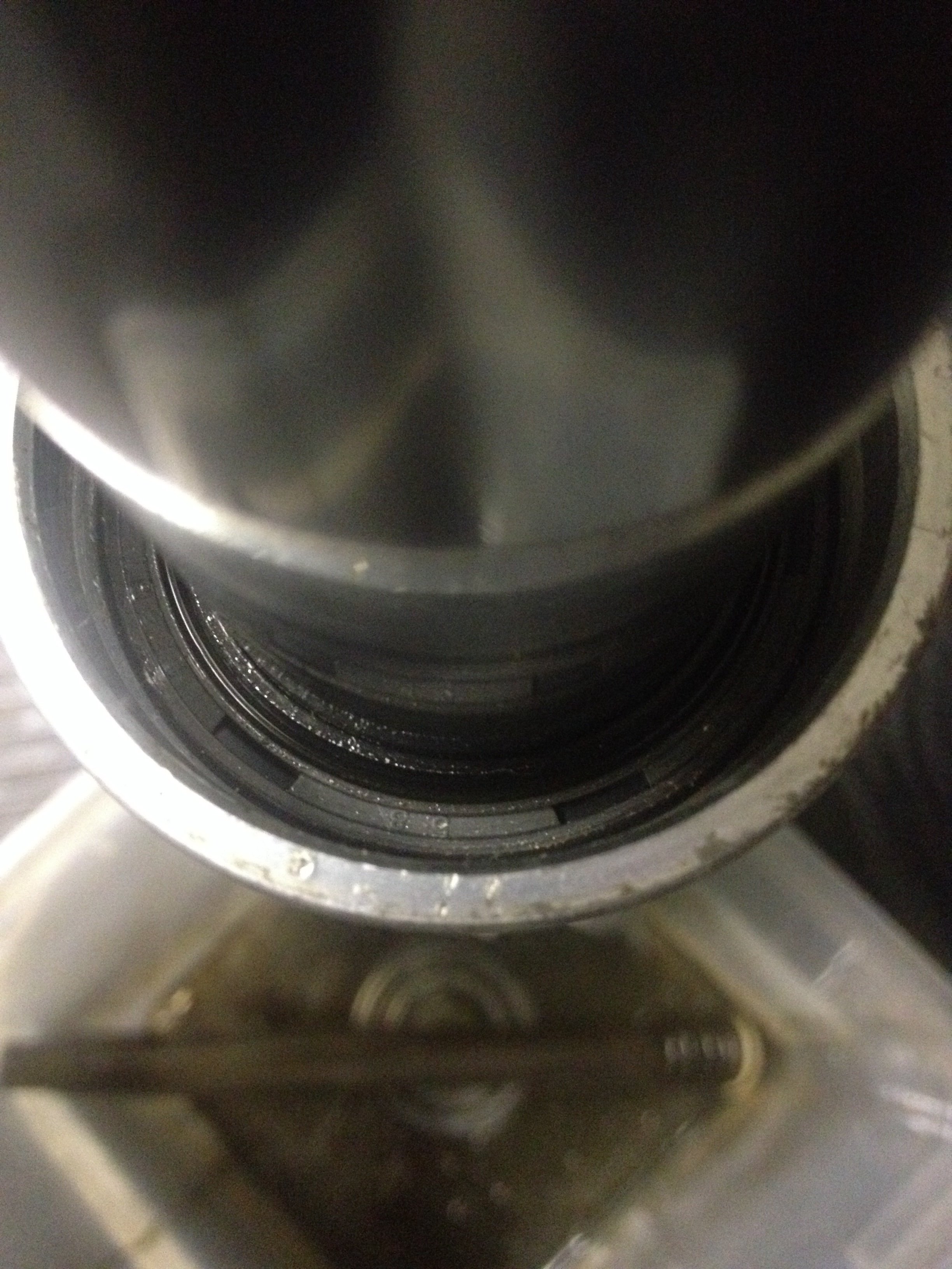

Can't seem to pull apart my forks...got
Everything out that I can think of except for the deal beneath the snap ring..am I supposed to take this out toget the station out? If so, how do I go about doing it I don't want to throw a flathead onto and rip it trying to to pry it out

your forks have bushings one under the seal one low down on the stanchion
you need to slam bang them a part,the lower bushing will catch the upper bushing and all the force will then drive the seal out,it wouldn't hurta thing and proly help a bit to heat up the top of the slider around the oustside of the seal area

it just doesnt feel right slamming them apart...feels like this is the wrong thing to do haha...but if you say so I will give it a shot
thanks xb

roger that, it never feels right slamming them apart :-\ but it is the way my friend,it is the way ;)
Stupid question #67.....
You've removed the damper bolt, right?
EDIT: Nevermind - I can see the damper rod in the bucket in the background...

haha yes I made sure to remove that...had to drill the sucker out in fact..already picked up new bolts tho today so that always feels nice to get new things...even if its two allen head bolts
