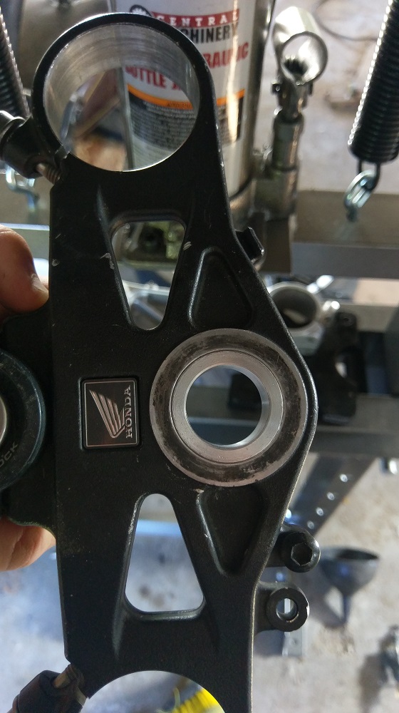

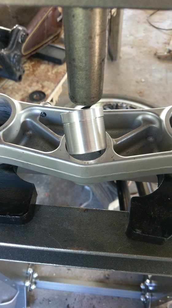

I figured I would update this post with some new things
I got the stem sorted out by making 2 adaptor rings, one for the top triple and one for the bottom. Both press fit. These adapt the old stem to the new clamps on the 09+ forks.
The old stem was then pressed into the bottom adaptor. The top clamp is not a press fit onto the stem. The bearing cap will need to be modified to run tapered roller bearings and that's all there is. The stock sized bearings will work.
