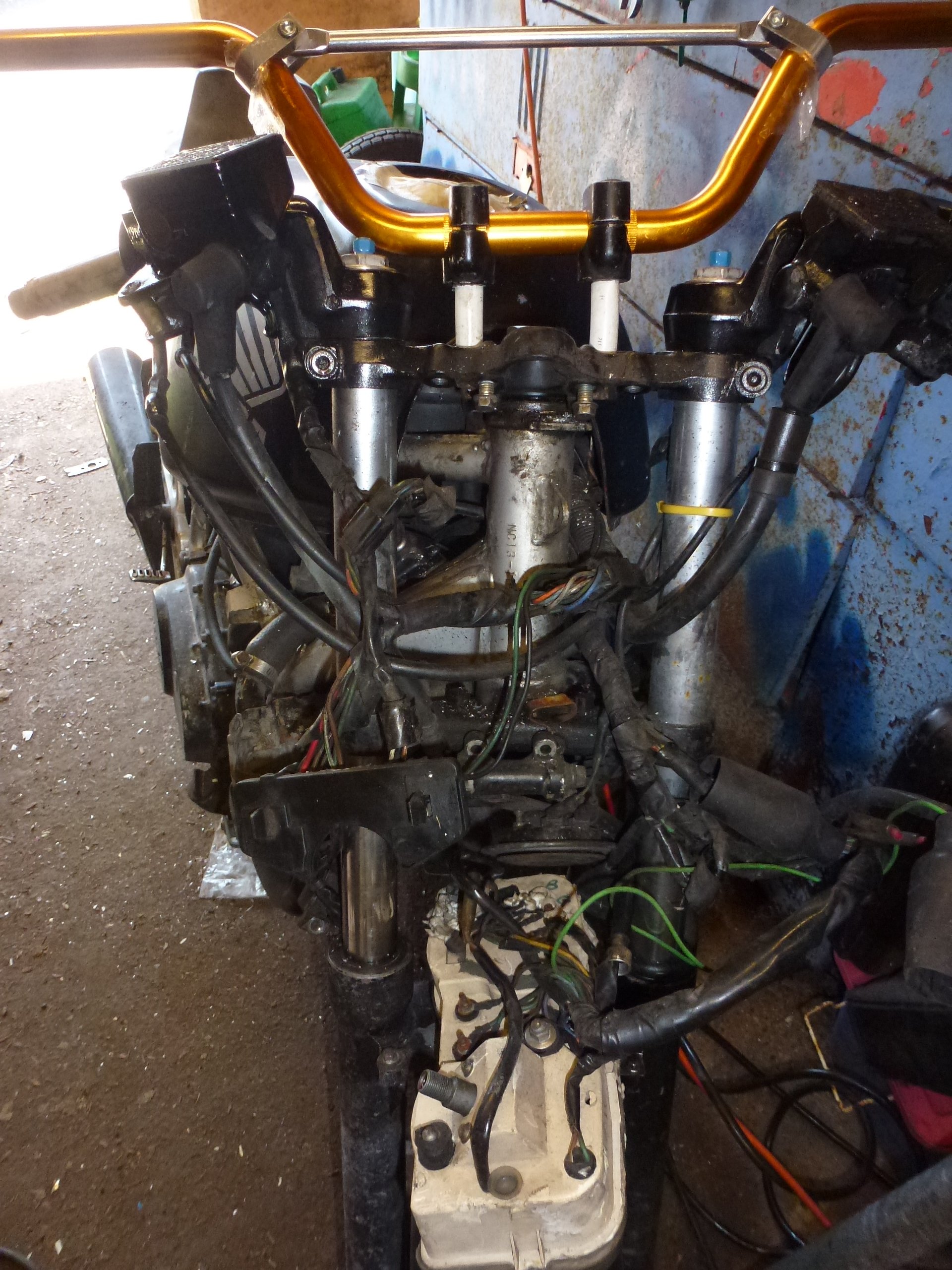

Fortunately it's not a Ducati with the key, ECU and Instruments all matched. Maybe look for a tacho with speedo insert so top speak. Simple single instrument.
I use a TrailTech Vapor because it's small and rectangular(ish) but there are better units out there. Try a dual sport/street scrambler type fairing. I used a plain 8x11 plastic rectangular number plate and changed its shape a little on the Phat Trakka. A little heat and a little bit of trimming and Robert's your mother's brother. Behind that is a small carbon fiber box that some of the electrics hide inside. I used an offcut of a 4x4 inch post as the mold. Cheap, easy and effective for the purpose.
Simple is always best and electrics aren't too daunting. I tend to draw out each circuit on a separate sheet of paper because doing it all at once is more than my brain can process. That way I can see all the safety switches and relays and so on which makes it easier to design a new clean simple loom. Integrating them all later is not too hard.
That VFR reminds me of the wiring mess on my ST3 when I decided to go naked - the bike - not me. Ducati had all that space inside teh bodywork and I had to make it all shrink and disappear. Took a few goes but we got there. For the ignition, you might want to start from scratch and use say an Ignitech TCIP4 with two pickups and dnump the Honda ignitor boxes and related components.

I love Hondas but they use way more wire than you need for the bike to run, just so they can put all the connections in the headlight. You can really clean up a lot by using multiple grounds close to the items that need them etc. and not running everything into and out of the headlight bucket.

My pal Brian chopped some 19mm dia thick wall tube to make up spacers for the BMW bar risers. I'll make up a spreader plate to go under the yoke as it's only about 3/8" thick alloy. There will be considerable additional load put on that area through the bars. Belt and braces.
I finally managed to get the OEM silencers freed off and removed ! Don't think they had ever been off before.
The Lobster tail meggas are spot on - happy.
Hmmmmm - don't like it, lot's of stress going through 2 relatively small areas and the yoke is only 3/8" thick.
Plan B - I'll make up a solid block of alloy to fit the top yoke 40mm thick and drill the mounting holes through, that way the load will be spread evenly across the top of the yoke.
The 5.5" Bates will do nicely and I found a couple of small gauges bought for previous projects.
Cables and hoses will probably have to be lengthened. Fortunately I have dozens of braided hoses from other projects, and maybe the other cables can be re-routed.

Made a little progress on my Flat Tracker project.
Clip ons removed and Renthals [ copy ] mocked up in place.
Clutch side controls are fine and all wiring / hose will reconnect with a bit of juggling the routing under the tank. There's enough spare wiring etc. on the clutch side to tidy all the cables etc. so they're not floating in the breeze - as per the POC pic.
Not so sure about the throttle side, the top brake hose will have to be changed for a longer one and the throttle cables are looking a bit suspect ! However, once the tank is off I can see if they can be re-routed to gain some length. Fortunately I have dozens of braided hoses from previous projects.
I've ordered a block of 40mm x 30mm alloy to make up the bar riser mounts for the renthals [ copy ]. I'm quite happy that will distribute the loads through the top yoke without problems.
