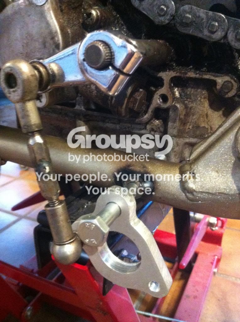

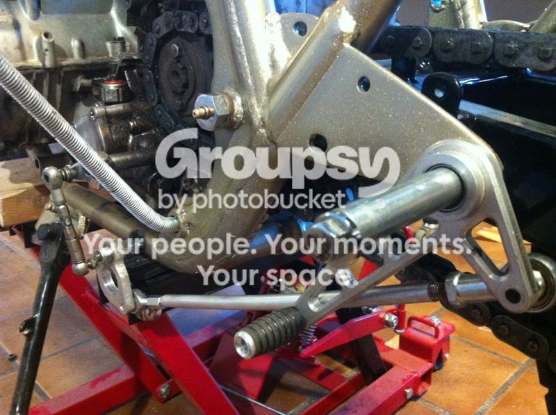

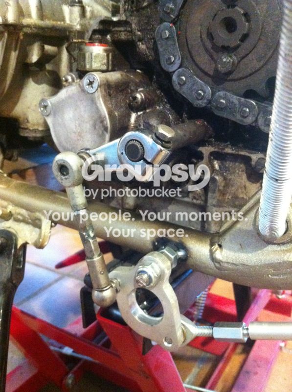

This was actually what I did in the very beginning. There are a few reasons I had to abandon the old lever, first because of the triangle frame suport there was no way to run a direct linkage, having to build an extender just to reach the stock lever, after I tried a few set ups I realized that the only way to link it changed the direction from pull to push (clearly BAD).

This is true but it caused the linkage to bend more than apply the brake when I tried it.
Because you're using the incorrect material for the linkage as someone pointed out earlier. Get some proper stainless rod and your problems will get a whole lot smaller, I bet.
I will check it out as a rod with less flex would work even with the arrangement as it sits now. I thought I had bought stainless but I have been wrong before. I do know that the outer tube is aluminium though.
If the outer tube is alu, your main material is too thin. Now, are you saying you use the rod to push the brake lever? You should only pull on such constructions. Pushing a rod needs a whole beefier system.
It is not push motion at this time it is pull. I tried a push set up and I know that will not work with this rod.
I have been trying to source a stainless rod long enough but have not yet found one locally. I did come up with an idea that may work but I will have to mock it up to see. The brake at least helps in stopping now but I am still working on perfecting it.

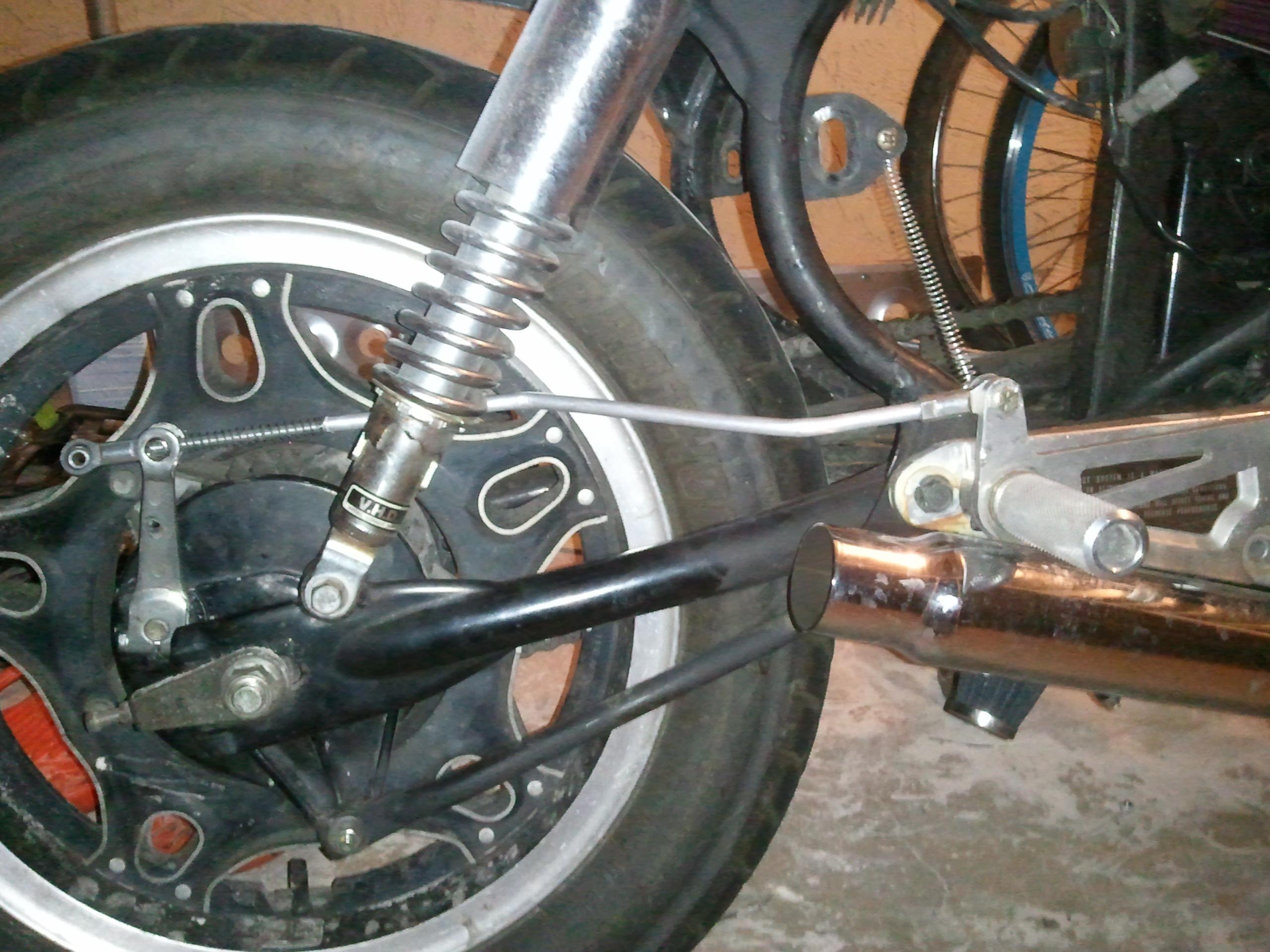

I plan on switching it very soon I will draw up my idea and post it in just a minute so you can see and make any comments on the idea that you have. Do you have any pictures of a good cable set up or a recommendation on how to do that? I have a coworker who worked in a bicycle shop for years and I have asked him about it before but I still need a little more clarification on how to make it work.
well just copy the cable principle and design as used on many vintage hondas cr125m/cr250m elsinores sl350 xl250/350 72-76 era they all had the excact same design and it works ok
you will need to have cable housing anchor at both ends
the front of the cable housing as one with the footpeg bracket the rear cable housing as one with the rear wheel travel
most time it is a boss on the brake backing plate
you will need a super beafy cable not like a bicycle or even front brake cable
i would just get one for a 72-75 xl250/350 and build around it
using that you are gonna have a cable with a pretty large arc to it but you wont find a real short heavy one anyway and short and straight with a sheathed cable will have travel issues anyway
as in the same TYPE of issue but different hahahaah
