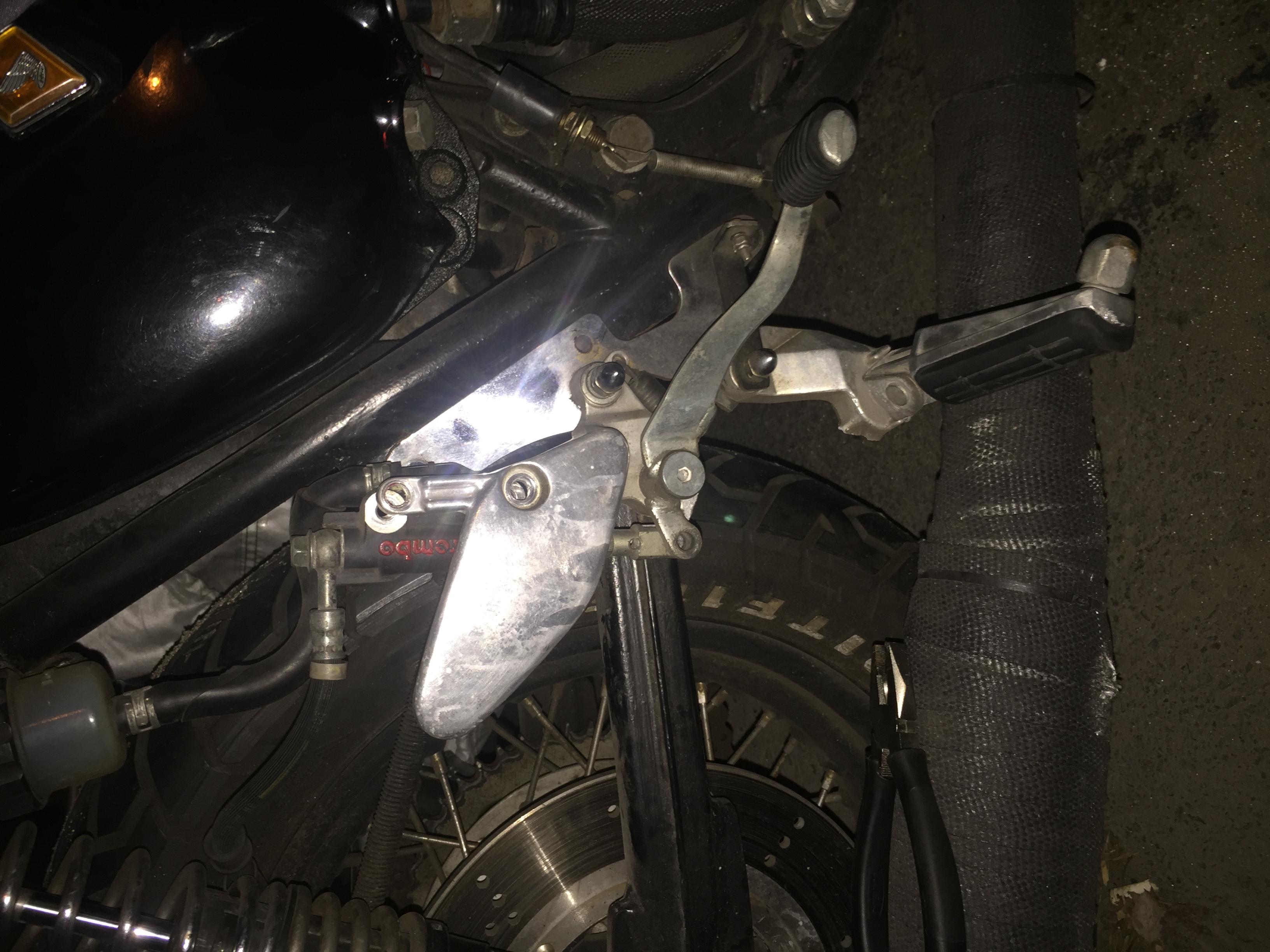

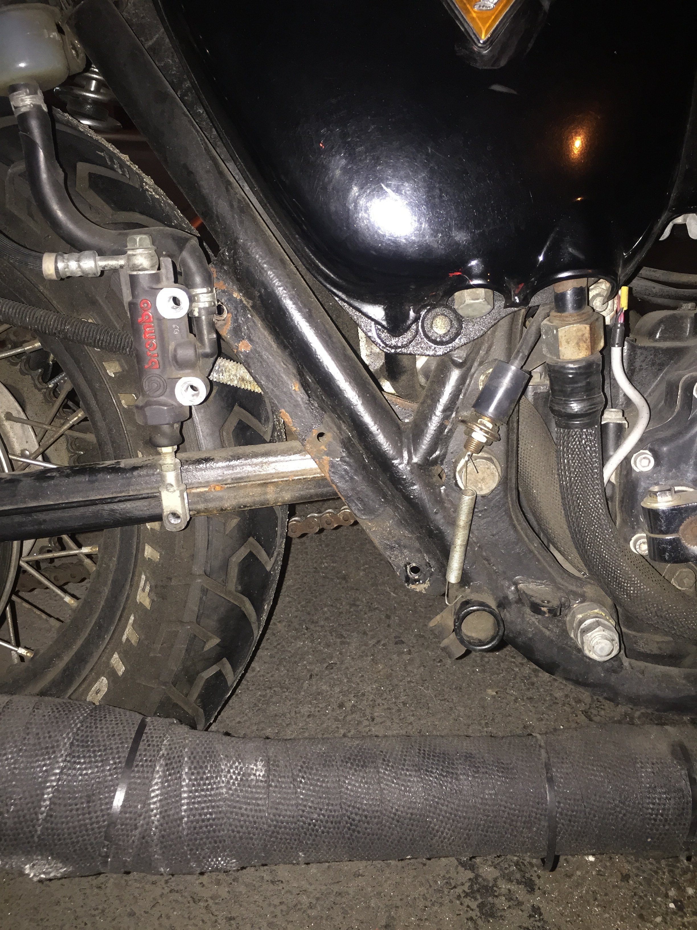

I have attached three photos below. The guys I bought this bike from installed a custom rearset bracket that was kind of janky and clunky. The other day the right peg was shorn off when someone hit it parking too close to me.

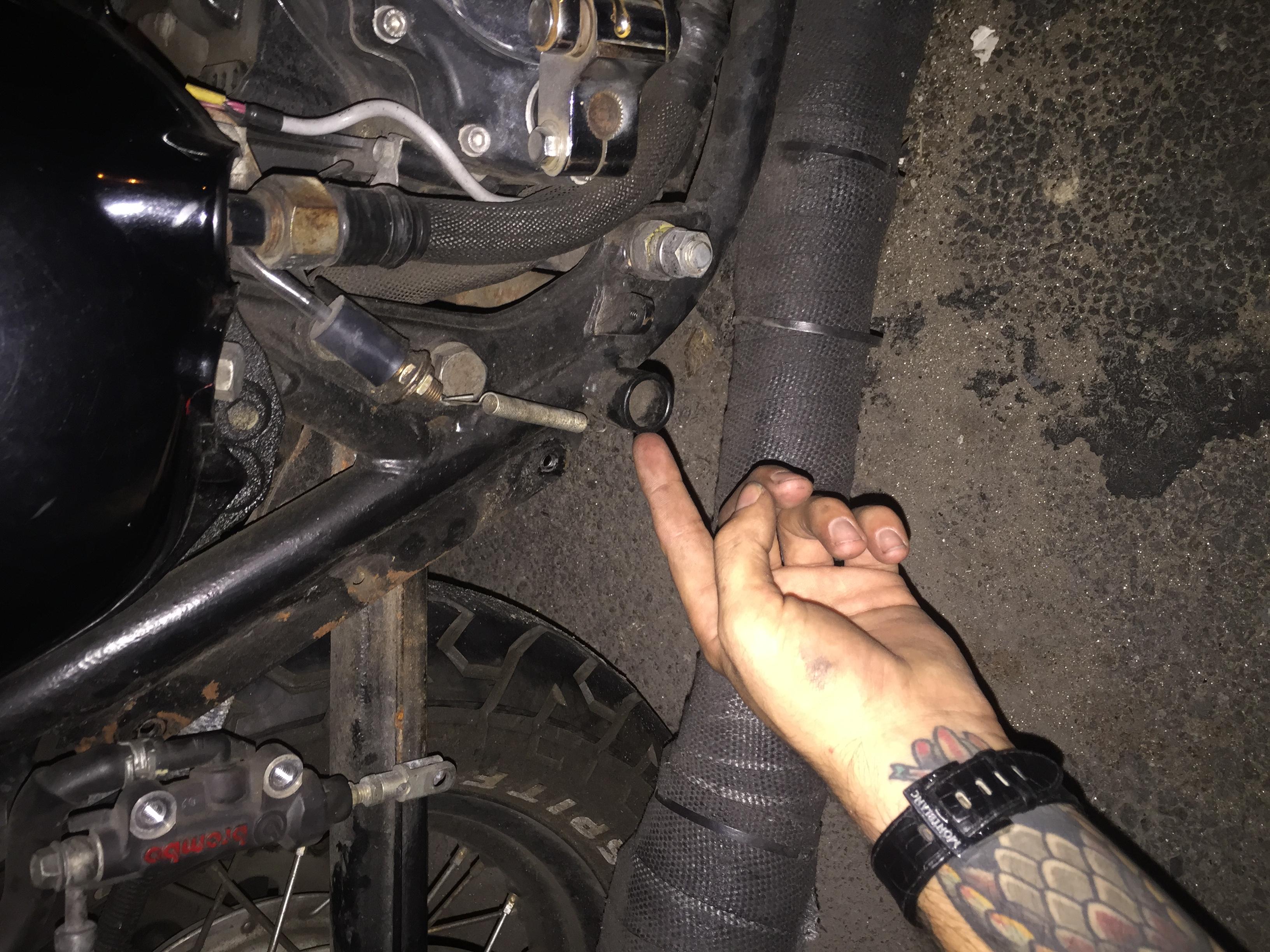

I took off the existing bracket and intended to replace it with this (http://cognitomoto.com/collections/rearsets/products/cb750f-rearset-brackets-gsxr-master-cylinder-conversion), but I ran into an issue mounting the right bracket as it hits the frame where I am pointing.
In your opinion, whats the move? I like the bracket and it will work with the master cylinder, just doesn't fit the frame as it is.

What year / model is the 750, just so we're all on the same page. I'm guessing that is just a tube welded to the frame to hold a rubber mounted exhaust hanger or something. Looks like you'd need to just trim a bit of it off to allow the bracket to sit flush, or put a spacer (washers) between the new bracket and frame. It looks like the Cognito brackets use the engine mounting bolts?

I figured it might be a matter of grinding that off but wanted to get a second opinion before I started choppin and grindin.

That's the tube where the original brake lever assembly would rotate. No need for it if you're not putting the original brake setup back on.
