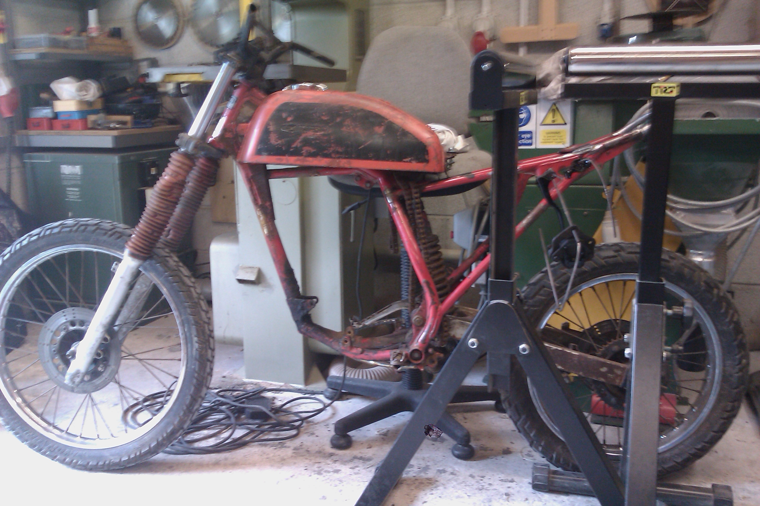

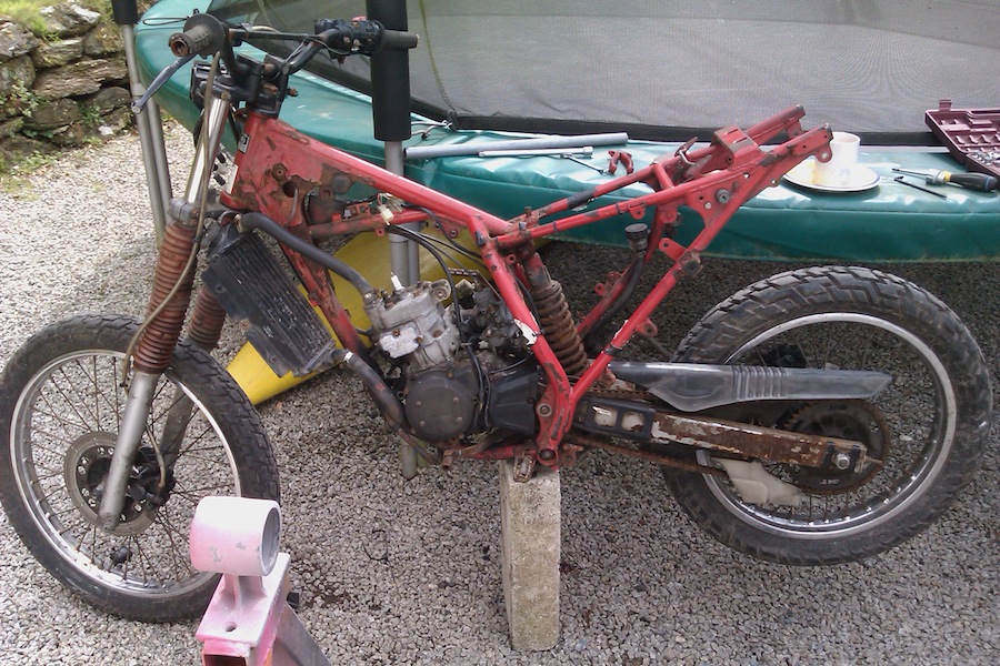

So after a few false starts at projects, this is the first one that looks like it's going to be finished.
Having pulled a kmx 125 from a hedge years ago, and recently being given a crash damaged rxs 100, i decided to make something that'll hopefully resemble a scrambler when finished.
i've got a few photo's from the start, and i'll post some current ones soon but i haven't taken any other photos during building up until now.
I'm 18, with no motorcycle training and no help building, just access to tools and a lot of enthusiasm...

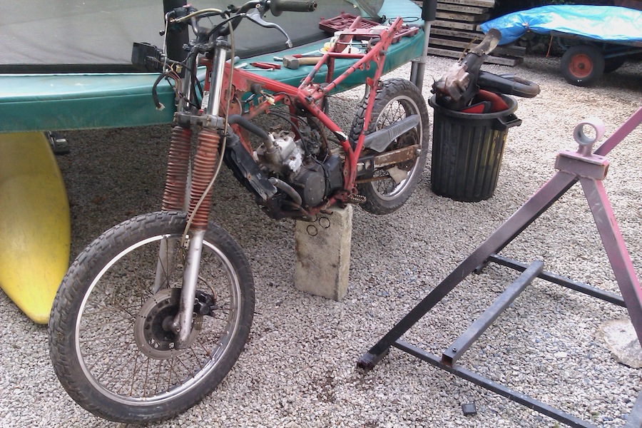

Some more photo's of the stripping down process.

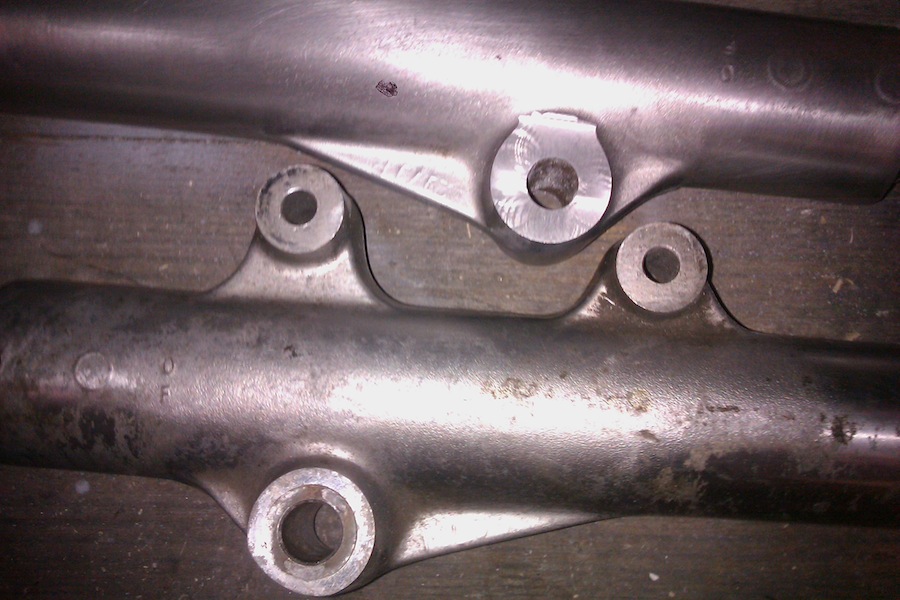

milling some dr125 forks out slightly to take the kmx front wheel using a 2 axis vise on a pillar drill.

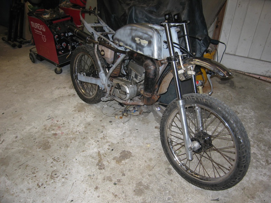

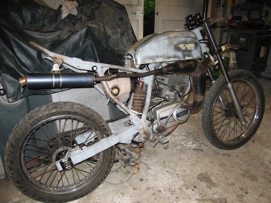

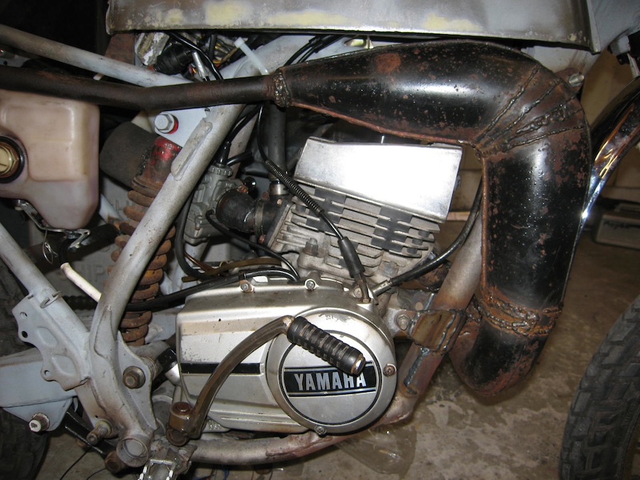

so, i've done alot of work since the last photos, but took none in the process.
Here's how it is currently, engine in, driving along but no brakes, mudguards or anything cosmetic as yet apart from a seat which i'm attempting to sew this evening.
