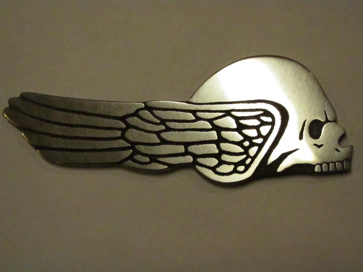

Sand cast tank emblems
Jesse Lee
Those are BAD ASS! I would love a set but yes at 73 big ones that is quite a ways out of my price zone ;) . LOL they look amazing though.
JR
WOW, those things are really really cool. You did a super job.
My bike is way too cheesey now. Without the addition of scary skulls.
Im sure you will have no problem selling a million of those.
We have some pretty amazing artists on DTT.
But those are definitely one of the neatest things Ive seen on here.
Your design is superb. and they came out beautiful in the pewter.
Nice work, and not the least bit overpriced, IMO. I am not a fan of skulls in general, or any other of the many cliches associated with motorcycles, but I encourage you to try more designs with this technique.
Really nice work. We have somewhat lost this neat technique and it is good to see it being continued!
The price is very fair.
Wow... I didn't expect to see so many replies and such a positive response, thanks for all the kudos... I thought I might get grief for my price more than anything ;D I know it's asking enough and I'd love to be able to offer these for less money, but for the amount of time that's invested in them it just wouldn't be worth while. As far as this particular design goes, I thought it was "cool", but truth be told, they're not my personal style either. Making these is not about what I like though, it's about putting food on the table ;)
I think the next one's I'll do will be something like this:
What say you? Yea or nay? ;)
