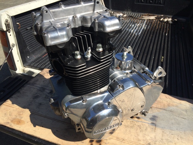

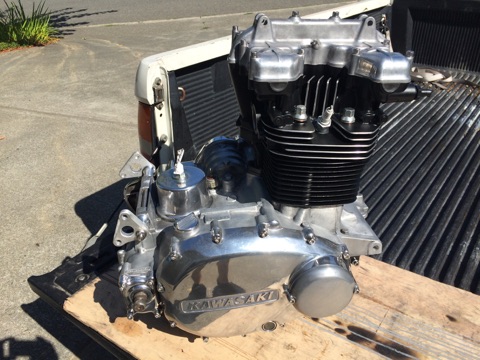

Cases are polished, I painted the jugs and head and cleaned up the fins. Couple things left to polish before its done. Any suggestions on replacements for wire clamps that go under the case bolts?
Maybe a P clamp? Come in a heap of different sizes and materials.
Also, engine looks rad dude.

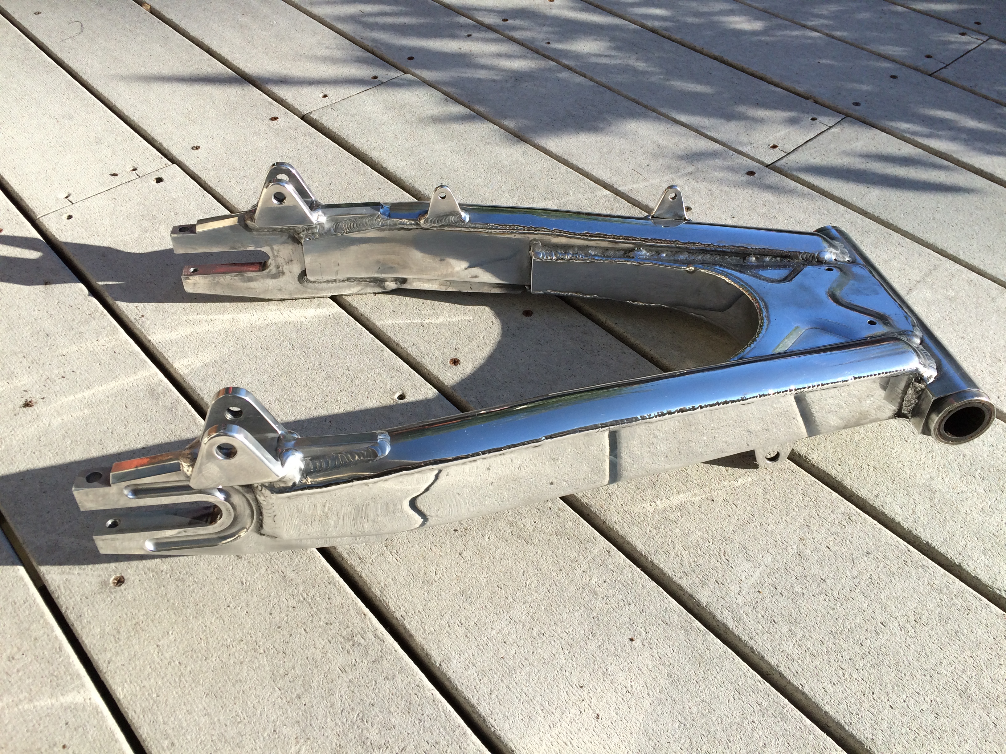

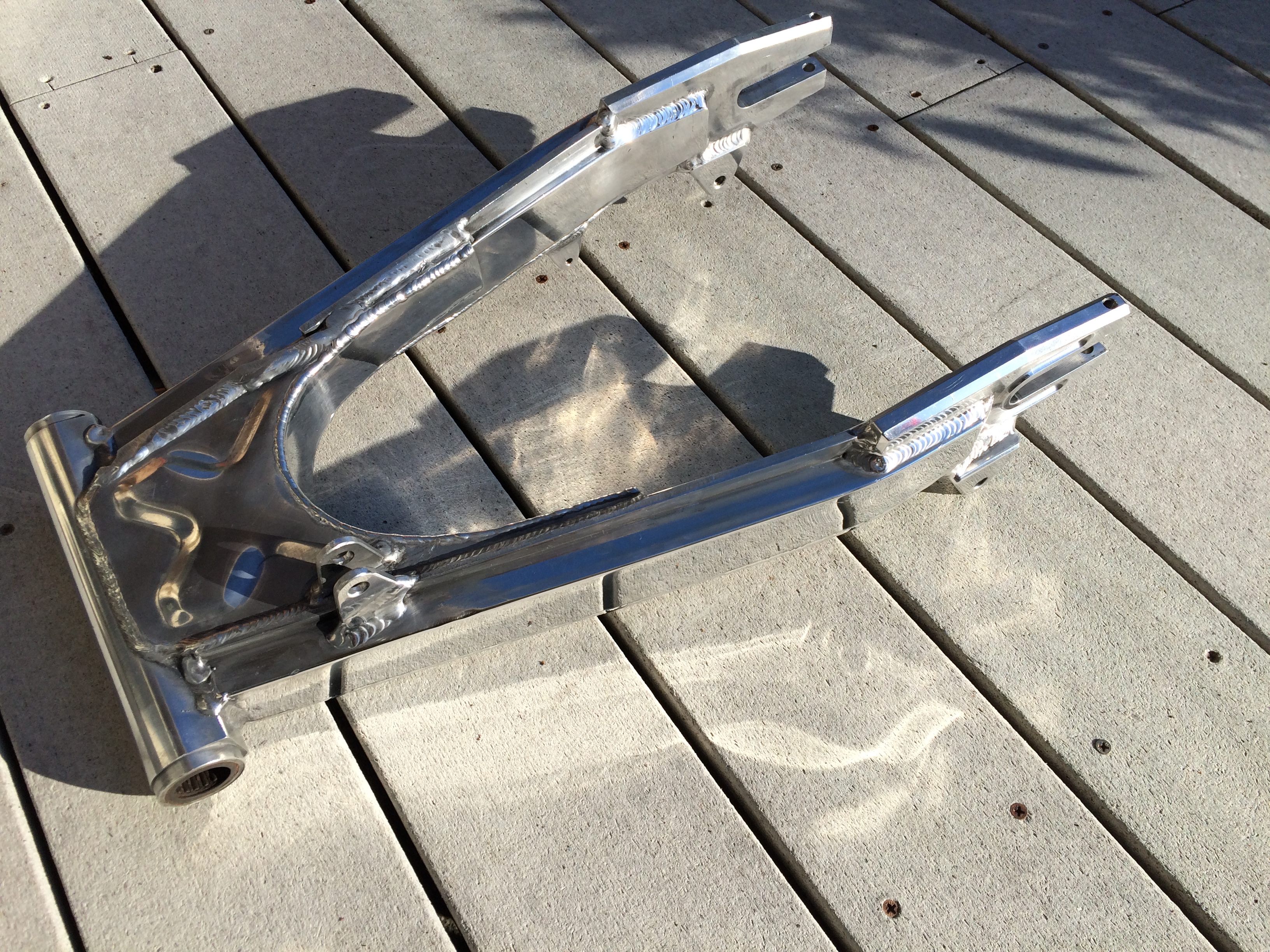

I'm no engineer but I've read than heating and welding aluminum takes the temper out of it.
I think 6061 in the annealed state has a rather low yield strength.
What do you think?
I appreciate the concern. Yes, 6061 does loose its temper when welded. I am planning on doing some artificial aging to help return some of the strength. I am aware that this is less than ideal, however, I am not terribly worried because the early aluminum swing-arms from Suzuki were not heat treated post weld (this is off a '82 GS1100). Furthermore, Its fairly common practice to lengthen aluminum swing-arms and no one heat treats. The guy that did the welding has done loads of aluminum swing-arm mods over the years and has never had an issue. Once I start riding the bike I will be scrutinizing the welds for cracks. If any cracks appear I will probably build a new swing-arm from scratch so I can use the appropriate filler rod so it can be heat treated. In retrospect I should have done that in the first place, as it wouldn't have cost me much more money but it would have been substantially more time.
