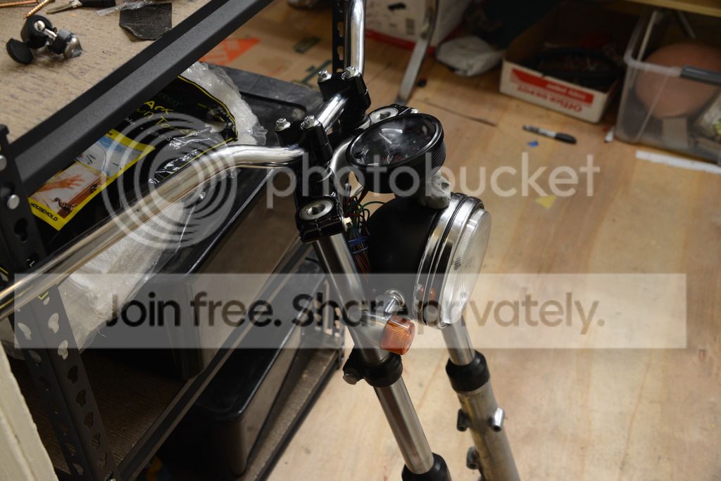

Im gonna use this 63-74 sportster headlight with a custom composite bucket that i originally made for my 1000 project. I am kinda digging the old school diffuser but if i go HID or LED i will use the clear lens. I think the screws at the bottom of the rings are kinda crude. Any suggestions to make it looks a bit cooler? I was thinking about some type of clamp or something.
I just mocked it up real quick so i can start brainstorming ideas on how i want to tie this all together.

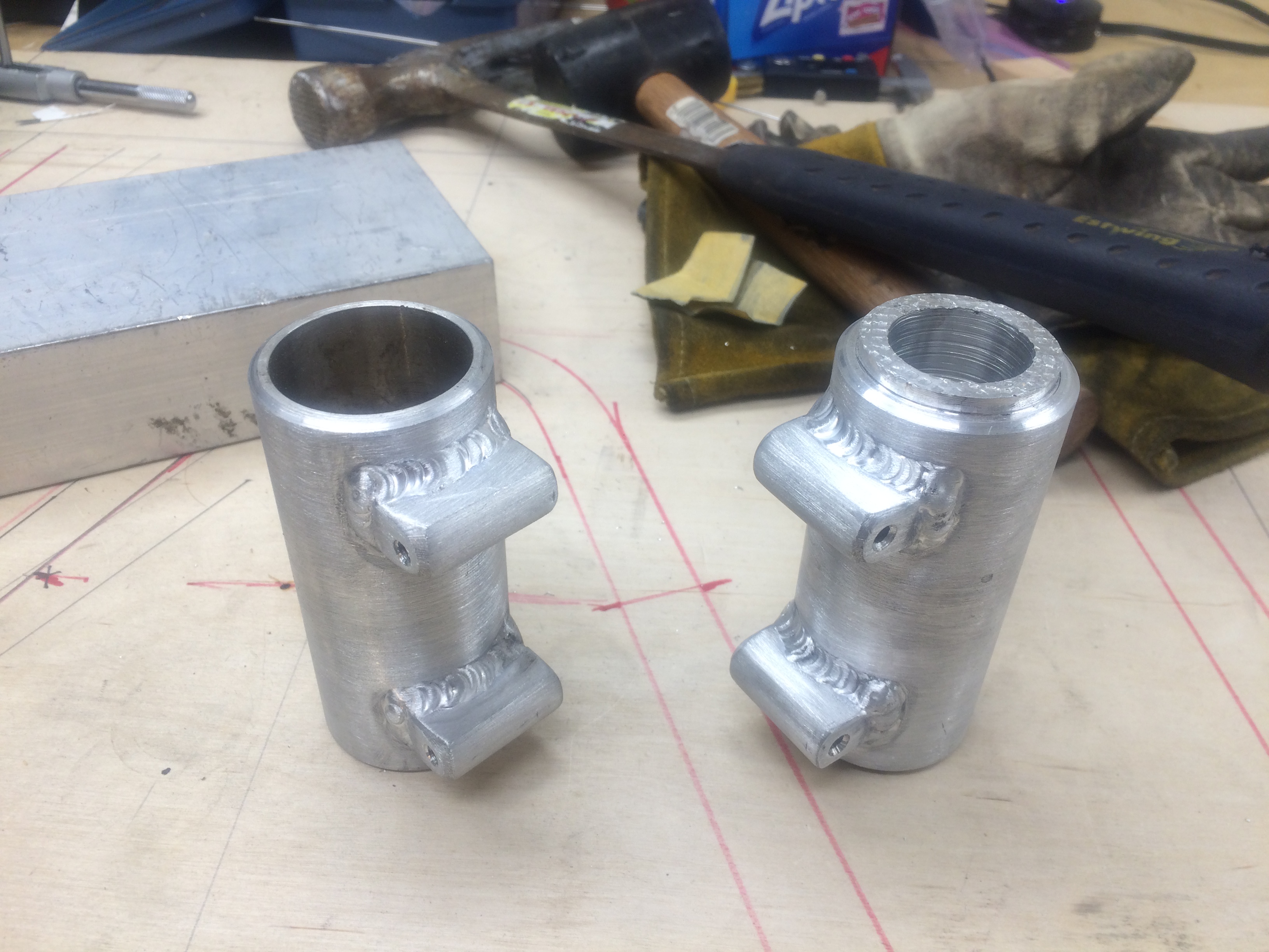

Started working on the headlight ears by machining up these bits and welding em up. I made a sleeve out of aluminum to keep the tubes from going out of round while welding. now it's clear should have used steel for the sleeve because its stuck in the second. I'm going to slit them tomorrow on the mill and will cut through the sleeve too, hopefully that will help me get the sleeve out.

The Eastwing only made it tighter. Weld a thick plug to the end with waffle marks and drive it out with a wood dowel from the inside, I would go into why but it just is always better to extract press fit aluminum rather than push it.
For the same reason I always tap the inside of valve guides, thread a bolt in and press the bolt surface to extract them... never galls the head or leaves aluminum on the guide ;)
Yup. The aluminum mushrooms easily. CRC freeze off might help too. Shrink the aluminum to get it out.

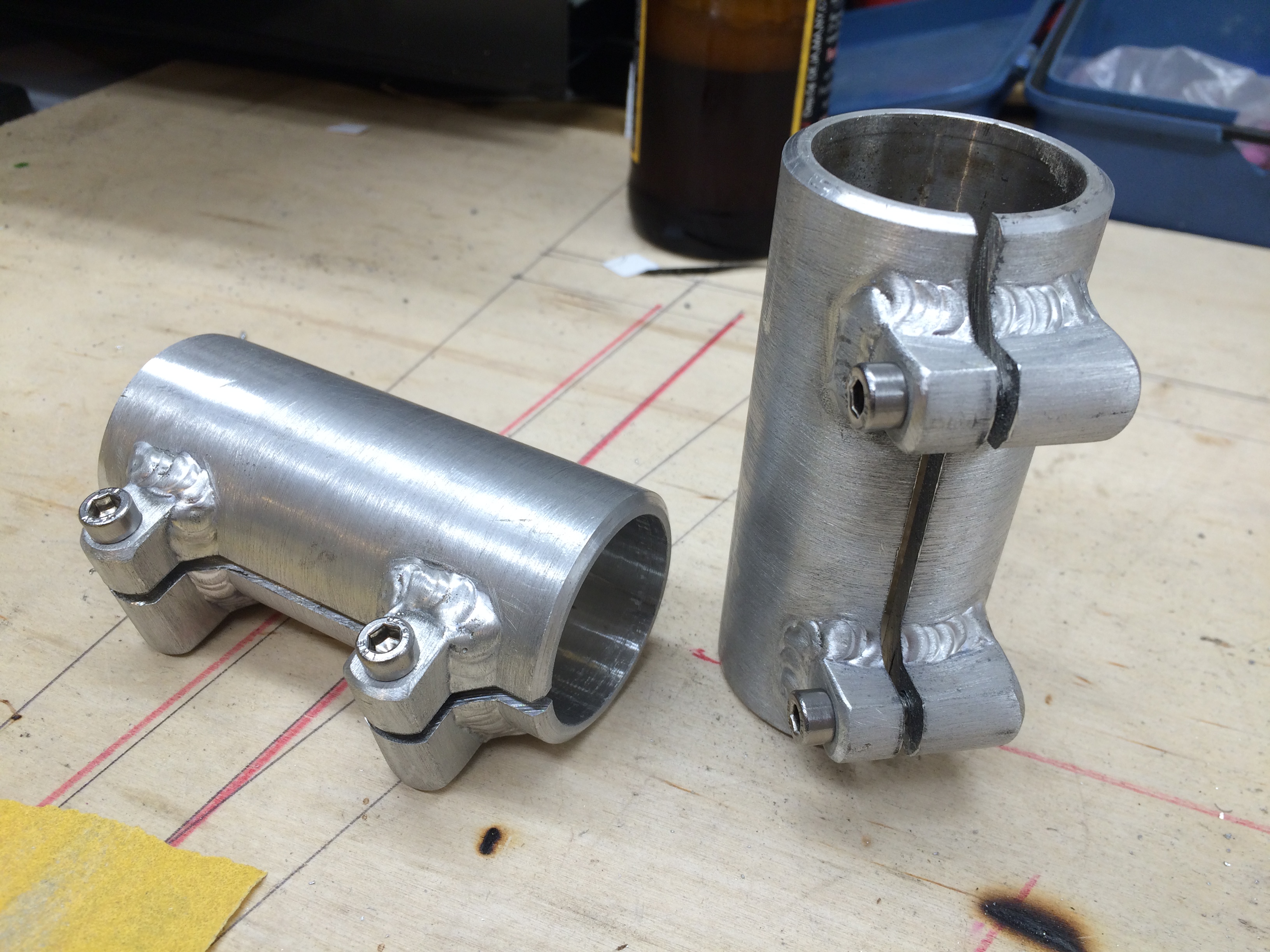

thanks for the tips guys, that was a dumbass move on my part hammering the end. I ended up welding the end up like a coil pot to try and help shrink it down. the sleeve came out with some pounding, after slitting, but it galled some parts of the tube. I dressed it up and they mount great. Never done a slitting operation on the mill before. VERY satisfying. Now that these are finished I can start doing some prototyping.

the only bummer about doing the tach/headlight combo is there is no logical place to put this oil light. any suggestions?
The gauge has 3 idiot lights but they are all pretty small. If this oil light is coming on I want to notice it right away. I was thinking it might be possible to have the gauge back light flash or something but I have no clue on how to do that.
