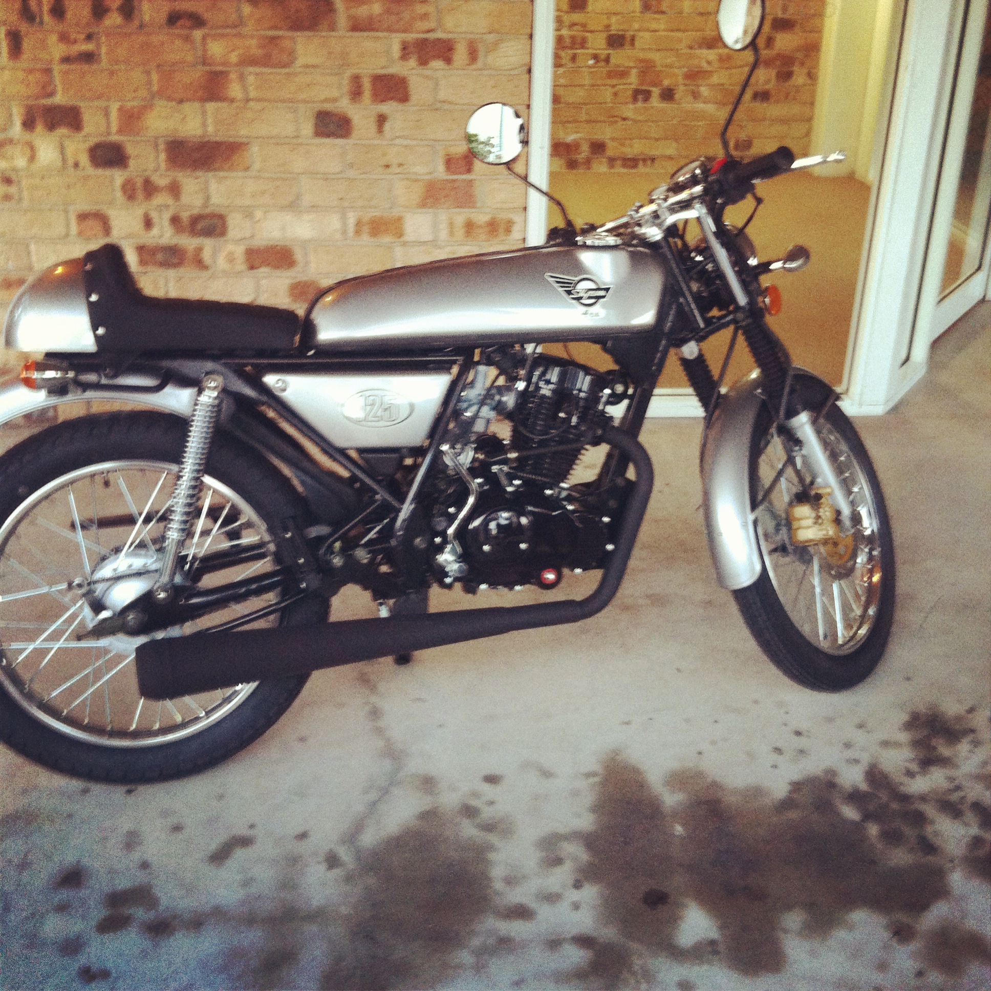

Thanks for replying. Trolled through some of the other threads on the Skyteam resource; there is much to think about in terms of modifications. Especially evolving it from a Learner/Provisional bike to a cafe racer to be reckoned with.
Living in Wollongong. Got my Ace from the good people at Motociclo in St Peters, Sydney
Mine is same spec. Just waiting for a few mods to be completed and compliance/wof.
I see you ended up with the rear adjustable shocks. I, and a few other black ace owners, seem to have got those. It seems red Ace owners got the non adjustable shocks with a chrome shroud and lots of them replaced the shocks with better ones. Will be interesting to see how ours go.
