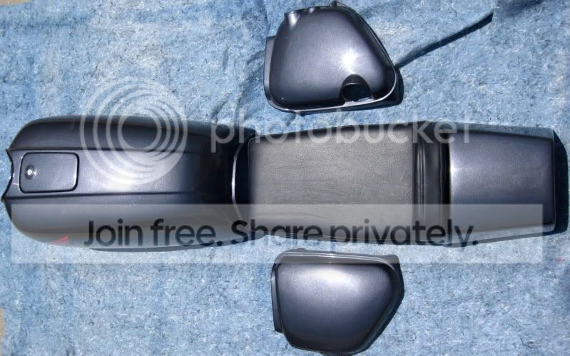

I mocked it up with a stock tank and new cafe tail. Just to get a feel for where it was headed.

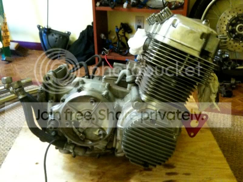

Then it was time to get the motor cleaned up.
I know you guys wouldn't recommend power washing the motor... :-\ but I sealed it up, sprayed it down with aircraft remover and blasted the hell out of it....worked like a charm.

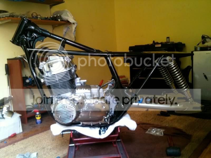

Time to put the motor back in the frame. I did the old "lay it on its side and drop the frame on top down" method...easy cheezy!!
Ok...what I haven't told you yet is that I had the swingarm powdercoated in this awesome "chrome" color...it came out perfect. The swingarm is gonna be a really nice accent to the bike when it all done.

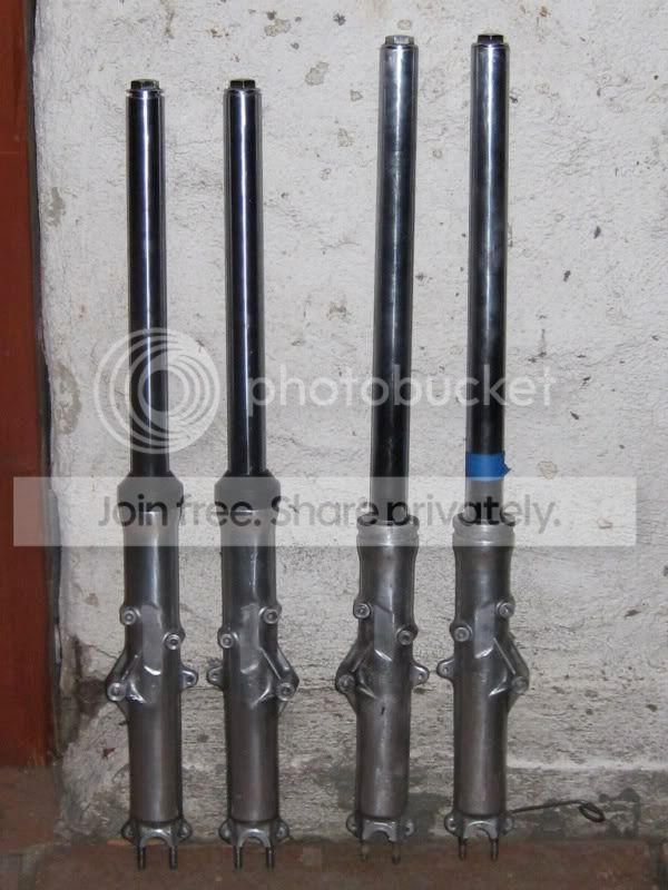

I was rebuilding my 1978 CB550 front forks. YES...you read that correctly. I'll explain later.
But this one fork seal was giving me a lot more trouble than usual. I beat the hell out of it from every angle but it would NOT come loose.
So then I boiled the fork lower (cuz elquenada told me to, thanks!) and it came out with a 10th the effort I'd already put into it. No problem!
So I mentioned above that I was rebuilding my 1978 CB550 forks. Well...I am swapping in those forks because as you can seen they are 1.5" shorter. So now I don't of have to drop my fork tubes into the triple tree to lower the front end, which looks sloppy in my opinion. Now it will be a clean look on the top triple tree but still be 1.5" lower, too!
AND the dual disc caliper mounting points match up so no disc brake swap necessary!

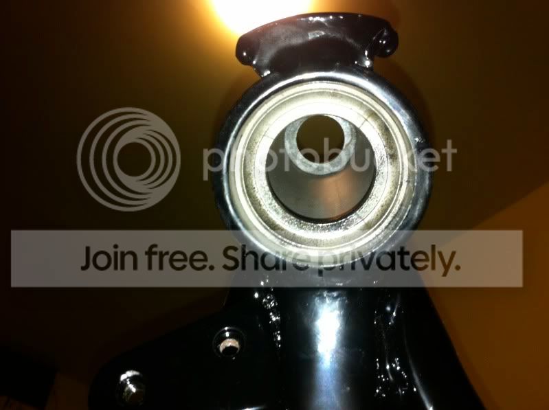

I purchased the PartsNMore.com STEERING BEARING KIT, Part#28-2011. It seems easy enough to install and I've identified the pieces that need to be removed from my Frame Neck and Triple Tree Stem in order to reinstall the new tapered bearings.
Here are pics of what needs to be removed. BUT I need some advise on HOW to remove the top and bottom bearing cups and triple tree bearing cone.
1. Top Bearing Cup seems like it is a separate piece that is merely seated in the neck.
2. Bottom Bearing Cup also seems to be a separate piece seated in the neck.
3 Triple Tree Bearing Cone at base of stem. Removal tips??
The "Blind Hole Bearing Puller Tool" got both cups out in under 5 minutes. Best removal tool ever invented!! Auto Zone has a "loan out" program...in case anyone doesn't know...you just pay for the tool, use it and return it...NO CHARGE TO YOU.
The Triple Tree Bearing Cone at base of stem was a little harder but the Dremel and a hard metal cutter bit...took about 15 minutes to cut it off.
So then I just tapped in the new cups for the tapered bearings into the neck (top and bottom). And then tapped the new bearing cone onto the base of the Triple Tree Stem, gave it some grease and bolted it up...

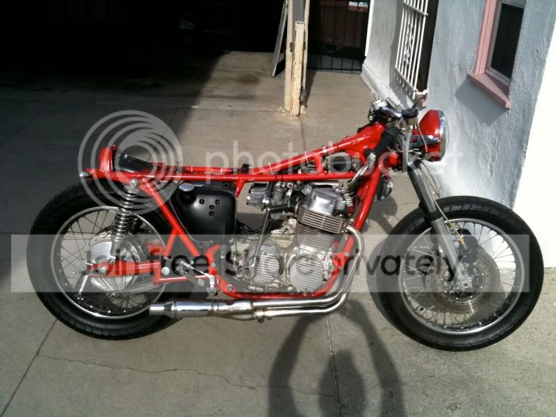

So I scored a sweet pair of old Harley rims (both 2.5 X 18) from Hoosier Tom. Thanks, Tom!!
The part # in case anyone wants it...
But FINALLY!! After re-angling the nipple holes for the rear rim, powder coat and lacing up a fresh set of Buchanan spokes...here you go! Next up is a set of Coker - 2" White Wall - 400 tires...gonna be SICK!

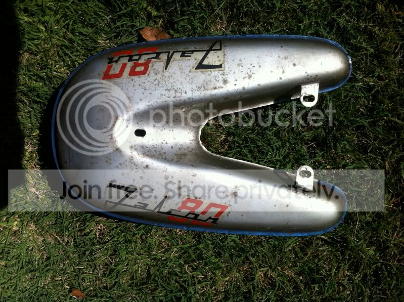

I was rummaging around at The Garage Company and found some old "tank" type thing. Didn't know at the time what it was...but now know it to be some part of a 1964 Ducati Super Falcon 80. But its gonna make a SWEET oil tank for my CB750. Mmuuuaaahaaahahahaha!!!
1.
2.
3.

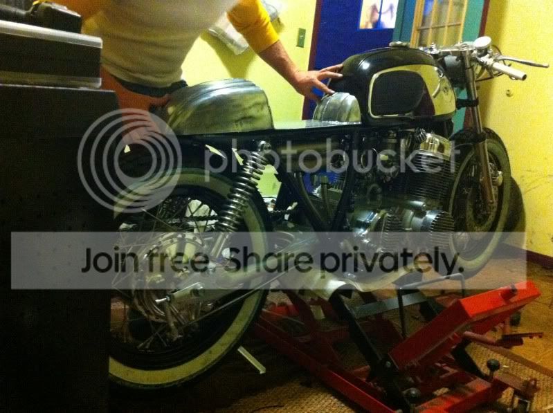

So then I took them home and mocked up the bike just to get a taste of where its headed. Also grabbed the stock tank and a spare cafe tail section I have laying around. However, I'll be doing a completely custom tank and tail section later...but you can get a sneak peak at something close to what it will become. Looks a little "tall" because the bike will come down about 3" once the wheels are actually mounted...but you get the idea.
I mocked it up with the oil tank and actual ride height. Looks a lot better in the lower stance....
but I think I will be mounting the oil tank up directly to the frame under the seat....dunno yet.

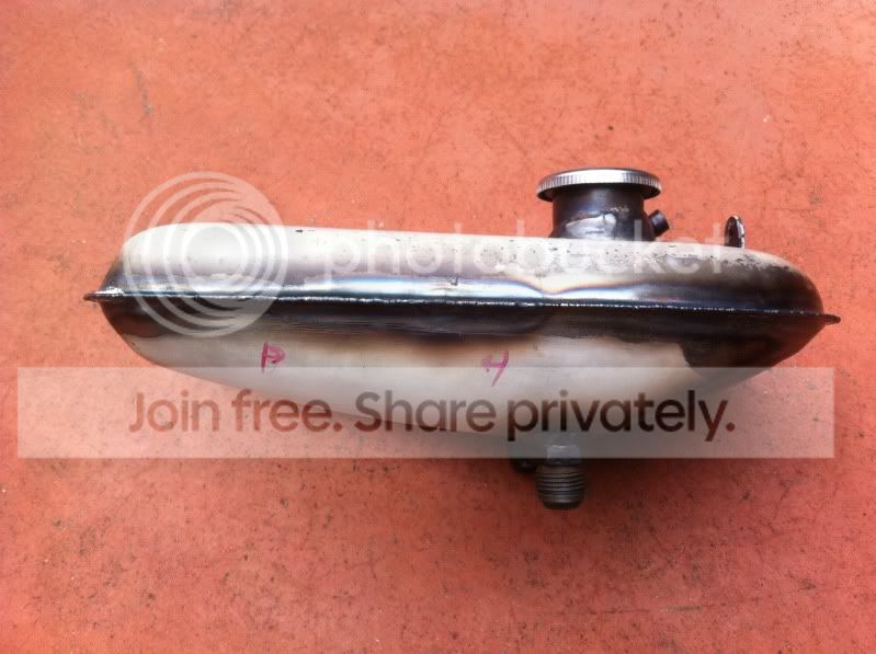

My friend Aaron took this and fab'ed it for me. It's gonna get polished but look at the great work he did to turn it into a bolt up oil tank...

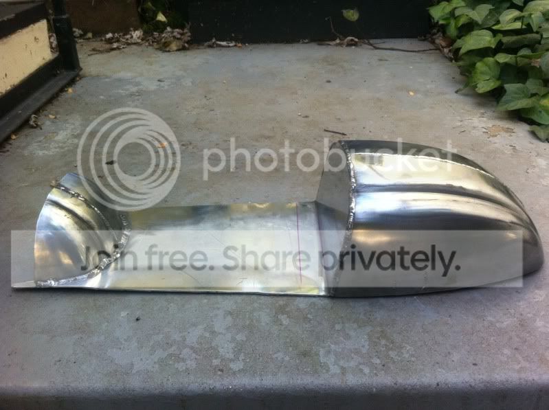

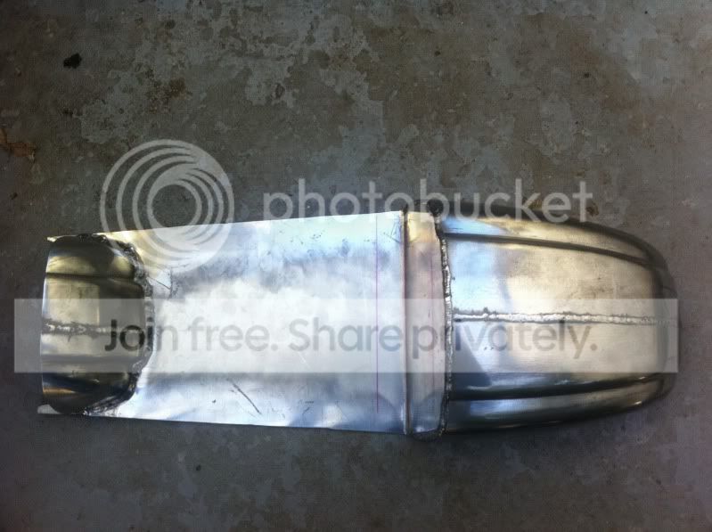

I fabbed this tank to fit the cb750 frame. And now its on to fabbing the tail. It is being made out of a custom alloy piece to flow with lines of the Black Bomber tank. Its gonna be amazing...IMHO. Take a look...but disregard the paint job...it was just for mock up...will be polished alloy / paint combo.
1.
2.
3.
4.
I got my tail finished...still needs more polish and a couple tweaks...but it's beautiful!! IMHO...
And it looks great with stock tank too...

I'm mounting my oil tank today before I have it chromed. Still have to tweak the mounting points to get it level.

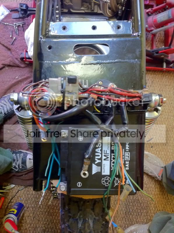

Had a WIRED WEEKEND!! My brother came into town and we spent the weekend hold up in the garage wiring my bike. It turned out pretty badass!! Here's a recap...
I studied the existing wiring harness before beginning.
And the tail mount plans begin... Did some light fabbing to the original mounting bracket to fit on the tail section.
New R/R unit and Solenoid...but kept the original fuse box just cuz...mounted up perfectly.
3am...too buzzed to solder.
Drilled a 1.5" hole w/ rubber grommet to run wires out of the rear section.
At little birdie decided to land on the floor of the garage at our feet...hung out for a while and then disappeared.
The tail section all finished...moving foward...
Under the tank...forgot to get a pic of it all harnessed up...
Getting everything into the headlight bucket.
Fitting the tail section over the electrical.
Fitting the headlight.
Haven't mounted the lights yet...but tested the system and no problems. Can't test charging system till I get it running.
Fuel lines and exhaust...then I'll start it up!!

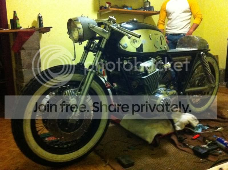

Just had to put it all together to see it before sending the headlight, gas tank, and oil tank out for paint...
