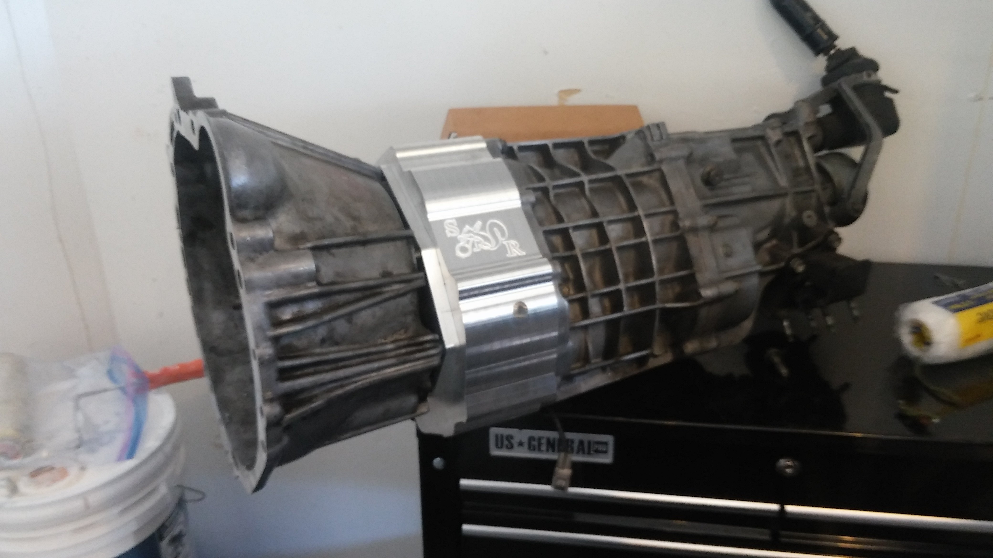

So this spitfire started out stock, pickes it up cheap because it sat for over 20 years. Drove it a few months stock, then ripped the drivetrain out for an upgrade. Swapped in a toyota 4age with a t50 from an ae86 corolla. After a little while I pulled off the stock intake and threw a set of ITBs on it with a megasquirt 2 ecu and 2jz waste spark coils. It is still like this getting 30mpg, I have plans to add a ms2x set up and go full sequential with lq9 coils on the plugs. And if I quit being lazy I made an adapter to put an AZ6 6speed manual behind the 4age.

Probably won't be many changes for a while. I've got over 10k miles on the swap, probably 7k of that with the megasquirt. I have the parts to build a pretty hot engine for it, 12-1 compression, 288 cams, forged pistons and rods, upgrade oil pump, valve springs. I've had the parts about a year, but either life or other projects have distracted me.

Ah a spit6, a car triumph should have made. I chose to go with the toyota engine mostly because I have a dislike of carbs. Especially carbs like the SU's. I shouldn't need to add oil to carbs, rebalance every oil change, and sometimes stop and get out to manually turn the choke off. EFI, is surprisingly simple once you understand it. The megasquirt I'm running was a kit, so I soldered it all together myself and learned to tune it myself. Next up my bike will get a microsquirt.

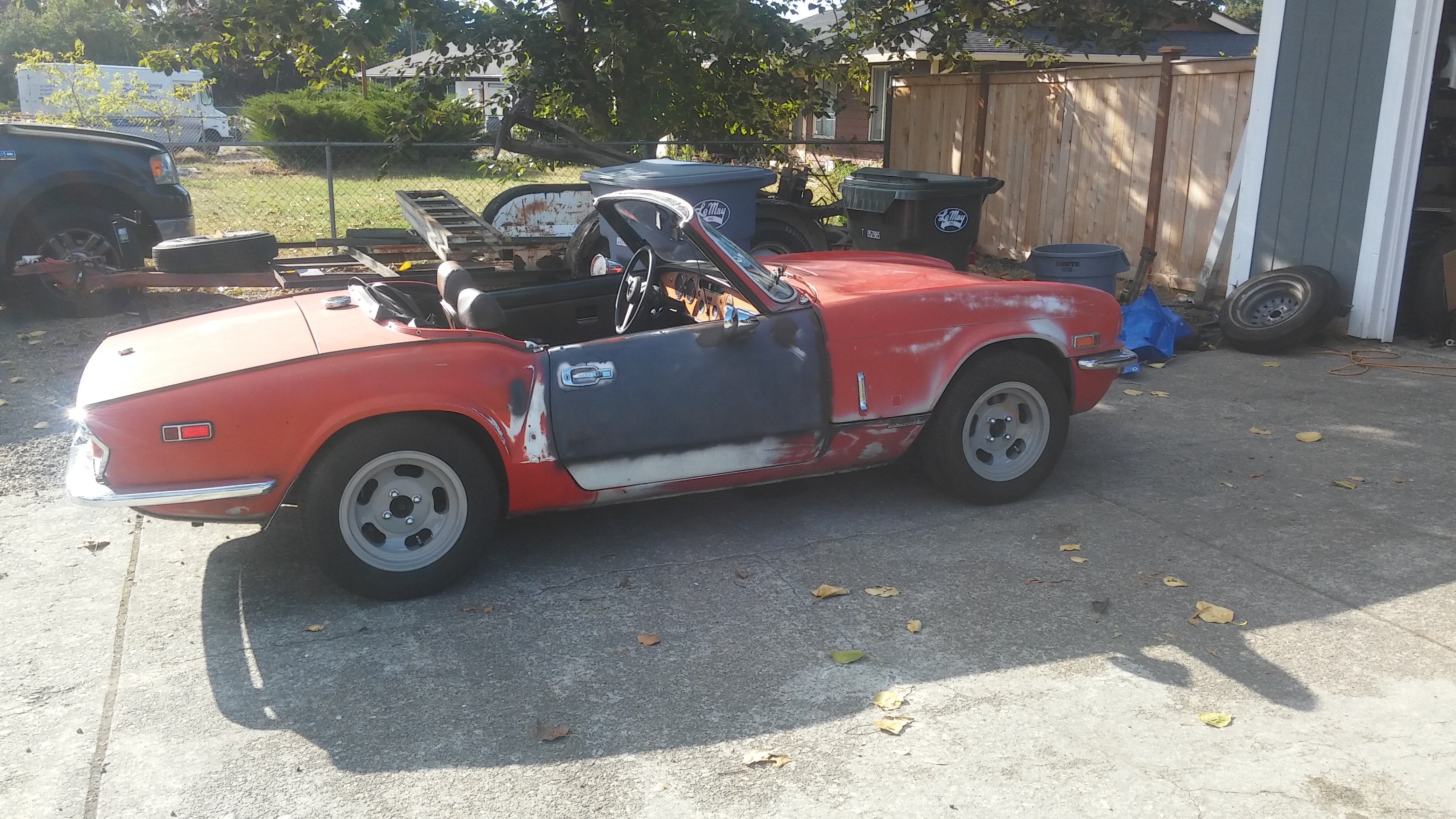

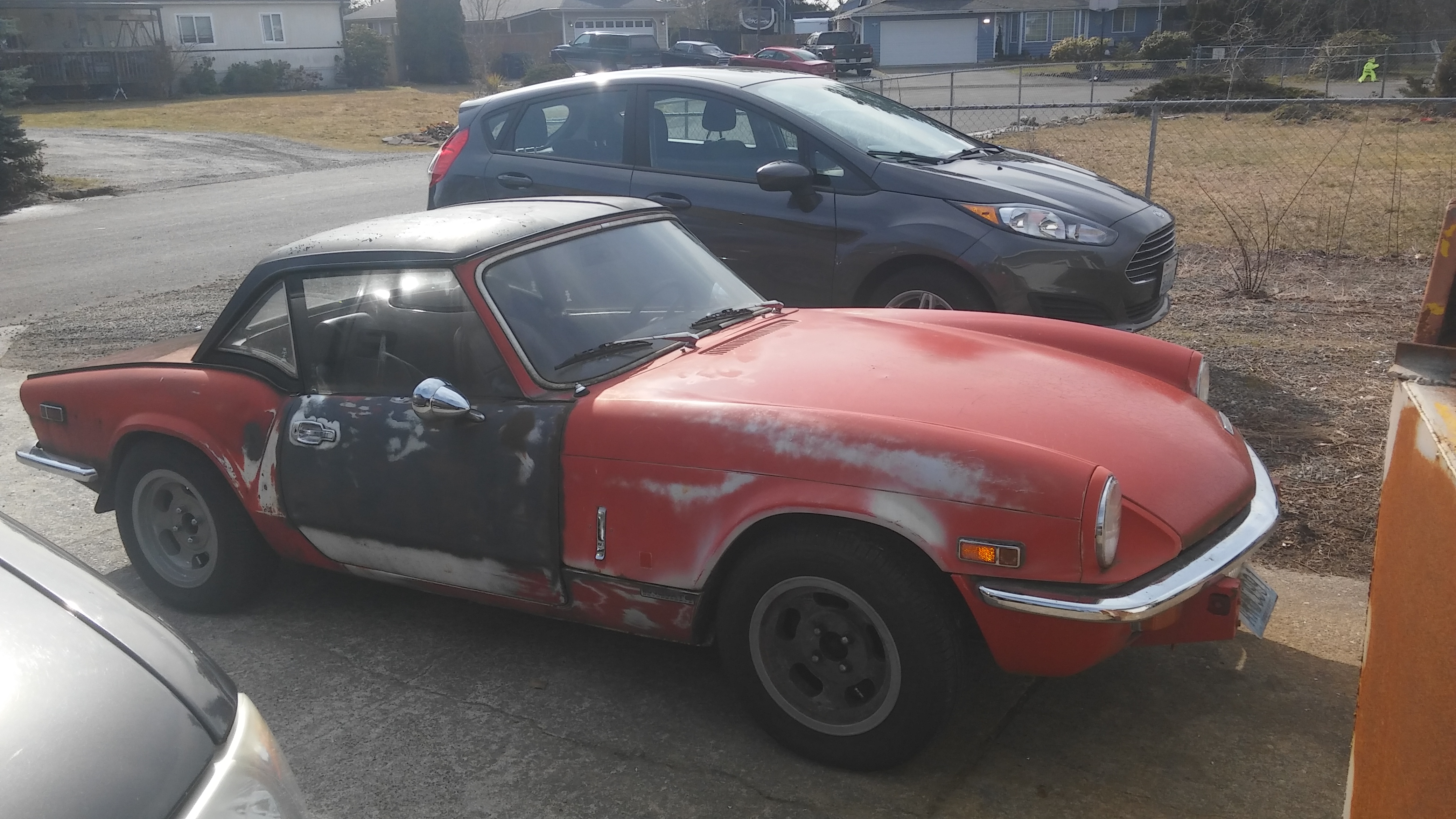

Well this car sat for about a year. I came home one day and the driver door was open and a hoodie was missing from inside the car, so it got moved to a more secure spot. And a more secure spot made it a hassle to get out when I could just jump in the truck.
So I pulled it out and started cleaning it up and tuning it up to get ready to sell it. First was a new battery and battery cables, the $12 pick n pull battery gave up after only 5 years. The original intake is back on as the ITBs on a basically stock engine look cool, but hurt driveability. And finally for today was an oil change. It'll get another oil change in a week since it sat so long.
Over the next week or 2 I will be cleaning up the wiring some, cleaning the car in general, and retuning it to run speed density unsteady of alphaN. Once it's clean and ready it'll go on craigslist.
