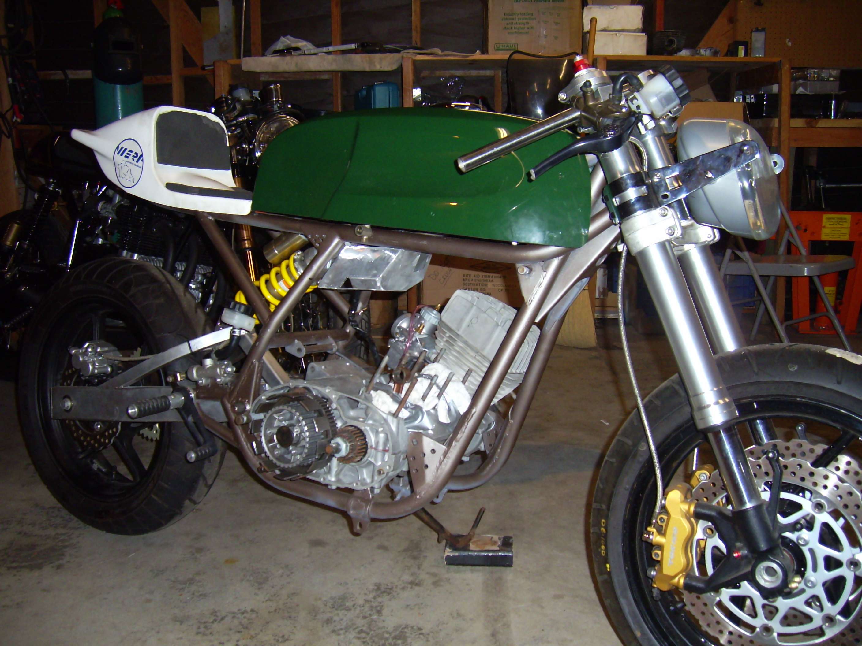

This brings me to where it sits now. Still have alot of to do to the frame before I get it powdered.
As for the engine, it is a stage II with reeds and new pistons. I also rebuilt the crank and put in all new stuff when I had it apart. Carbs are 34 mikunis, and as you can tell I still need to get it back together.

The last few pics of of the aluminum oil tank that I welded up today. Unfortunatley, it came out looking too much like a damn spaceship. My original design looked better, but only held about 1 quart, so I added some space, but don't really like how it came out. Let me know if you can think of a better place to put/position it.
By squirley, shot with Digital Cam at 2010-01-31
Looking good mate, love those old stroker triples! On the oil tank, you could just machine up a thin-ish slab tank for the oil and put it directly under the tank, between the frame rails. All it'd need is a small dropped spot towards the back for you to plug the nozzle into so it wouldn't ever run dry.
Cheers - boingk
Thanks boingk, I actually started to weld up a thing slab tank to sit under the entire tank, but ran out of gas... i will get it tacked together and weigh my options.
On that note, does anyone know a source to purchase weldable aluminum bungs so I can attach lines... or is there other options for this?
The TZ Seat has my vote! I always thought the same thing....you could build a bike around that thing. Not too many seats you can say that about.
not a fan of the tz seat with that tank just my $.02 i think that tank is gorgeous on that bike thought so you definately cant lose that.
You could go either way with the seats, they both work well on the bike. The TZ will be easier to mount a plate and lights around though, I reckon.
