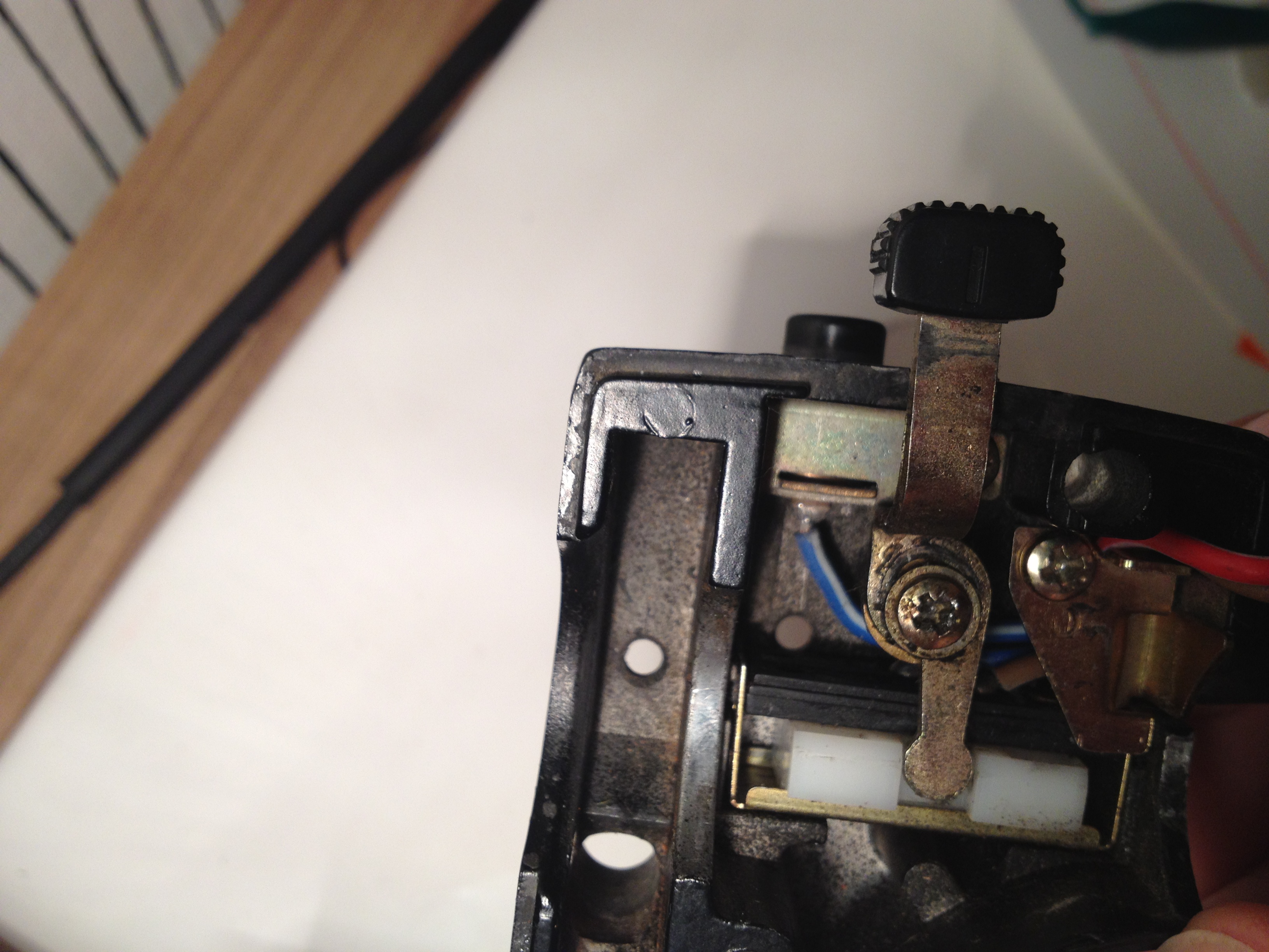

When I was tinkering with starter relay I accidently touched positive wire from battery and wire that goes to starter motor and engine started.
So I took right handlebar controls apart and saw something really confusing. Start switch only has one wire attached to it (blue/white). Question number two; What does start button do? What wires are connected when button is pushed? Why I have 5 wires (6 but brown is joined in one flying) instead of 4 as on schematic?

The starter button completes a circuit running from the starter solenoid
+ battery to solenoid to button back to - battery (ground) There is a second heavier wire running from the battery + terminal to the solenoid, then to the starter motor. The starter button allows low amperage 12v current to fire the electromagnetic switch in the solenoid, which in turn makes the connection for the heavier wires to allow the high amperage current to flow from the battery directly to the starter motor. A normal handlebar switch can't deal with that current and if it got to your finger, you wouldn't be on the bike for long.
@Tim; thank you for your input. Only thing that bugs me with the starter button is that as you said it should complete a circuit to starter solenoid, but when I opened housing I saw that there is only one wire connected to that button... how can it complete a circuit with only one wire :D
see the attachment, that blue/white wire is only thing connected to the button

soooooo I got it started via push button, the catch was in new handlebars that apparently are not conductive...so I used one aligator clip wire and connected control housing to frame and bam it worked. I got sorted blinking lights, tail position light and brake light wires.
