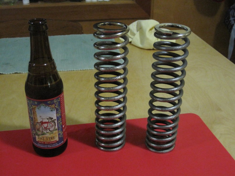

I've done it, but you'll likely be left with nickel plating under the chrome (as I was), which I believe is easier to sandblast off than chrome. If you want to strip chrome and nickel (electro)chemically in one go, sulfuric (auto battery) acid is a better bet. As shown here:
https://youtu.be/INiyYbFUihA
Edit: I've never tried the above, I'm just going by what's said in the video - where he claims he's removing "chrome" from the bolt (though the video title states "nickel" - but it definitely looks like chrome to me). A quick google search, however, claims that it's actually a two-step process, stripping the chrome with hydrochloric (muriatic) acid first, then stripping the nickel with sulfuric. I've personally removed chrome and zinc from steel parts with hydrochloric acid, but never tried the electrochemical method on chrome or nickel, nor either process on aluminum.
If the levers are aluminum.... beware, the acid etches aluminum about 10x faster than chrome. If there are any pits or breaks in the chrome, you will have a canyon in the aluminum long before the chrome is gone.
If the levers are steel, the muriatic will do a fine job.
