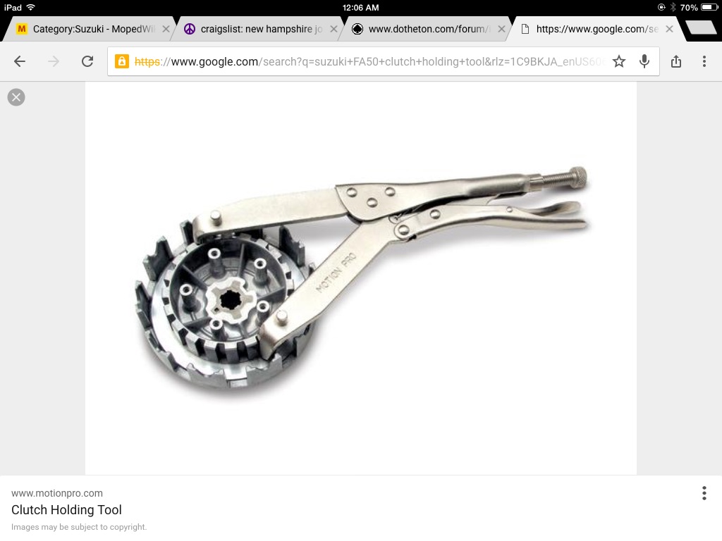

I'm trying to get to the crank seal over here, but this centrifugal clutch thingamjig is in my way. Manual says I need a clutch holder tool, but it's discontinued everywhere and I can't even find a good picture to make one. Any ideas?
Search Moped Army repair section ****hint *****search all dates not just last month...but i think motion pro has one that could work
There may also be stuff in the moped wiki
There is also a tuning spreadsheet so you can see what kit pipe jet speed etc....others used & got
And if you search in the performance section youll see all sorts of tricks

I actually have read through there. The formatting on that forum makes it a pain in the ass to read though. I guess a popular mod on the FA50 is to shave the mating surface of the head, I think you can take about 1mm off to make the fins sit even with the cylinder. I'm not set up for it, all I have is a belt sander
