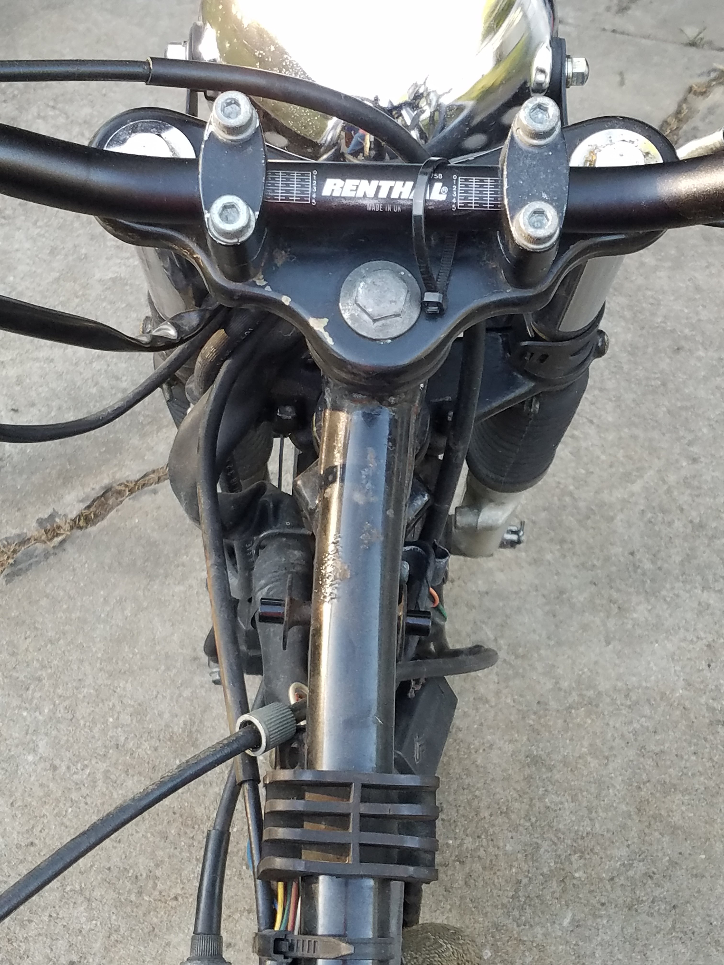

So, about a month ago I bounced off the front of a van on the ol Suzuki. Snapping my leg in half and bending just about everything that can be bent on the bike. Mostly small, cosmetic issues. But a few things are a BIG problem. The frame is bent near the forks and the swing arm is goobered beyond repair. Normally Id total it out and pop the engine on a go kart or something, but this bike has sentimental value and Im determined to keep it on the road. Sure, I can get a new swing arm fairly cheap, but the frame needs finessed back into shape or replaced. On a small/slow bike like that Im not particularly concerned with it being dead on perfect and I can fudge the VIN over to an untitled frame no problem. FINDING ONE seems to be the issue. Anyone happen to have a bare frame and/or swing arm lying around? Lol. Or even any insight or ideas? Much appreciated.

I'm sorry to hear about your accident. I certainly understand the sentimental aspect, but I'm not sure I'd be comfortable riding a straightened frame. Perhaps pulling curb kinks out of the down tubes of an irreplaceable/collectable classic, but a bike that could be a daily rider/commuter? Not so sure about that, especially because it's that large backbone. Others on here are far more experienced than I when it comes to metal working, their opinions could be different than mine, but if my bike had a frame bent like that I'd be looking for a replacement frame.
Sorry to hear that you were nailed by a van.
The simple solution is a frame swap of course and take care of whatever legal issues arise from that.
As to straightening frames, it can be done and quite simply if there is no structural damage. That means no cracks and no crushed tubes. I have seen many frames straightened on jigs to closer that factory tolerances and at a Superbike school I watched a couple of strong men with long steel tubes, push/pull a steel Kawasaki 600 back to more or less straight. On that one the from end was twisted. Steel frames are not hard to straighten if you take your time.
The last frame I had straightened professionally cost $750 and needed to be done on a jig. Aluminum frames tend to crack at the weld joints, so they are a bit more tricky, but steel is easy.
That one looks banana type bent but I suspect that if you put the top tube in a press, you could push it straight. Steel has a certain elasiticiy and will spring back, so you have to go past straight to let it spring back, but take your time and check everything carefully.
My concern would be that if the top tube and swingarm are bent, what else has also been bent. The front downtube is most likely tweaked and the back end is probably bent too. Start by checking wheel alignment and see how far out it is. With wheels in line, both wheels should also be vertical. I suspect that the front wheel on that bike is off to the right and skewed at an angle.
But you have nothing to lose by checking it and trying to push it straight (with the engine still in place) and if it's too bad, all it cost was some time.

Right. Thats obviously the easy route if and when I find a parts bike/frame. Im currently on the hunt. But like you say, its worth at least trying to iron out the frame. Getting a good look at it, it all seems doable with enough leverage and patience. The tail end of the frame doesnt seem damaged, and what is bent up front is smooth. No cracks or crunches. Did they use heat when you watched them straighten that frame? I consider it, but worry about the integrity of the steel. I plan on taking a ton of measurements and getting a real good look at it before making the call. Also, both wheels are all out of whack, which tipped me off to the damage to begin with. For a few weeks after the accident, I had only seen it through my window and everything looked cosmetic. It wasnt a super serious accident. I was going like 20mph and the van was stationary (long story). Point is, I was disappointed but not surprised when I noticed the wheels were tweaked. Lol. Could have rode a little more this season!
No heat needed if you use a press. If you try to use long steel tubes and a couple of strong mates, heat might help. Heat isn't usually required and it makes it a lot more complicated to hold/bend because invariably someone will end up touching the heated part.
Cold pres it in a 10Ton hydraulic press. It will have to be supported by a couple of mates as you "drive" the press ram.

Im just trying to figure out the logistics of that. Lol. Never tried this before. Would it be easier to tear it down to bare frame?

Yes, strip it down but leave the engine bolted it or else the frame will distort even more.

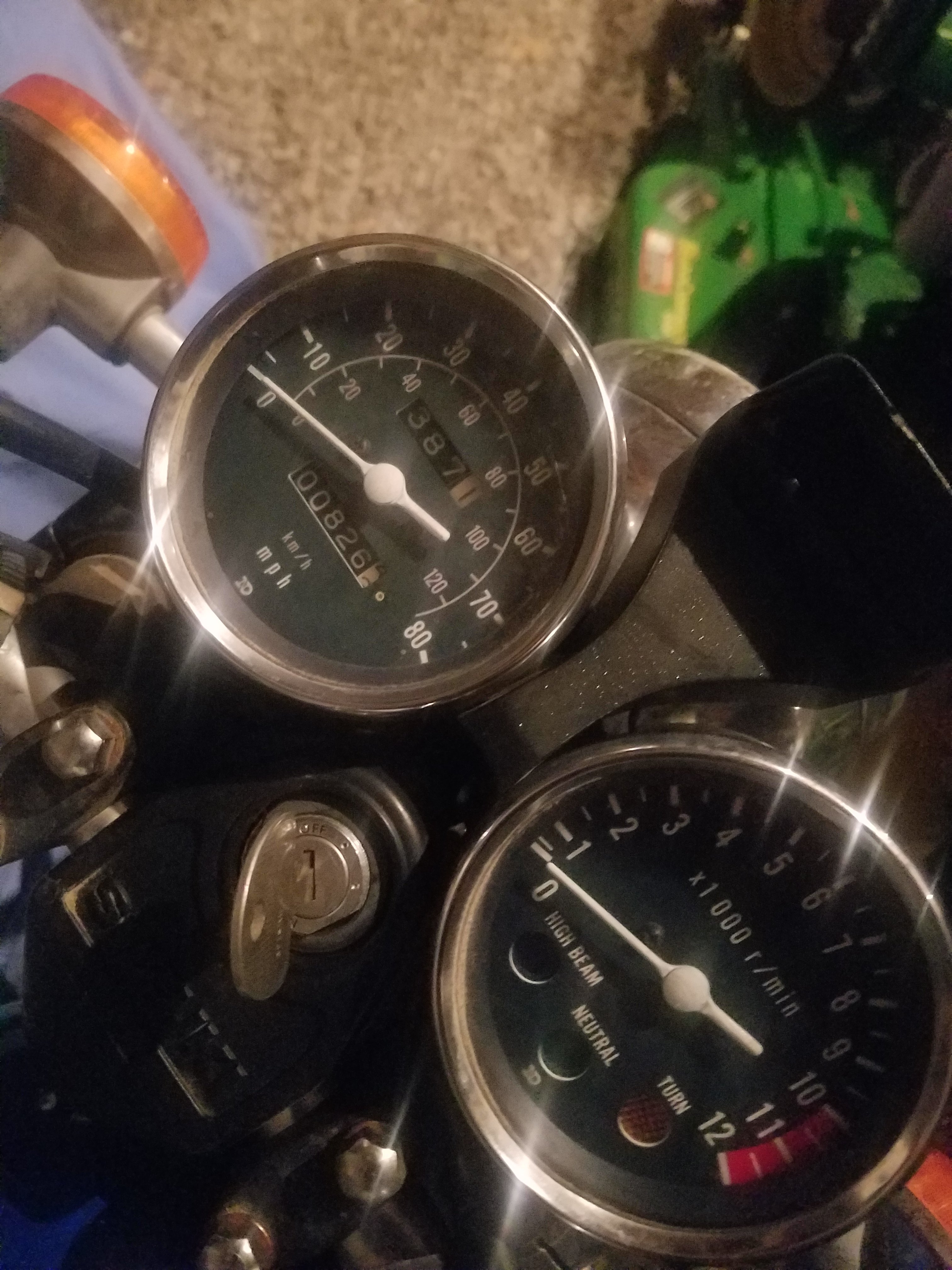

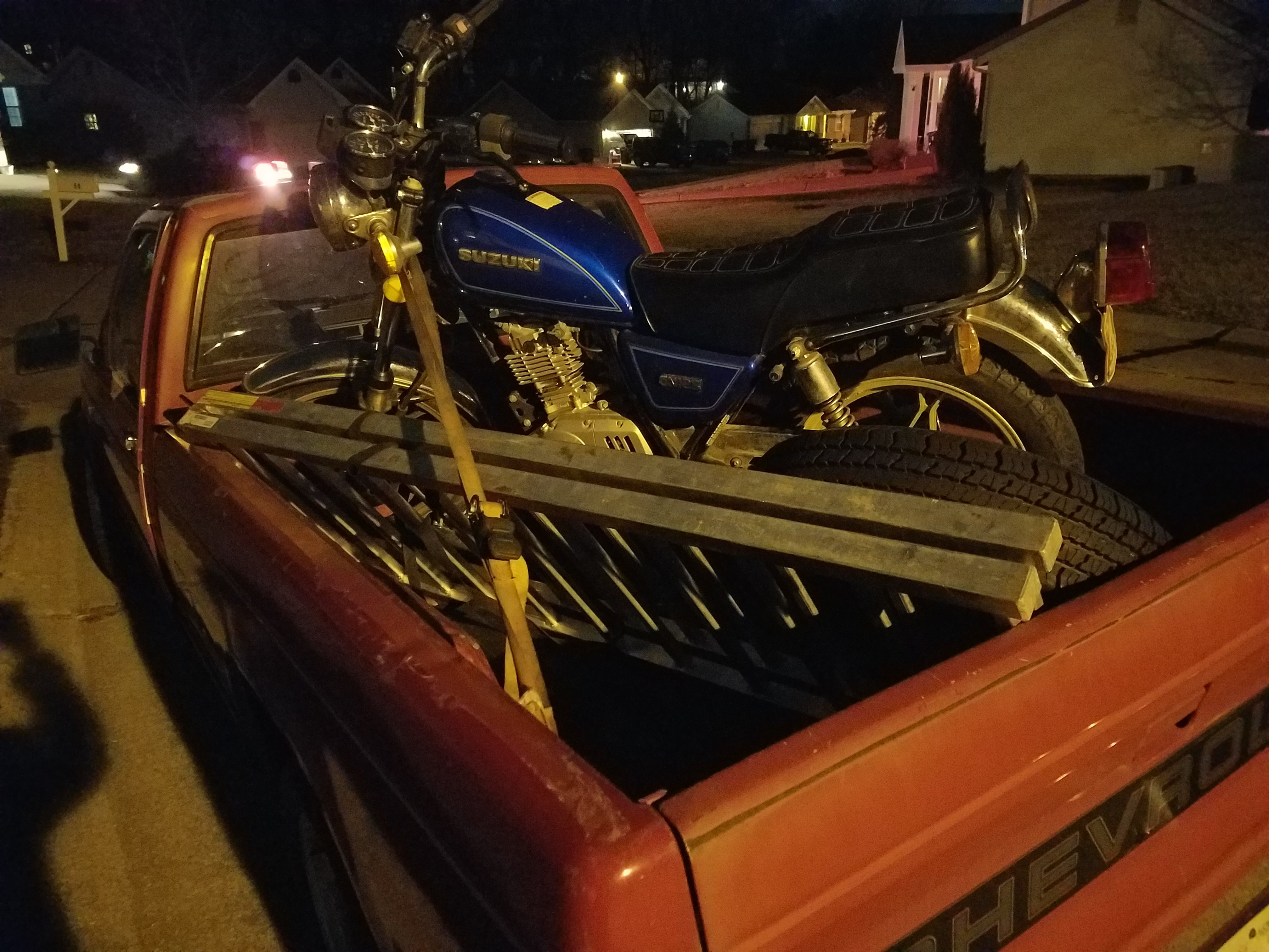

To anyone interested, I FOUND ONE! And not just any old replacement frame. A complete bike with just a hair over 800 miles! It even came with a ton of paperwork from the single owner. In the process of swapping all my parts over now. Spent the cold days tearing the old bike down to the frame in my living room. Going to put a 150 kit and some go-fast junk on the higher mile engine before swapping it to the new frame and tucking the low mile engine away. The new engine runs great with my rebuilt carb slapped on it. Smooth as silk. Only issues with the new bike are the front brakes are locked up/missing front caliper, the carb needs rebuilt, and the tank is trashed (rust and dents everywhere.)
