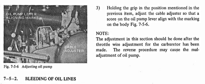

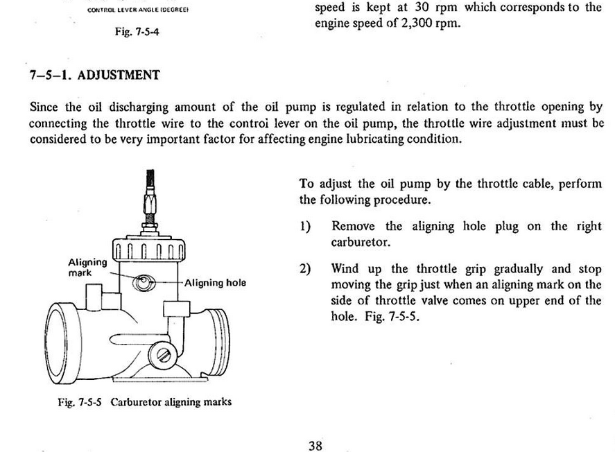

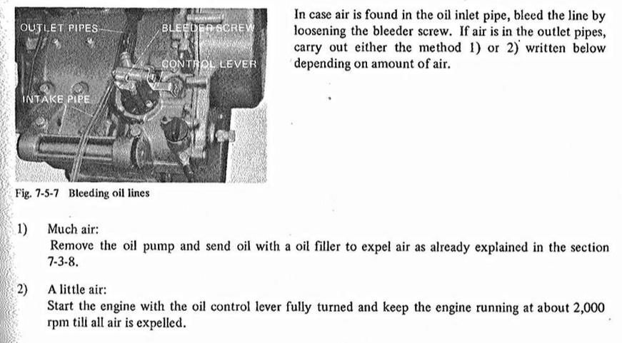

Was wondering if anyone could tell me what the oil pump rod adjustment is on a 1974 gt750.Clymer manual has nothing on this. Any help would be great! Thanks
If you have the throttle cables adjusted correctly, this is the steps for adjusting the oil injection "CCI"
