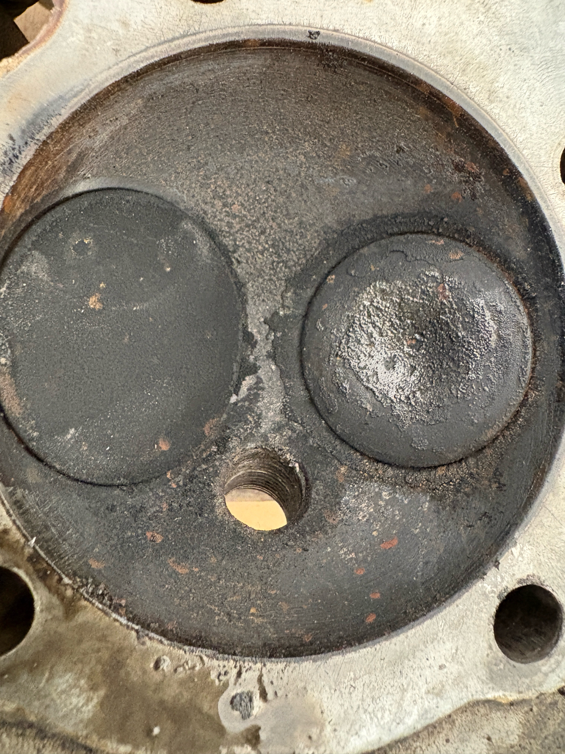

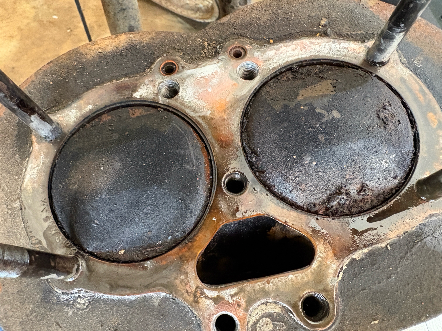

Finally went out and started tinkering with this thing. Figured it would be easier to yank the top end with the motor still mounted in the frame so that’s what I did. Everything thing is dirty and some things are rusty but nothing looks damaged or broken.
The crank spins over very smoothly and the pistons look okay. I think my next move is getting the bottom end out of the frame.
