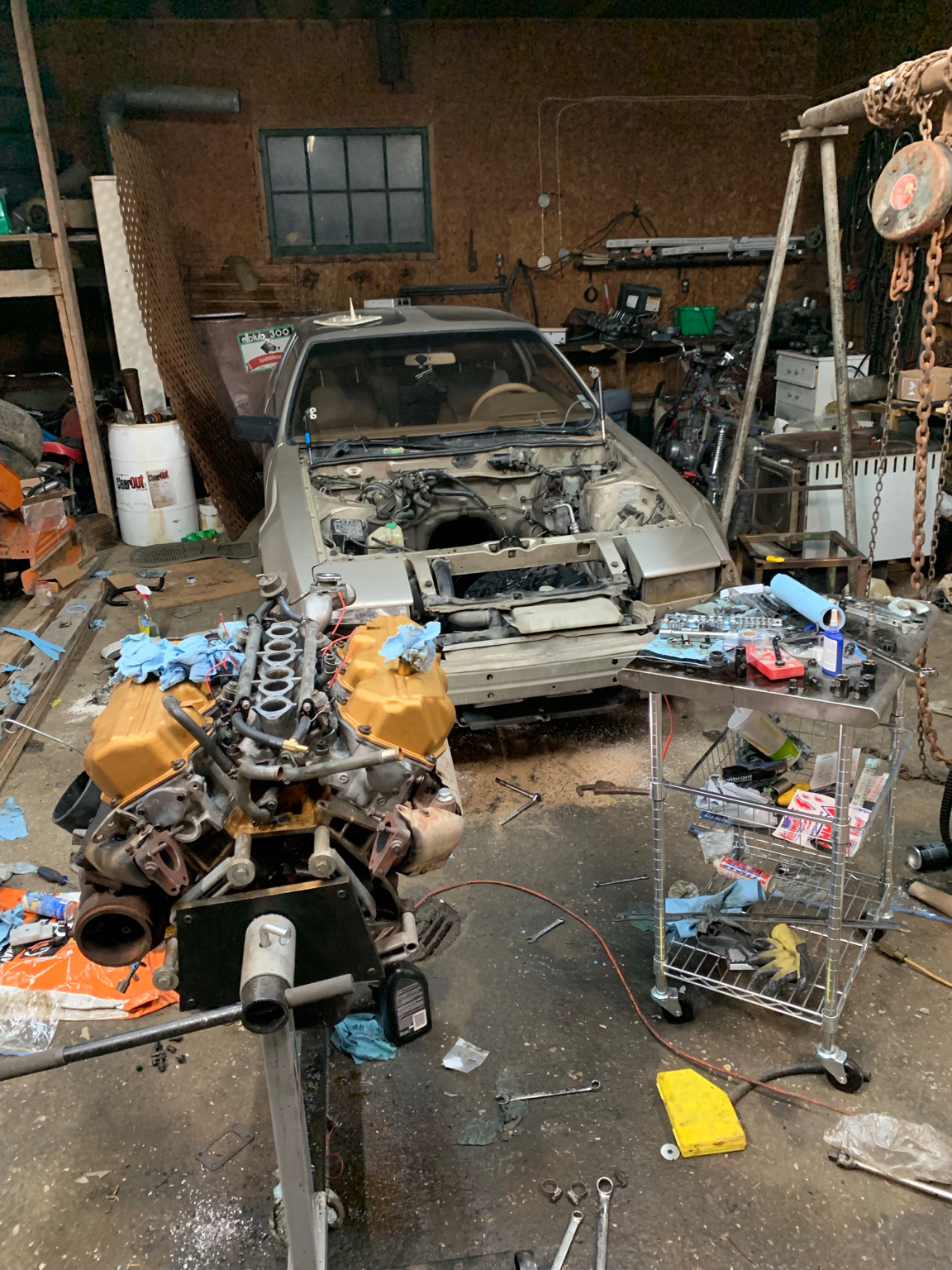

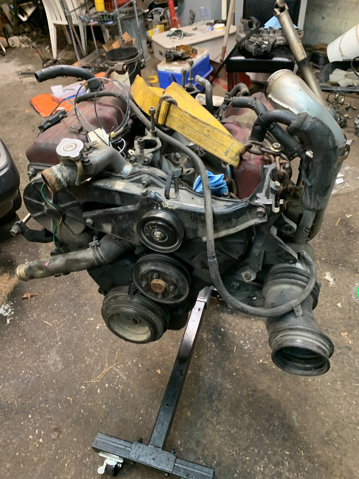

Swapped in a manual transmission and drove it for a year but decided it needs a little more boost than the factory snail can provide. Basically, full EFI system replacement, bigger turbo, engine rebuild, hopefully double the stock power for a fun summer daily.
Engine out and about.
Exhaust studs need a bit off help

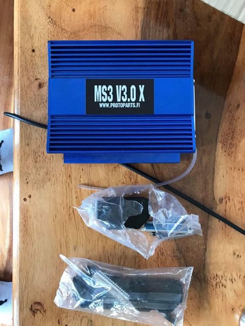

Megasquirt ms3x ecu to replace the 33 year old factory ECU

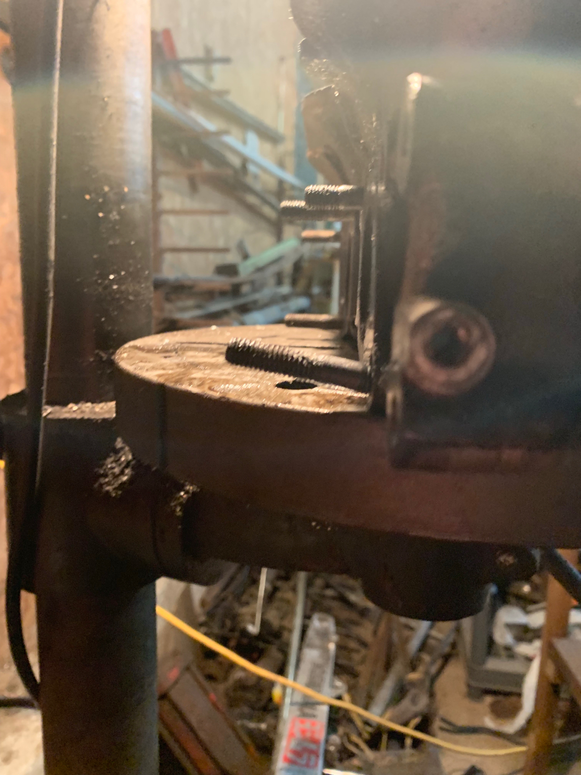

Intake plenum, original intake has these snaking passages down each side. Pretty restrictive when trying to bump up the airflow. Top was cut off of this spare intake and a 1/8th plate was welded to the top.
I still need to drill it out and weld in some bungs so that i can fit the bolts down through the plate and plug the top after.
Wires are all soldered to the ecu connectors.
The ms3x can run full sequential injection and ignition. All lines to the ecu are switched grounds or sensor lines. Need to add a fuse box and 2-3 relays to keep everything independent of the factory harnesses and then run the power lines to the injectors and ls coils.

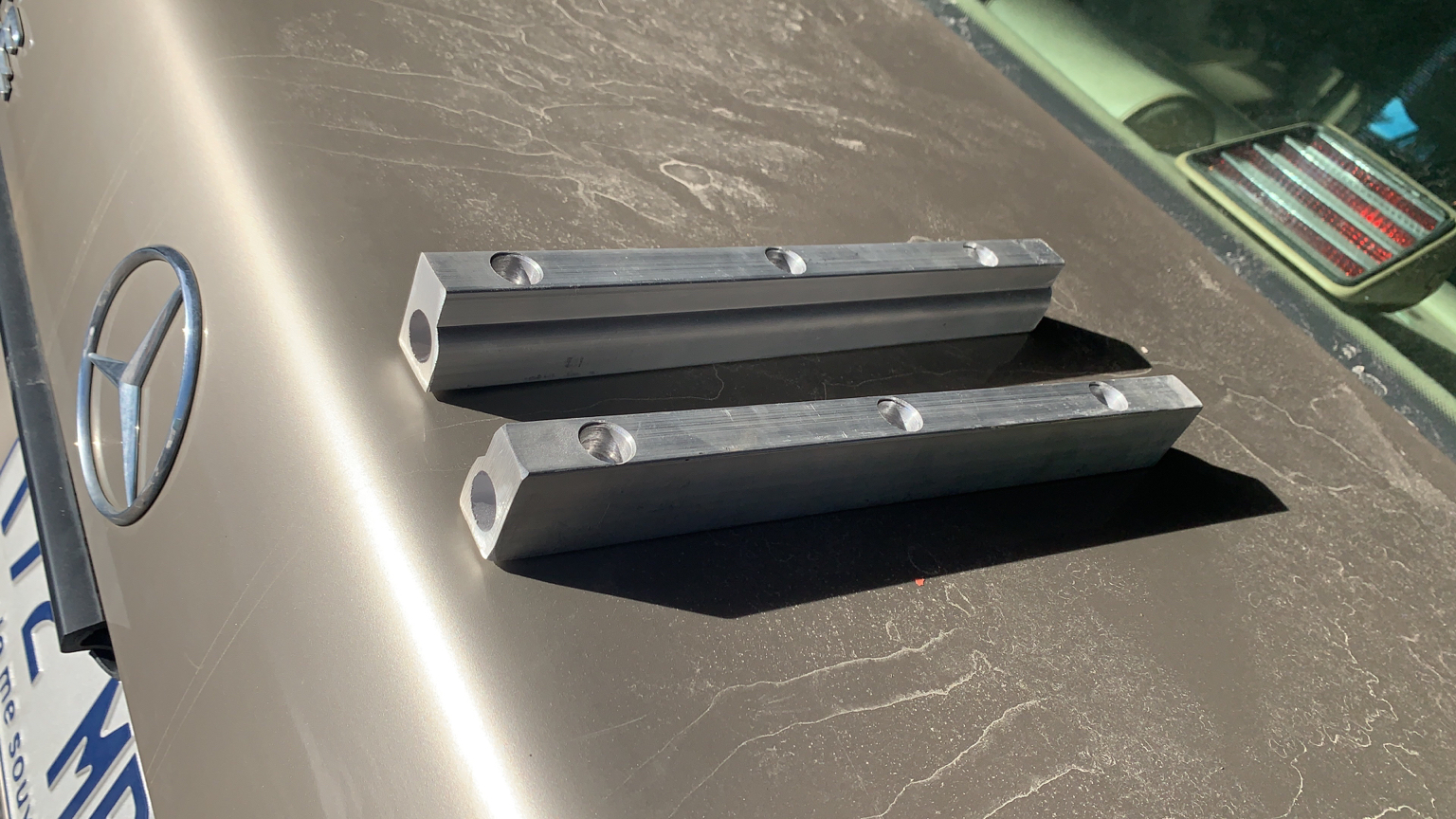

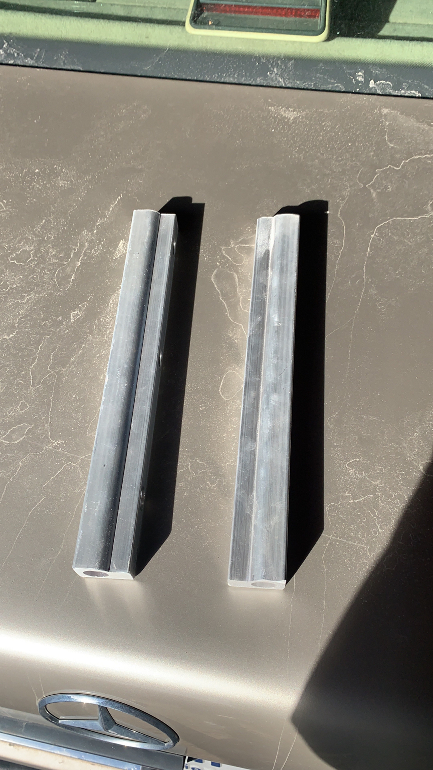

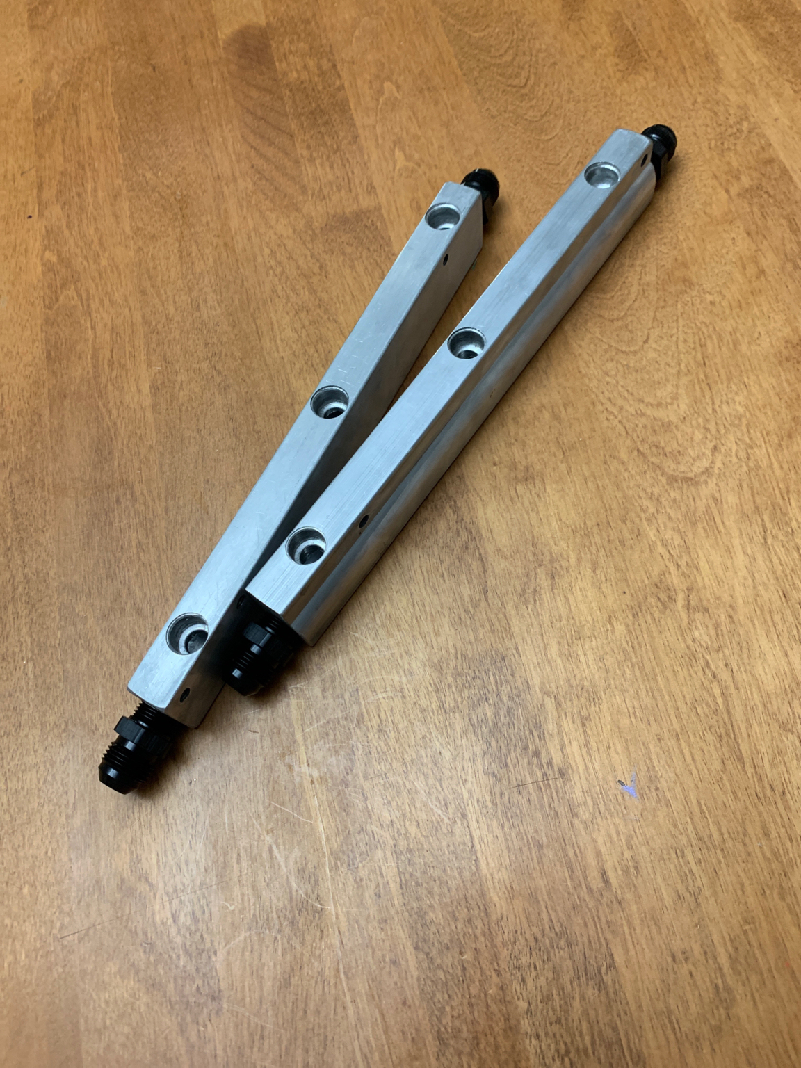

Bought some fuel rail stock and some injector drill bits to make up a few sets to sell. The cost of getting some of these up to canada is about 250 USD. total cost for tools was about 180, and material is like 40$/set with some -6an fittings so it’s a no brainer.
Got them sat up on there to test fit, had to trim some down as the original length was about 1/2” to long. The stupid coolant filler neck still interferes a wee bit. Was hoping to avoid putting a 90° right into the rail.

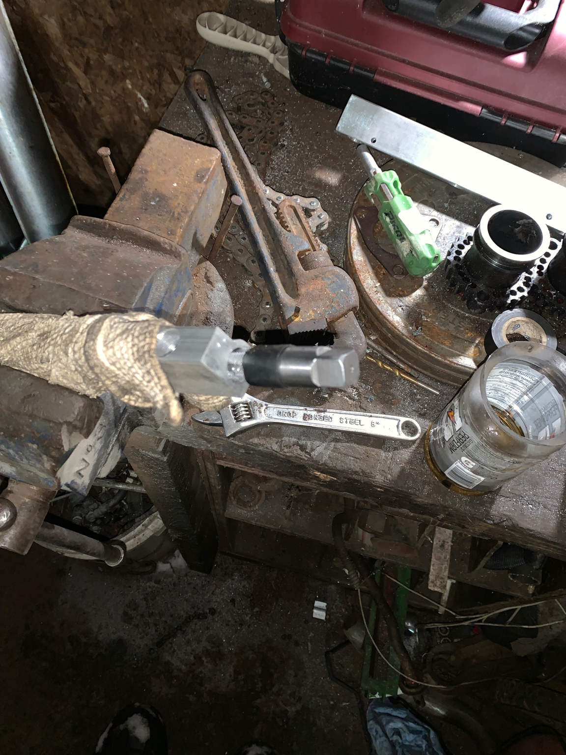

Got my NPT tap in the mail today, but still waiting on the -6 fittings. Got half the rails tapped and threw some of the -8 fittings in for a test.

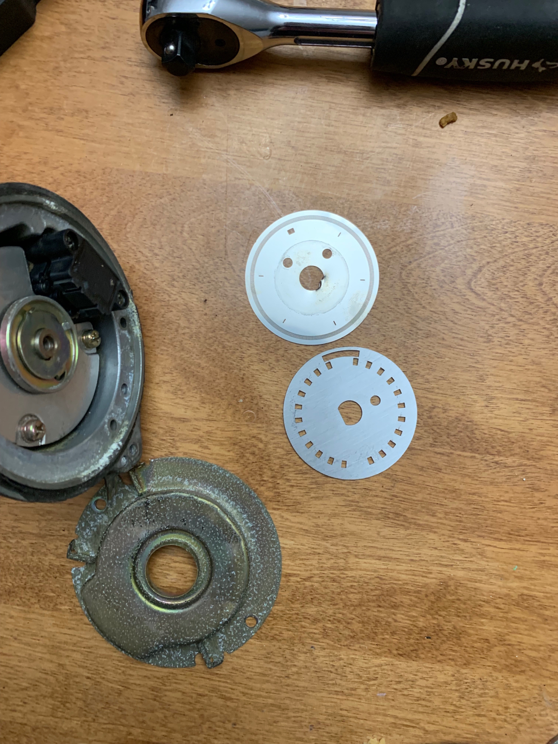

So most older nissans use an optical sensor & LED to send the crank & cam signals to the ecu. In this case they are located in the distributor.
The original wheel has 360 slots for the crank signal and 6 slots (one larger) for the cam signal.
This wheel doesn’t play nice with aftermarket ECU as the resolution isn’t there for sequential ignition & injection. I replaced the factory wheel with one that simulates a 12-1 crank wheel with a single tooth cam wheel.

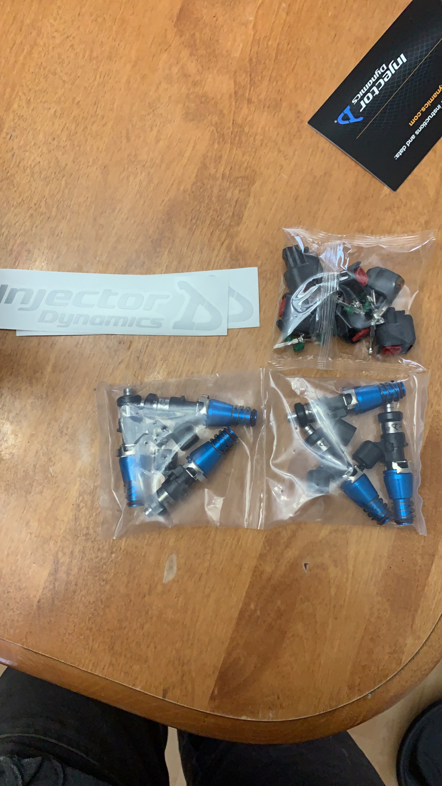

Also received my new injectors, i realized that they’re probably the dumbest place to try and save a few bucks on this project, especially if i need to pay someone to tune it.
They may be nearly double the price of other equivalent size injectors, but the extra characterization data from ID apparently makes worlds of difference.

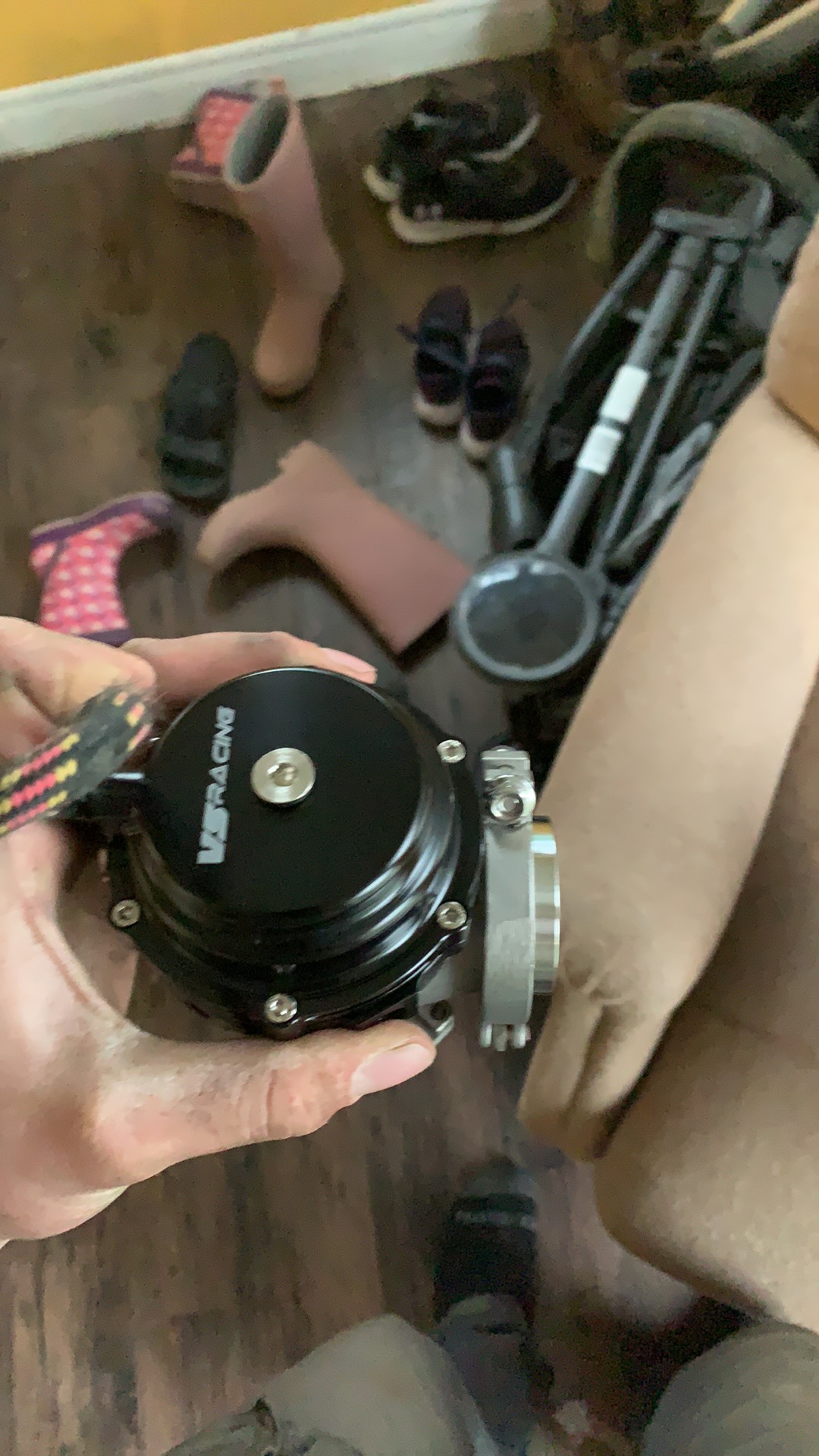

New wastegate arrived, 44mm
Absolutely massive compared to the internal gate on the he351.
