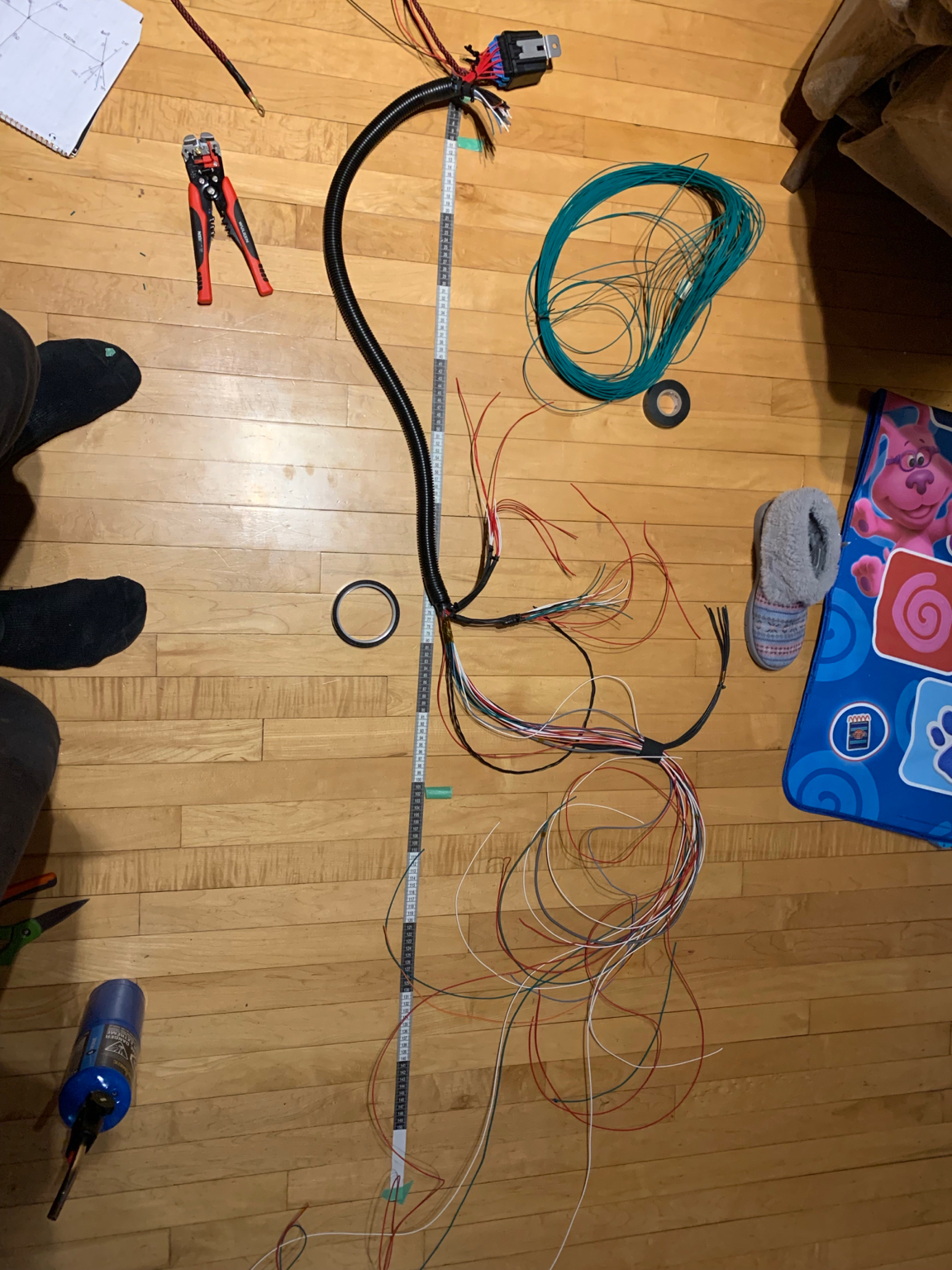

After 3 hours of measuring, cutting, crimping etc
The 12V+ supply circuits are ready to be laid out.
I really like this PDM box, i just wish it had some options for bussing instead of having so many crimped splices hanging 2” out the back

Another three hours to lay out more of the wires and run a test fit at this point. Everything looks like it should line up a OK. Not much left to do on this harness now other than she thing for the last five branches and then crimping on the connectors
Hopefully I can get it to fit through the firewall with all the connecters on there, It is a little concerning at this point

After the first attempt I realize that an hour or two of planning and preparation will save a lot of time in the long run when putting these together.
I swear, doing a harness looks like one hour, but becomes 30 something.
Probably not too far off actually. I’ve got about 10 hours into it now plus a couple hours of planning and preparation and all that’s left is to sheath three branches and then crimp on the connectors.
Hopefully I can get that done in about five hours of time but the ECU connecter will be interesting as none of the wires are labelled so I’ll have to be testing with the multimeter for each white wire
