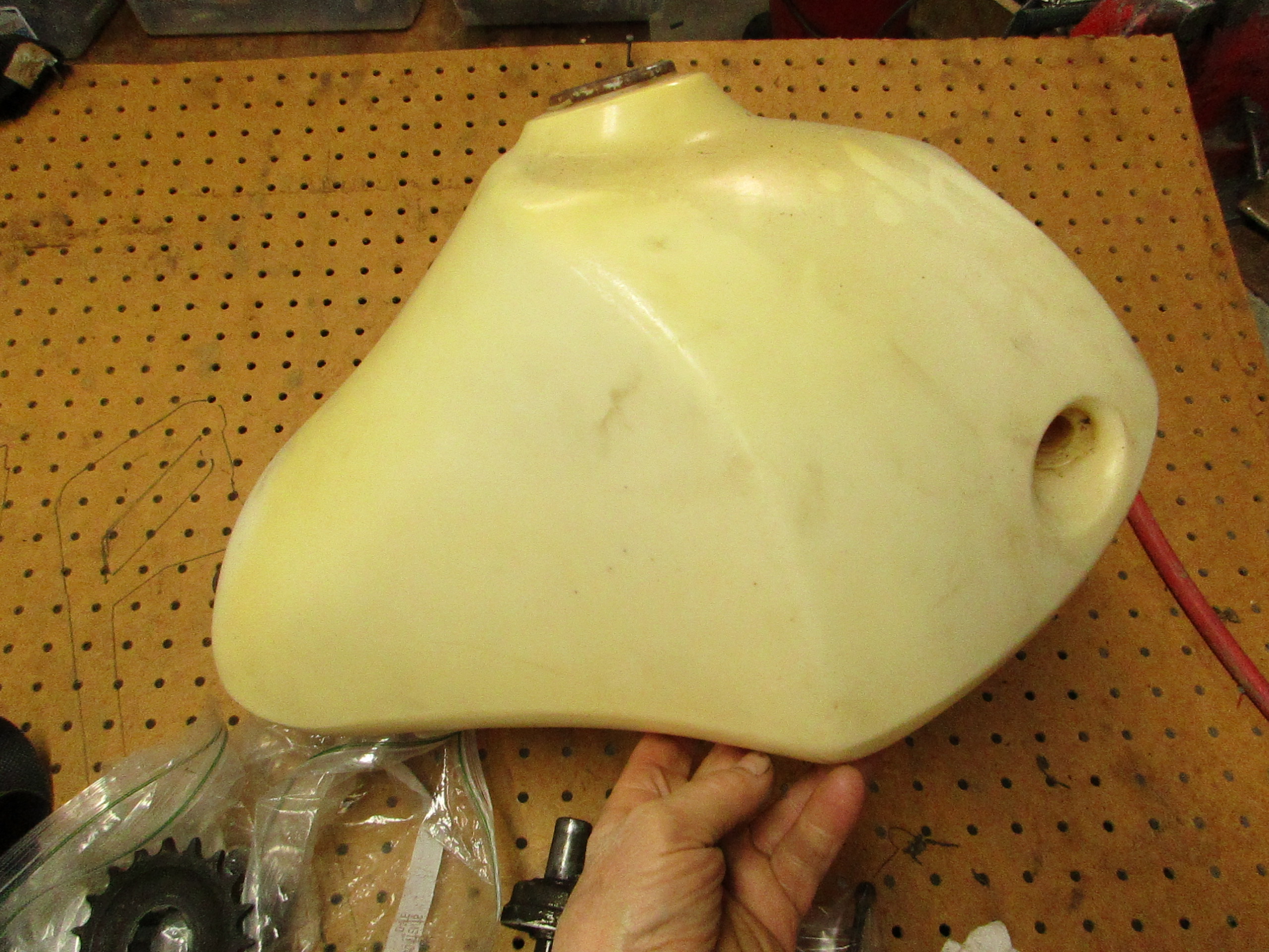

hey mister e if you want a period correct oversize plastic gas tank i think i have a doozi
just pay the shipping and a cup o coffee
the extra gallon will come in handy
there may be a few here who recognize this tank
there were other versions but they all had a laurel and hardy like moniker
who was the iconic tuner, racer ,LEGEND, entrepenuar who distributed these and other products with 'is name for the sig of the brand ?

That does look like a Clarke! But I'm not up on my desert tanks very well. Sir, let me know how much $ and where to, and I'll get it to ya. I'd love to keep the historical accuracy on this build as much as I can.
Thanks!
