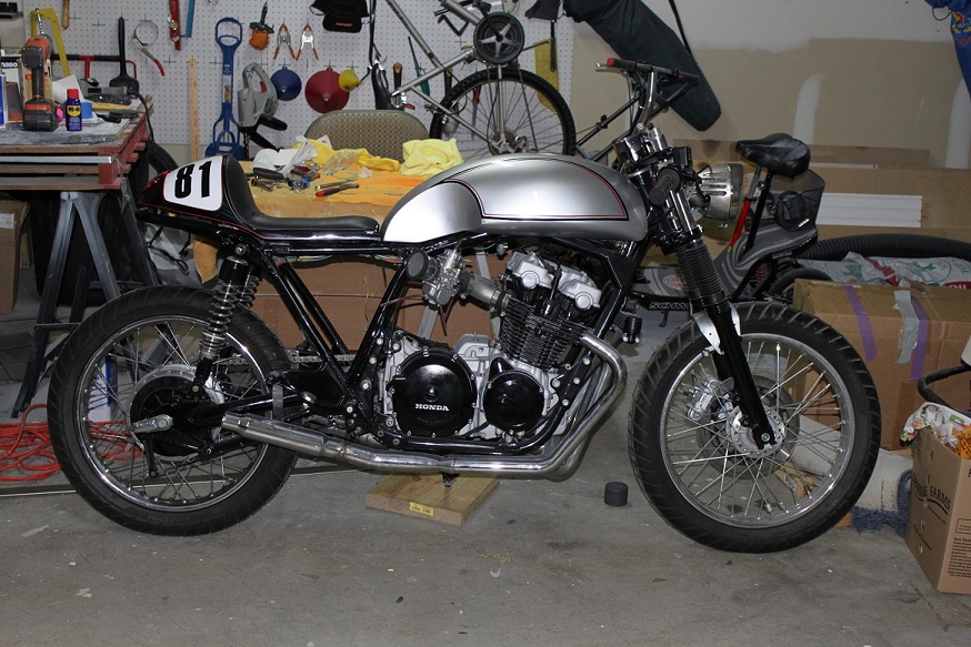

Havn't posted in forever. I'm building a 1981 CB750K from the ground up, and it's almost done! I've completed the following since the last update:
-rear shock mounts relocated
-oil cooler modified and installed
-speedometer sensor location for digital speedo fabricated and mounted
-stainless lines ran
-tank and tail section painted, no decals yet though
-rearsets mounted
I still have to get it wired up and the tank plumbed in. I'm also planning on making an aluminum tank strap to add to the manx/triton theme.

Hey P,
Just checked out your blog to get caught up to speed. I must say, your build's giving me some hope for that old CB750c in my garage. Keep up the good work, the hard parts behind you now.
Pistol said:
It is a BCR tank and tail section. They are made of fiberglass.
Really is nice. 8) Please just pop the seat on the frame and take a pic. I'm itching to see how it looks... :-)
haha! Well I'm waiting to get my number decals in the mail. The tail section has number plates on it and they look super goofy without numbers on them! :) Hopefully they will be here by the weekend!
I got a boot today (had ankle surgery last week). Hopefully tomorrow I'll hobble out to the garage to get those numbers on! I'll take a pic and post it by the weekend.
Dude, thats looking really nice man... Probably one of the nicest CB750s ive seen.
-Slice
Still on crutches, but I got the tail section on today.
