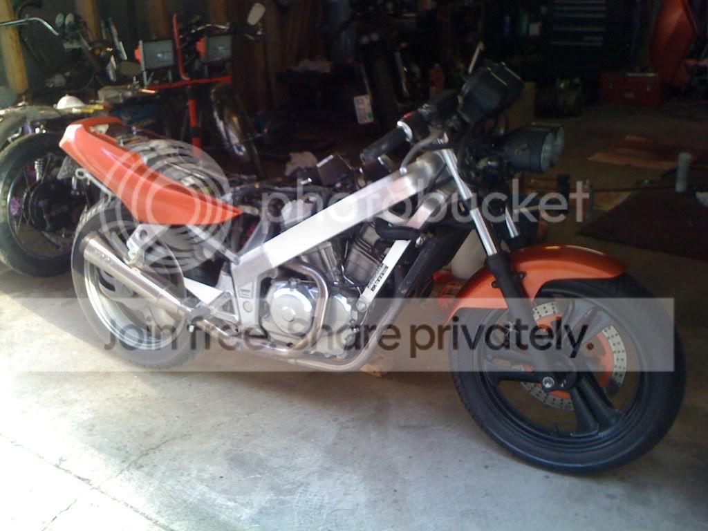

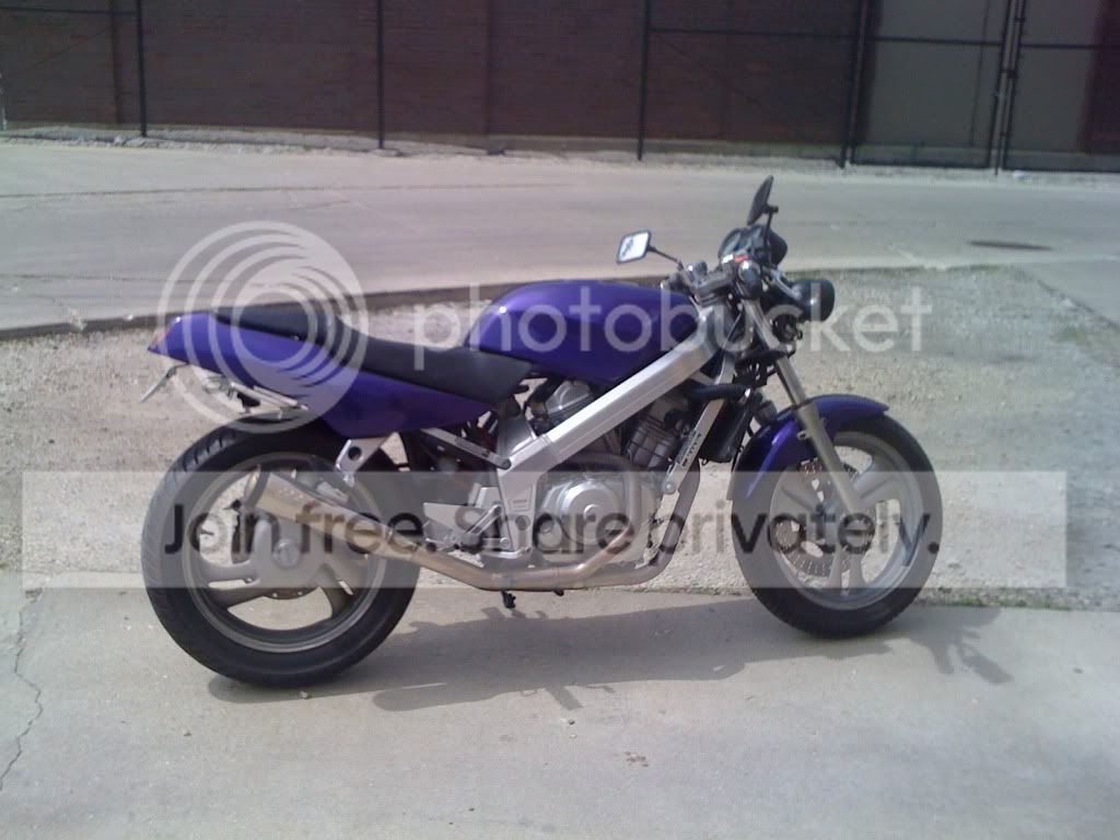

This is the what I started with. I couldn't stand the burple color so I decided to change it.
Here are a few phone pics.

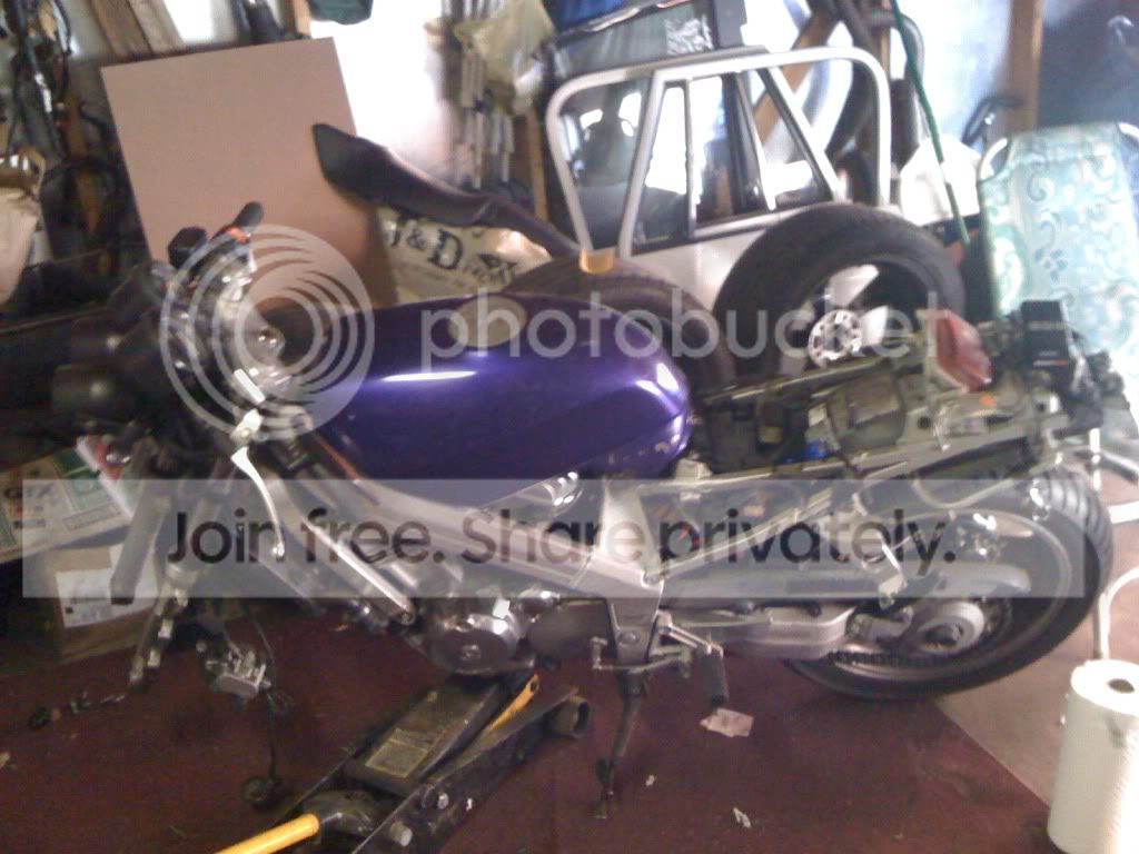

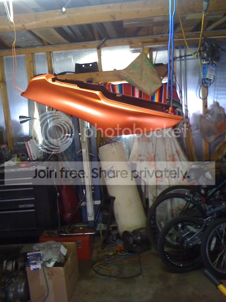

So I started to take her apart. I found a good color for it! I prepped the tail piece first and sprayed the base coat. Then I gave it a wet sand and sprayed the clear.
All the paint is rattle canned!

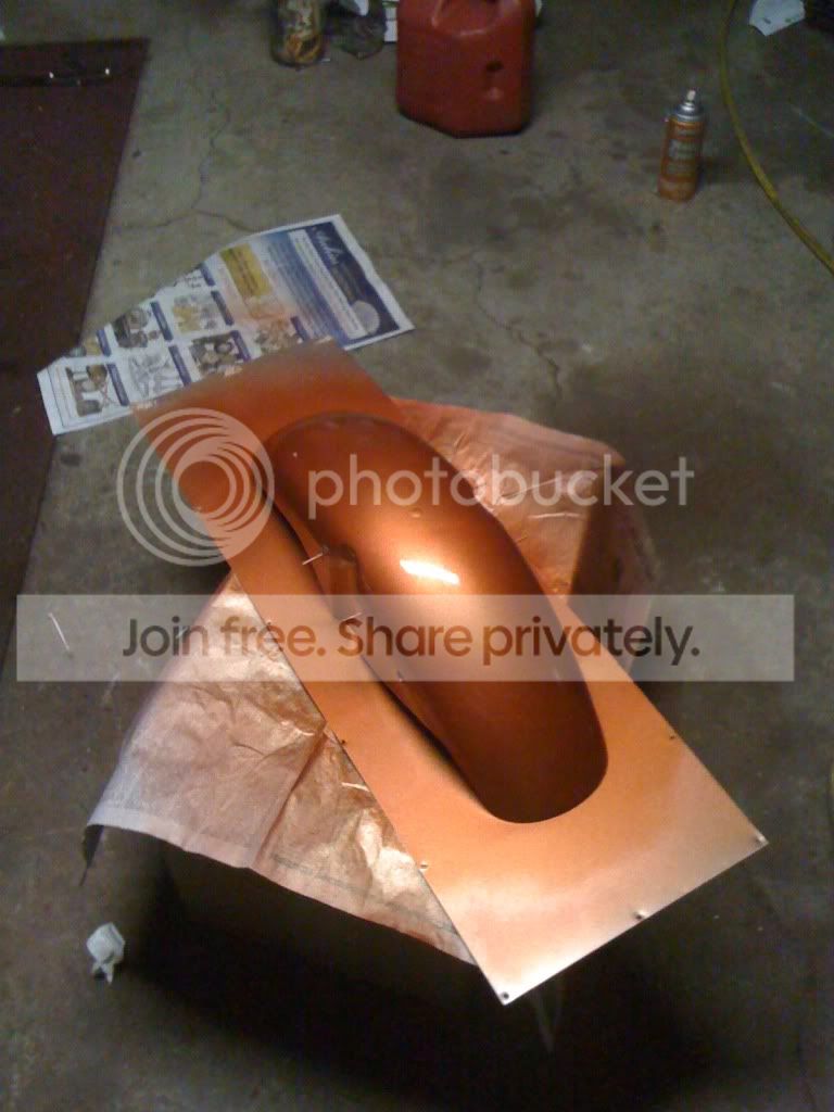

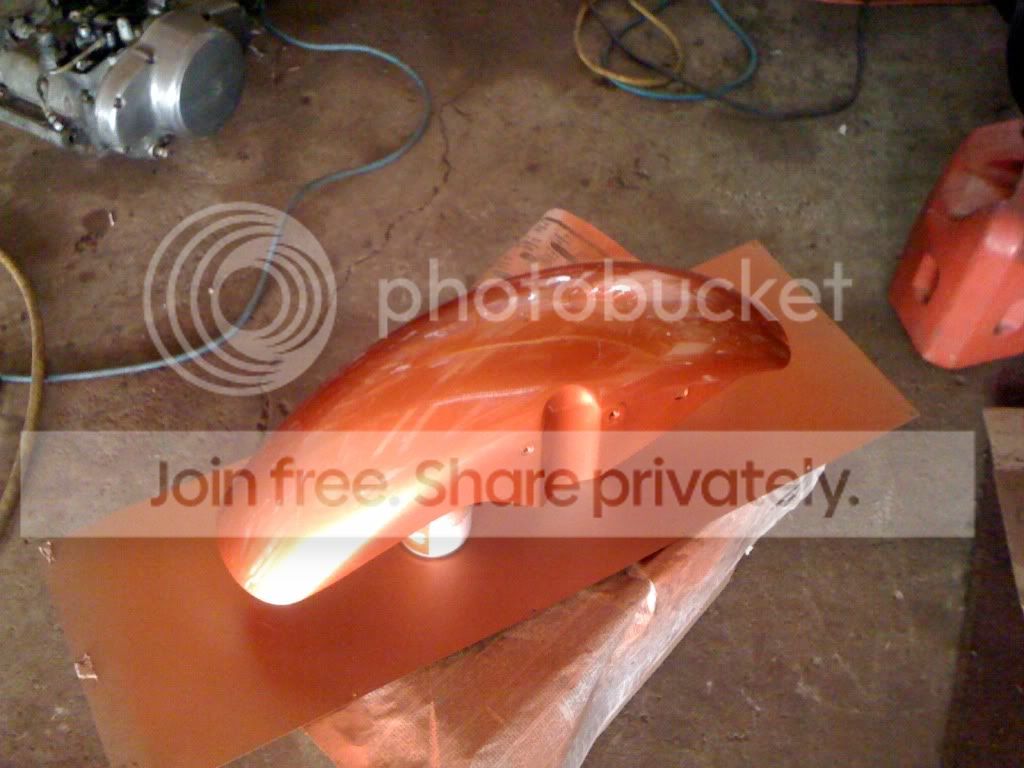

Cleared the fender with 3 coats

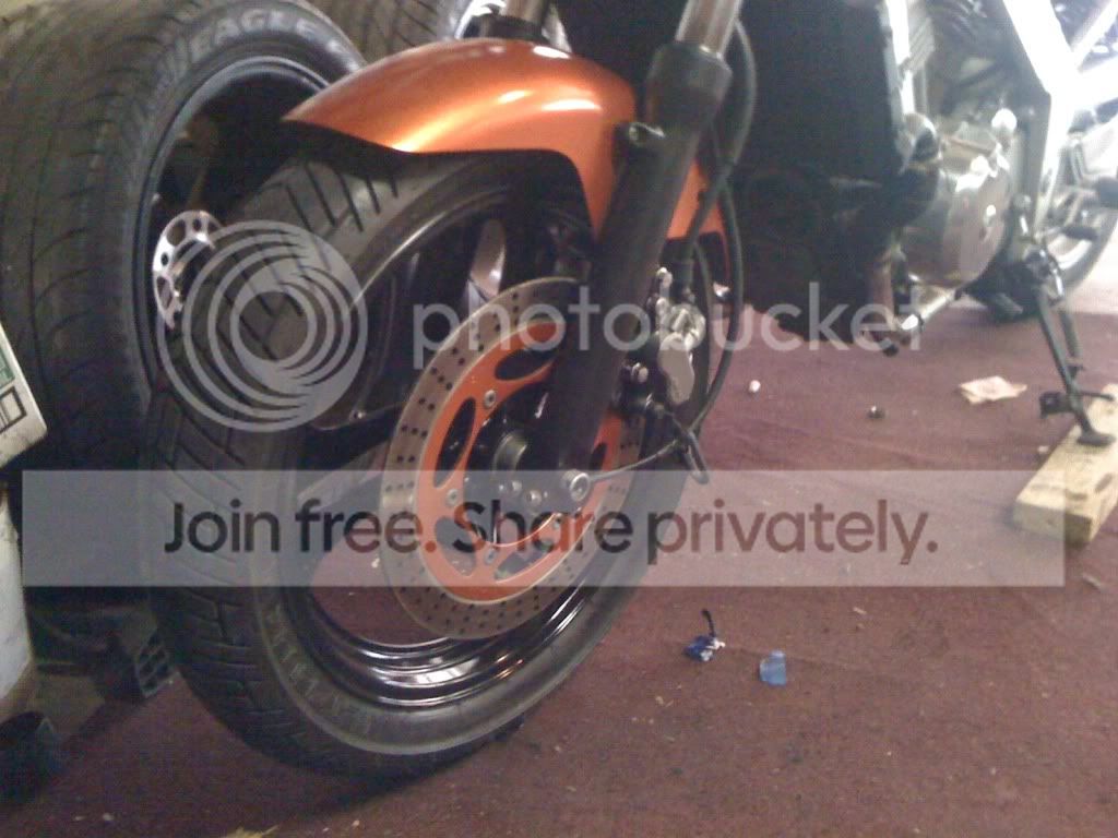

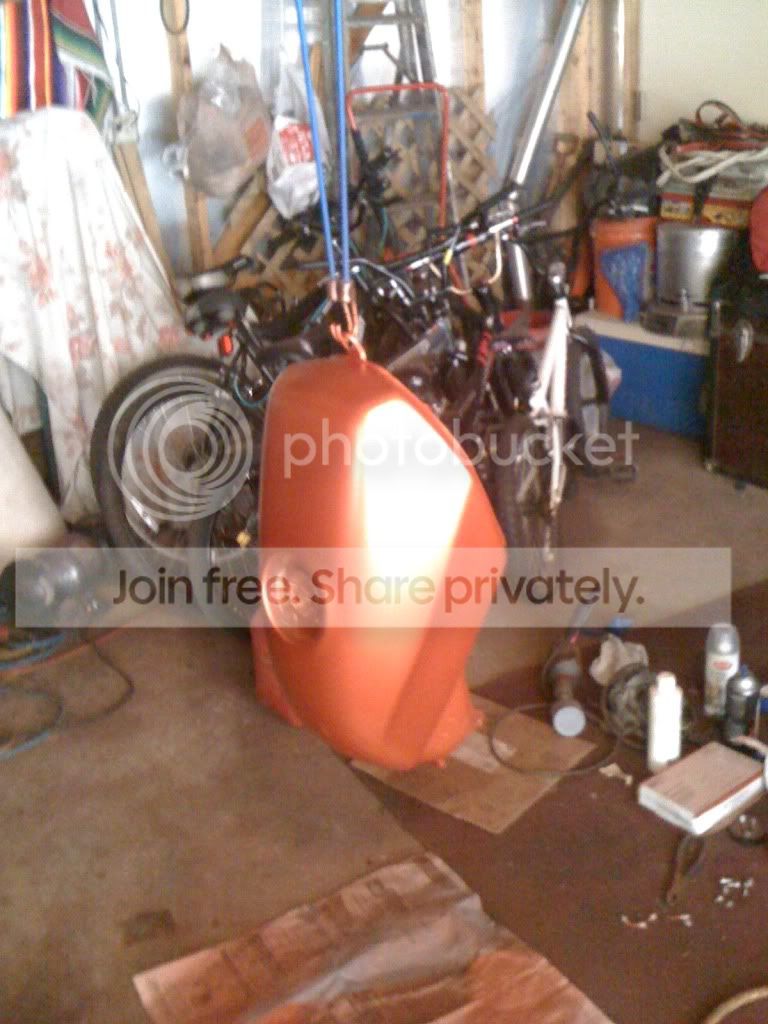

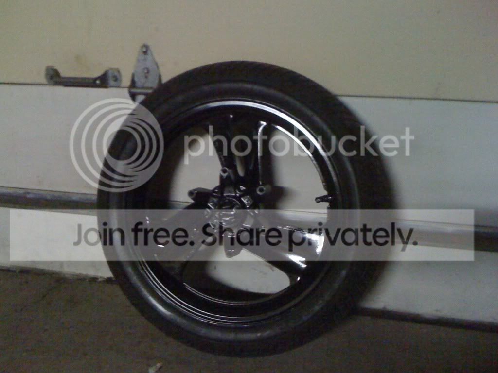

Then I did the tank and put the front together. Also painted the forks a matte black. Its starting to look like a bike again. I am soo close to finishing!

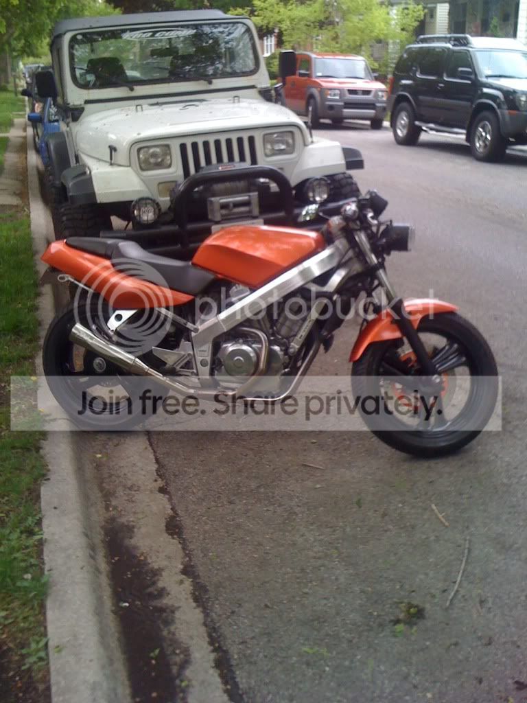

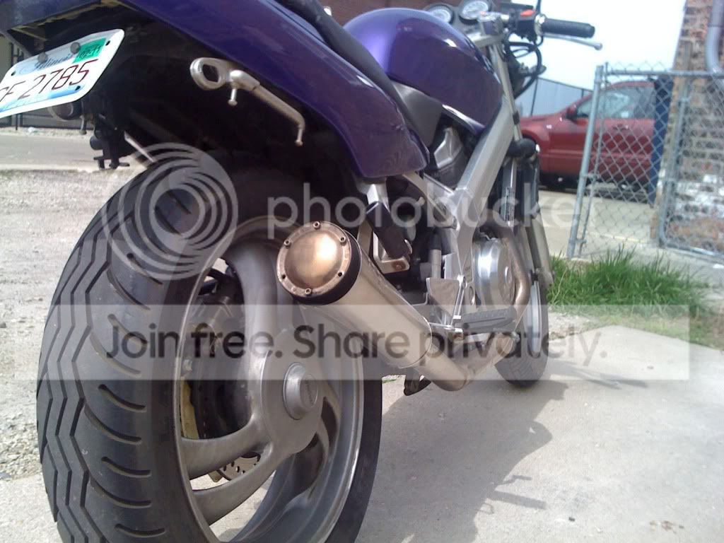

Put it all back together and here she is! I also ditched the stock mirrors and went with a round bar-end mirror. I'll get a pic once we have some better weather! This Chicago weather sucks!!
Looks good man. Much better. Im not a big fan of that copperish color (reminds me of a chevy cavalier for some reason) but your work is exceptional.

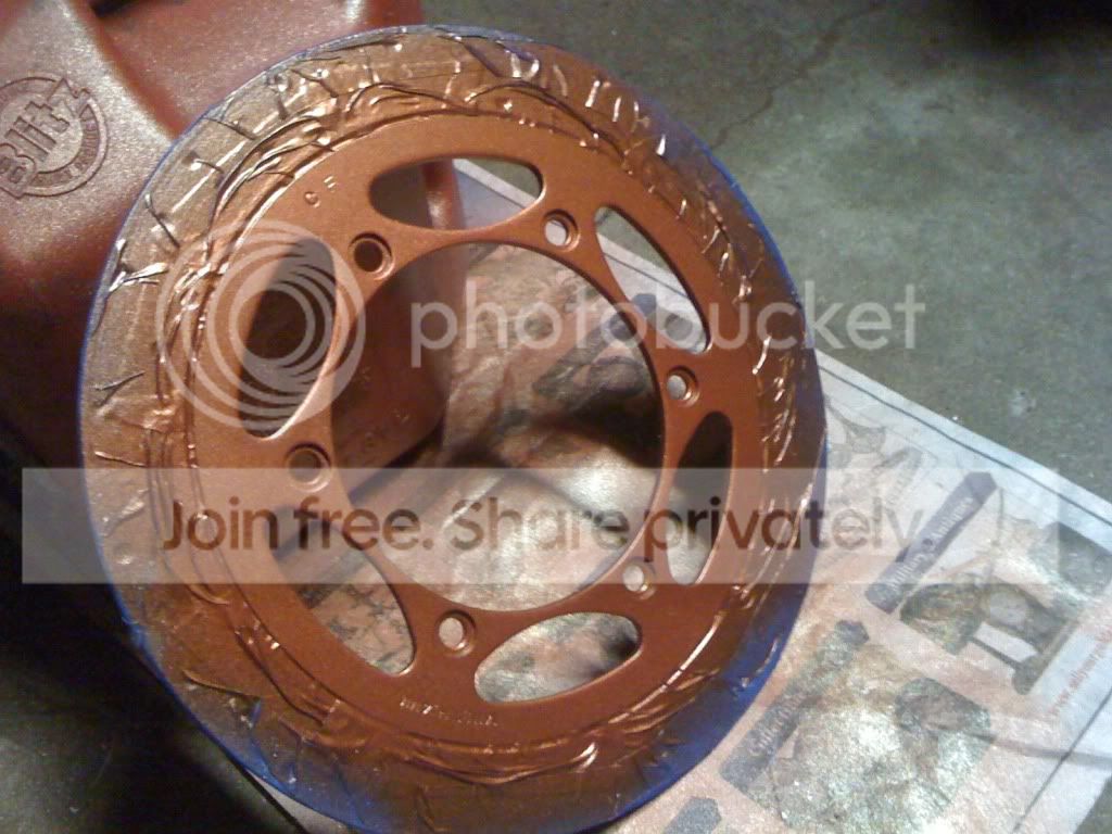

Yeah, looks great, I am a big fan of the NT650's. Cool Bikes, and the single sided swinger is sick!!! Only issue I see is that rotor. Did you use Hig temp paint? They get pretty warm under hard braking, and if the paint is not hi temp treated it will flake off... I did my rotors on my dirt bike and they were fine in the dirt, no real problems. Then I took it to the street with a sumo setup up. The increased braking on the street heated my rotors up and the paint came off... just my .02
Yeah I thought about that... It might just happen but in any case, I am gonna get new rotors next season. ;D
