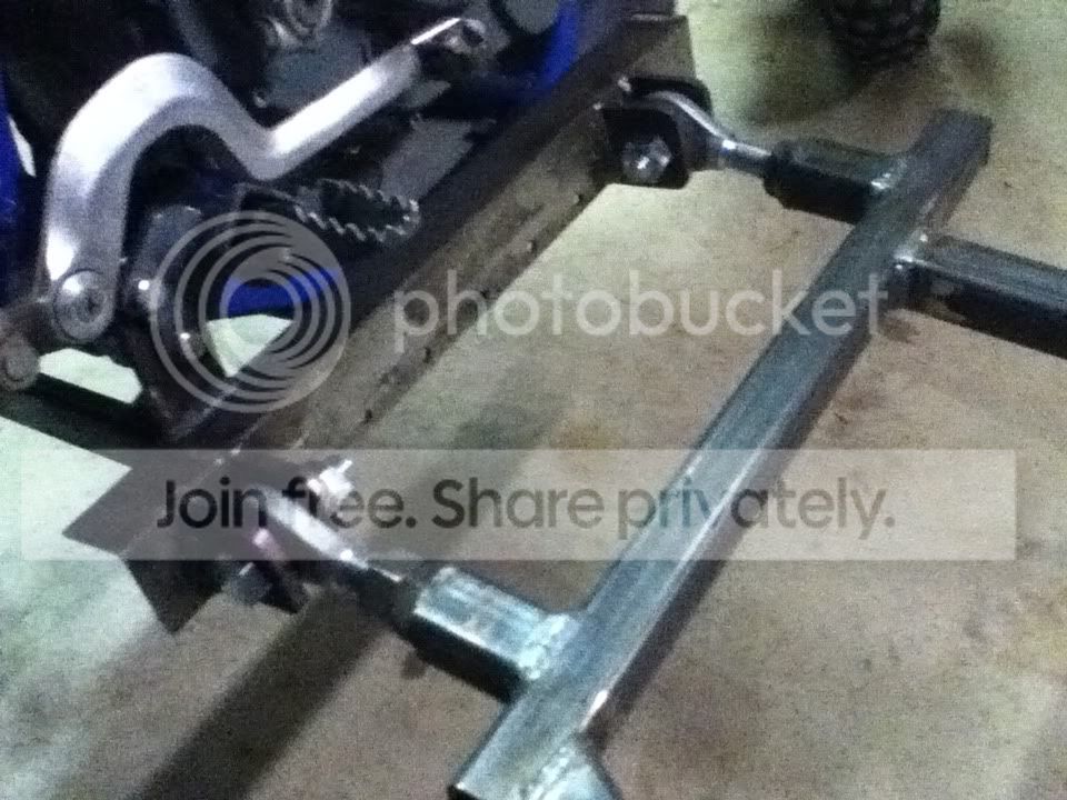

well, i did some work on the hack today. i'm kinda treading water though. i changed my mind on the mounting system. i did manage to kill 2 birds with one stone. i wanted a wider track width and i also wanted to be able to adjust the toe i got rid of my pipe hinge and went to a more conventional adjustable setup. it added about 5.5" to the track and bow i can adjust the toe. it is also much easier to remove the car from the bike now. i will get some better pictures with my real camera tomorrow.
