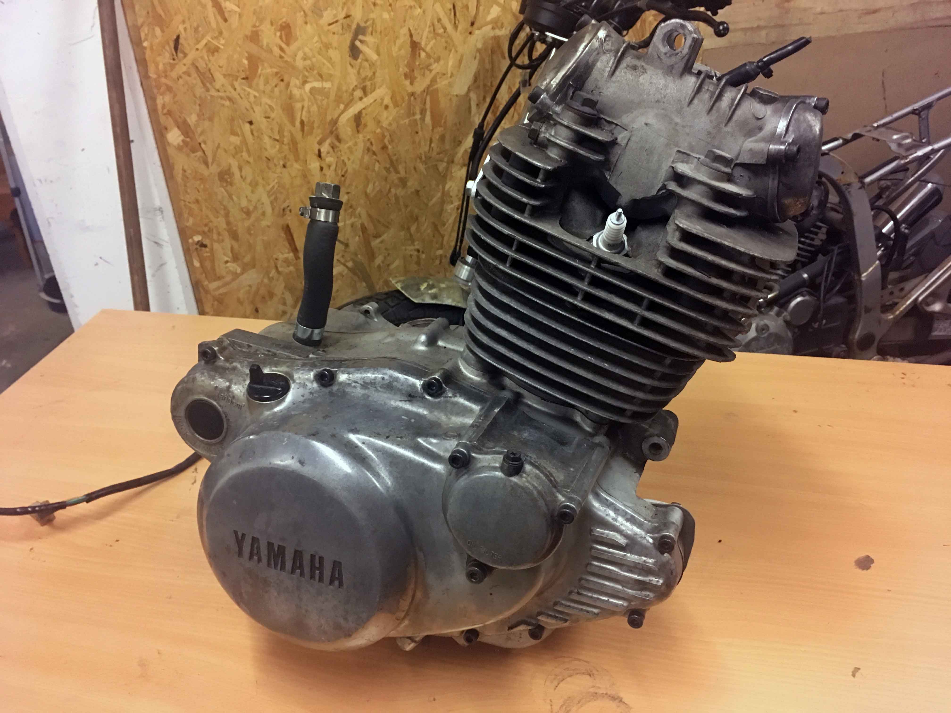

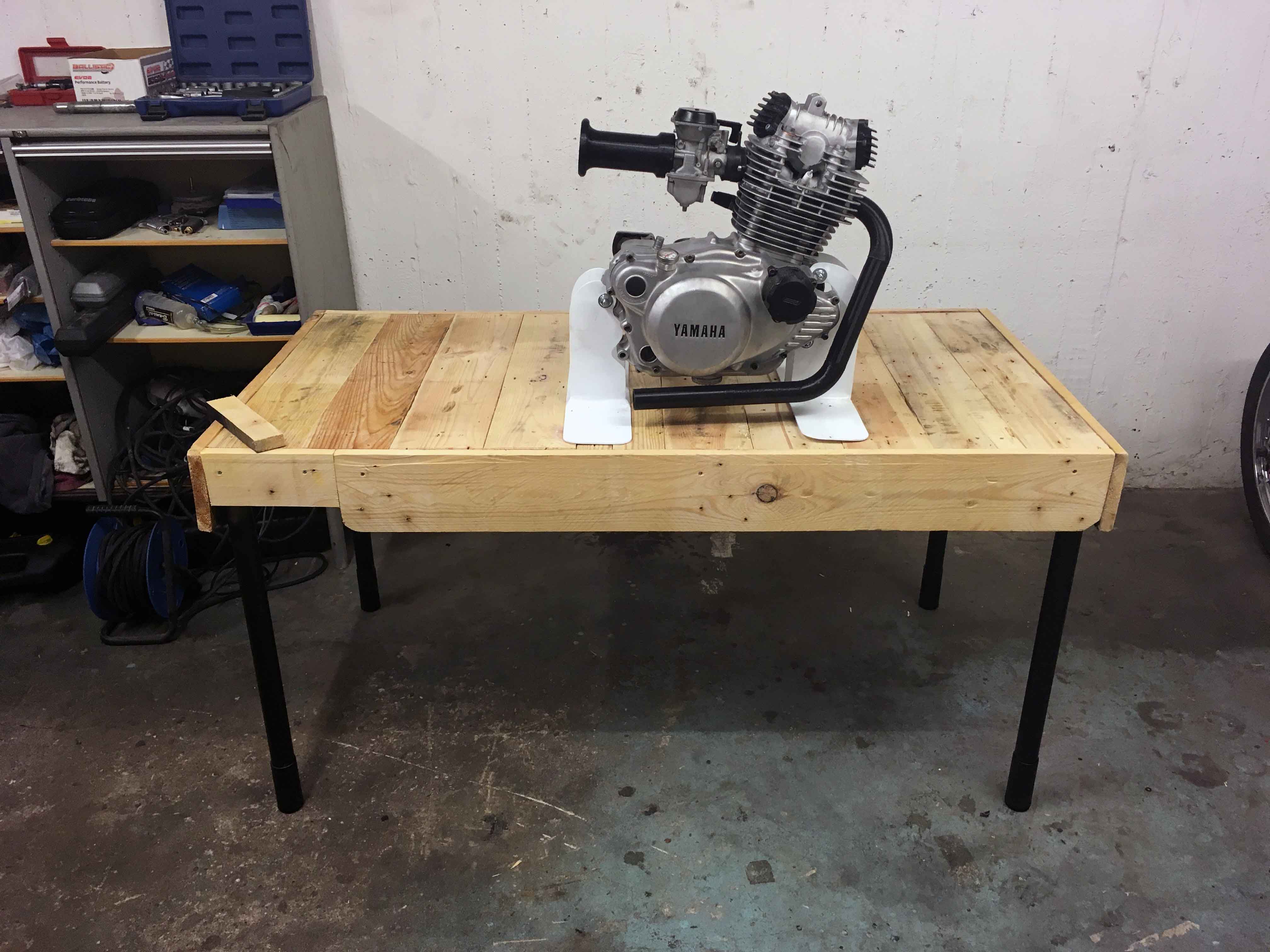

Managed to 'build' a 'rustic' table for filming some more install and tech vids. Then found some time to blast the engine as well. This time a pretty rough job compared to the last engine - running with the more time on performance things than looks! I actually tried soda this time too, but it just wasn't abrasive enough to remove the clear coat on the engine cases or the oxidisation.
Oh yeah, then put on some old 3D printed prototypes to dress it up a little and put it on the stand I made a last year. Never thought it would be so handy!
