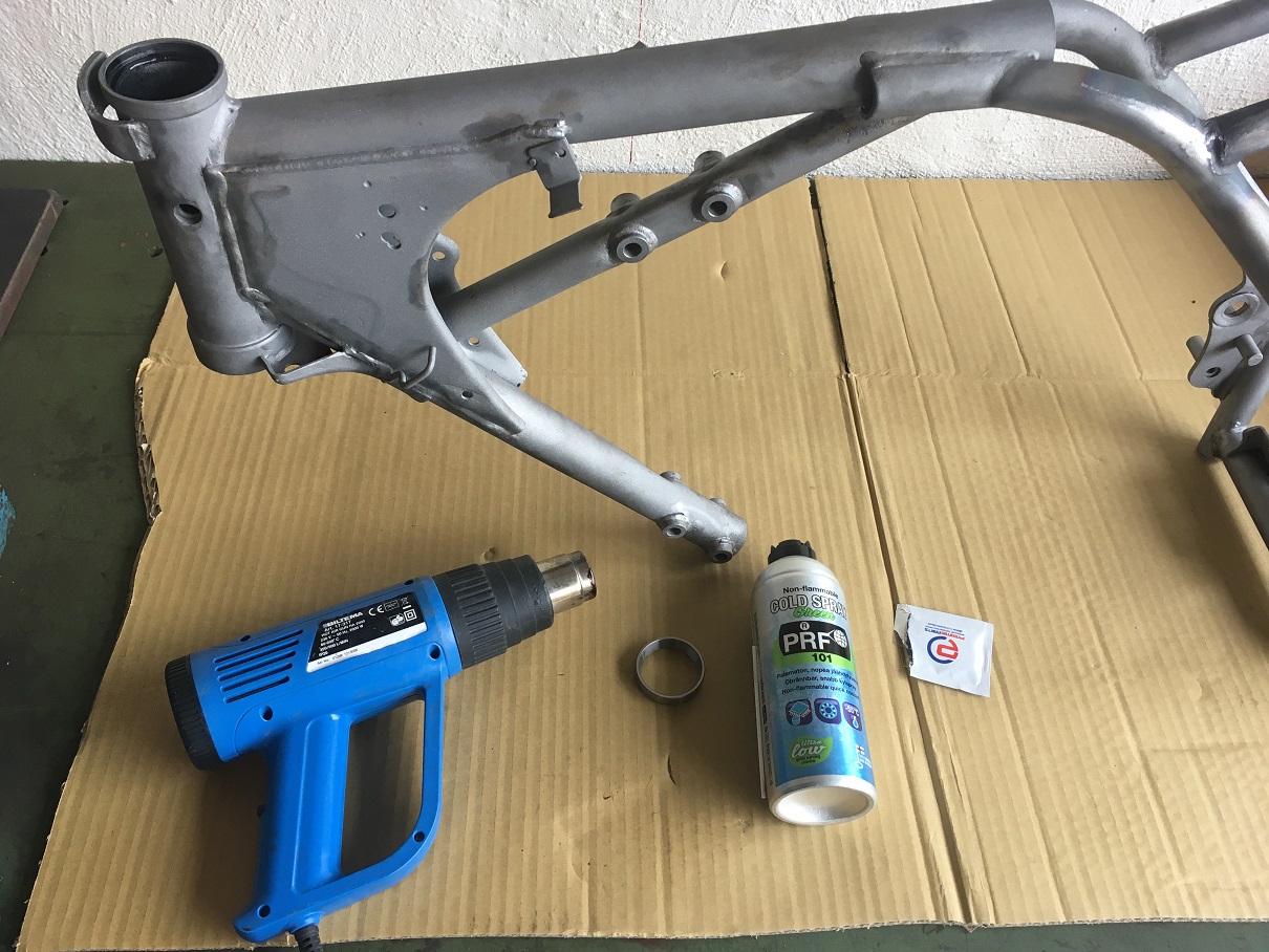

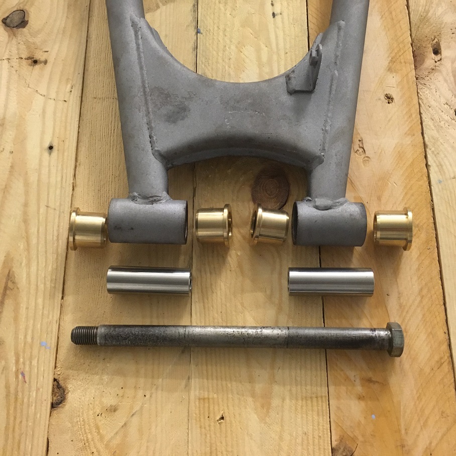

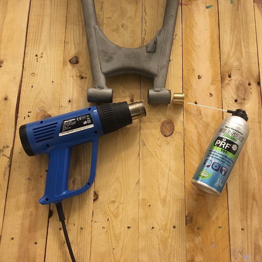

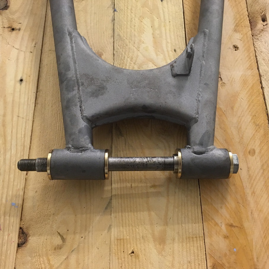

I used some freeze spray and a heat gun to help with the installation of the tapered steering head bearings and the custom bronze swingarm bushings. It seemed to help and worked pretty well!

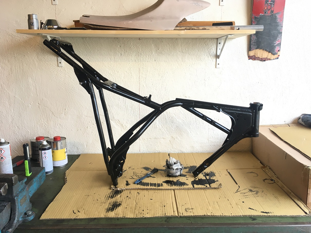

Then painted two coats of Rust-Oleum Combicolor (as suggested by a few of you!) by hand with a paint brush. This paint is great and I am happy with the result - the hand done look. I will be trying to achieve this with a few other parts too - like sanding some of the aluminium parts and leaving light sanding marks. It will be a nice touch I think to a bike with quite a few CNC parts.

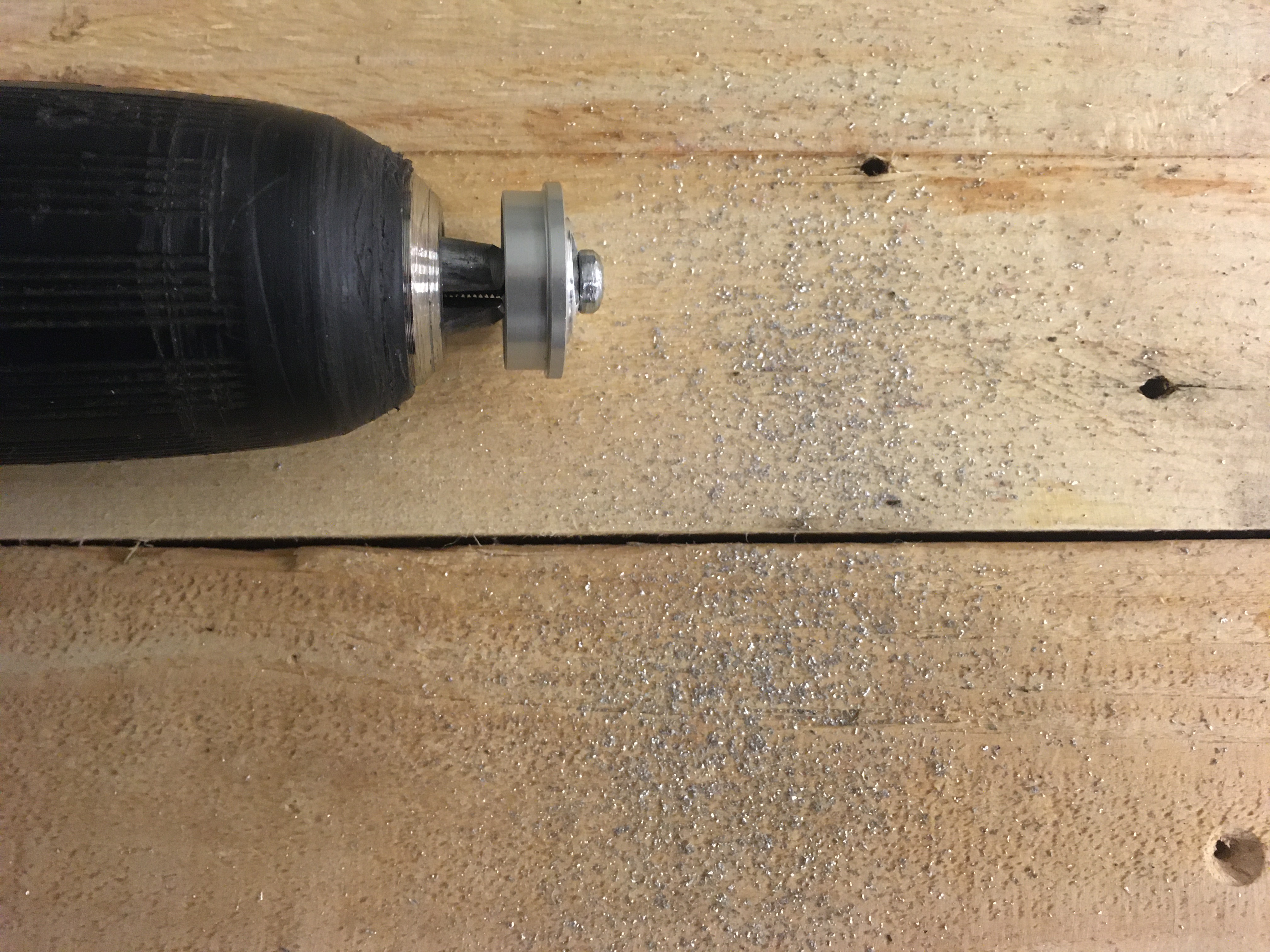

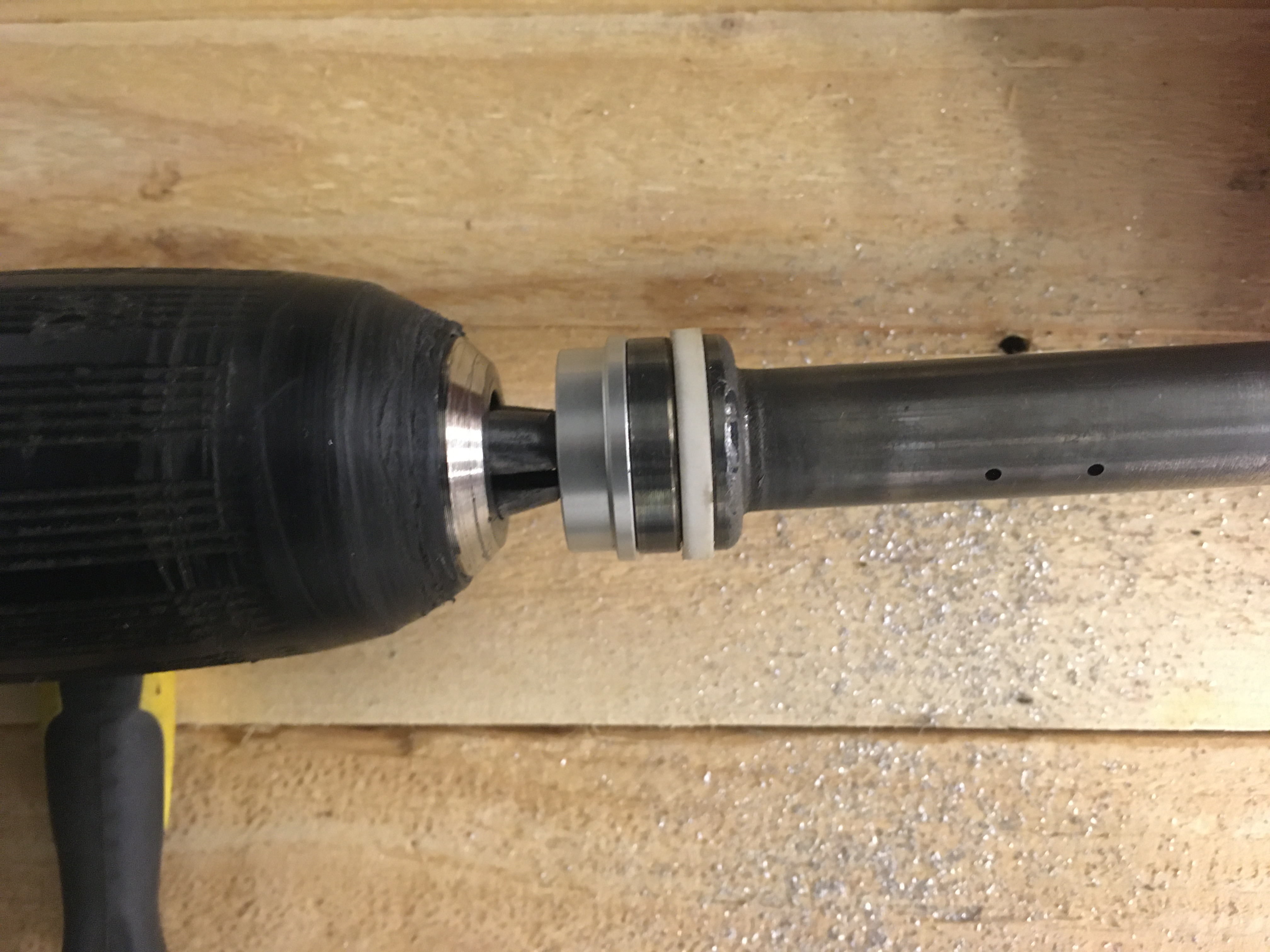

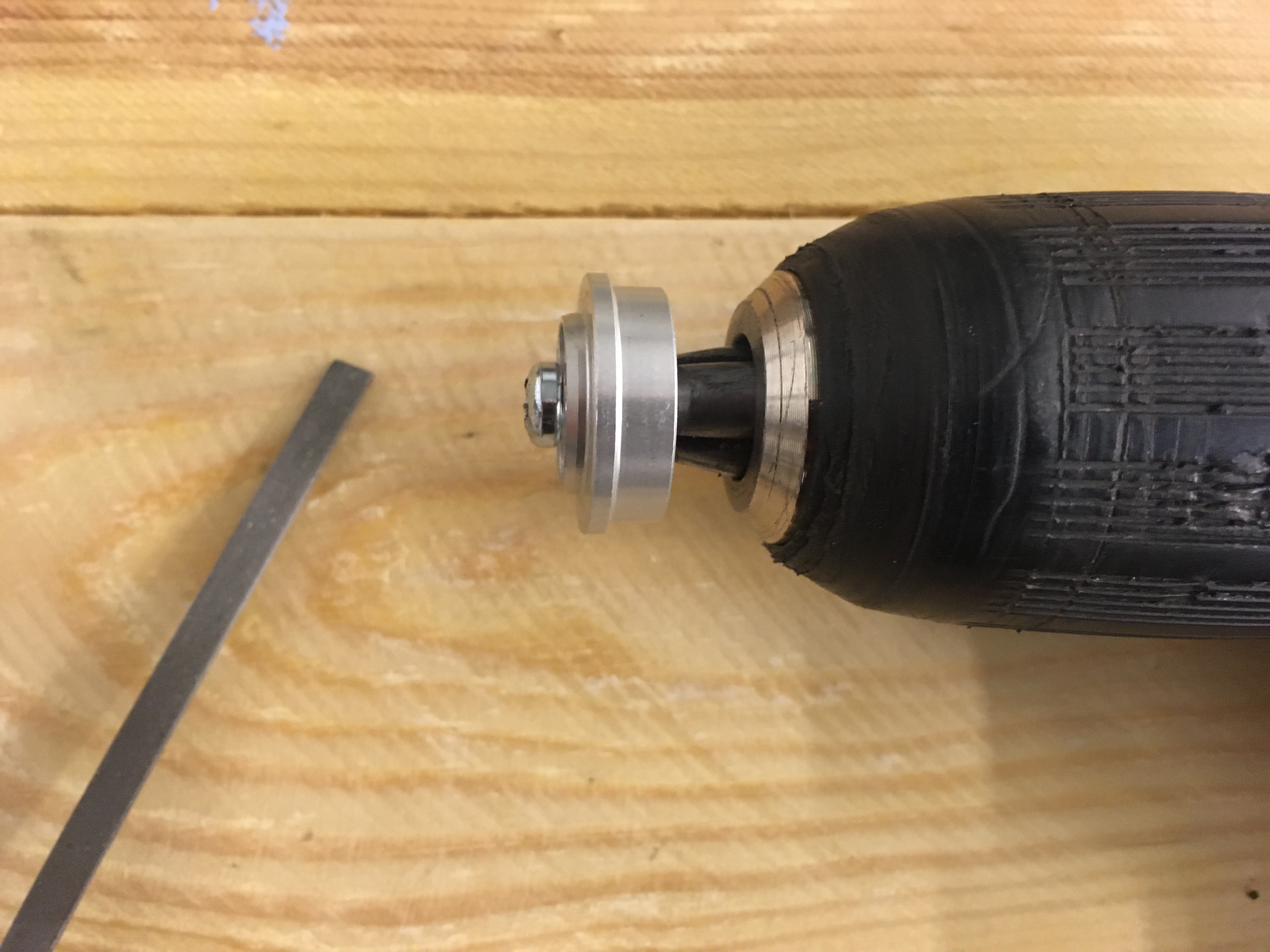

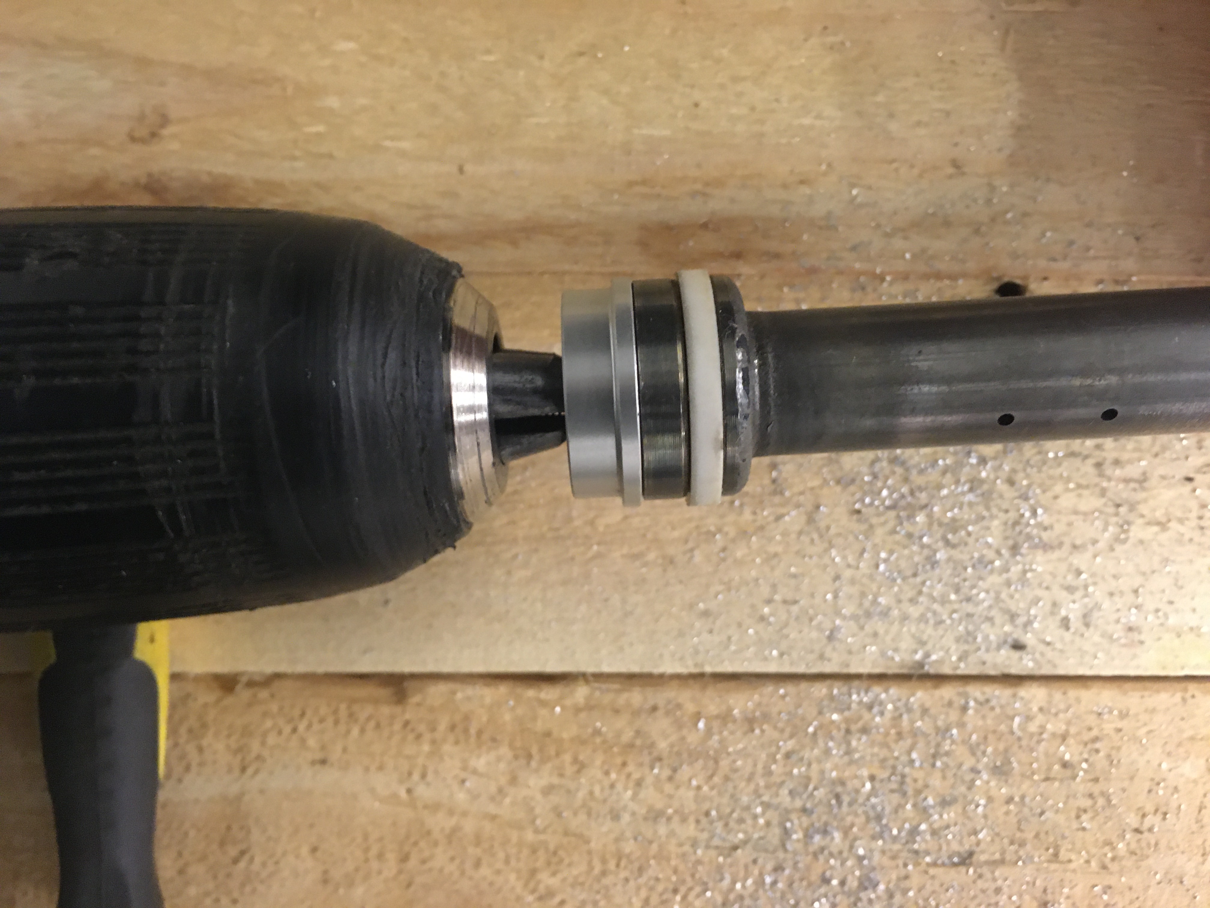

Then it was time to make those fork emulators fit the SR's damping rods... I don't have a lathe but could have outsourced the job. But then I thought that this kind of job does not need to be too accurate, they just need to fit. So I used a battery drill and a file as a makeshift lathe :p
Can't wait to put these trick forks together! Using many of the Minton Mods here :) I bought some nice liquids too ;)

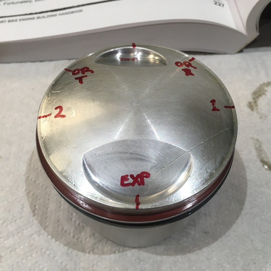

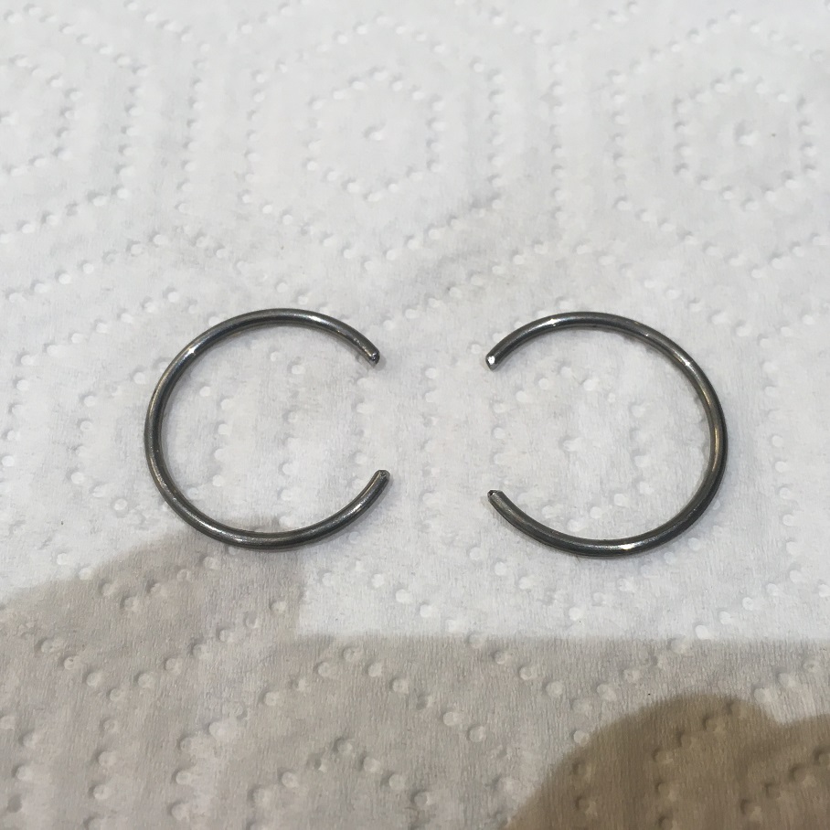

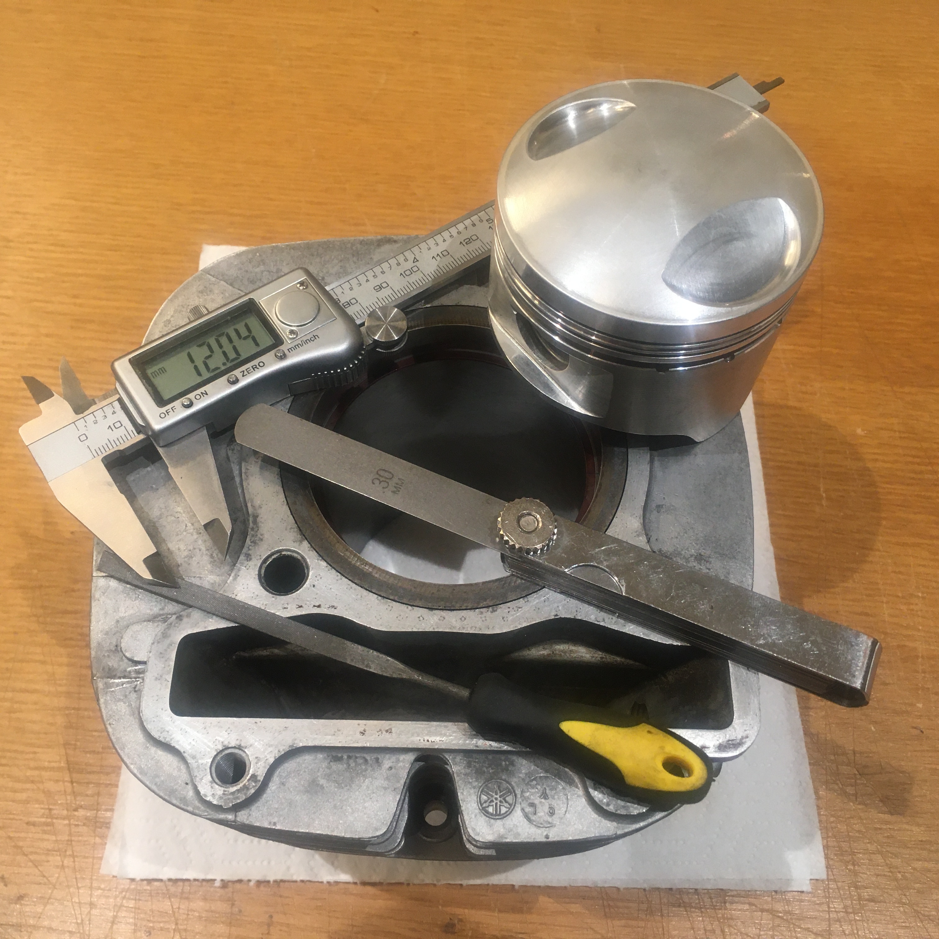

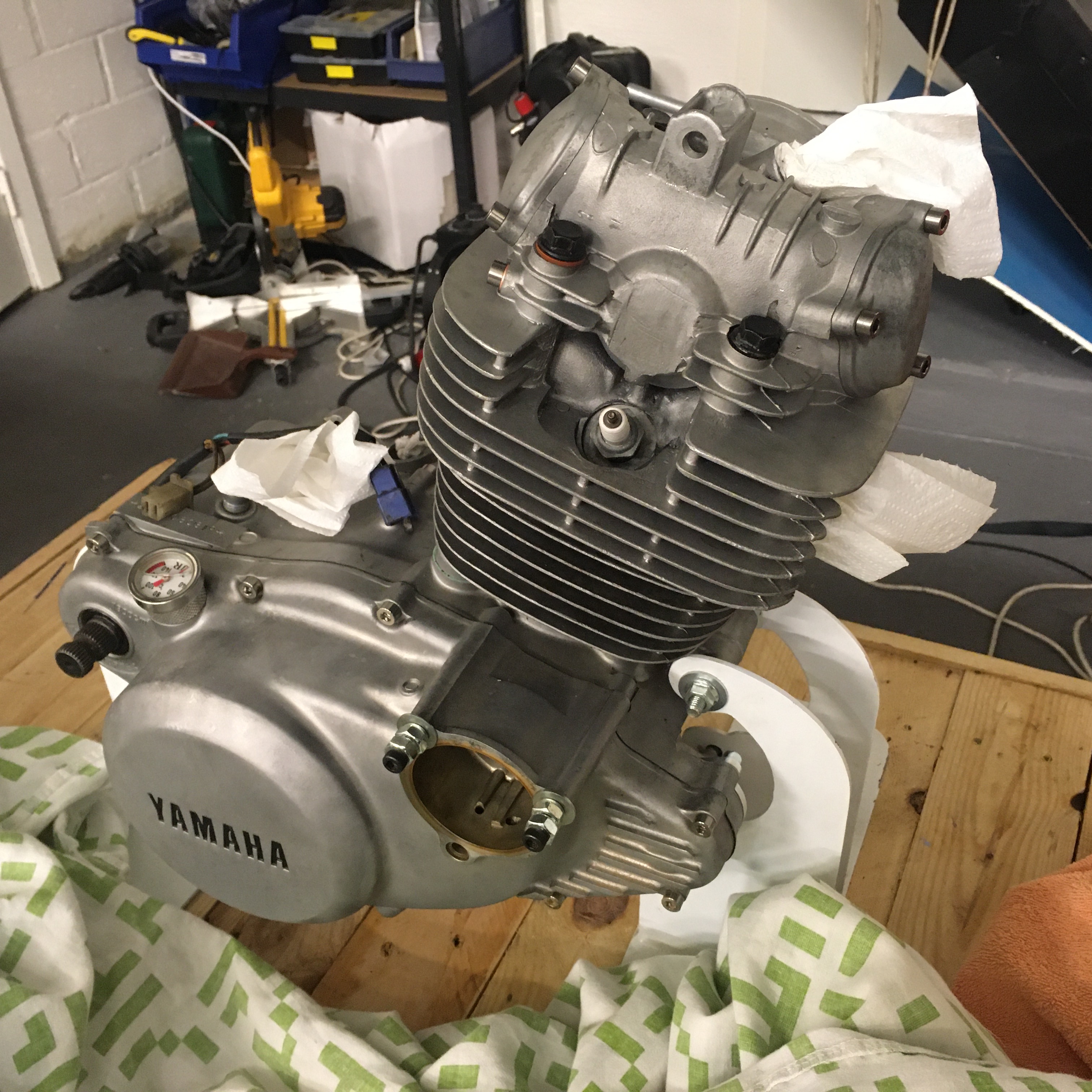

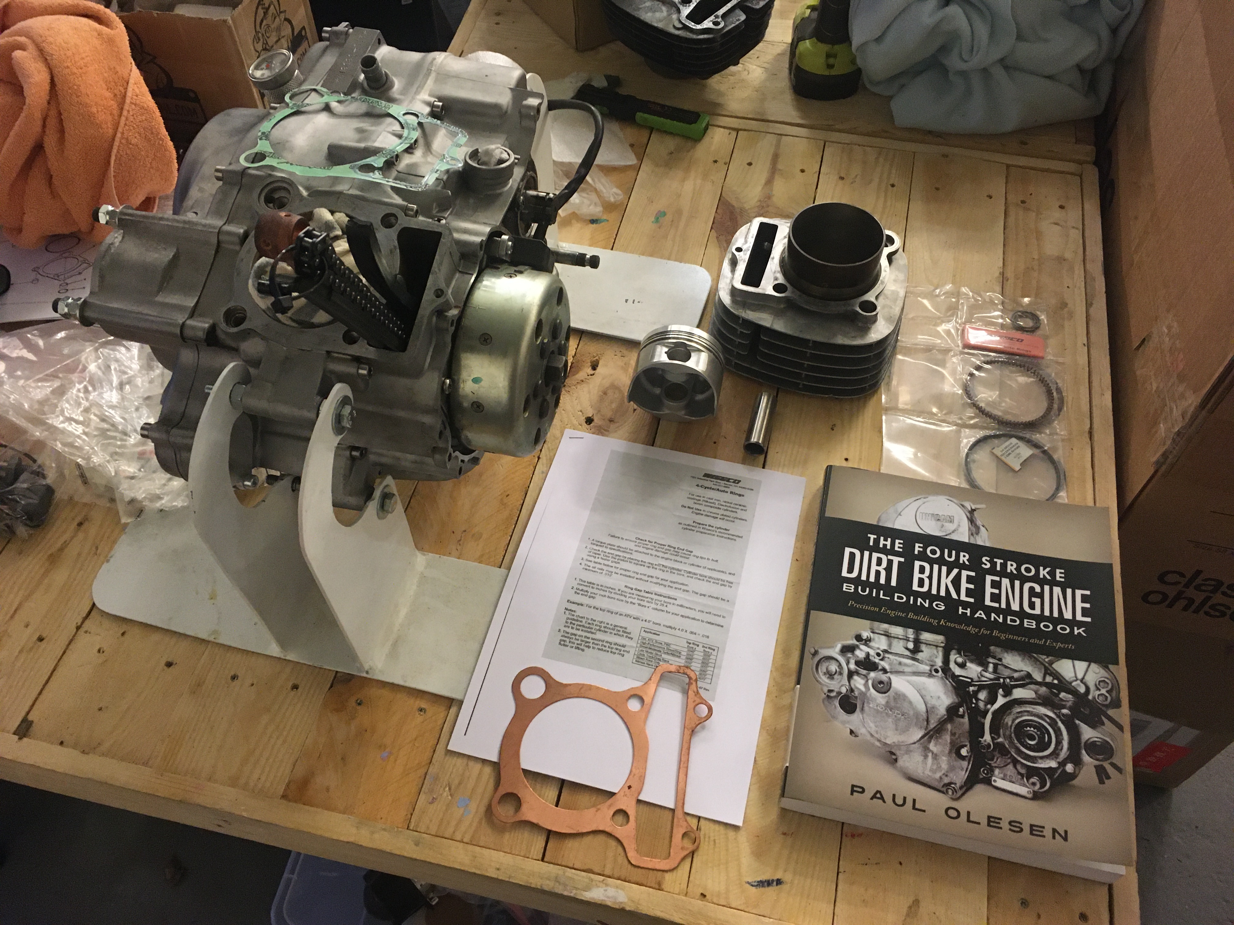

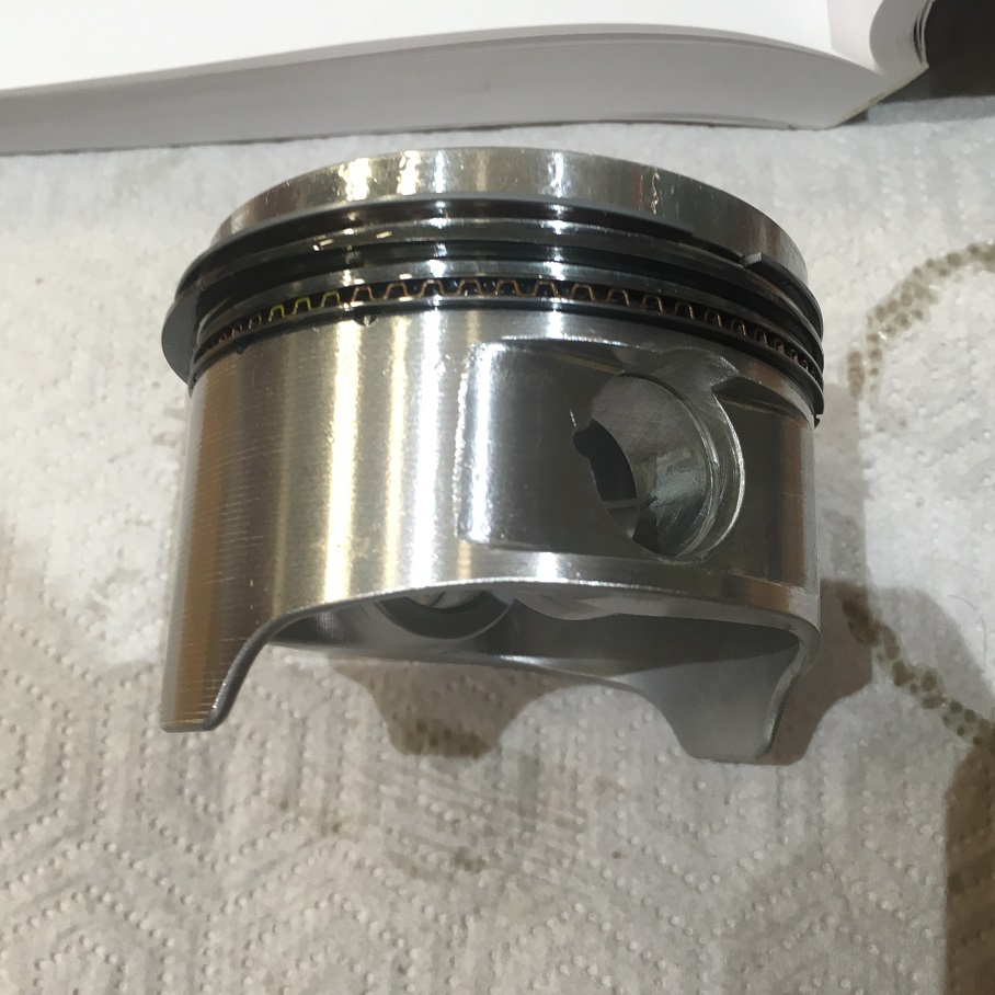

And time for engine assembly! Piston rings gapped according to the Wiseco guidelines.
It is easy to get trapped down a rabbit hole of disinformation about engine assembly and tips, and after reading countless articles and forum posts, its nice to just stick with one method, follow one mans advice and have that book on hand. What is my verdict? There is several different ways you can successfully assemble an engine, period.

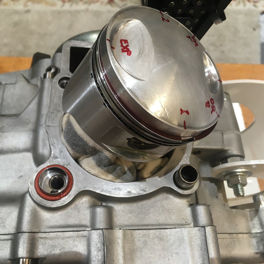

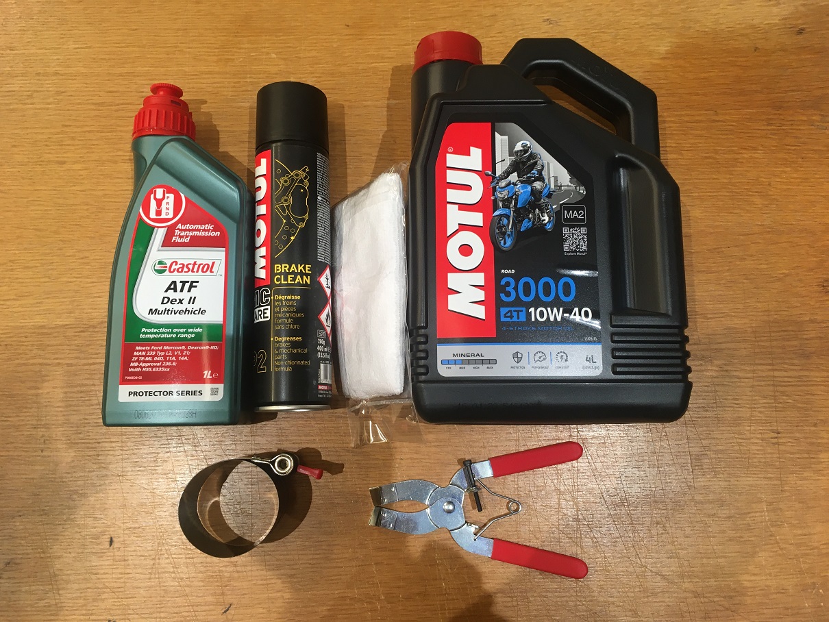

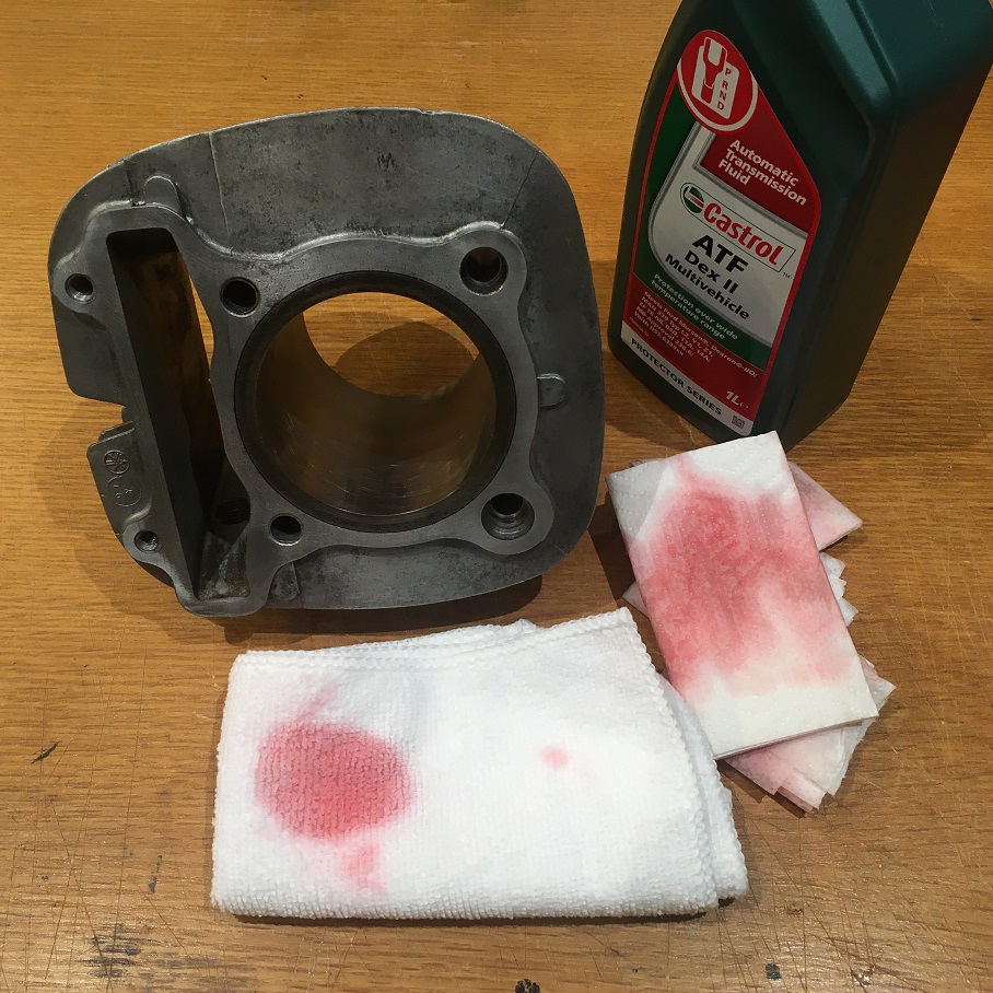

I ordered a piston ring compressor and a ring expander tool... Both sucked and I ended up doing the whole thing without them anyway - waste of money. I also bought some brake cleaner some ATF and a lint free cloth to get the barrel real clean after the boring and honing the shop did. Plus I ordered some good mineral oil for the engine break in.
The assembly went pretty went asides from the hiccups with the stupid tools. Like I mentioned in the previous post, I followed Wisecos guidelines through and through - so you will see the placement of the different ring gaps. I also filed the ends of the circlips (a tip from Paul Oleson) so that they were easier to install and didn't catch any edges or damage any aluminium on the way in.

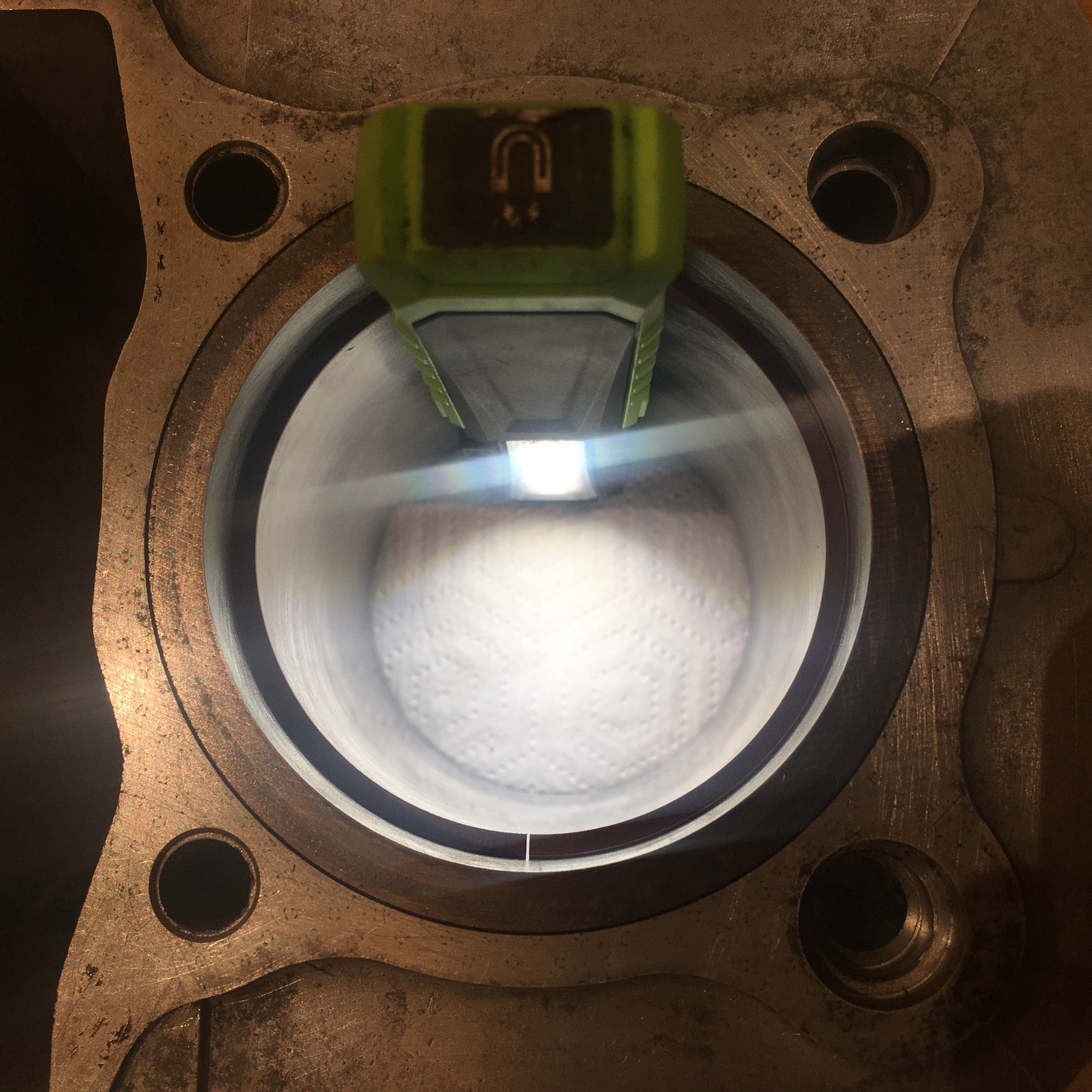

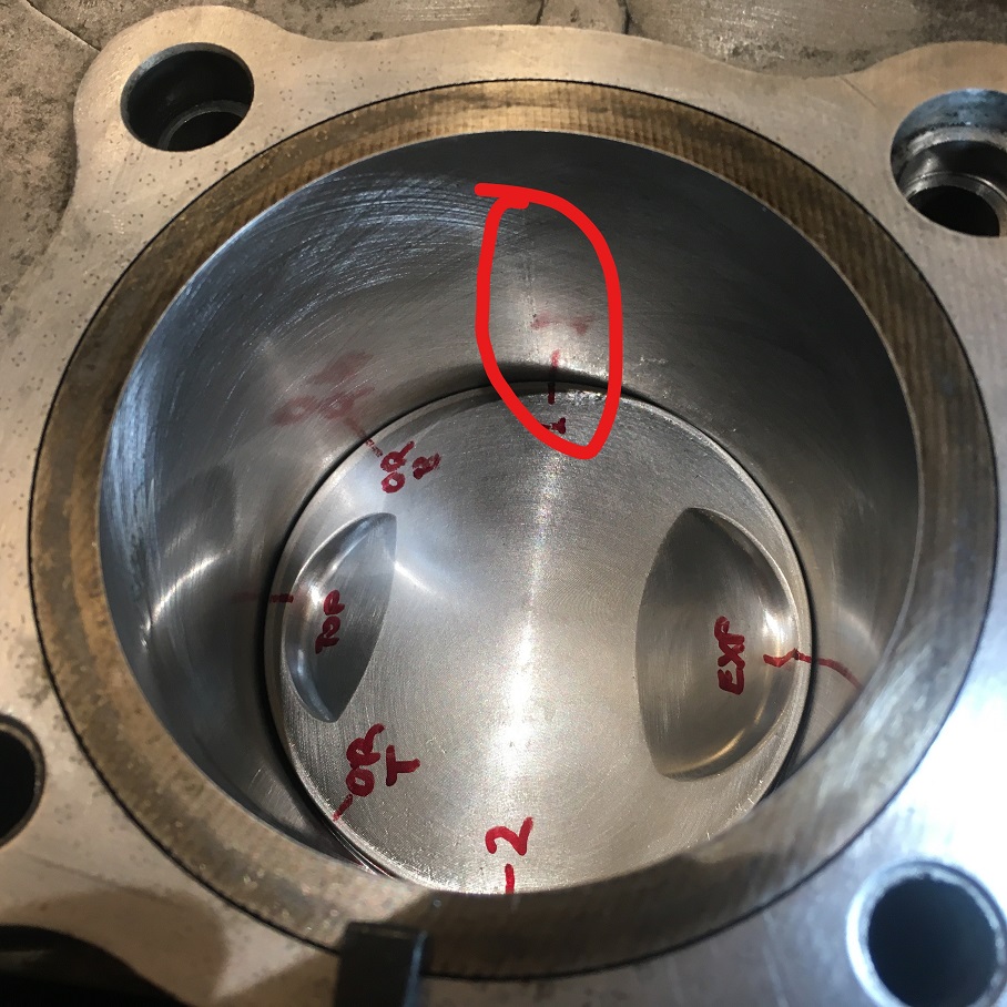

Once the cylinder was on it was possible to rotate the engine and check to see if the top ring gap was still in the position it is supposed to be - which is evident with a streak in the lightly oiled bore (red circled detail).
I got the head on with the copper gasket in between as well. I will button everything up with torque wrenches another day!
One thing I did not research so much about was the way in which a copper head gasket should be used. It is generally considered standard practice to 'oring' them around the bore. If you're not familiar with that, give it a quick google search, cool stuff. It ensures a gas tight compression seal. I did not do this and am hoping I won't need to - there are plenty of people that have successfully used copper head gaskets without oring-ing them. However, if I get head gasket failure when I run the engine, I will know why and will know what to do... It'll be 'off with 'er 'ead! A great advantage of this engines cylinder and head interface is the use of orings around the oil feed galleys - in contrast to many car engines which rely on the head gasket to seal oil and water passages as well. So there was no need to use silicone around those areas like some people suggest (for copper head gaskets in car engines).

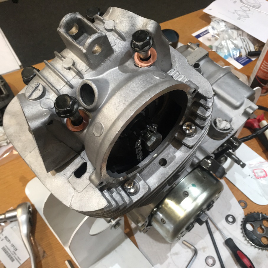

And with the use of two different torque wrenches, the engine was buttoned up again! Stoked :)

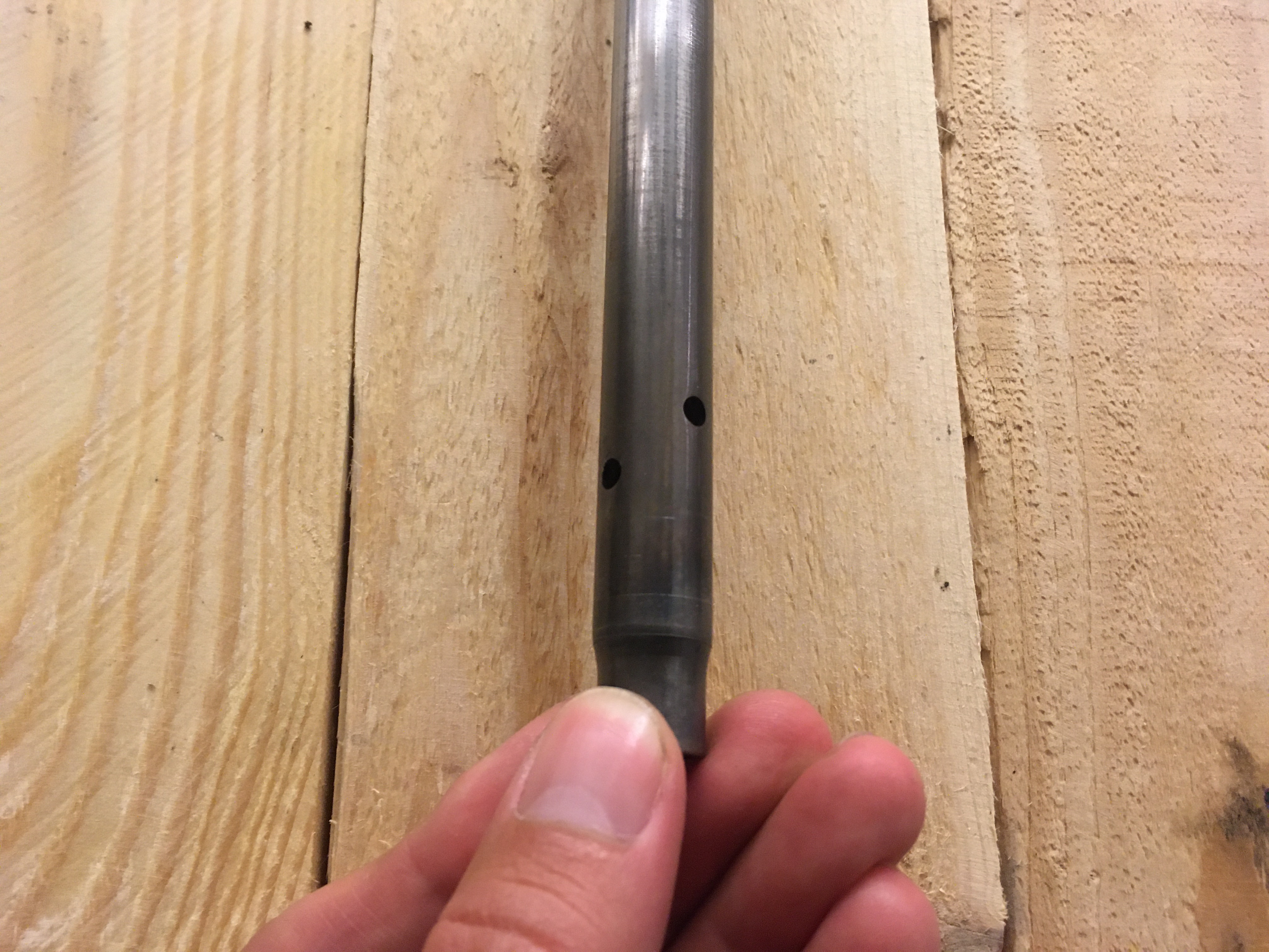

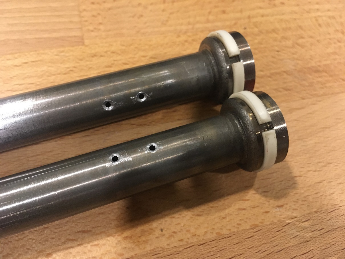

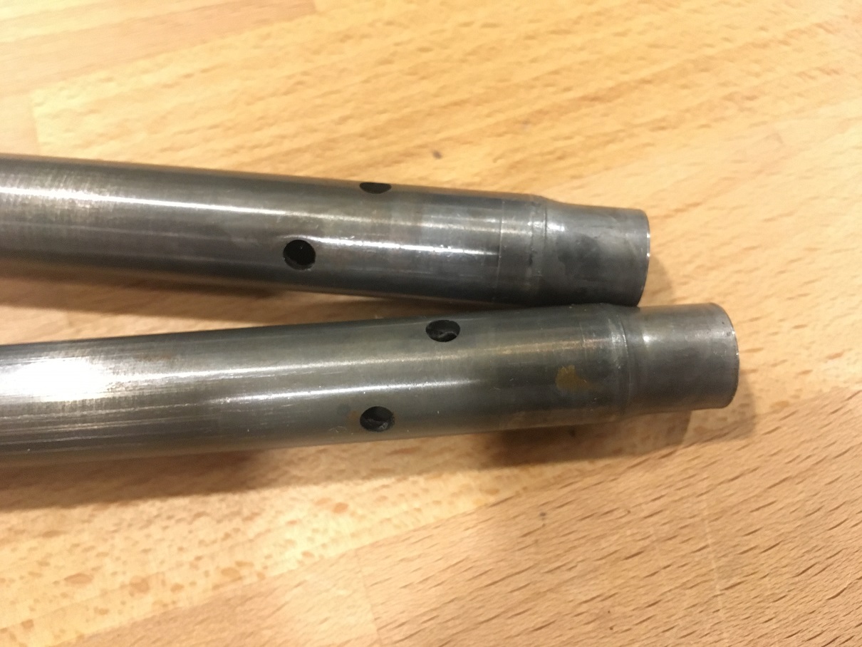

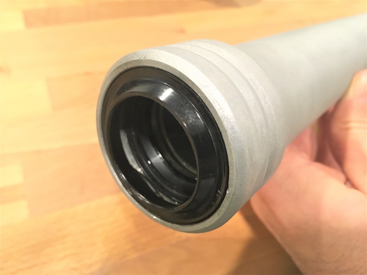

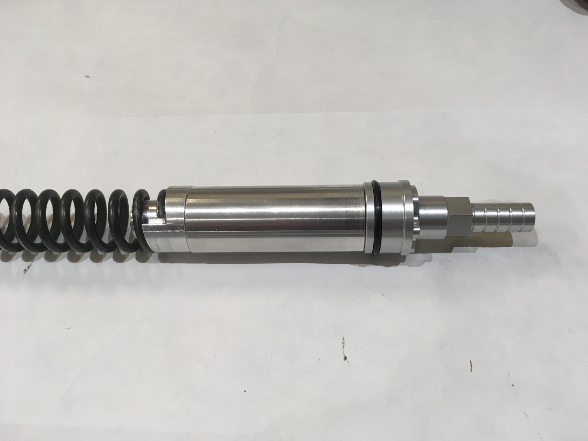

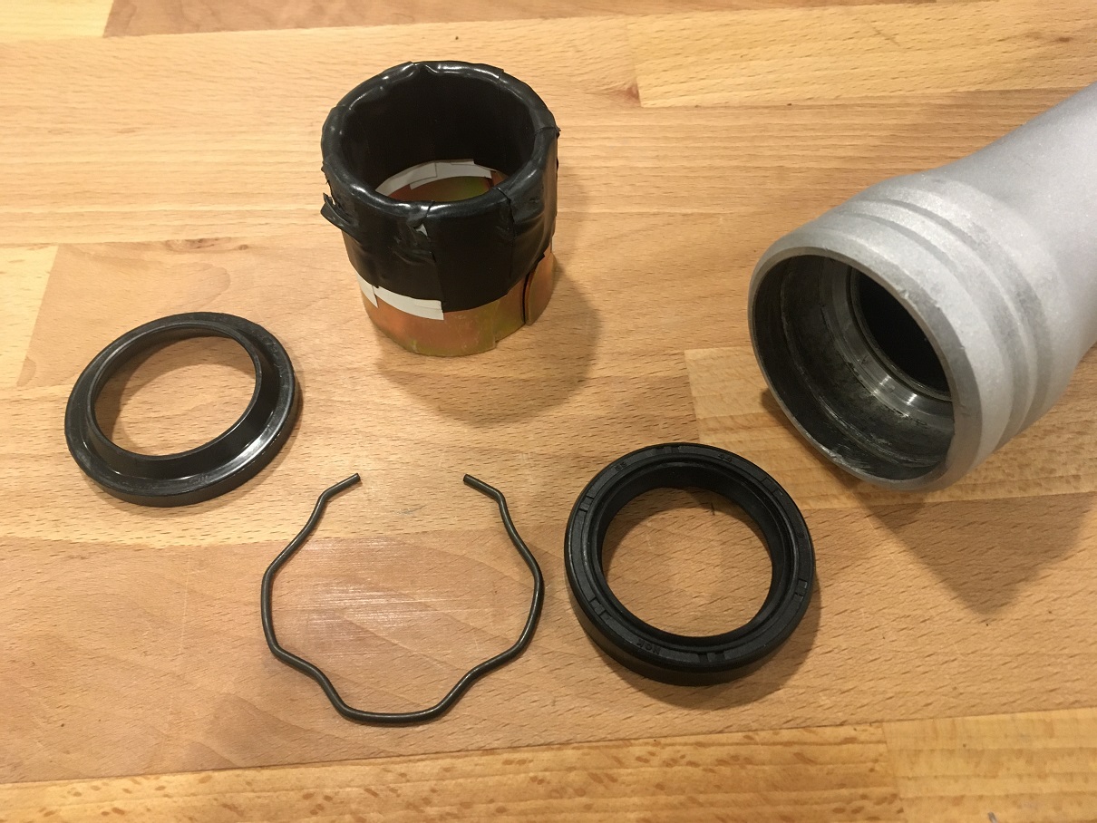

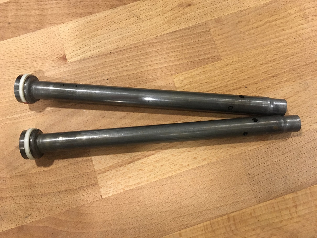

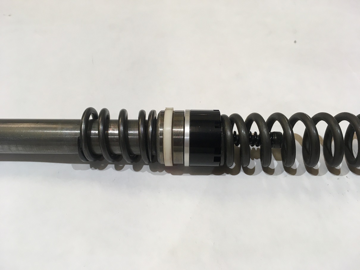

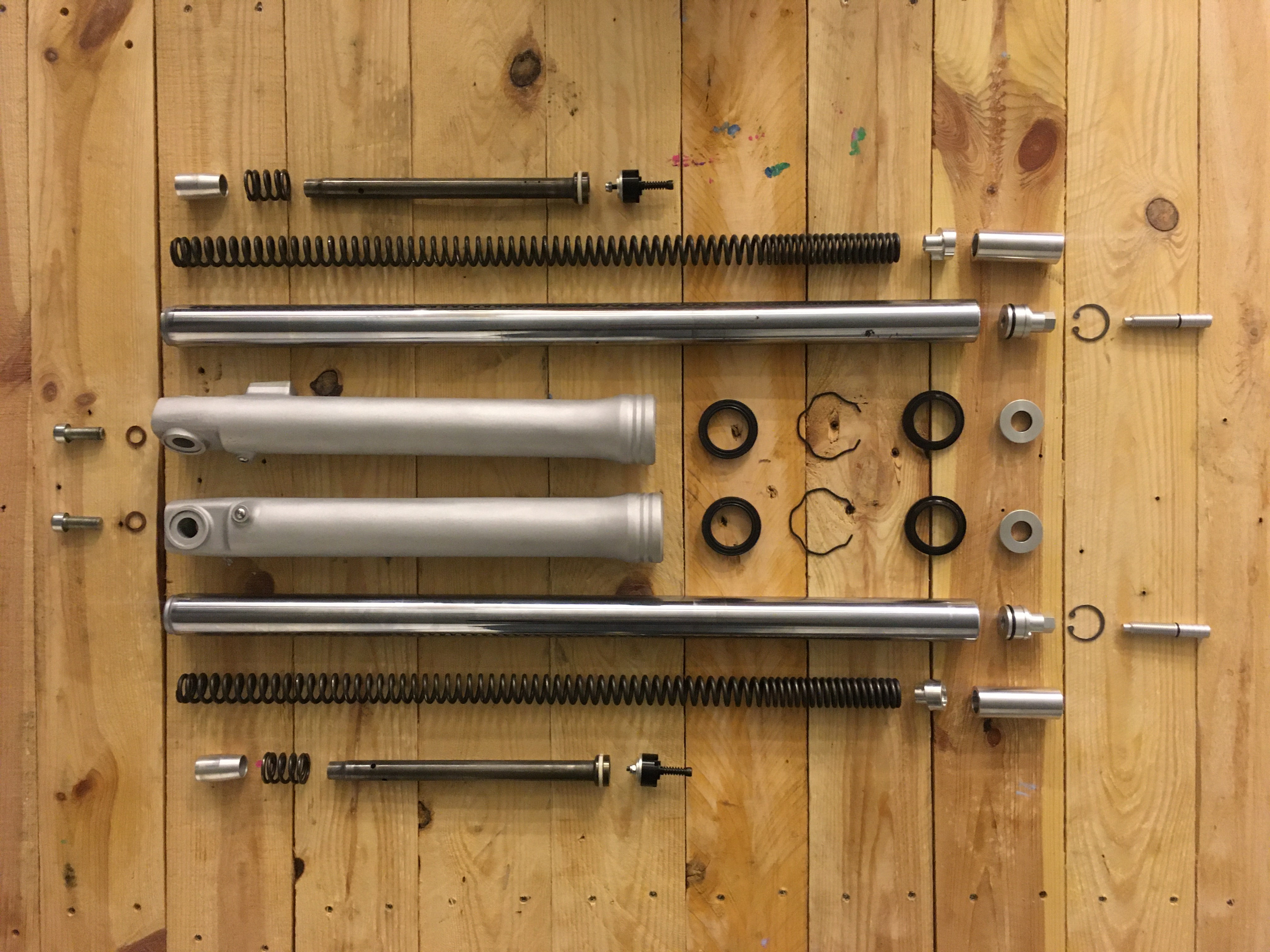

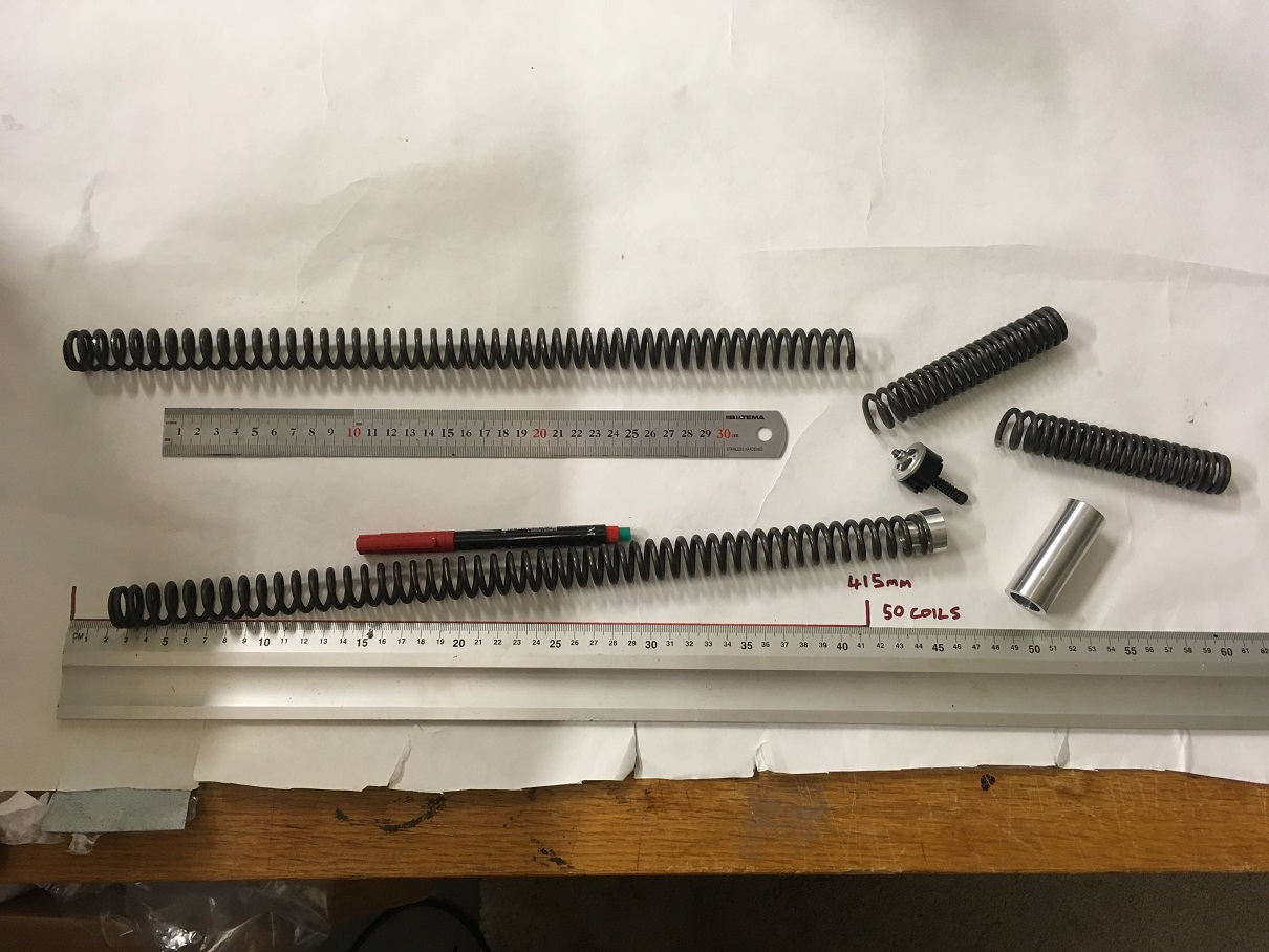

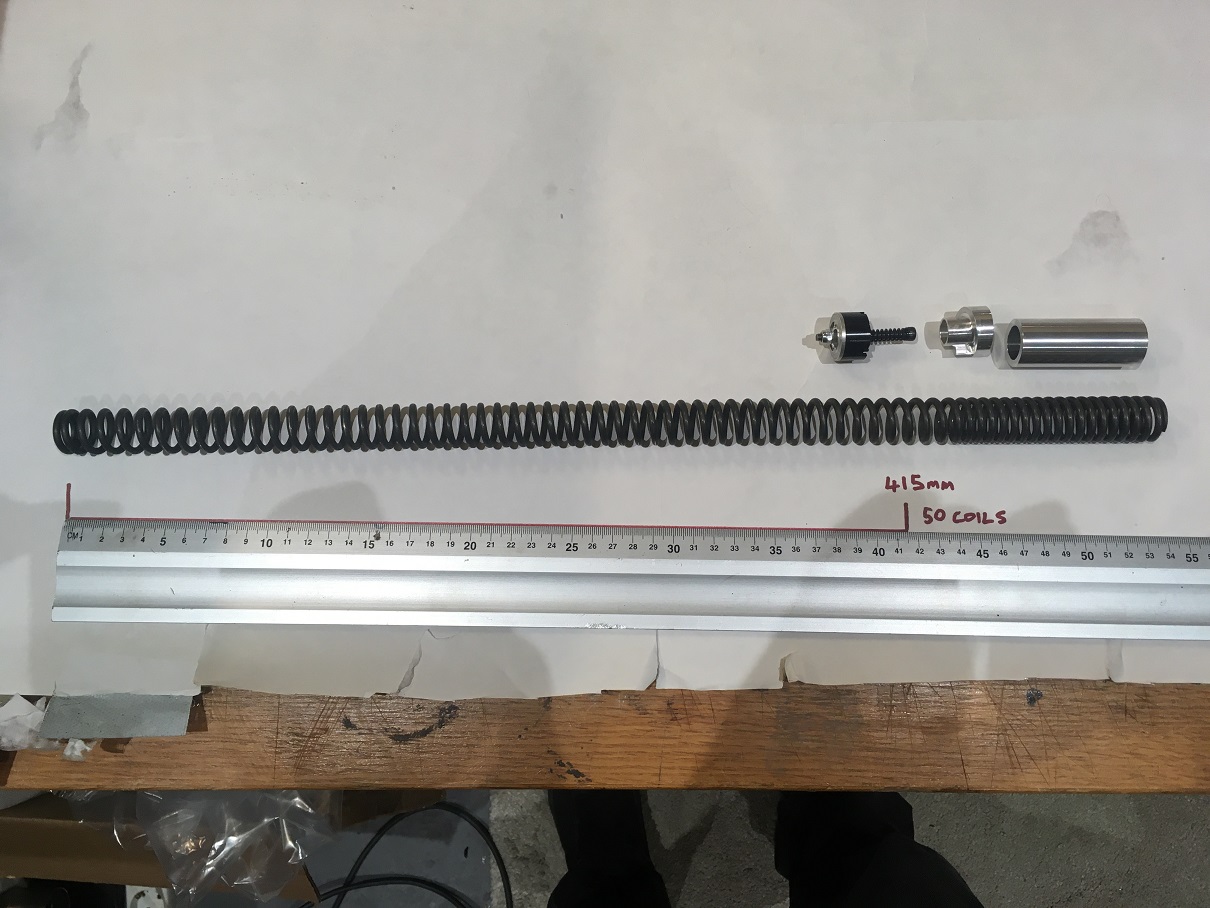

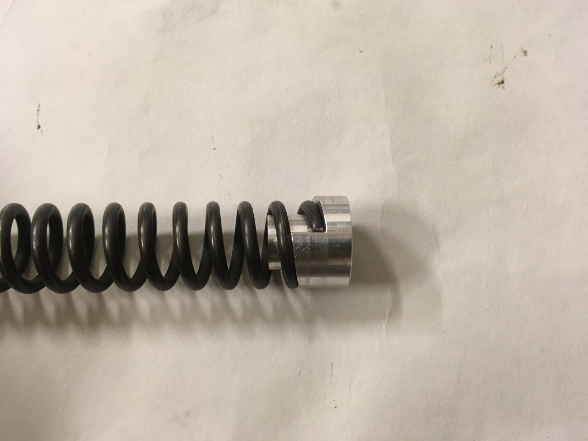

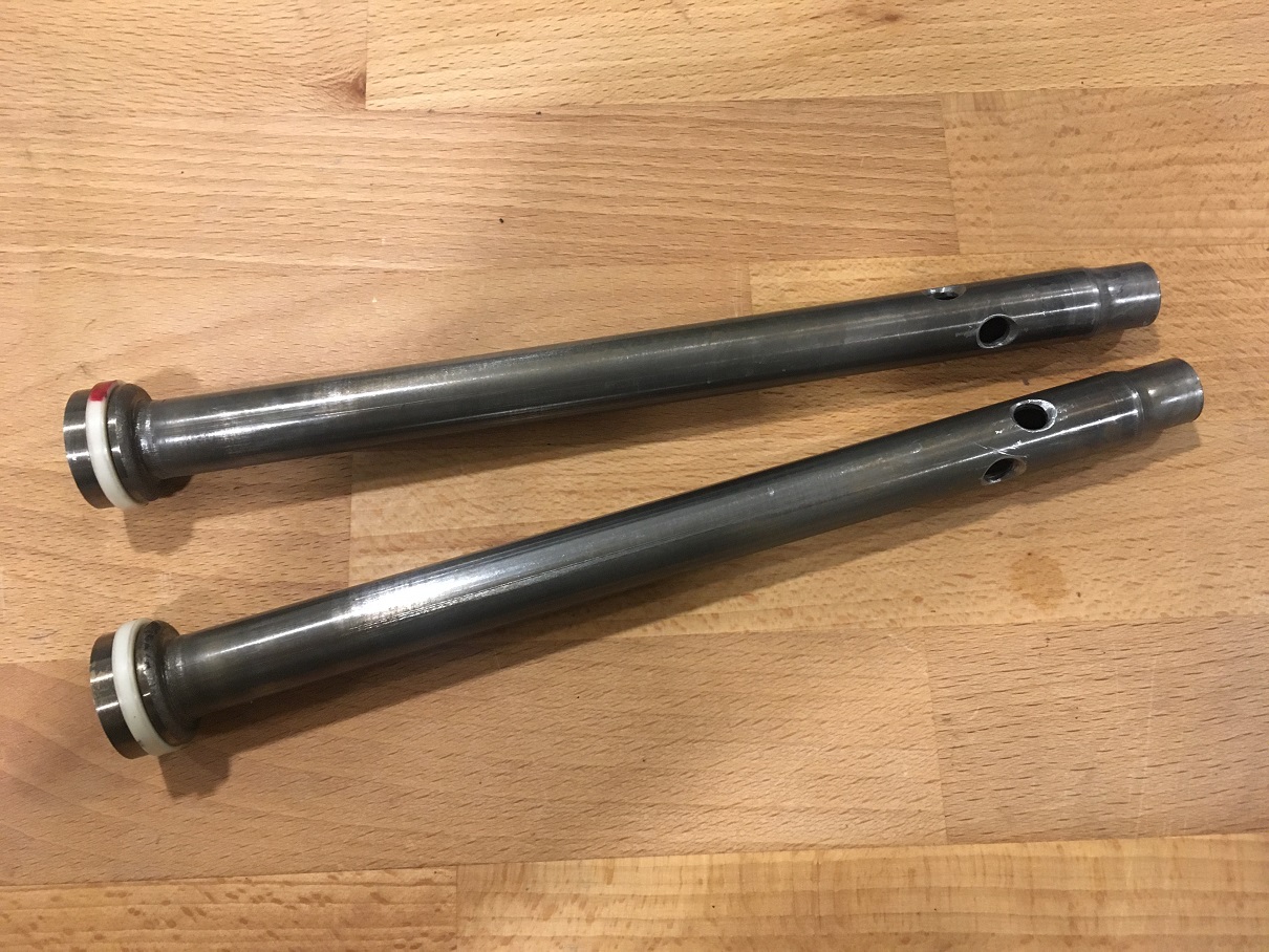

I finally got the fork build complete as well. Just a recap on the forks...
Many mods are, or were inspired by the infamous Minton Mods (done to the XS650). And here is the list:
  • 33mm fork seals instead of 32mm seals - to reduce stiction. These seal very well so far, surprisingly!
  • Drilled out and chamfered damper rod holes (rendering them obsolete in preparation for the...)
  • Fork cartridge emulator valves - for much better controlled damping
  • Cut and spaced fork springs - resulting in single rate springs at 4.7N/mm - a 42% increase over stock, suggested rate for a fully kitted rider weight of 85-90kg
  • Custom adjustable preload fork caps - for a +30mm range of preload
  • Removable adjustment rod to expose a fork oil filling hole - meaning the caps don't need to be removed to adjust fork oil level
  • Shaved/lightened and blasted fork legs
Now these must be the trickest SR250 forks ever made? What would you prefer, these or an USD modern fork swap?
A couple more pics...

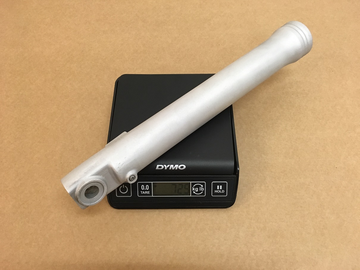

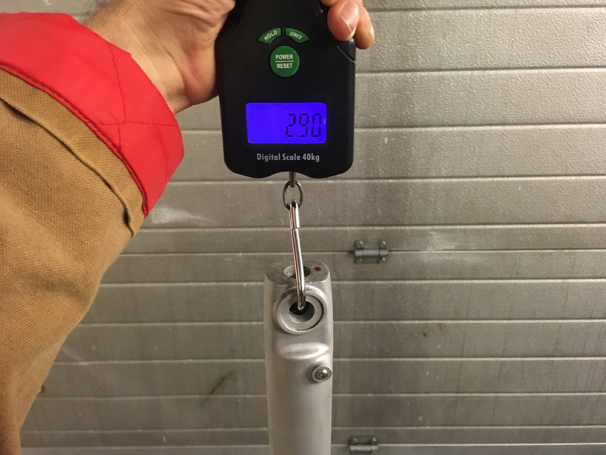

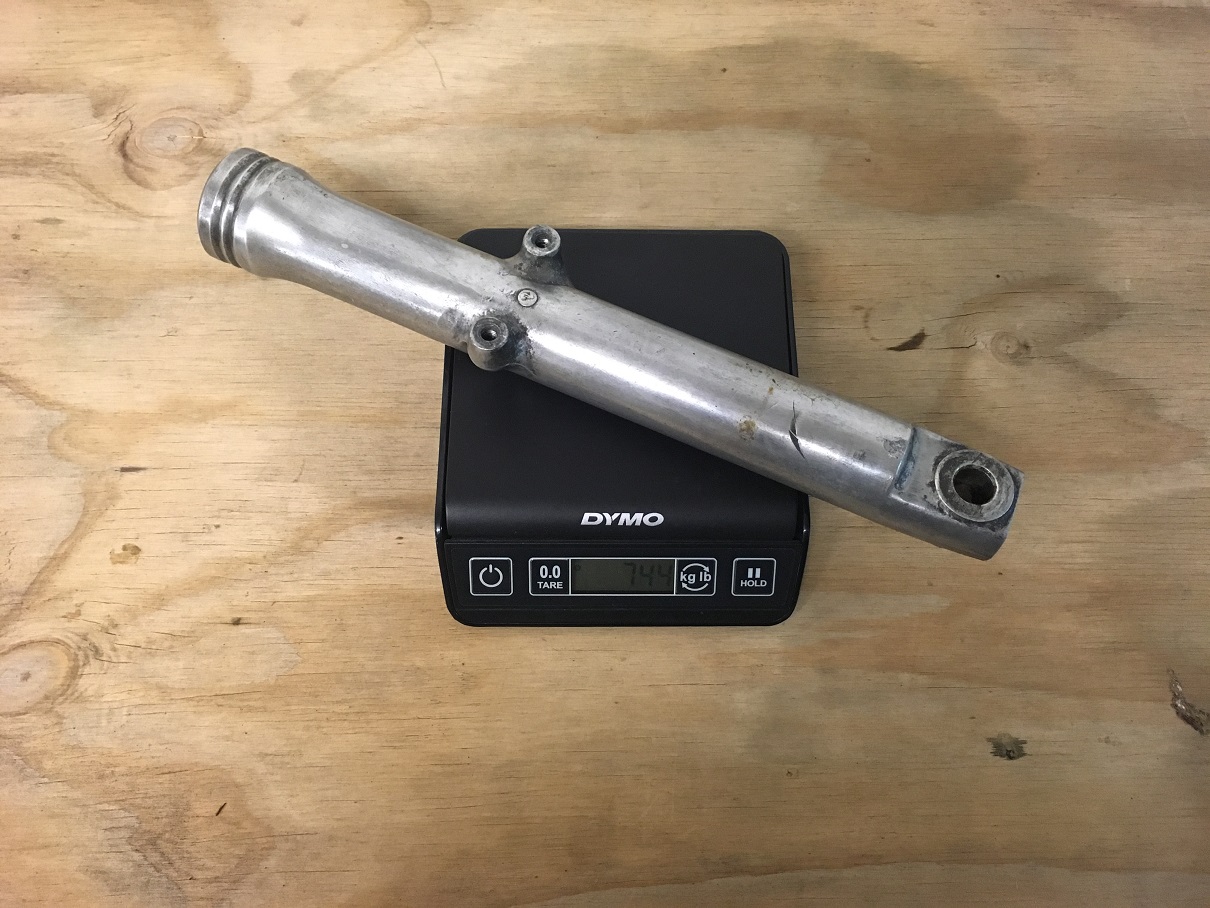

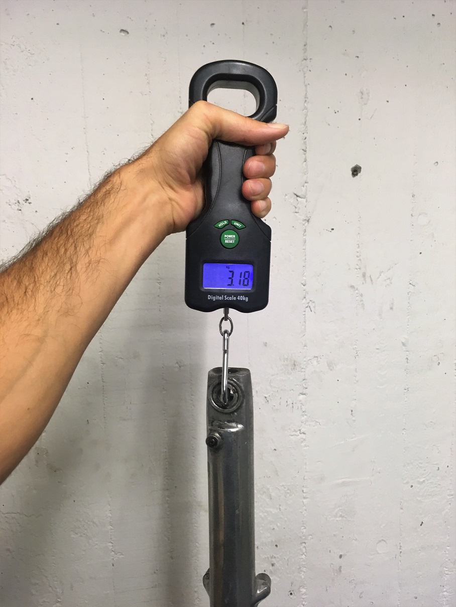

And to continue the ridiculousness of the weight reduction program... 480g reduction on the entire fork assembly - that is almost half a kg! With 67g being removed from the fork legs - which is piss all but it is also unsprung wight, which is good! These weight comparison photos are taken 2 years apart, that is embarrassing :D

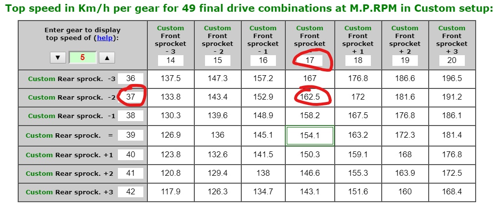

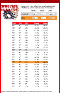

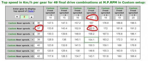

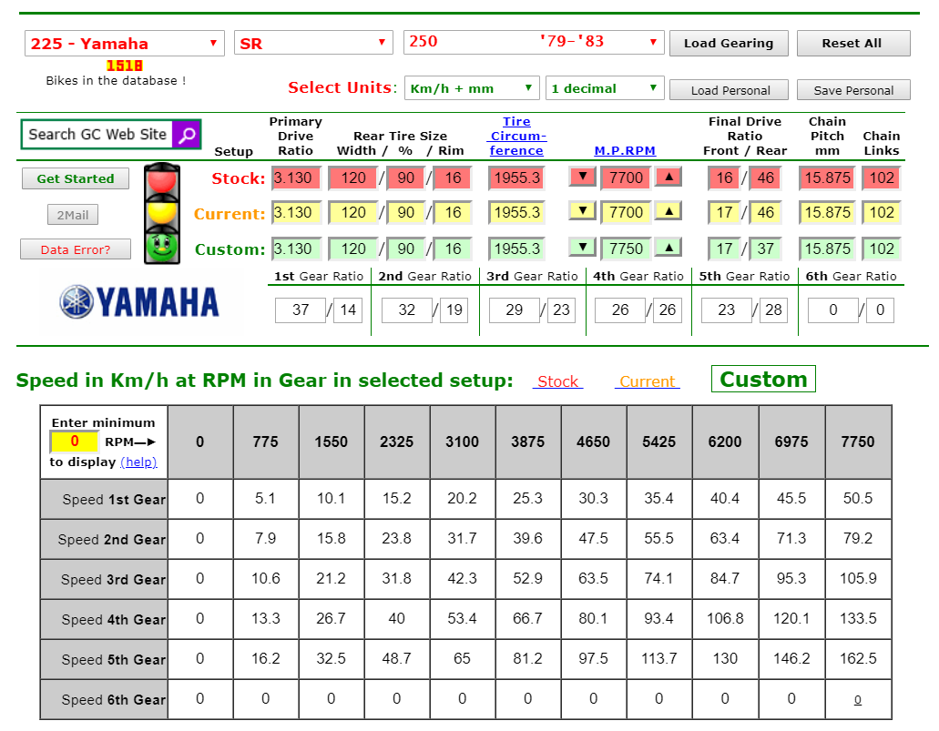

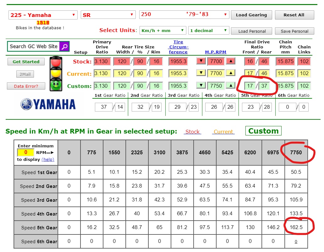

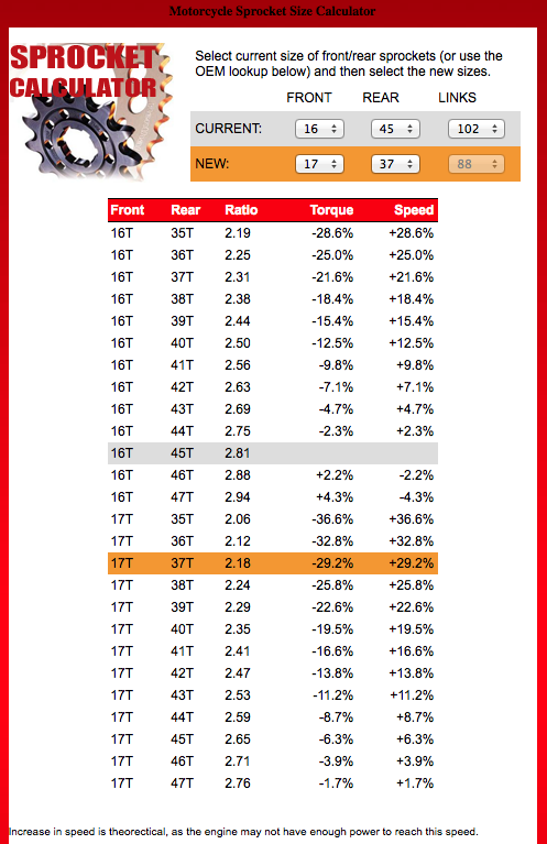

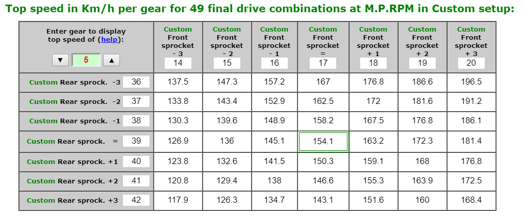

I haven't covered this in any previous posts so here goes...
Asides from the obvious obstacles for the SR achieving 100mph being a) lack of/enough power, b) weight and c) aerodynamics, there is another one that is less obvious but equally important... Gearing!
Even with a raised rpm ceiling with this engine, it will still not be able to turn the rear wheel fast enough with stock gearing to even get close to 100mph. I used a few online tools to calculate different top speeds with different max rpms with different gearings (sprockets). From previous knowledge and testing, I know that the max front sprocket size is 17T (up one from the stock 16T) - because any larger starts interfering with the crank cases, which means quite a drastic change to the rear is also needed. By looking at the calculations it looks best to run with a 37T rear sprocket (down from 46T stock). This means that when achieving the engines current max power rpm (7750rpm) a top speed of 162.5kph should be achievable. Now hoping that the engine will rev a bit past that and make power past that (with all the upgrades), that seems reasonable. Although it doesn't leave much room for error - so I decided to try a 36T to have a little margin.
And, running with the theme of weight reduction on this project, I saw the sprocket as a golden opportunity to continue that theme. The stock JT steel sprocket weights exactly 1kg - making it an easy target for weight reduction. After searching all over the internet, I found these guys: https://www.supersprox.com/eshop/products.php?cat=13528
Based in the Czech Republic, they custom machine aluminium sprockets to your specification! I was thoroughly chuffed to find this. So now the sprocket is ordered and I am hoping it will come in at 500-600g :D

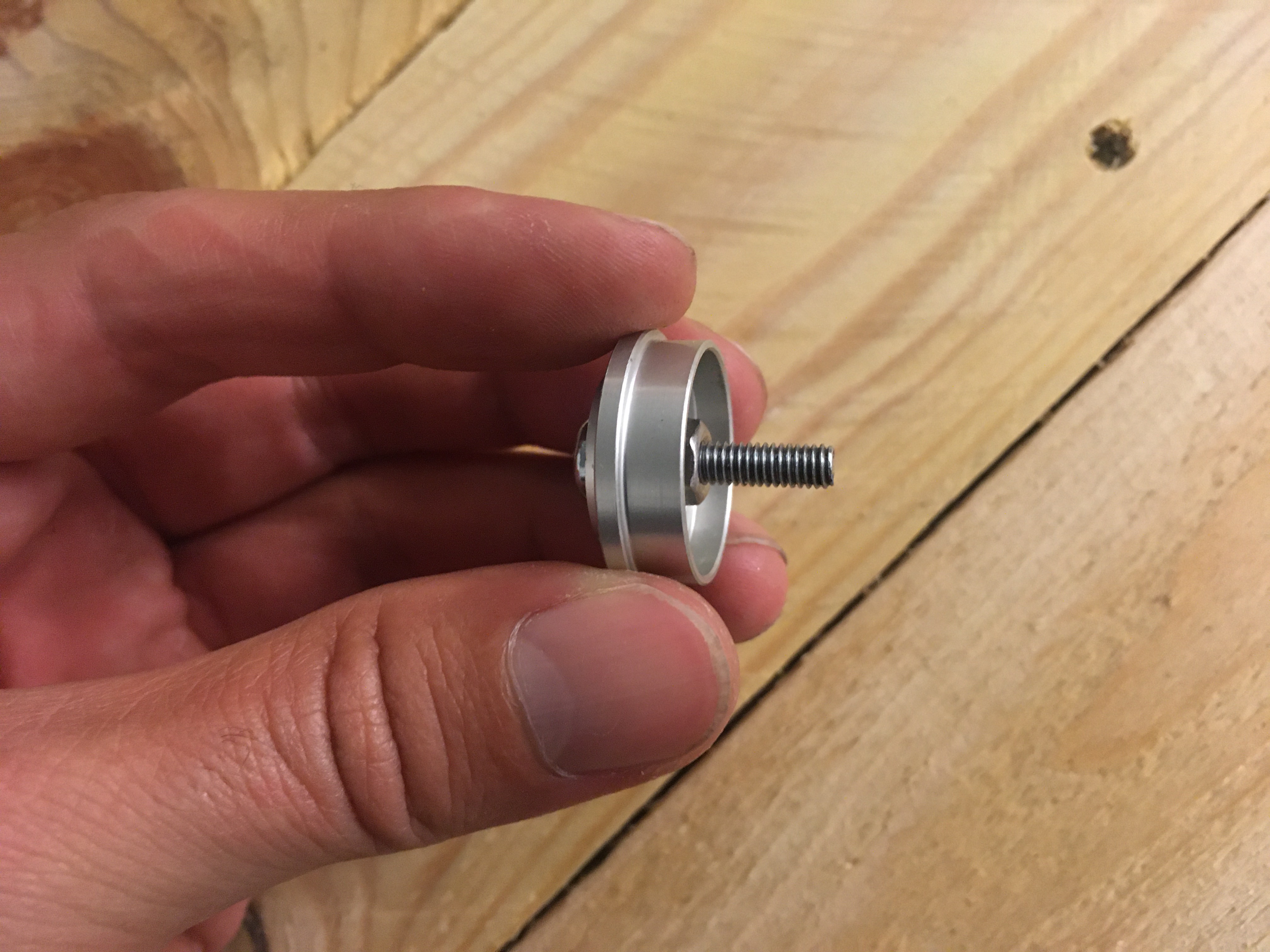

This is how I solved the hole in the head from removing the tach drive entirely... A Jadus Tach Plug plus a turned extension. Works sweet :)
