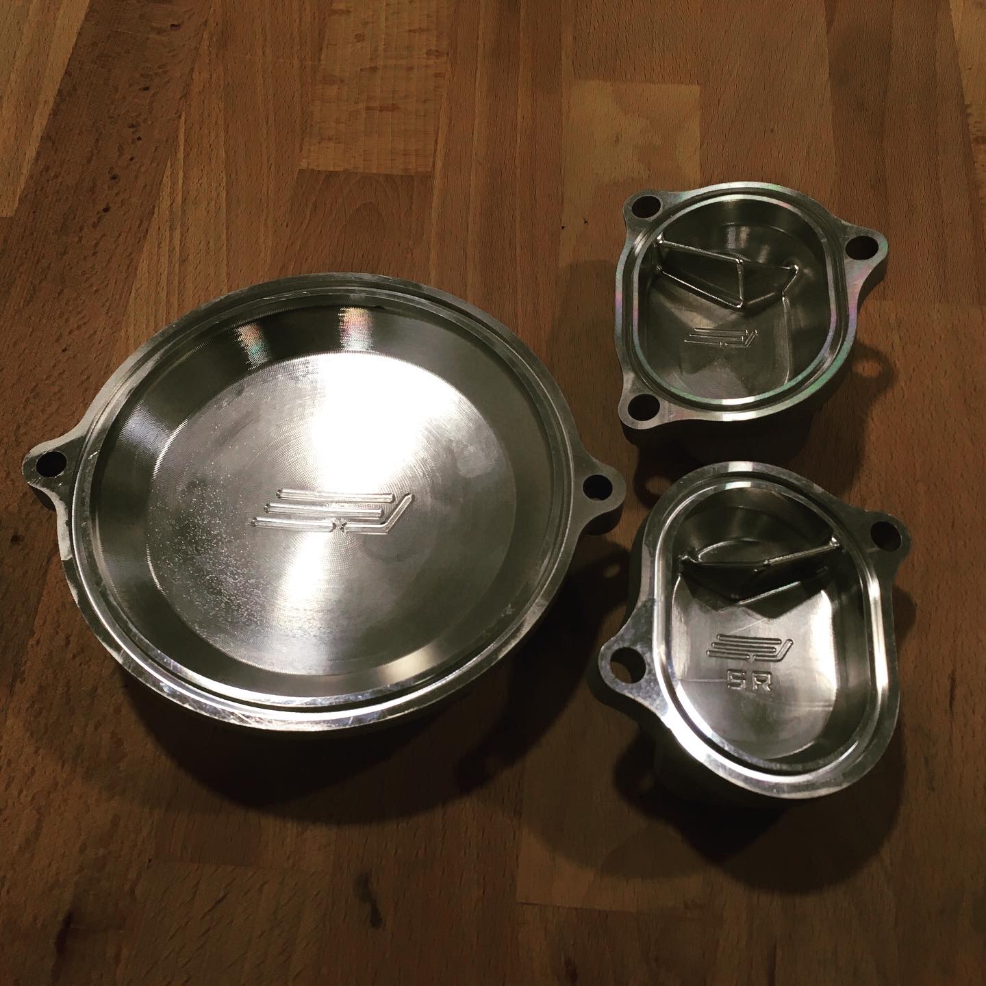

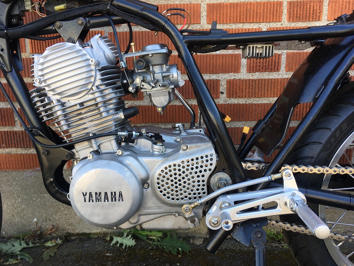

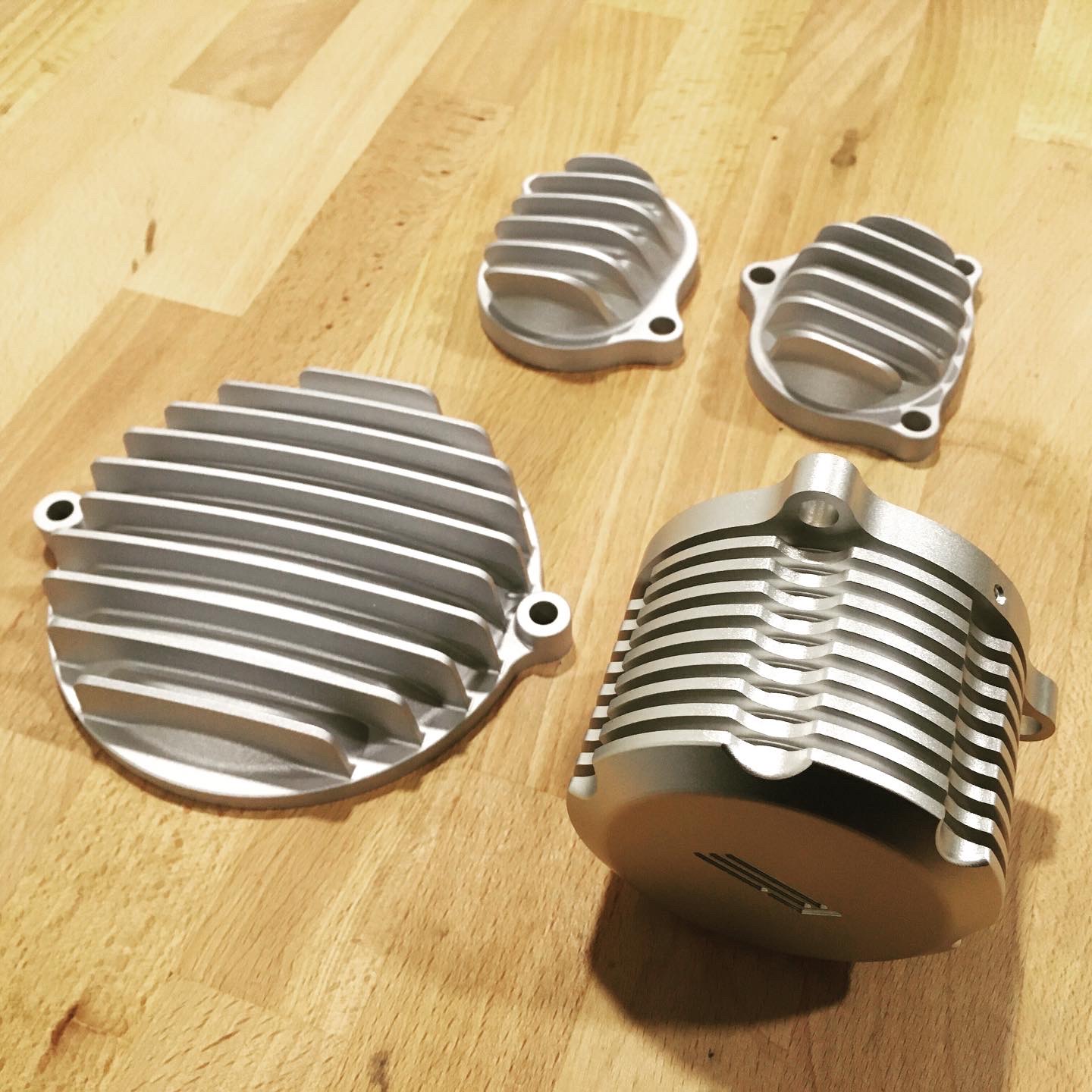

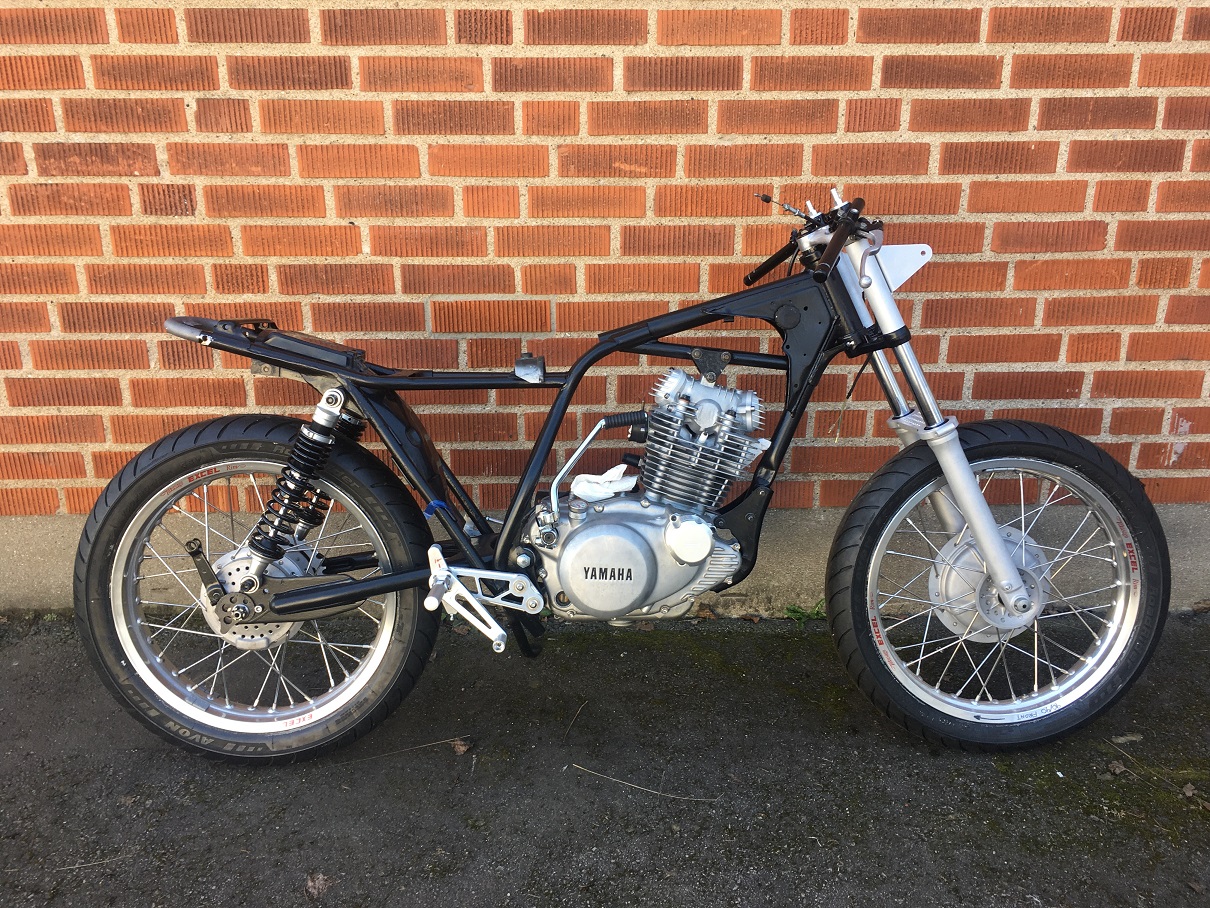

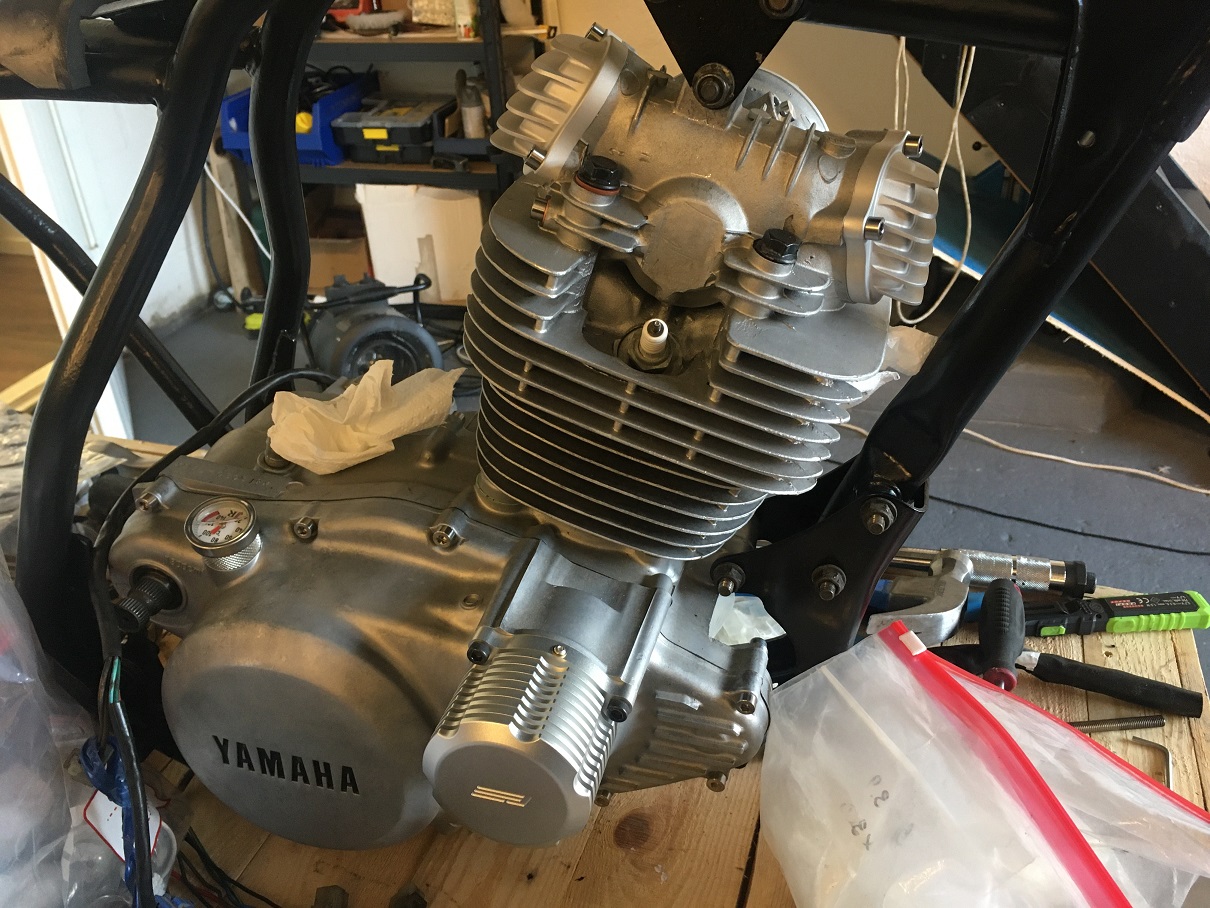

Finned engine covers for extra cooling arrived and are installed :D

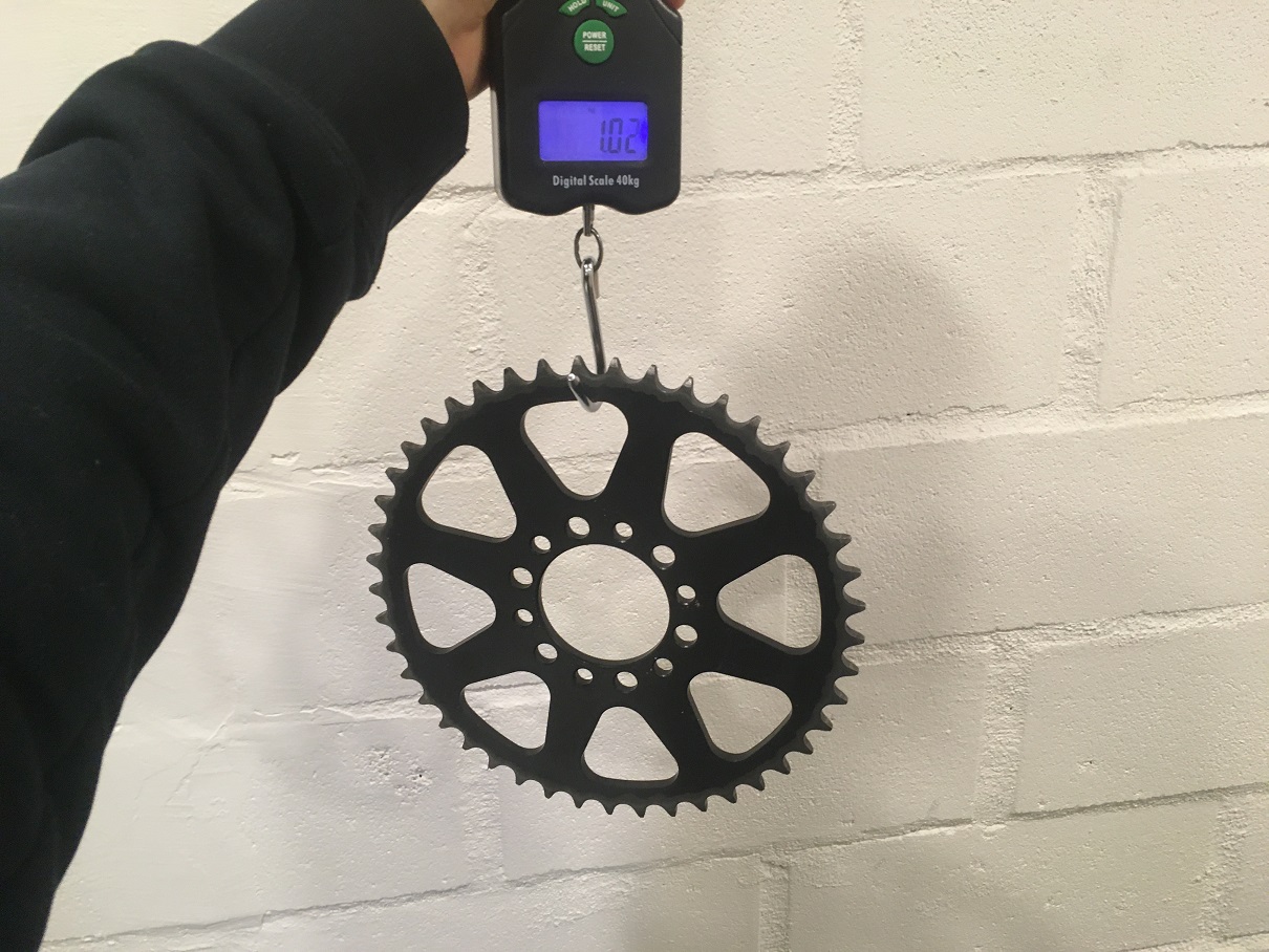

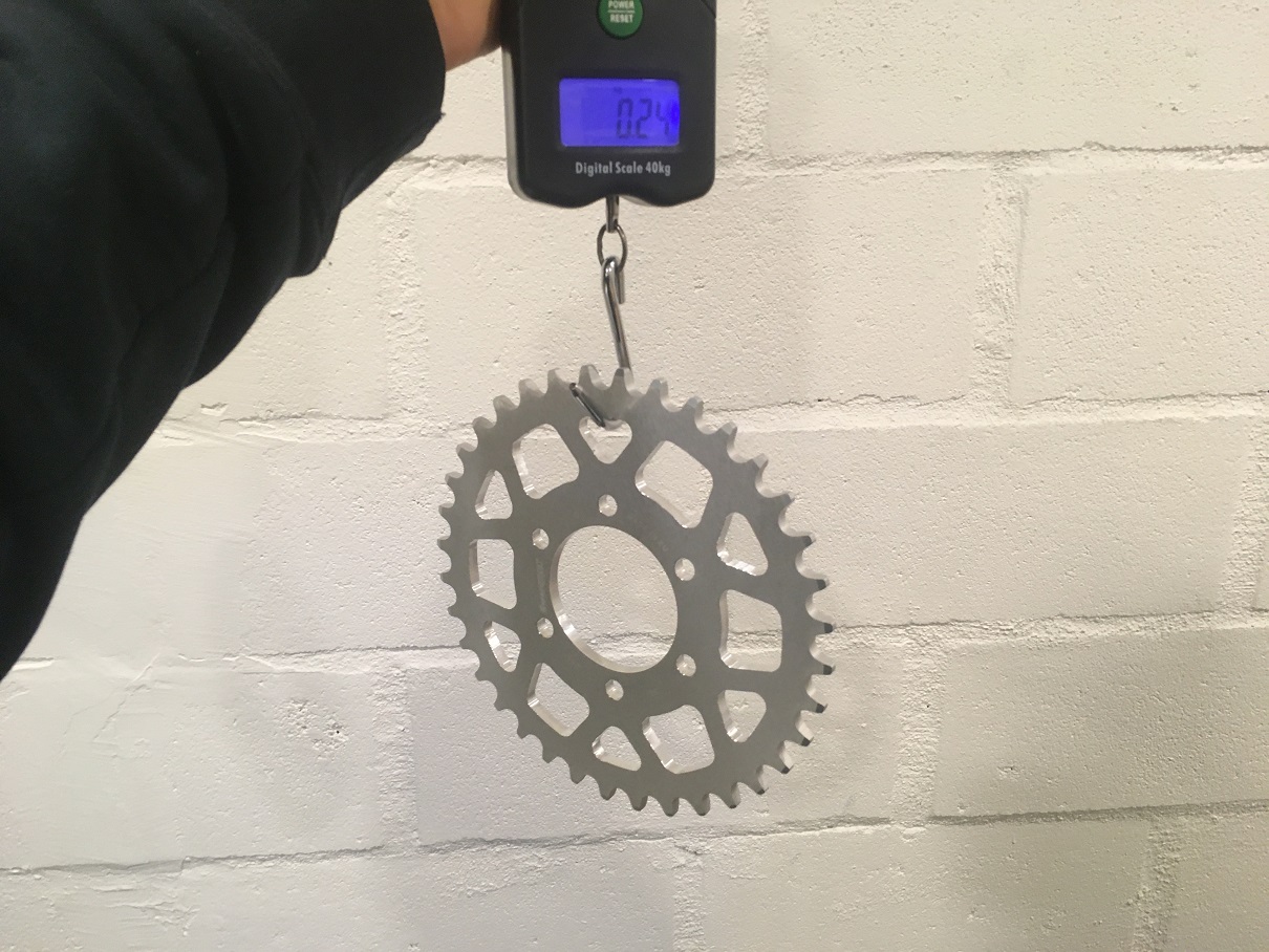

Can highly recommend SuperSprox! What a sweet service! Will def use this in the future. The sprocket came in even lighter than expected - at 240g-ish. Decent weight savings here, especially unsprung mass. Now got the rear wheel assembled and ready to go in the frame. I tracked down a decent lightweight, low friction but strong chain as well - after reading a lot about different types. I like the all silver look :D too

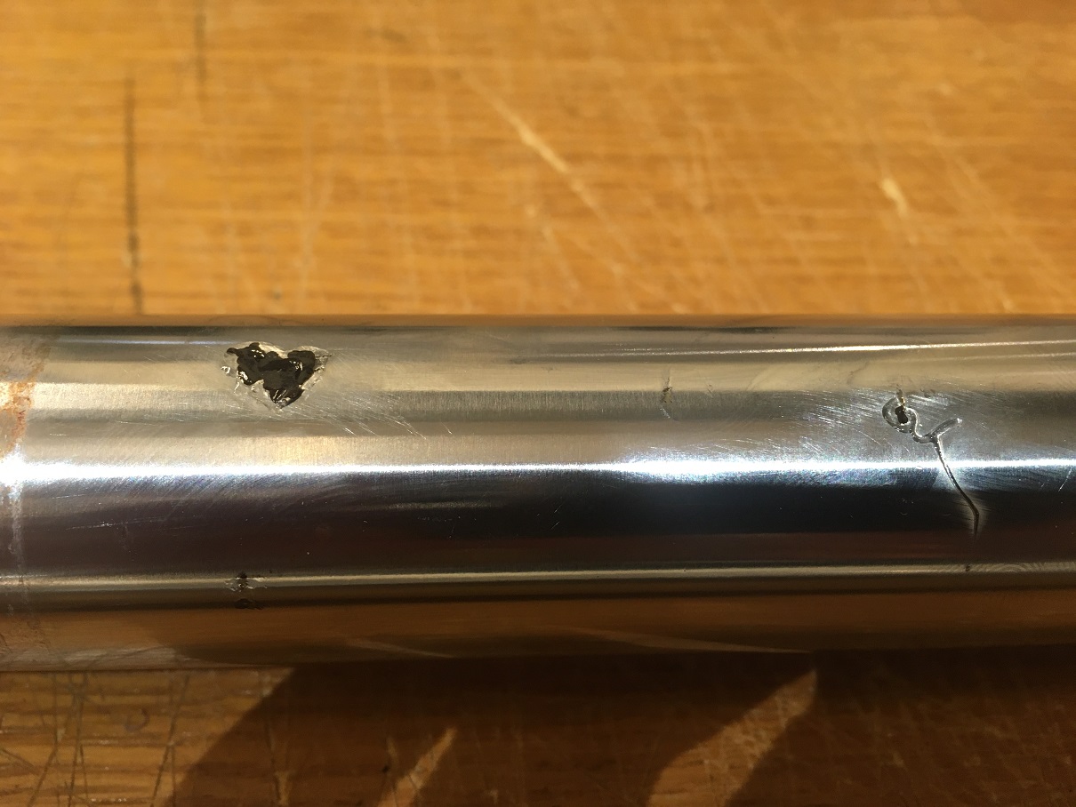

I was lucky that I had two decent fork stanchions for this bike - many old SR250 forks get terrible corrosion. There were no issues in the 'working' area of these, however there were a few small rust spots that I wanted to address. I had seen this fix method somewhere online and decided to give it a go myself.
So I sanded back the spots with 400 grit sandpaper, cleaned it with acetone, then filled with a really strong gap filling 2 part epoxy. Then waited for it to harden and sanded it back carefully. It looks like it has worked but I am not certain how long it is going to stay put! Perhaps there is another type of two part epoxy that would have been better suited to this. Oh well, this area of the forks will be covered anyway by the custom headlight brackets - as well as being sealed and water proofed (held in place with orings).

I've never seen that approach tried before. What the heck, looks like it's worth a try, why not? Good luck w/ it.

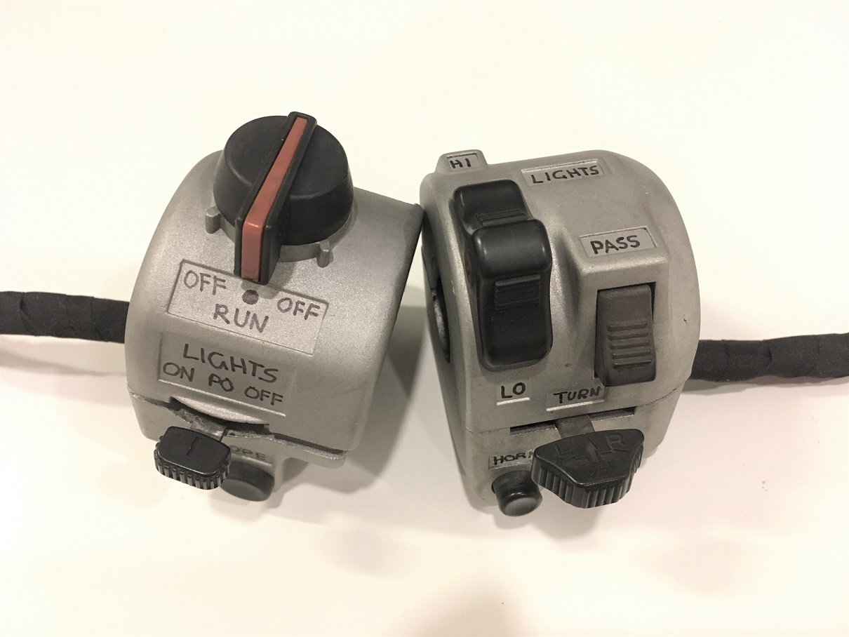

An update on some of the electrics... By removing the electric starter I could also remove the starter relay and safety relay (cuts power to the starter relay in the case that the bike is in gear or clutch not pulled in) and the associated wiring that goes with those components. It will be nice to have a little simpler wiring harness. I was also able to fix the starter button in position and label it 'NOPE' on the bead blasted stock switch blocks :D I really like these small hand-made touches here and there - so the bike does not look too 'machine'.
I have also shortened the switch block cables (too much wiring in the headlight otherwise) and the speedo cables.

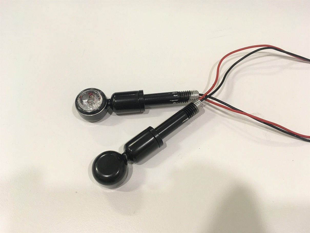

I am glad I ordered two sets of the custom headlight bolts for the mini blinkers because the second set will get used in the rear - picture of that coming soon!

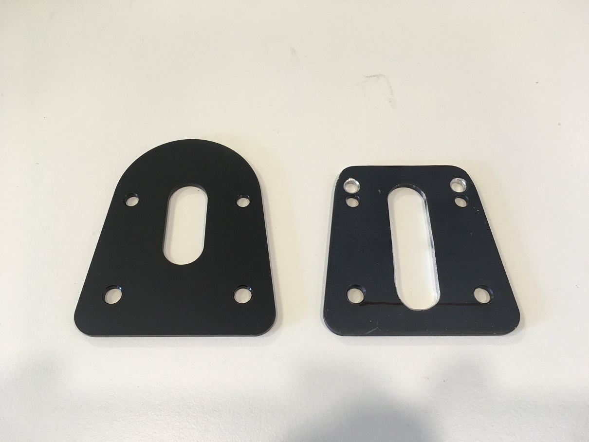

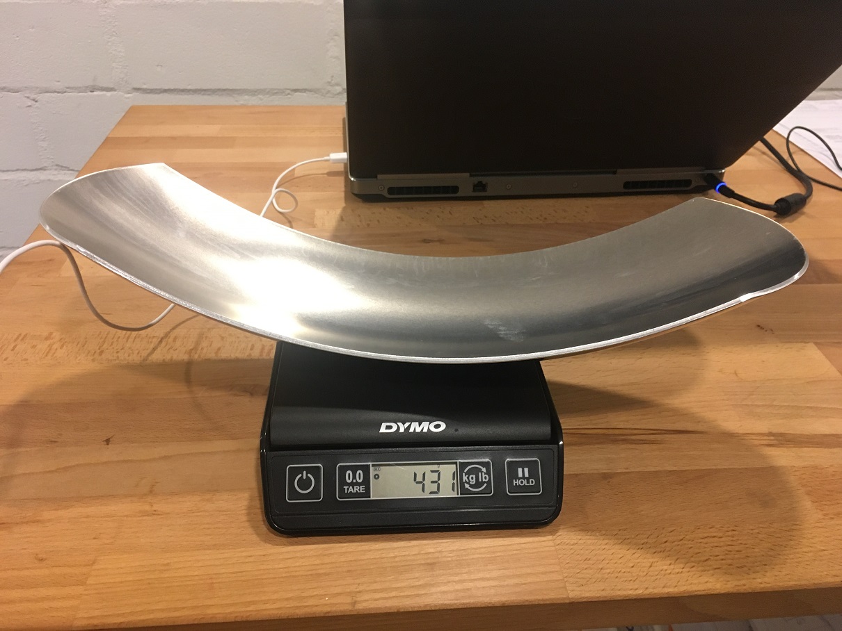

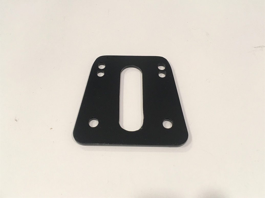

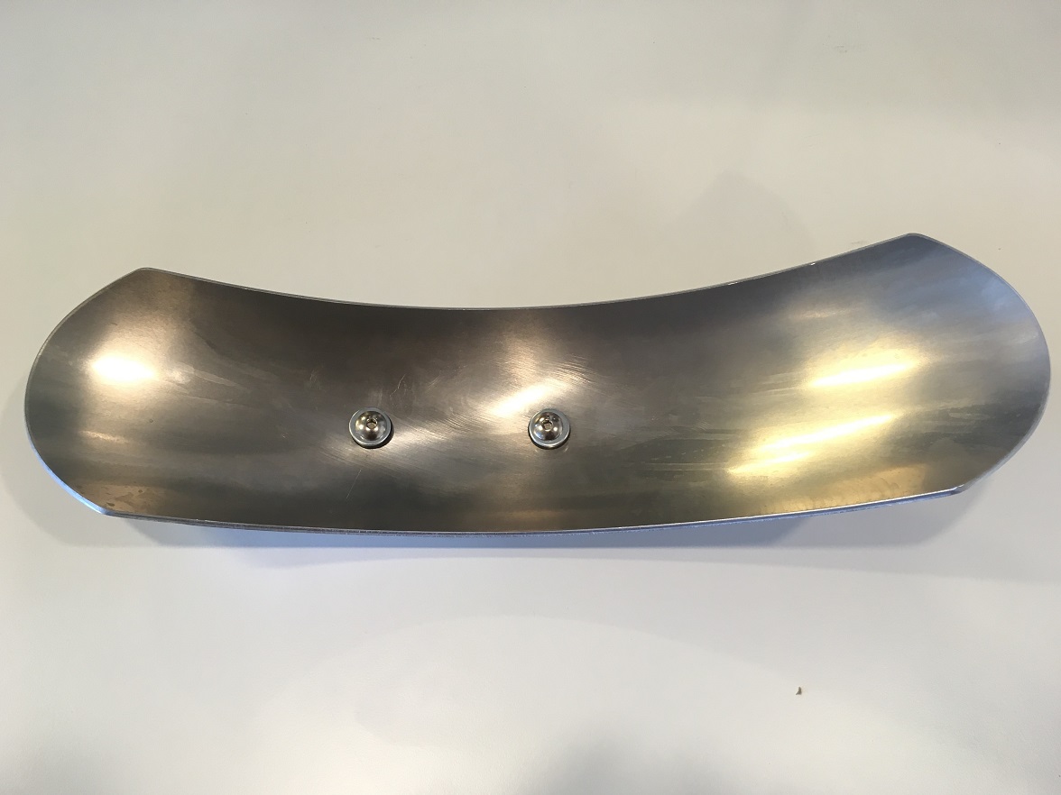

A few more parts taking shape. A trimmed guard - much lighter than stock :D Grommeted holes in the guards for mounting - vibration damping. And a trimmed and modified speedo bracket - for the new unit.

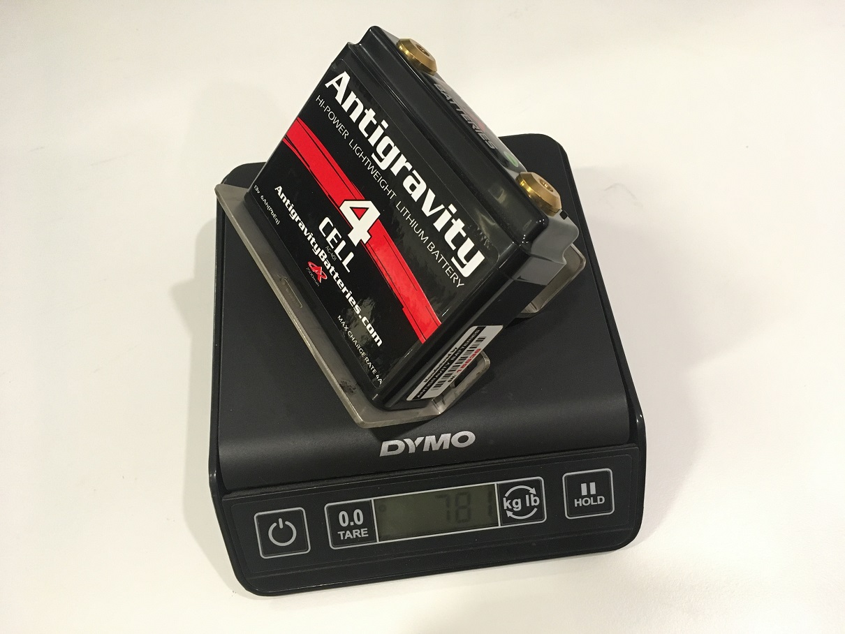

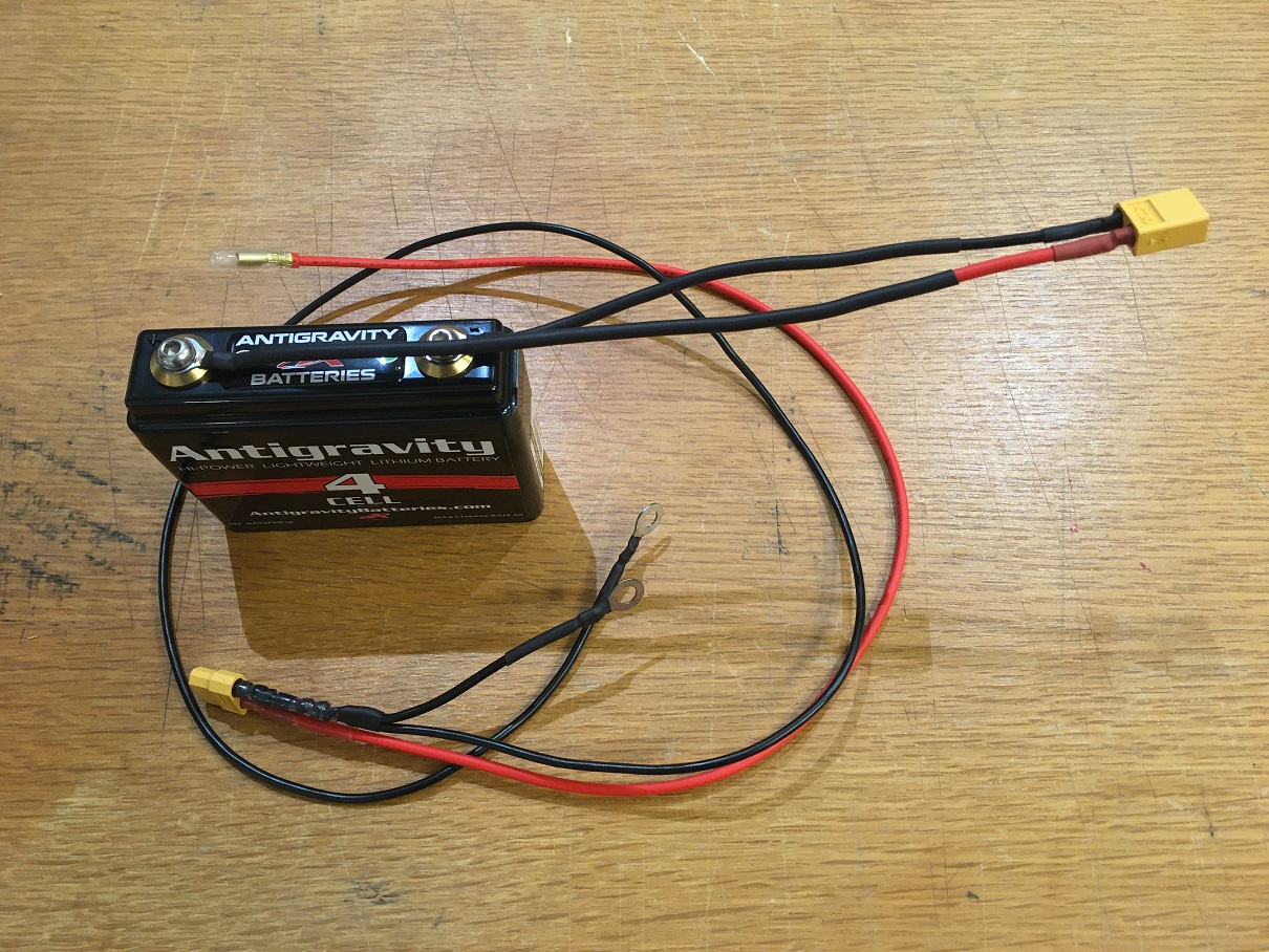

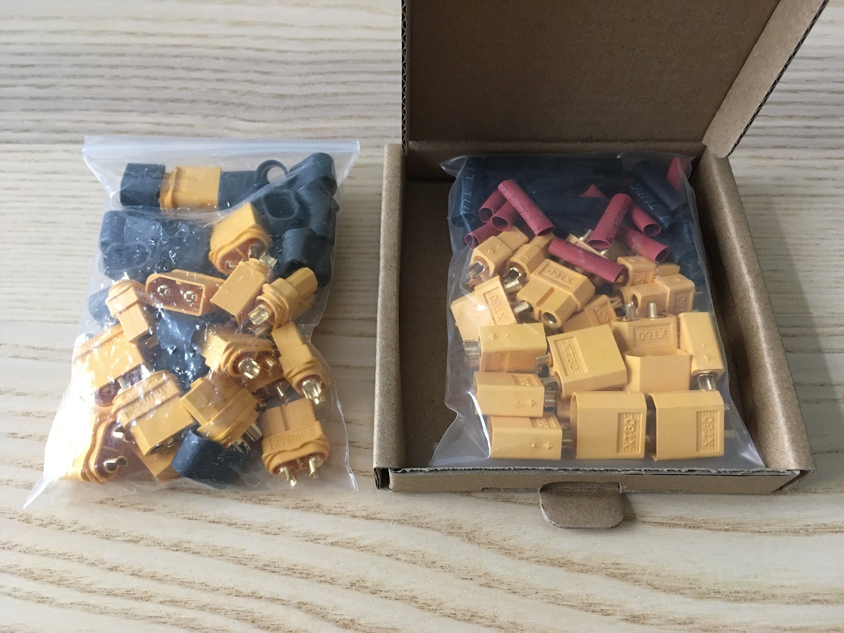

And some more parts taking shape... A trimmed battery tray - I designed the tray so that it could be used with both an 8 cell and 4 cell lithium battery but I had never actually tried it with the 4 cell - always wanting the extra juice for the starter. But now with kickstart only I could try it and it works great. I could also remove the tab for the starter relay - not needing that any more either. I also decided to use some XT60 connectors for the battery - so I can easily disconnect it in case of any parasitic drains that are difficult to find (lithium batteries, as you know, die if drained below a certain voltage - ask anyone how they know hehe). And also to be able to easily connect a charger while the battery is still in place - wiring up an adaptor with a plug to the charger. Together with this I made a small power harness that connects back into the main wire harness. This one has two grounds to be sure - one running to an engine cover bolt, the other running up to the main frame ground by the ignition coil.

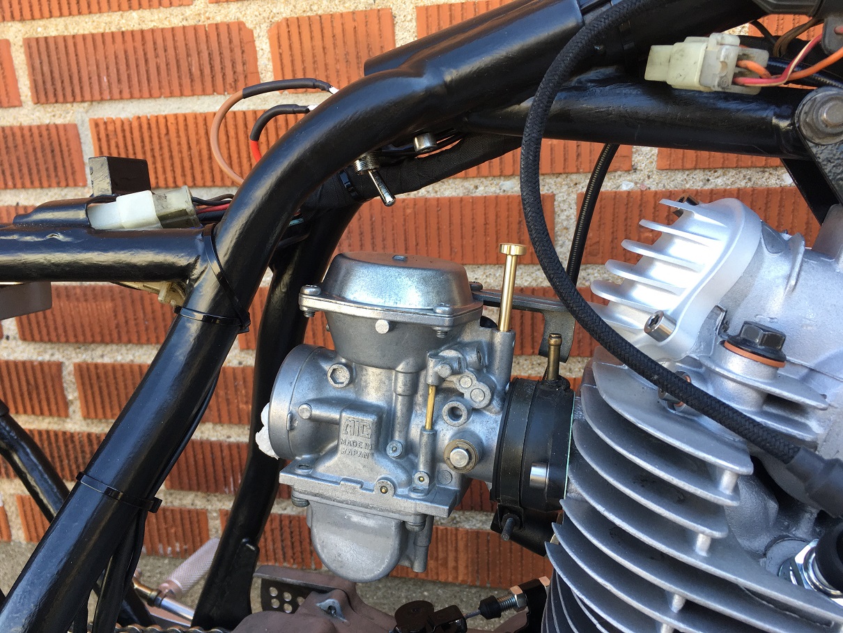

Finally, a decent update...
  • Carb restored (cleaned, re-jetted, butterfly valve mod, air/fuel screw upgrade)
  • Wire harness 95% sorted - battery connectors installed, ignition 'switch' (replaces keyed ignition) installed (see above carb), all lights installed and operating - see the solutions for mounting the blinkers, pretty happy about that, speedo and switches installed and wired up, ignition coil and spark lead and plug installed, battery tray and electrics tray installed - with automotive fuse holder and relocated Reg/Rec

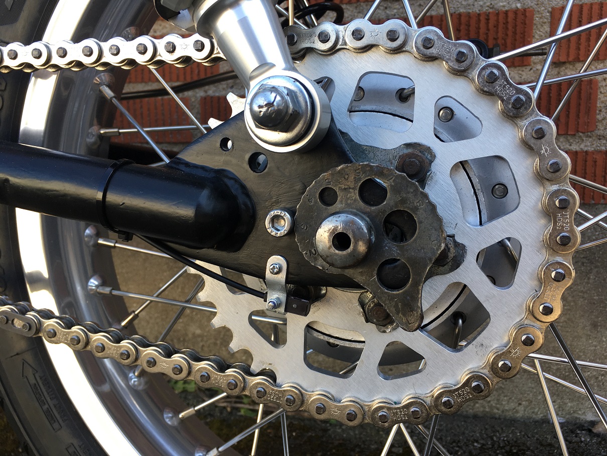

  • Speed sensor bracket made and sensor (Hall) installed - picks up the sprocket bolts on the wheel (this is dialled in once running)

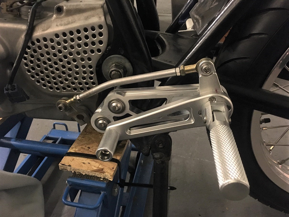

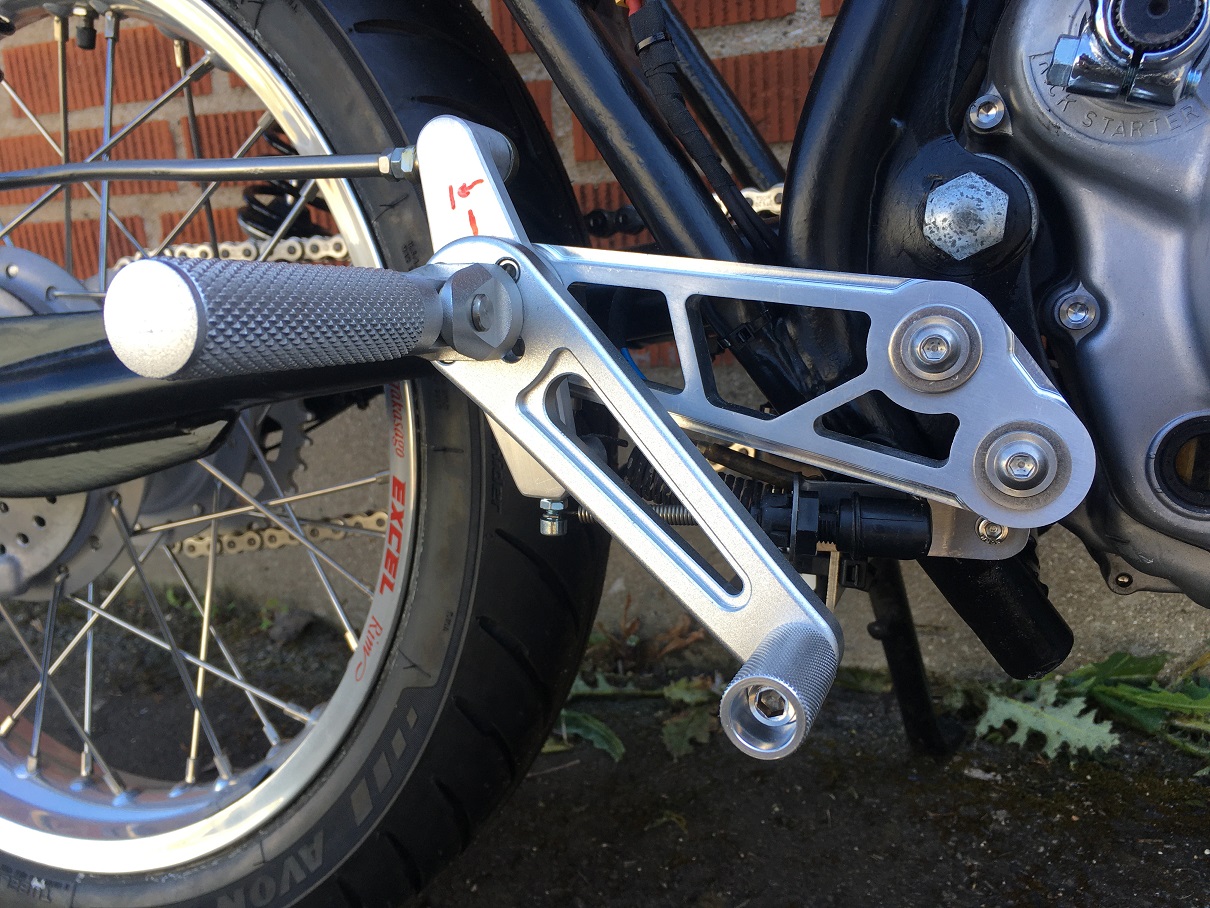

  • Rear sets sorted - now with bracket for brake light switch

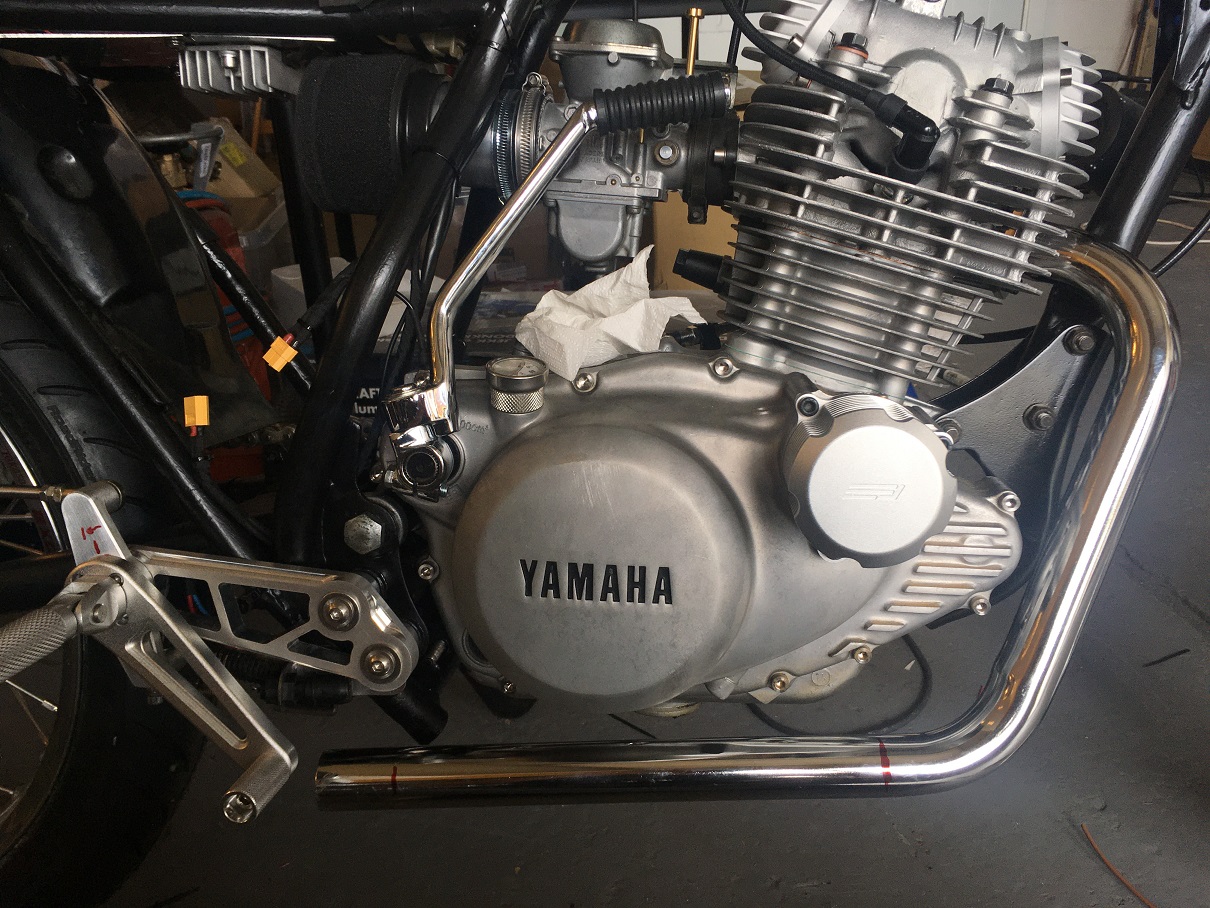

The last big jobs are to finish off the wiring and then sort the exhaust. I have used some exhaust calculators to calculate the preferred header length and have bought some adaptors so I can weld it all together with the Jadus 20 bend adaptor and install a vacuum pick up tube for the PCV valve/pump (from XS650).
If all goes well, first start will be by the end of the month (June)! :D

What’s this butterfly valve mod you did?
It is old hot rodding trick that increases carb throat area by cutting off one side of the butterfly valve holder - so it is a blade rather than a fork. In this case, area increases by around 10%. Who knows how much it will help, but thought why not try it! Hoping the engine will want to consume that much more air at least :)

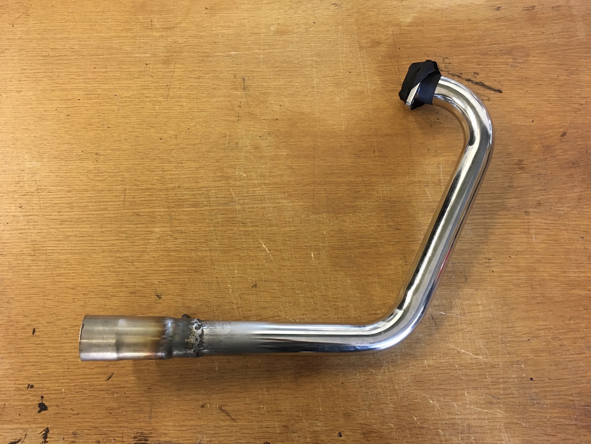

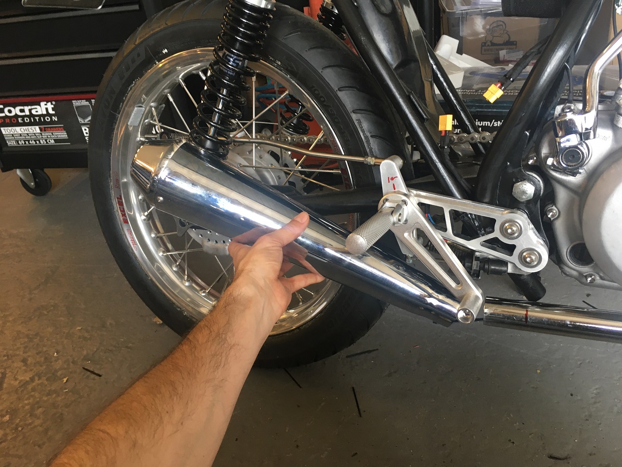

Finally got a decent chunk of time to sort the exhaust. I bought a nice reducer that almost matches the Jadus header and the steps up to match the silencer (almost). In this reducer I welded in a vacuum pick up for the PCV valve/pump that I will be testing once the bike is running. For now it is not connected because it is an extra factor that I do not know enough about when first starting and running in the engine. I will connect it later when everything is dialled in. You can see how it will operate and that I have blocked it off for the time being and am just using a standard crankcase filter for now.
I am completely embarrassed of these welds, they came out terrible - worthy of the hammered dog shit Instagram page. I just couldn't get the settings of the gas welder right for stainless and the metal wasn't flowing right. This has made me decide to finally get a decent hobby TIG welder later this year - at which point I may redo this exhaust or at least try tidy it up. Suggestions for good TIG welders that wont break the bank?
You can also see in the first photos that the original plan was to have a nice upswept exhaust. However from all the header calculations I did with the goals of the engine/power in mind, this style of header would have been far too long for high rpm power. So it needed to be chopped much shorter and just sit straight under the engine/foot peg. The position came out alright and it will not affect handling/lean angle at all.
Still on track for a first start by the end of the month! Hopefully one evening next week!
