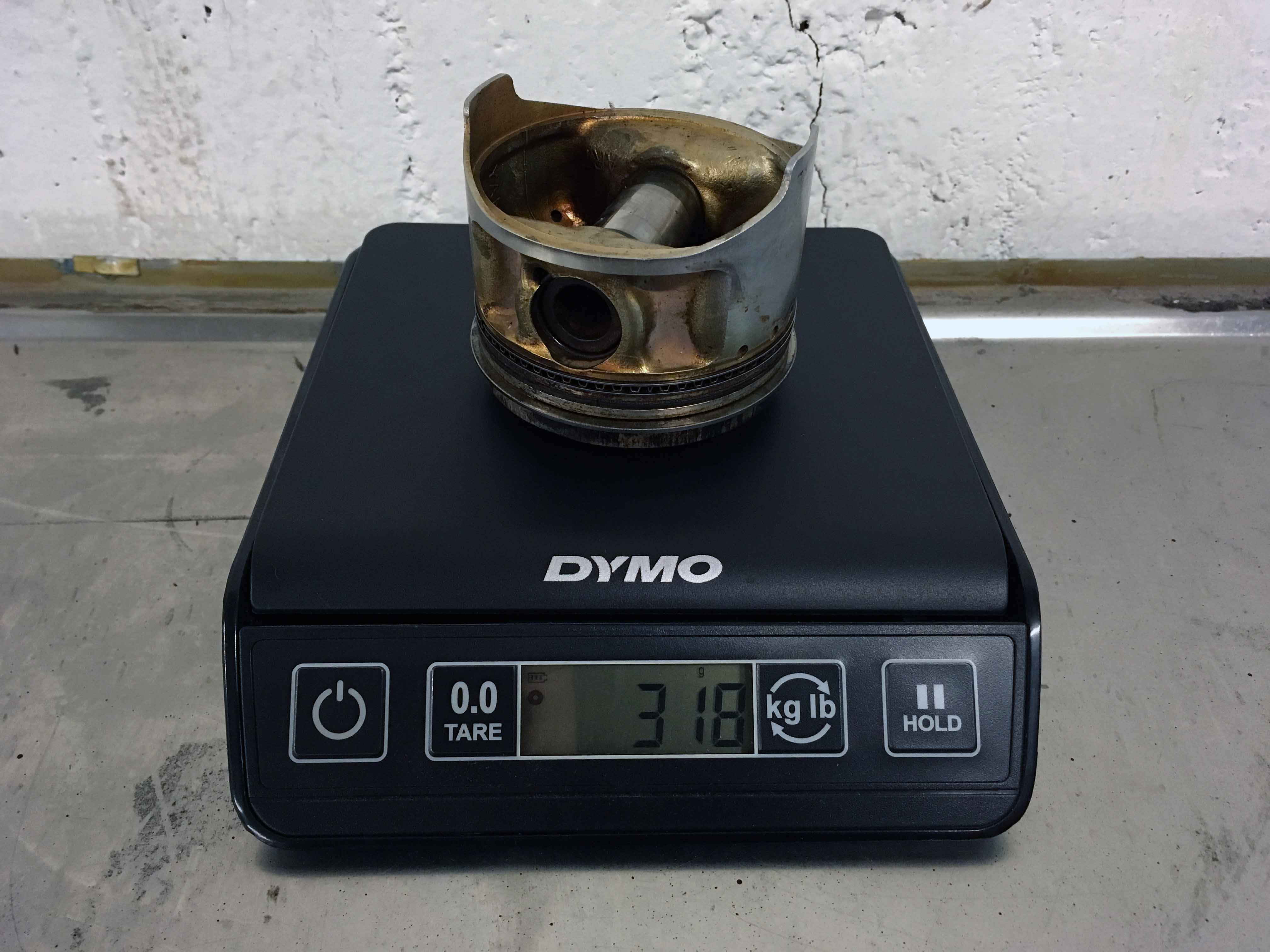

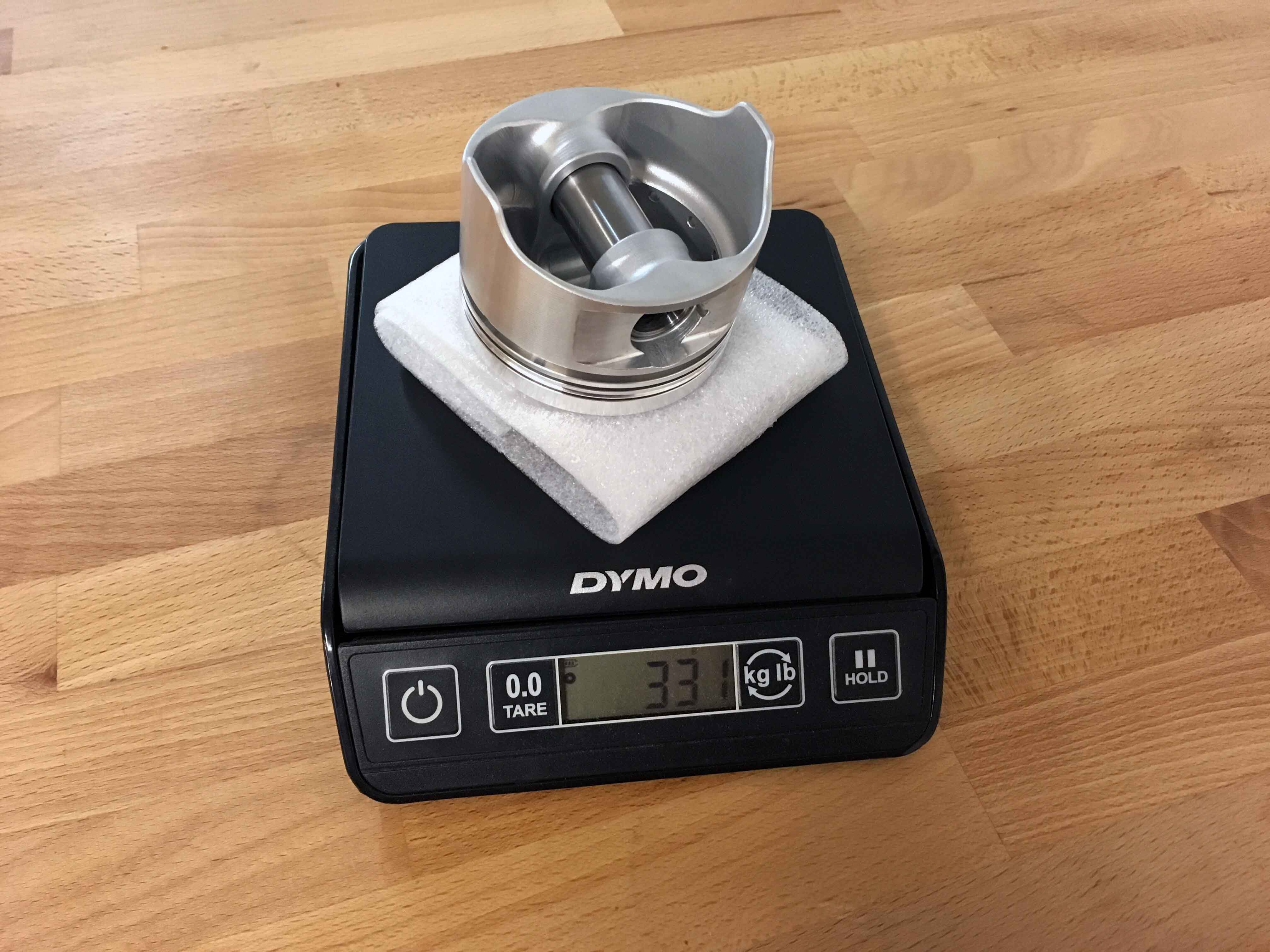

Over the weekend I managed to start the tear down of the top end and do a bit of a measure up. I wanted to know the exact weight of the piston assembly so we have a baseline for the new big bore piston. I hope that with new methods, we can achieve a bigger piston with the same weight as this one so that the balance of the engine (both the primary balance for the crankshaft and the secondary from the balancer shaft) remains the same - so not to effect the vibration levels. If this cannot be achieved, we will taper bore the piston wrist pin to get the weight back to stock.

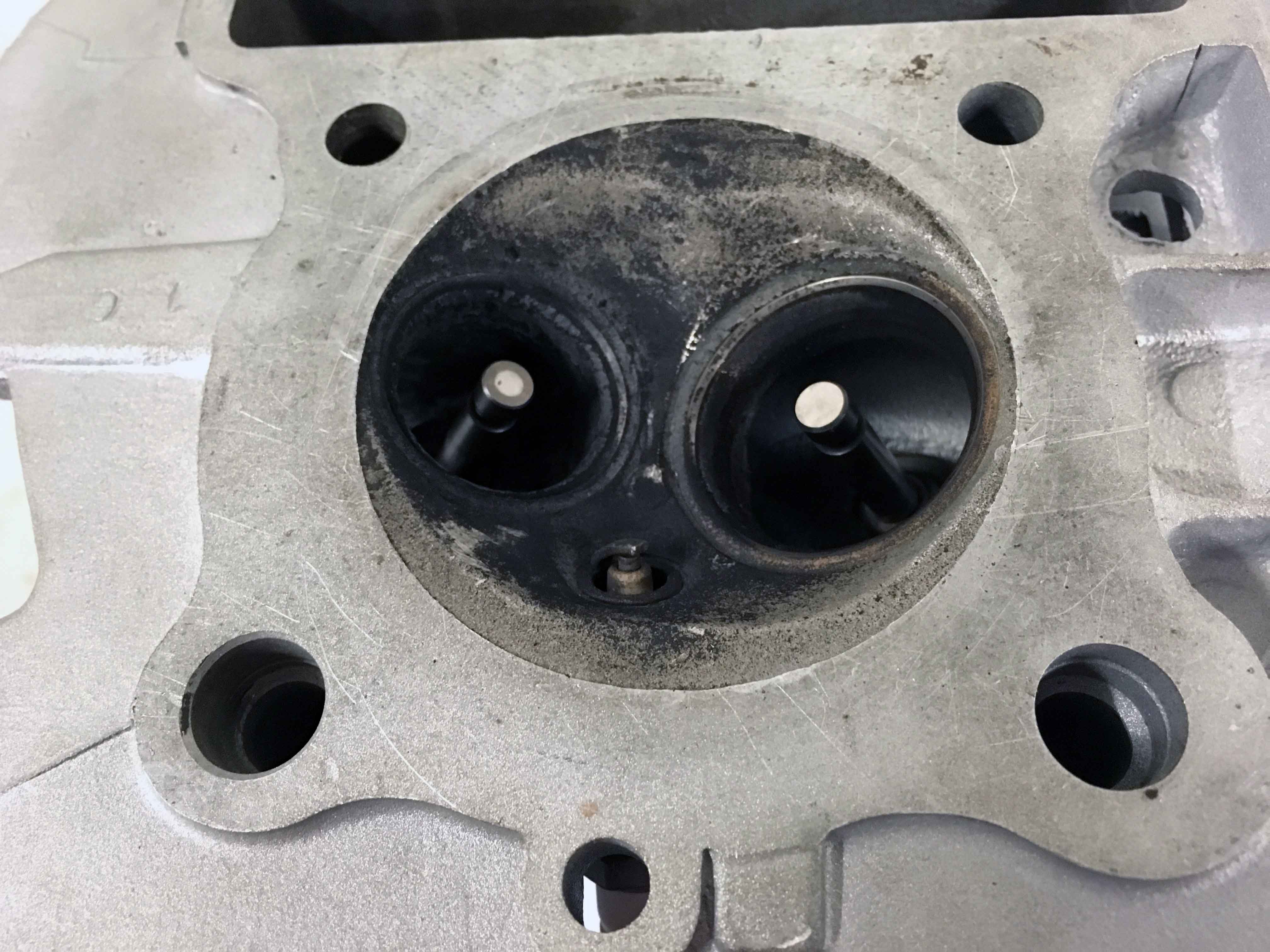

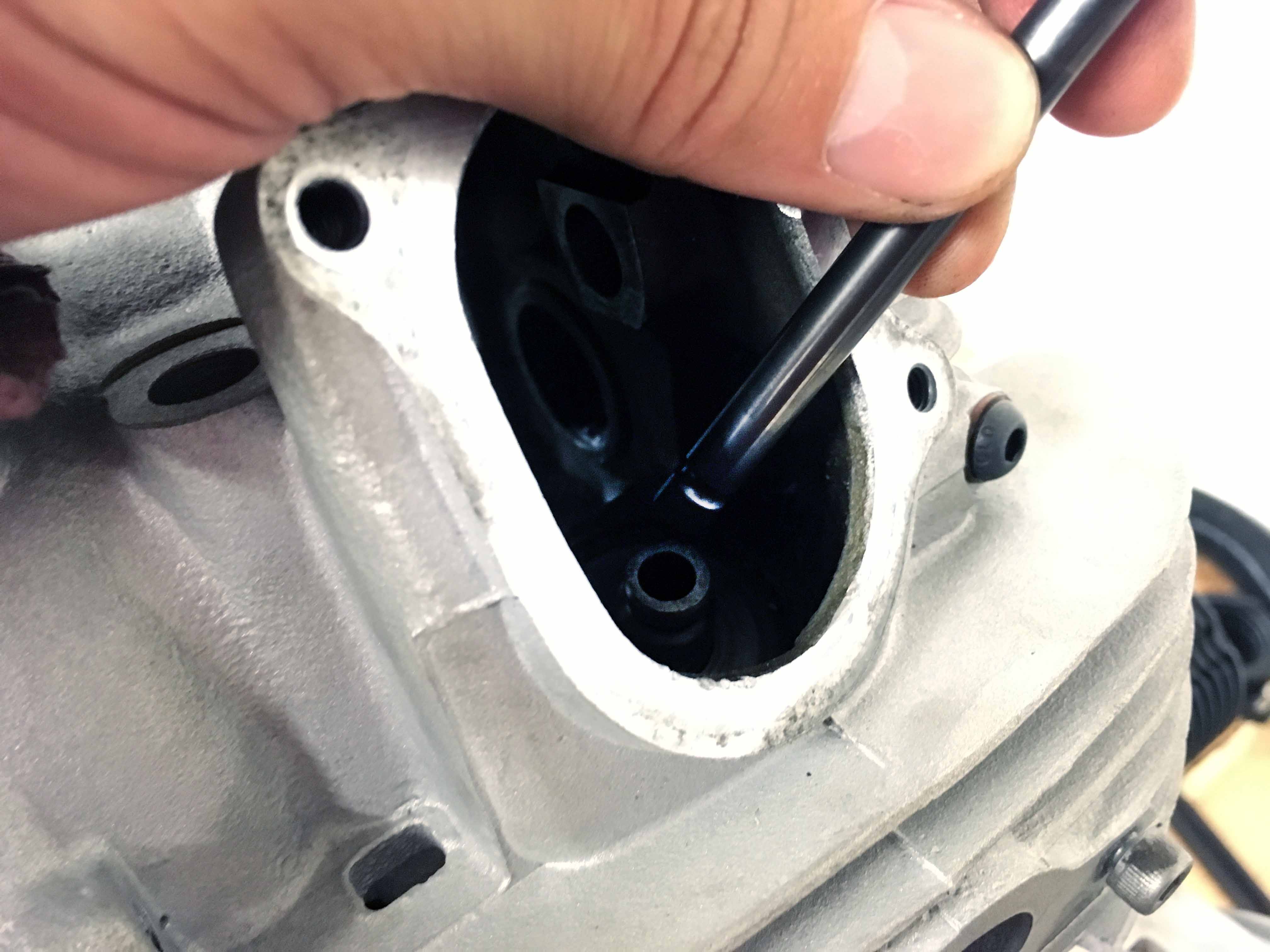

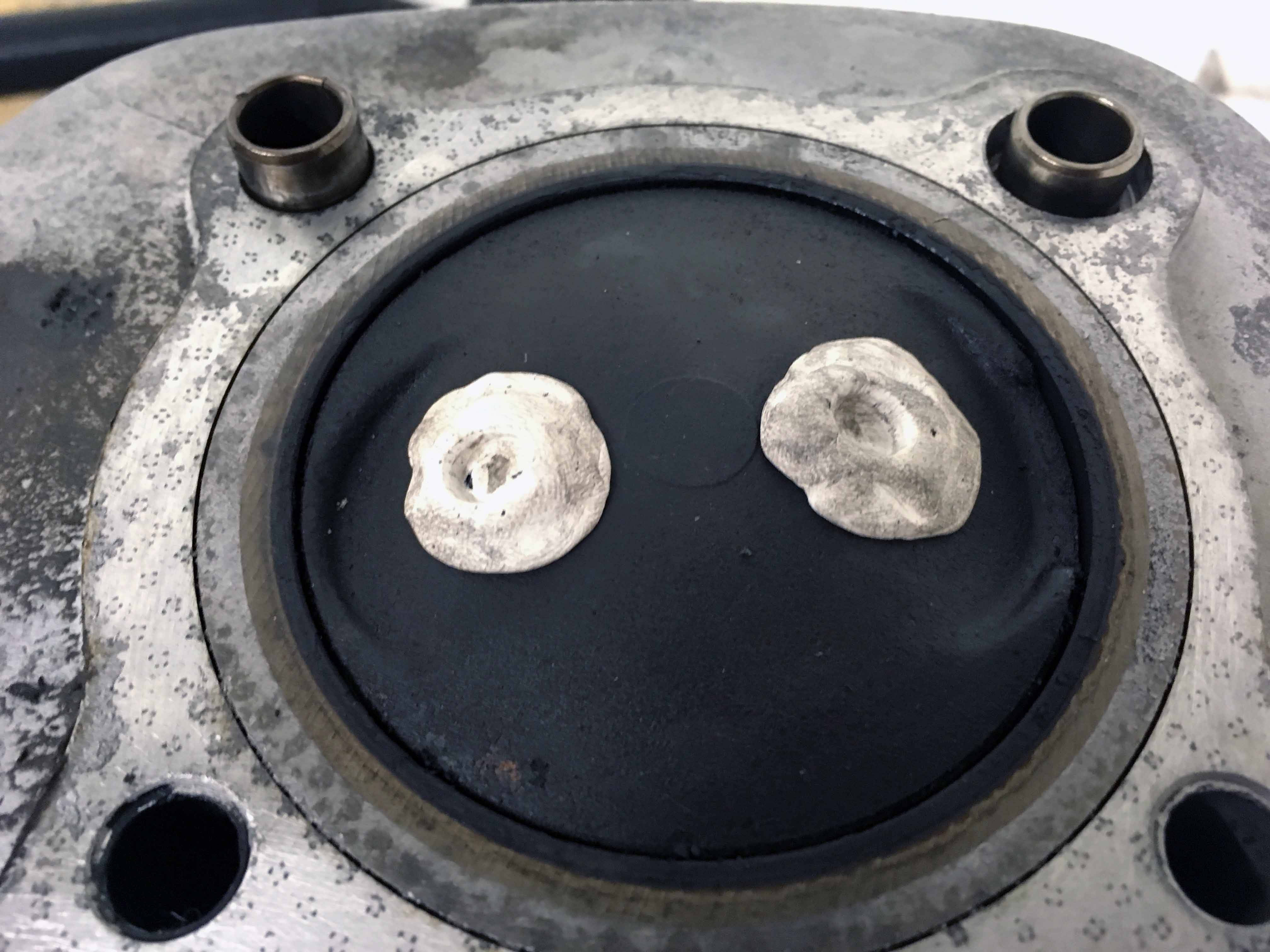

Then the piston producer wanted to know valve angle and wanted me to mark the valve centres on the piston so he has a reference for machining out the valve clearance pockets. The valve angles in the photos don't show up very accurate because of the perspective, but they were both 115 degrees.

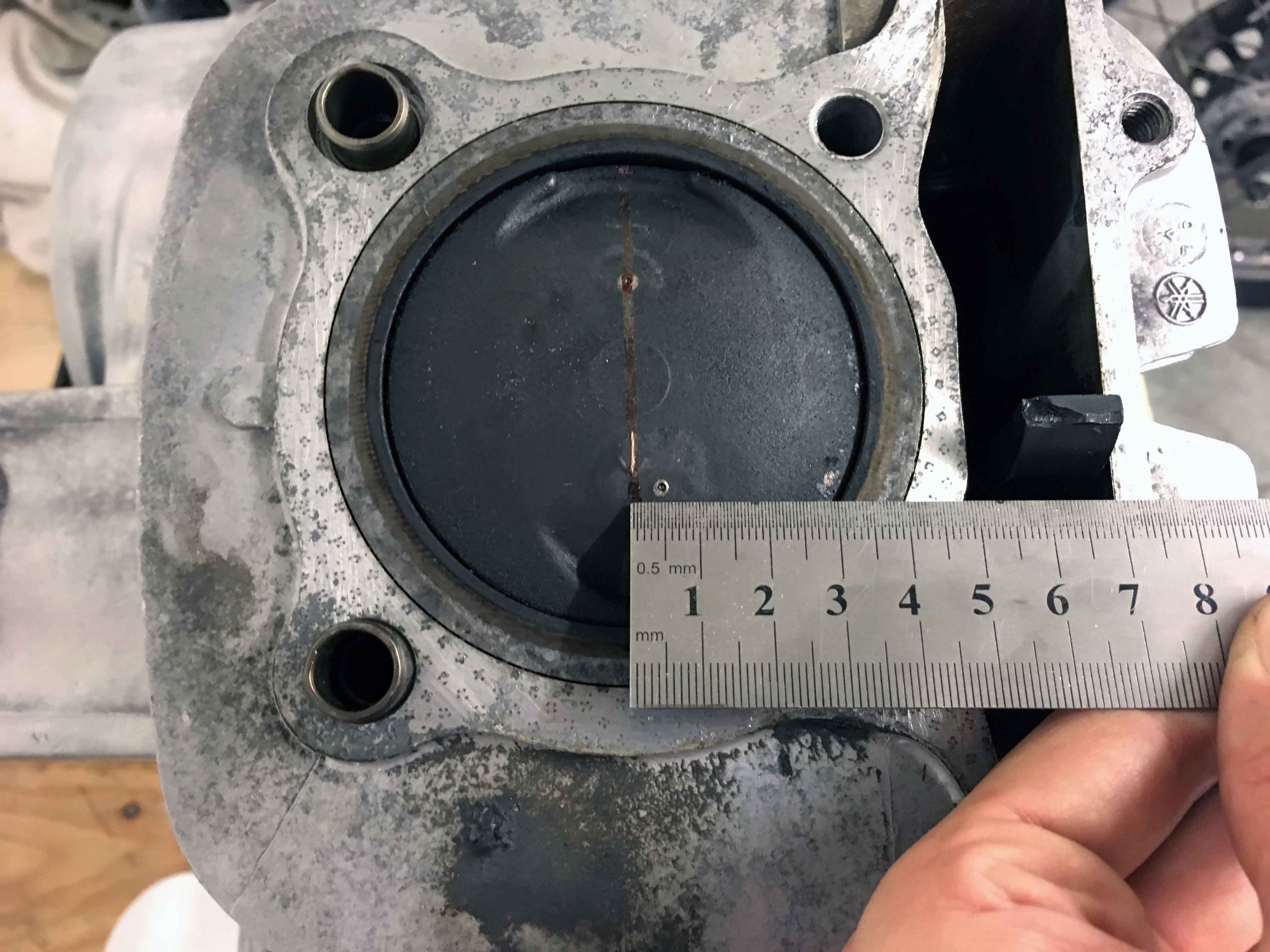

I also measured the compressed height of a used head gasket and the deck height. Deck height seems to be zero... So just relies on valve to piston clearance and the clearance from the head gasket height. Eventually I will cc the head and add this to the volume of the compressed gasket. Then I will be able to get an exact compression ratio and be able to calculate and predict a new compression ratio with the new piston and the new swept volume.
The head volume is listed in the manual as 30.4cm3, head gasket thickness as 1mm (which is correct for a compressed one) and compression ratio as 8.9:1 (for the 239cc versions) and I have no reason not to believe this, but I want to measure it anyway. I will also use that compression ratio and these listed numbers to reverse calculate the head and gasket volume just to double check my numbers and see if there are any differences.

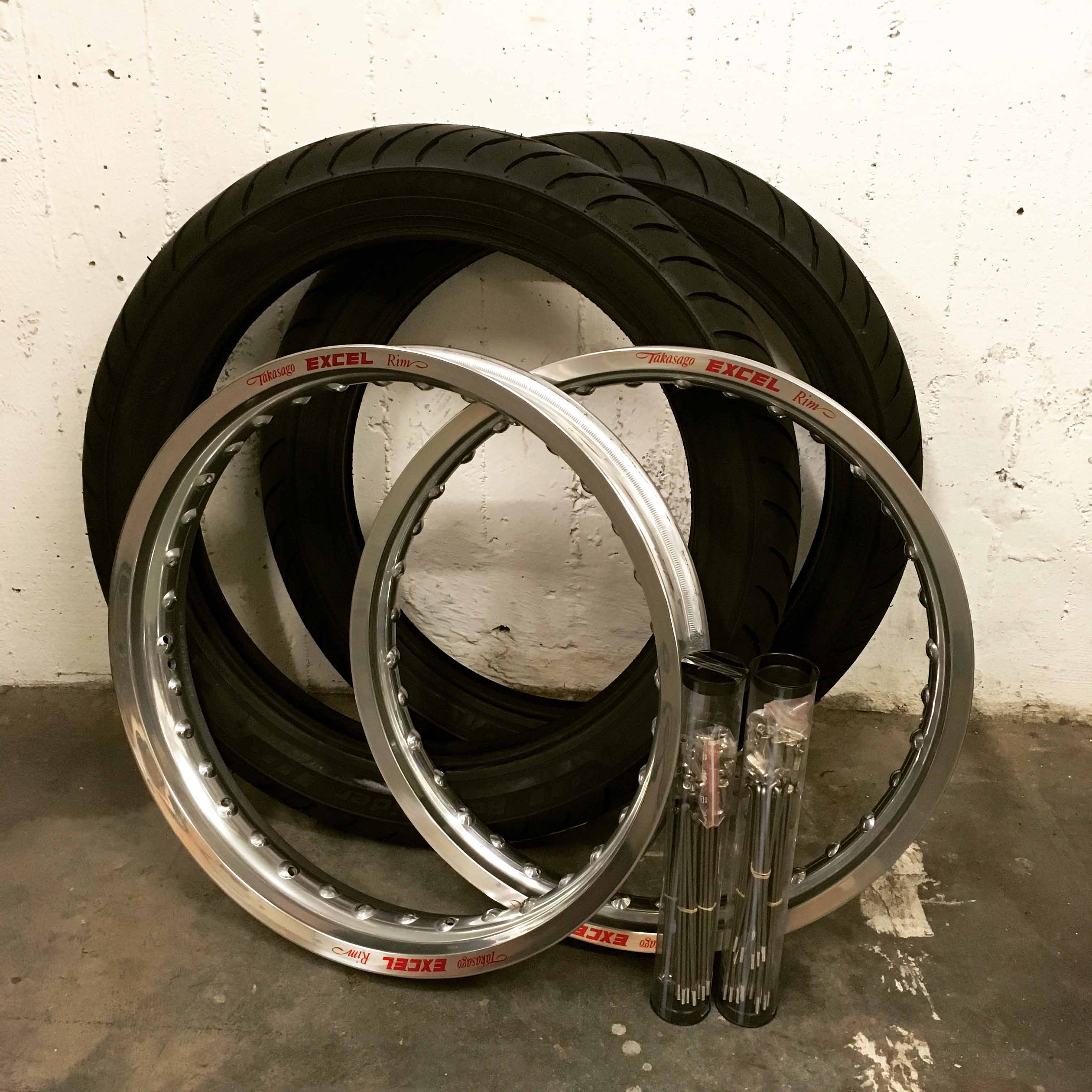

Finally saved the dough to buy the rims and the tires I mentioned. Already have the spoke sets in stock so that part was easy! Now can't decide if I should just build the wheels or if I should try make an instructional video on how to do it. Feels like there are plenty on Youtube already? But maybe good to have one specific to the SR?
I assume you're going with the same 16" size as your previous build (that the spoke kit was made for)?
I actually had one off spoke sets custom made for those 16'' wheels - for the look I was going for. Pretty idiotic of me to build a bike with 16" wheels, then not offer that option to customers. I just figured most people would want either the scrambler or cafe racer look with these bikes - so I made the spoke kits for 18" - the spokes actually convert the standard 16" rear wheel to 18".

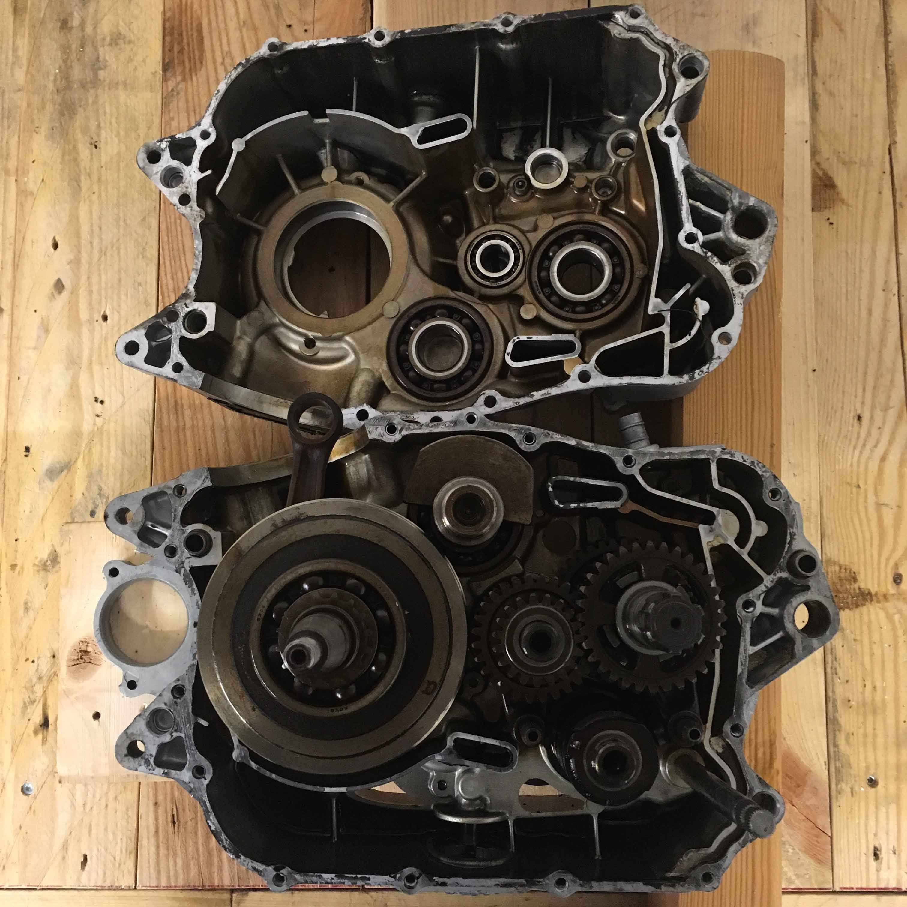

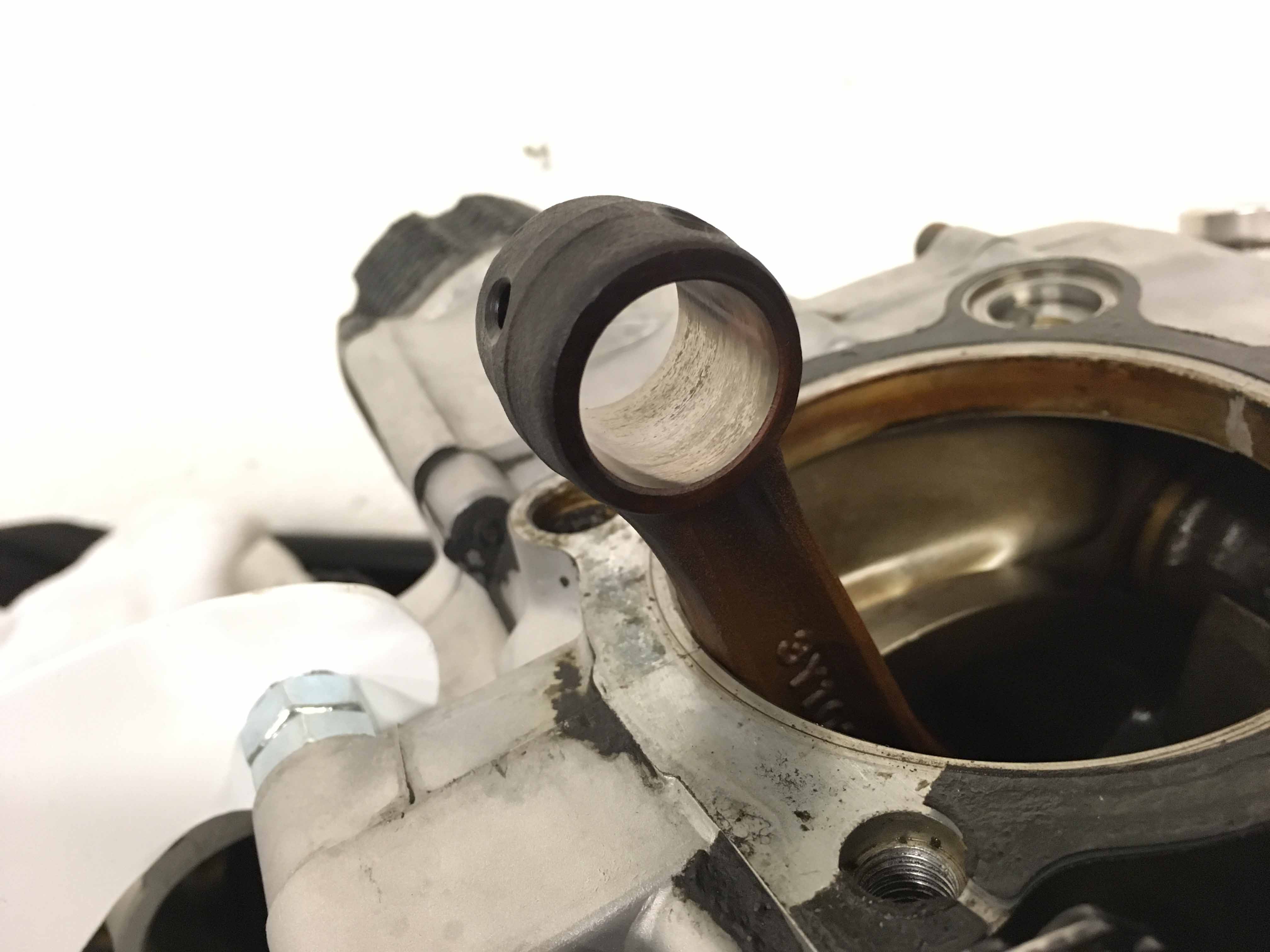

When pulling the head and barrel I noticed some pretty serious wear on the conrod small end and piston pin. Piston pin = no problem, getting replaced anyways. Conrod, kind of a bastard. And with the planned mods, it doesn't make sense not to have a strong bottom end. So I pulled her apart and will replace the crank pin, roller cage bearing, con rod and main bearings either side. Tranny seems sweet and other bearings and seals are all good.

No, not covered yet and very good point, glad you brought it up. I did look into this and read up on it. Basically, vibration is a horsepower sapper. Plus it is incredibly destructive on engine components. I could have balanced the crank shaft with the new piston, but you can only balance for first order vibrations in a certain rpm range - say It was balanced for 10,000rpm, it would be horrible through the rest of the range. I would still like a smooth spread of power through the rpm range. Most modern 4 stroke singles (if not all?) have a balancer shaft, and those engineers are chasing power too. It's just better to get gains else where. Like for example by removing the electric start starter clutch, sprocket and chain, I will be removing a lot of rotational mass right there :)
Here are the items I will do away with. I will also have the crank either welded or plugged at these holes - the oil delivery to the starter clutch will no longer be needed, so they can be blocked off (will double and triple check this). When taking apart the engine I cable tie assemblies together in the order they came off and then place them in ziplock bags. Along with a bunch of photos too! I also take photos of any special orientations or bolts that are longer than usual - to remember their placings.

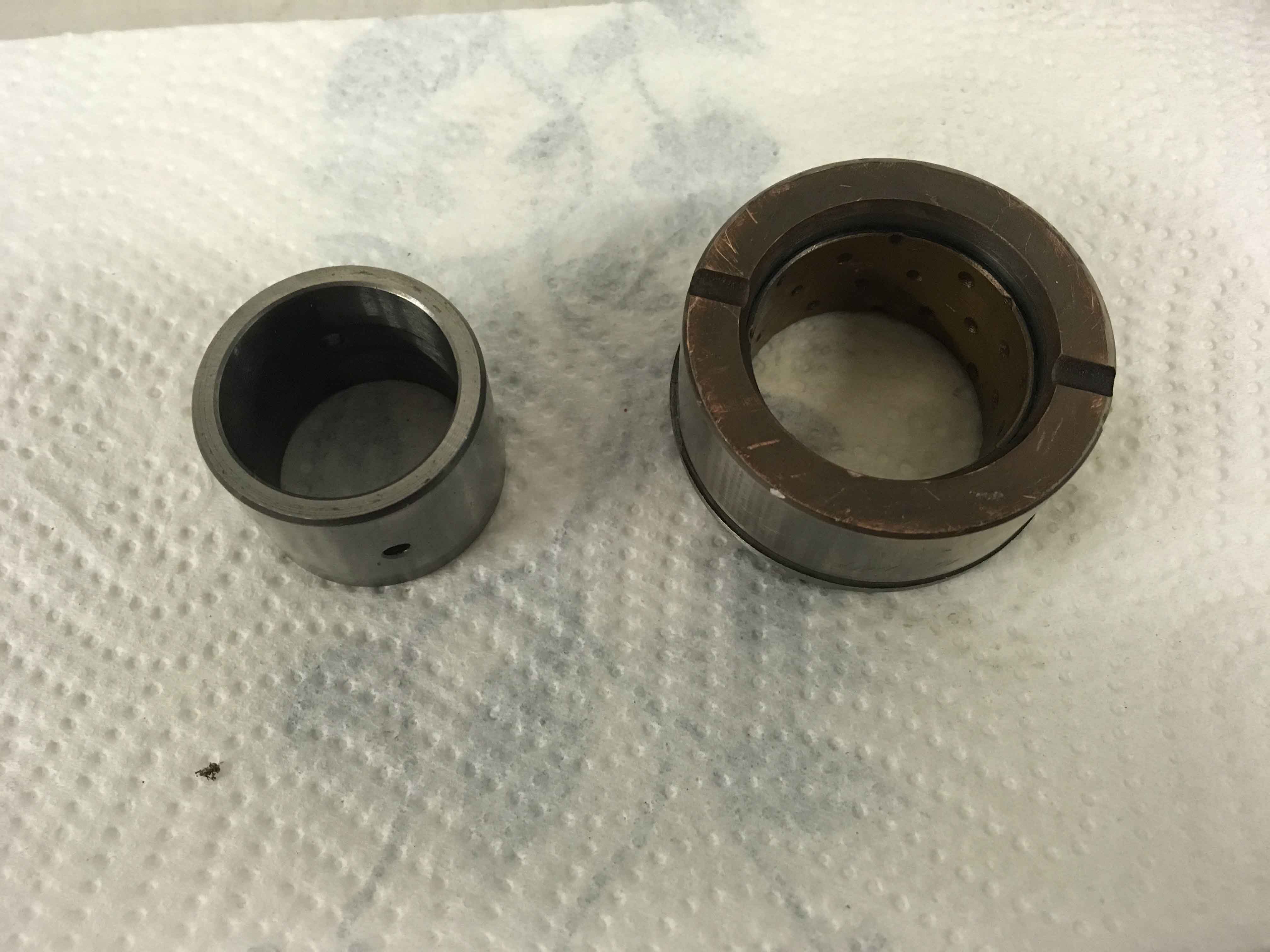

I have thought through (checked and double checked) the starter gear thing. I have decided I will not be blocking any oiling galleys. The centre part of the gear rotates on a bushing. The bushing has oiling holes very similar to other parts in the engine - the small end, the rocker arms, the clutch basket etc. This rotates on a plain machined bearing inside the starter gear - it even has golf ball drilling dimples to encourage better oil retention. On each side of this starter gear are some slots/details that indicate oil distribution. So I decided to retain it so that the other engine components around it - mostly the drive clutch drive gear and the counter balancer drive gear, receive oil the way they are supposed to. However, because not using the actual gear, I cut that part of it off and will have it turned down on a lathe to match the outer diameter of the core. This will make sure it is balanced - don't want any minute wobbling things at high rpm!
