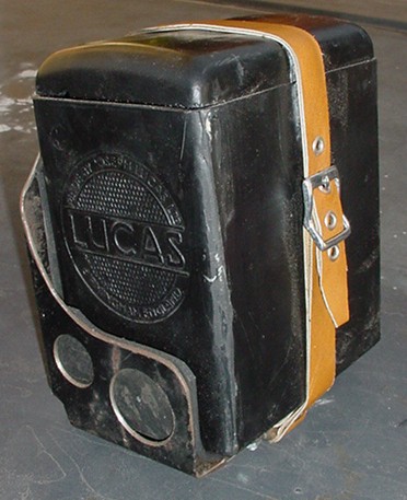

Other cool bits collected over the years for this project include a Smiths speedo,Royal Enfield fuel filters & exhaust heat sinks ,Replica Brit taps, a Vincent tailite & a home made battery bracket with one of my figlass Lucas battery boxes
kohler speedo by eurodave96, on Flickr
kohler tailite by eurodave96, on Flickr
