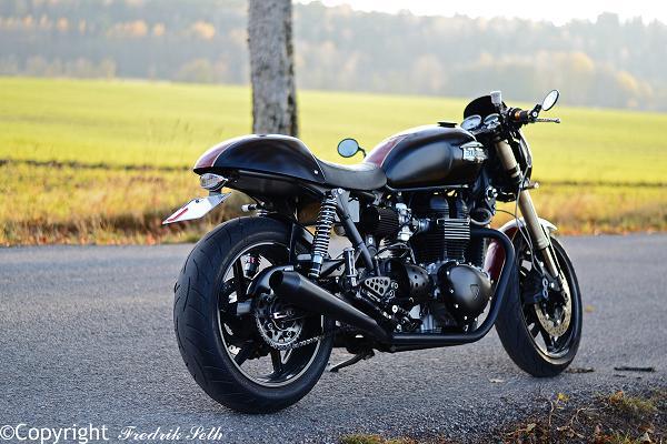

My latest buil based on a 04 Thruxton.
Engine:
-Airbox removed, DNA pod filters
- HC Pistons
- Port polished
- Reinforced clutch, etc etc..
Electrical system
- Cleaned up, all relays etc. placed under the saddle
Handling
- R1 00 front fork and tripple tree
- R 01 pots, R6 05 discs
- R1 05 front wheel
- CBR 600 rear wheel
All in all over 50 parts, most of them waterjet cut from my 3D CAD designs.
To much to describe, It's a lot :)
Some more pics
Thanks!
The top triple is a modyfied R1 triple, the gauge mounts is a design by me in Auto CAD, water jet cut and powder coated.
