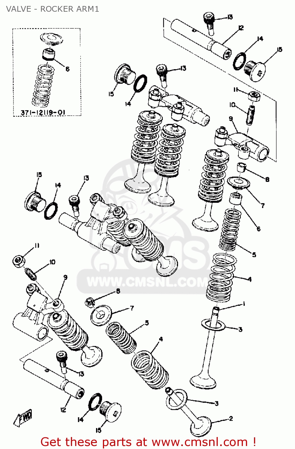

Next I was told that a valve seal may be bad. New valve seals on the intake side. My exhaust didn’t look like it had seals at all. That seems weird to me but that’s what it looked like.

1- Should I have valve seals on the exhaust side?
