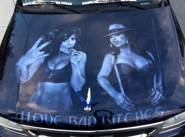

DocRot gave some great advice. I’m a professional painter and I’ve been airbrushing for a couple decades now. I’ve tried a lot of airbrushes and I’ve found that nothing beats the Iwata Eclipse for an all around work horse. I prefer the gravity feed. I have a few airbrushes that cost significantly more, but I barely use those other ones. Learn how to keep the air brush clean—it makes all the difference. If cost is an issue, get a cheap pancake compressor. For a beginner, water base or water borne paints are a good idea because you do not need to adhere to strict time windows. I like Createx Auto Air. I’ve done complete automotive paint jobs with Auto Air with great results as long as they are top coated with urethane clear. I’ll include a couple examples of my work.

Thanks for the reply! I am by no means an artist, just looking to do some fairly simple helmet painting. That's some awesome work right there:cool:
