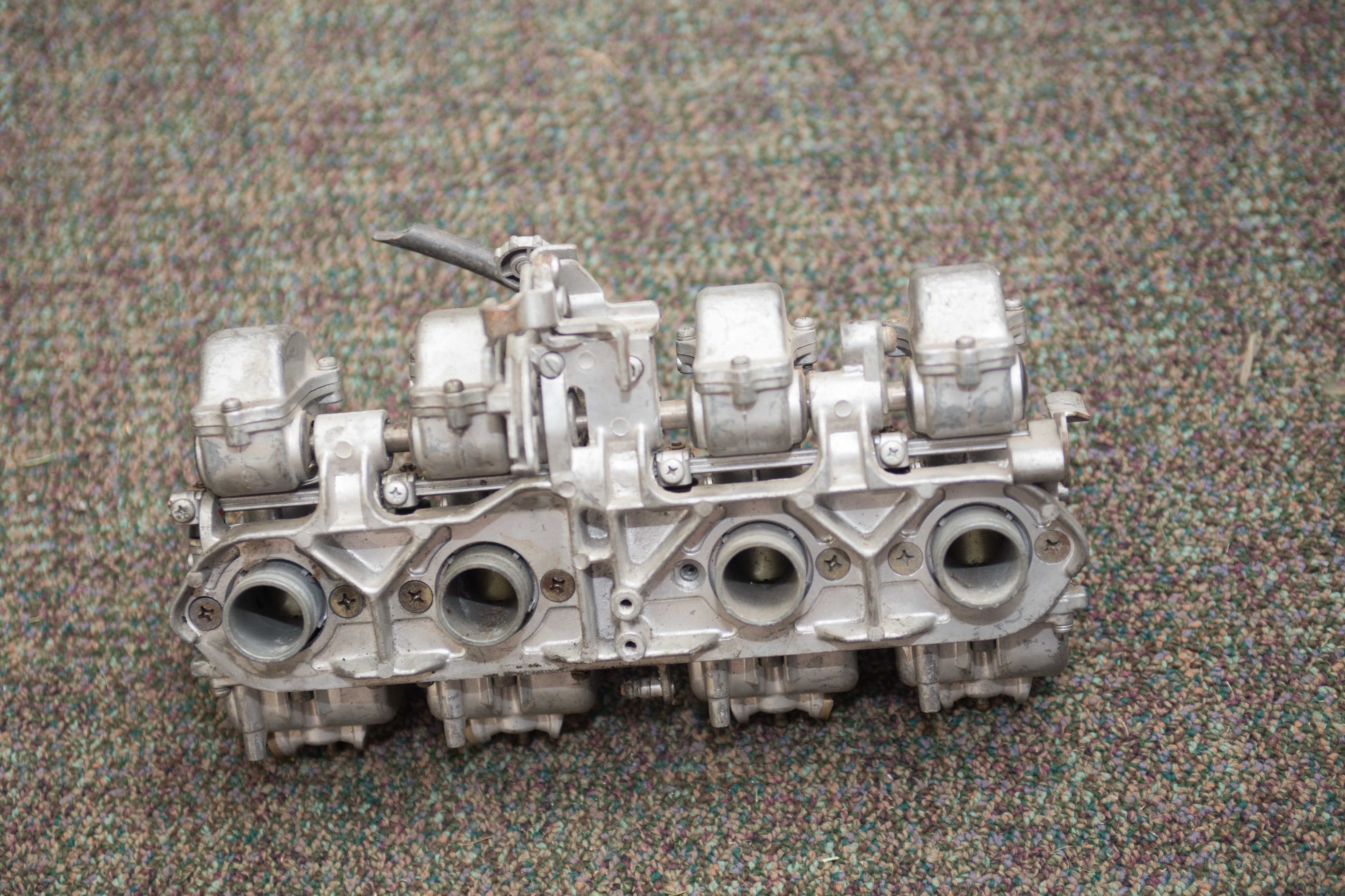

Any guesses what bike these are from? They are mikuni's, I acquired them in a deal, but the guy didn't know what they are from. He restored old Kawasaki's mostly, so that is my only lead.
A picture of the other side: https://flic.kr/p/GBFbD1

could be KZ550?
but Like Yinzer said, number on the side of the carb will pinpoint

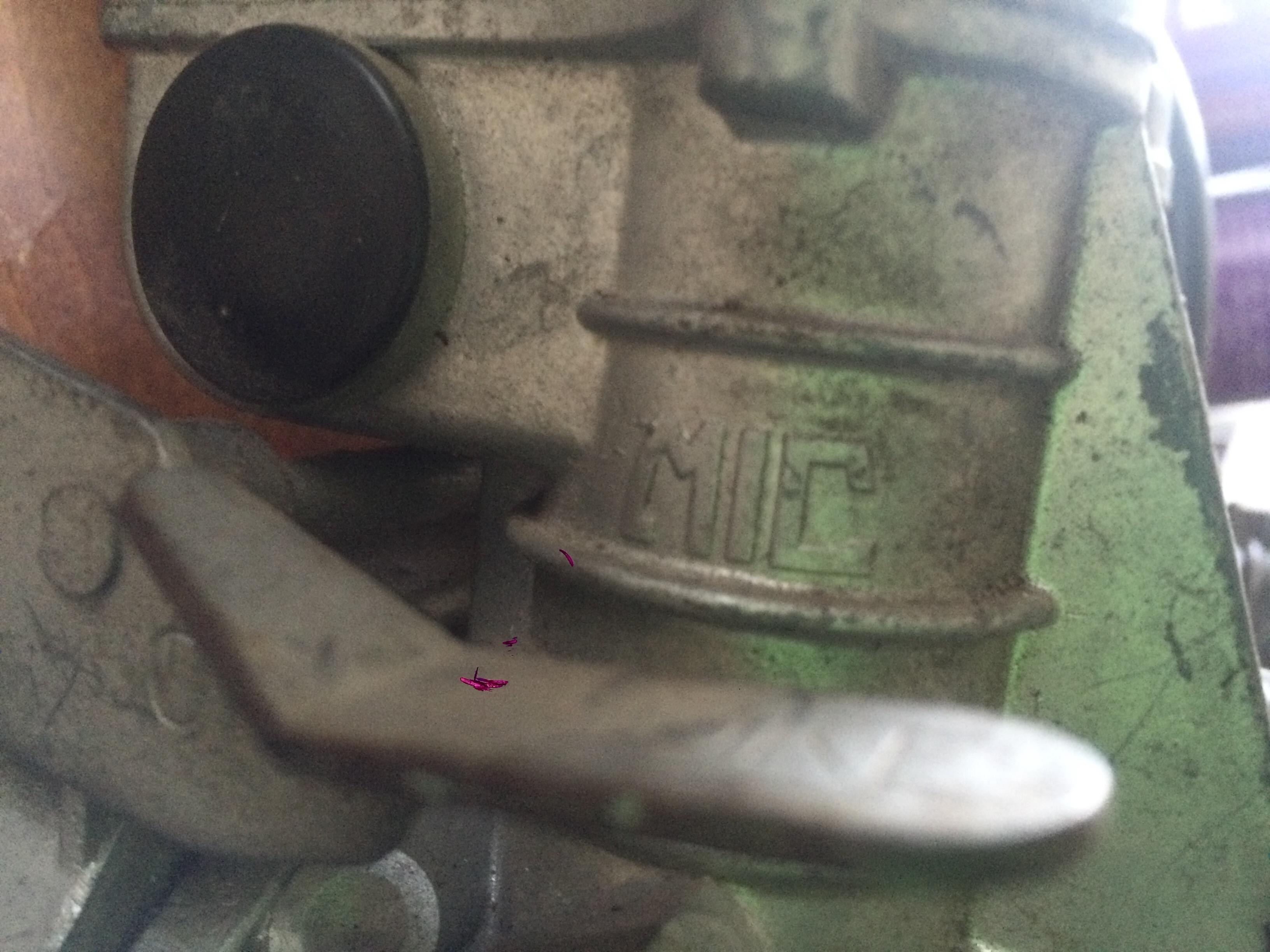

No numbers, the only other marking is "MIC" on each Carb on the opposite side of the Mikuni markings.

Looks like stock 24mm carbs from an early Kz650. They're the only ones I can think of with ribs on the carb bodies like that.
Later, Doug
Pretty sure KZ650 would have an accelerator pump on #2. These don't. Did the LTD carb set differ?
After chatting with some guys over on the KZrider forum - I am pretty sure they are the 77-79 KZ650B carbs.
I have heard multiple sources that they will bolt up to the same boots etc as the original carbs?
As far as jetting - would the same jets work you think? I am guessing I will need to get different jets?
