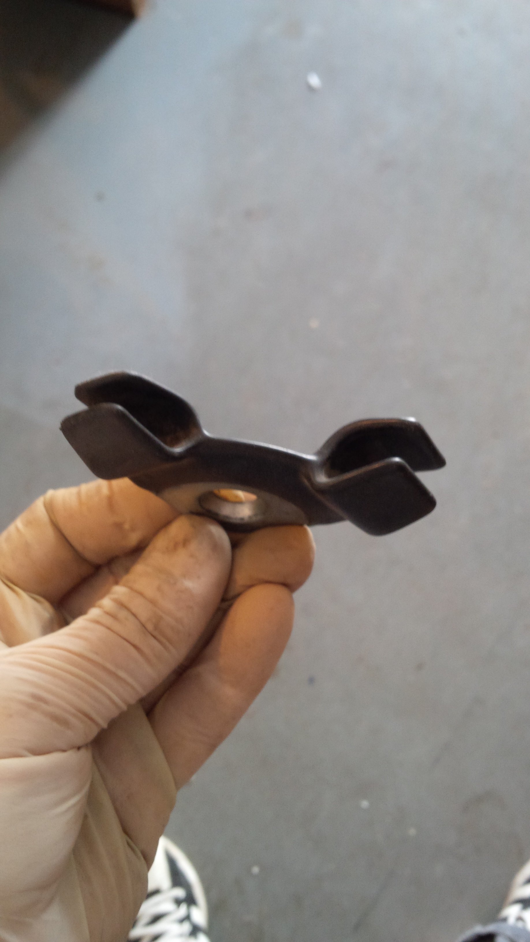

Trying to put back together our 1975 Honda 360T. My son took it apart, and has since found new hobbies (girls); the bikes been sitting in the garage for a couple years and I'm into putting it all back together.
I'm not sure what and where this goes; anyone got an answer, and/or some pics on the bike?

Up front on the backbone of the frame there are two posts - rubber grommets fit over these and there is a corresponding cup on the tank that sits over them. This part sits on one of those posts, UNDER one of the grommets, likely the left one, and orients the wiring harness.
