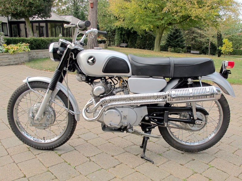

So I bought this exhaust off eBay. Great deal, great condition. It's for my 1973 cb175. I get the box open expecting the thing to slide right on but nope.
It's like the headers are too close together... Or the exhaust ports on my bike are too far for it to fit.
Can anyone tell me which bike this came off of? The seller and the tag say a 1972 cl175 but it doesn't fit from what I can see.
Help! Thanks.
No i have cl160 and the muffler sheild has strip instead of holes.

Definitely for the CL175. I always disassemble the exhaust into separate pipes when installing. Exhaust ports are just angled enough to make it a bitch to get them in together. After they're both in you can put the hanger and shields back on.
Holy crap that is terrible. Barn burner, it's just as you said. Once on, you can tighten the clamp that keeps the pipes together. Other than that they're flopping around all over the place. Cool. Well I'm glad to have that sorted out! Thanks guys.
