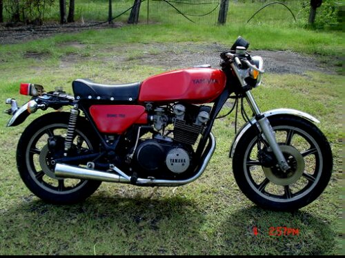

The first photos are of the XS750-2D as advertised and now - nothing major but needs a final paint job.
The next photos are of the XS750SE as advertised (that why I was the only bidder) and at home, the final photo as of today, just getting parts together!

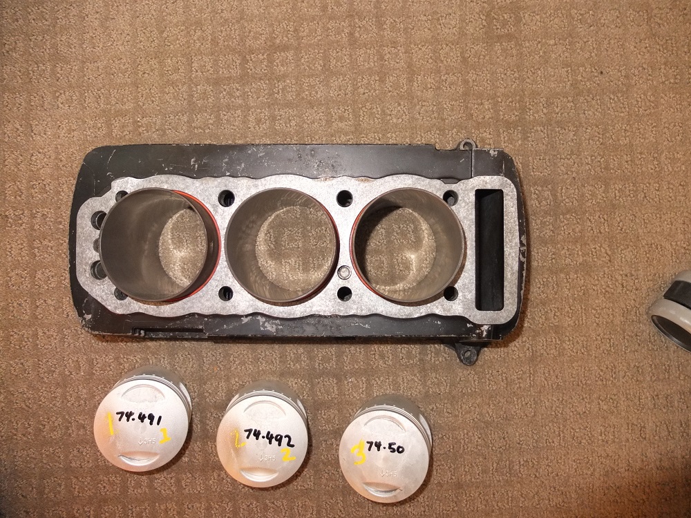

Cylinders and pistons have been dropped off at the machine shop. As you can see in the photo the pistons look OK, they are not in the same league as the Scheuerlein pistons out of Germany that went into the XS750-2D, but they should be fine. The cylinders look a little rough on the outside but all mating surfaces are in good condition.

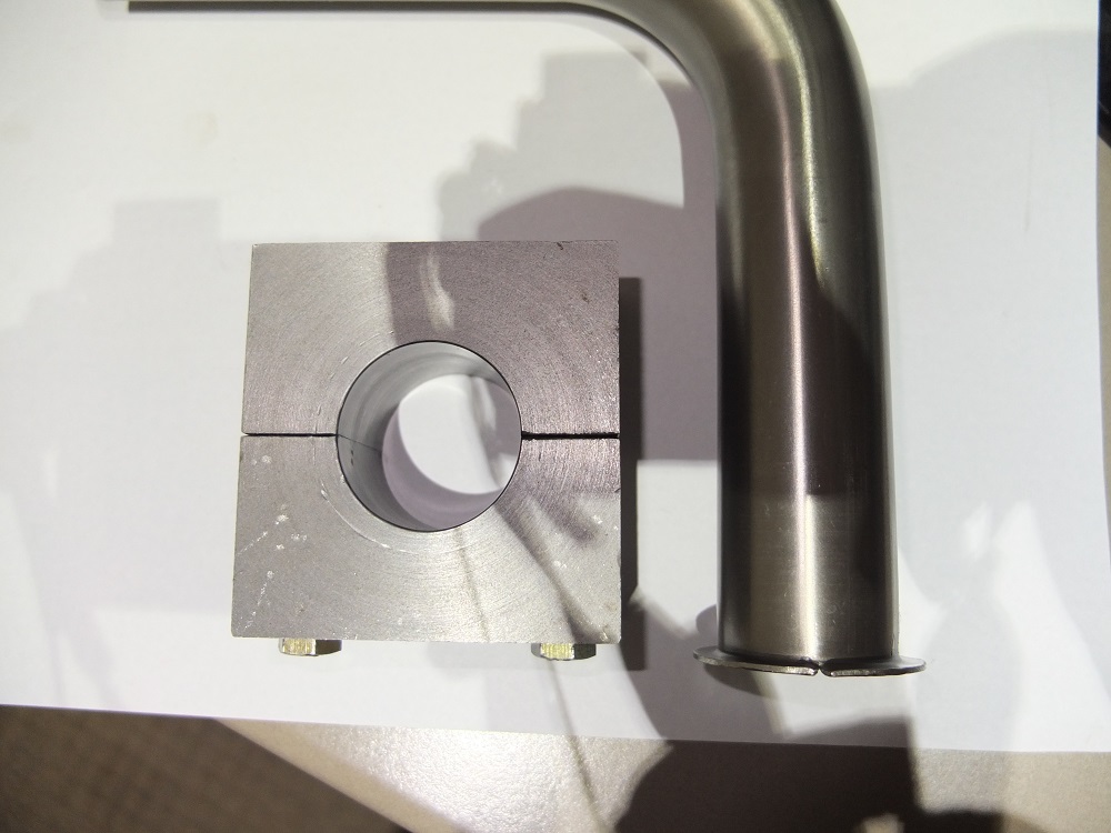

Spent a couple of hours in the shed making up some tooling to form a flange on my headers. I have a triumph 1050 Street triple header which has a nice flat junction where all three header pipes meet, but the couplings onto the head are not compatible. Pipe diameter is also same as the XS at 38mm so I have just bought some 90 degree 38mm 304SS bends to solve the problem. In the photo you can see the first practice run. I will use the practice parts as the little clamp brackets that clamp the headers against the head. The split is along the tube seam, on the headers I will get my TIG welding mate to spot them on the inside before I flare them and see if that helps.

The cylinders came back from being bored out to 74.5 that only leaves 1.8mm walls on the barrels! There was some variation on the piston diameters, only microns but it means the pistons need to go in the assigned cylinders.

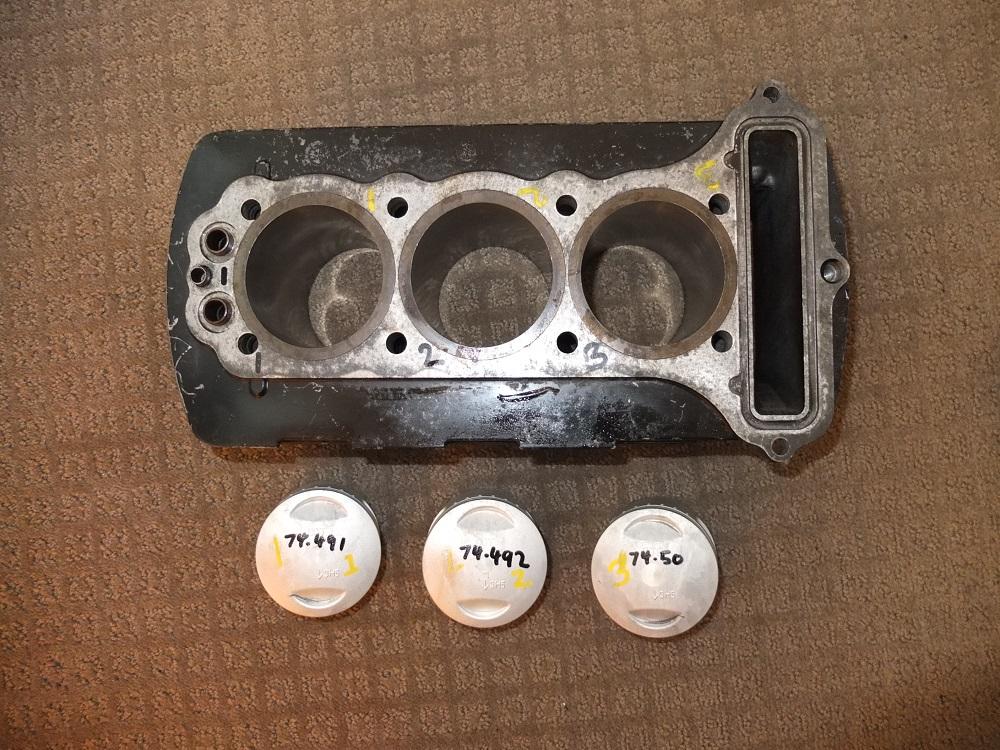

The cylinder is back after boring, and as in the photo the pistons had a few microns of variation. Not enough for any problems, 2 pistons are interchangeable and one, 0.008mm larger must stay in #1 position. I went back onto the Scheuerlein website as their pistons were close to perfect for the 750, to see if they sold big bore kits. And they do, BUT they cost Euro400 and are the same big bore kit that I bought on Ebay for AU$200 delivered. Have a look at the photos - they are out of the same tools!!! Scheuerlein state they are sourced out of Japan - but I cannot see how they justify the extra AU$380!!!
I have the gasket kit, so in theory I have all I need to rebuild the engine unless I find some surprises.http://www.dotheton.com/forum/Smileys/default/tongue.gif Made up an engine stand on the weekend to make it a bit easier. This is the second XS triple rebuild I have done , and the 3rd time to strip one down. On the 750, one of the journal studs striped out when I was taking it to final torquehttp://www.dotheton.com/forum/Smileys/default/angry.gif. One hellicoil and a day and it was fixed ;D.

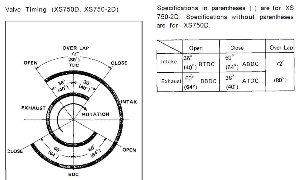

On the cams the XS750E appears to have the final design and the highest performance so that looks OK. Plus it keeps the valves open longer so I guess the actual compression will be a little less due to the swept volume with closed compression is slightly lower!!! The info I could find was per the attached image for the D and 2D and the following text for the E.
"Therefore the engine modifications were kept subtle and affect only the top end of the engine. For example the compression ratio has been upped from 8.5:1 to 9.5:1, which means it now requires premium fuel (at least 90.5 octane rating). The actual shape of the combustion chambers has also been altered and they now actually displace fewer cc’s than earlier XSs. Cam profile has been altered slightly, retaining the same lift but now having sportier intake timing. And intake breathing has been further increased by changing the venturi shape in the carbs (they’re still 34mm in size), modifying the main jets and adding on a, larger, better breathing air box.".
