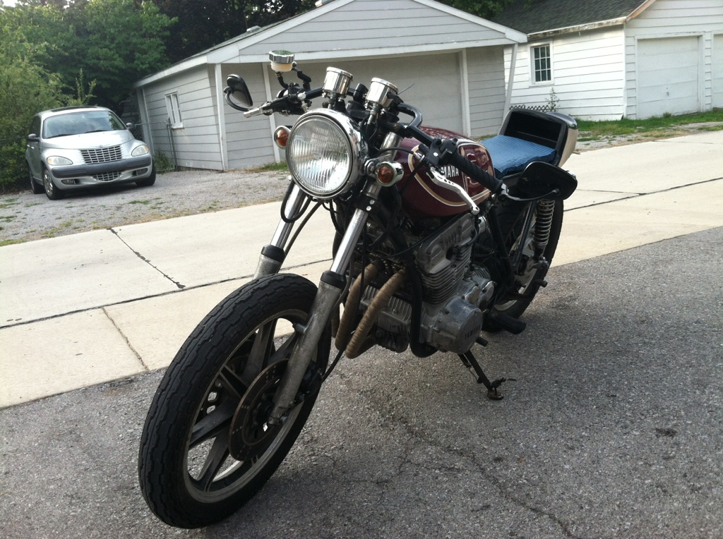

Re: xs750 Triple Cafe glamour shot, waddua think?
just another update.. nothing big.. really just telling you guys how my bike is riding etc...
The bike is overall riding... ok.. you can still tell that the carbs are off.. I will take the carbs apart and reset the float height and needle height.. I think my Henry Abe filter is too restrictive.. I think I am going to go to either k&n filters or velocity stacks.. not sure yet...
my petcocks are seeping a little.. enough to be really annoying.. not leaking out the fuel outlet.. but out the gasket.. looks like I will be switching to manual petcocks sooner than I had planned..
I bought a fat back tire for it.. and so far hasn't been a huge issue.. until it gets hot outside.. it expands some and then rubs terribly on the driveshaft housing.. I need to drop down one tire size in the back.. I feel like this and the combination of the running rich and having to keep my gas cap open to vent and seeping petcock is killing my fuel economy... I should be getting somewhere closer to 250 miles per tank of gas.. and I'm getting around 150 if I'm lucky.. ugh!
regardless of those issues.. my bike is still waaaay fun to ride.. I love it.. here is a pic
